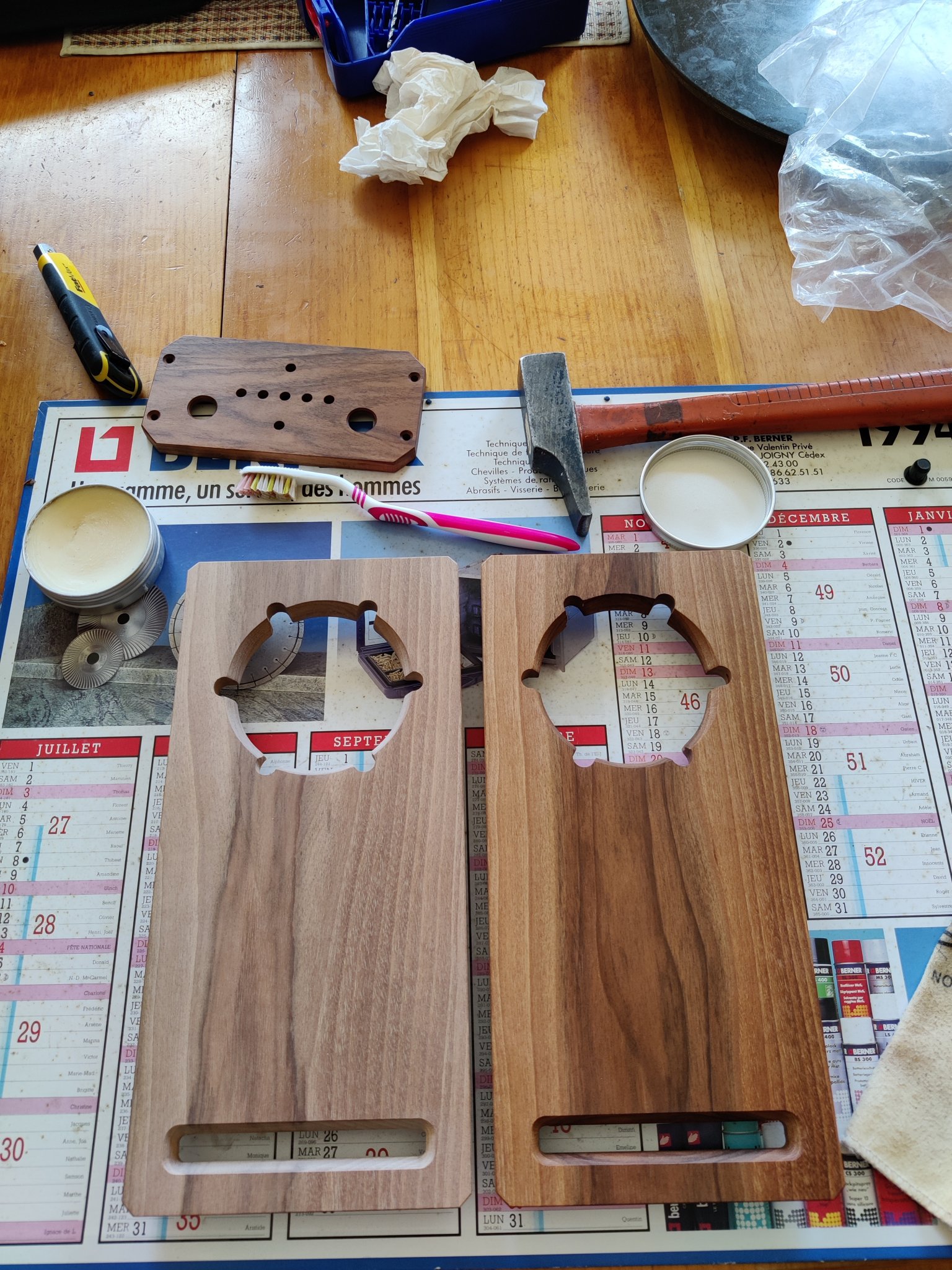

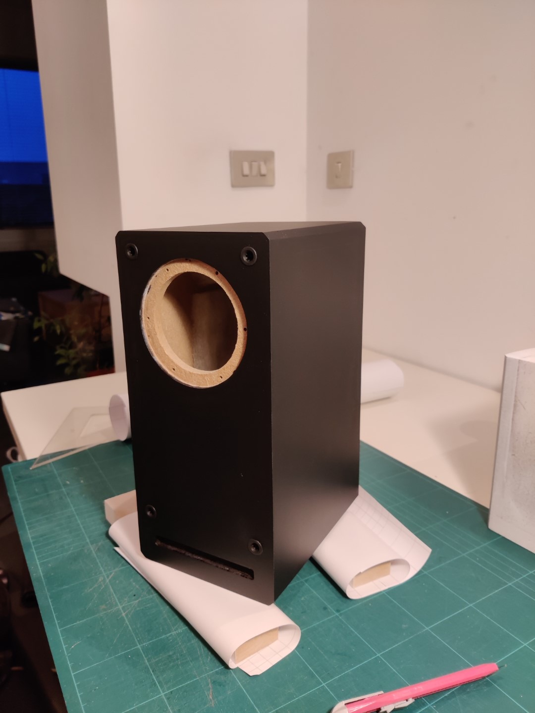

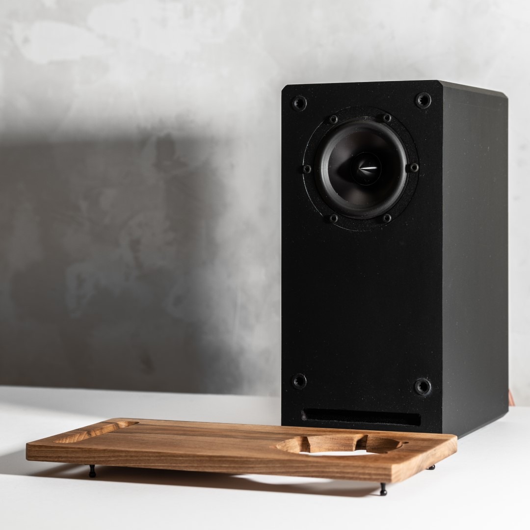

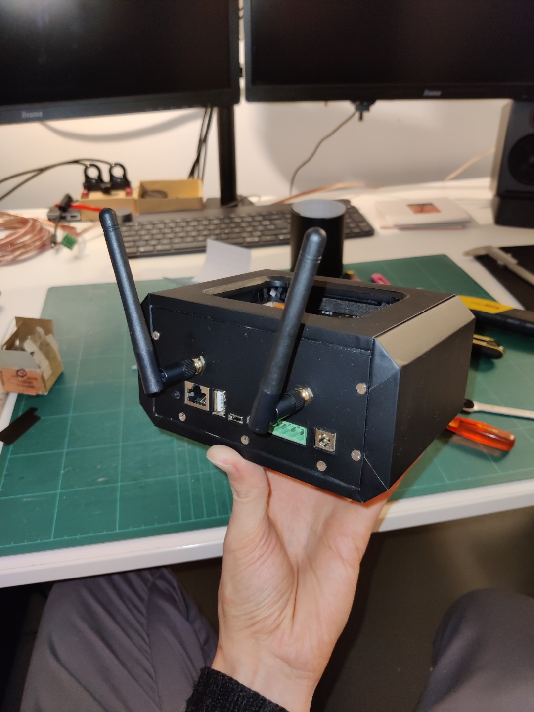

I would like to show you my first speaker build.

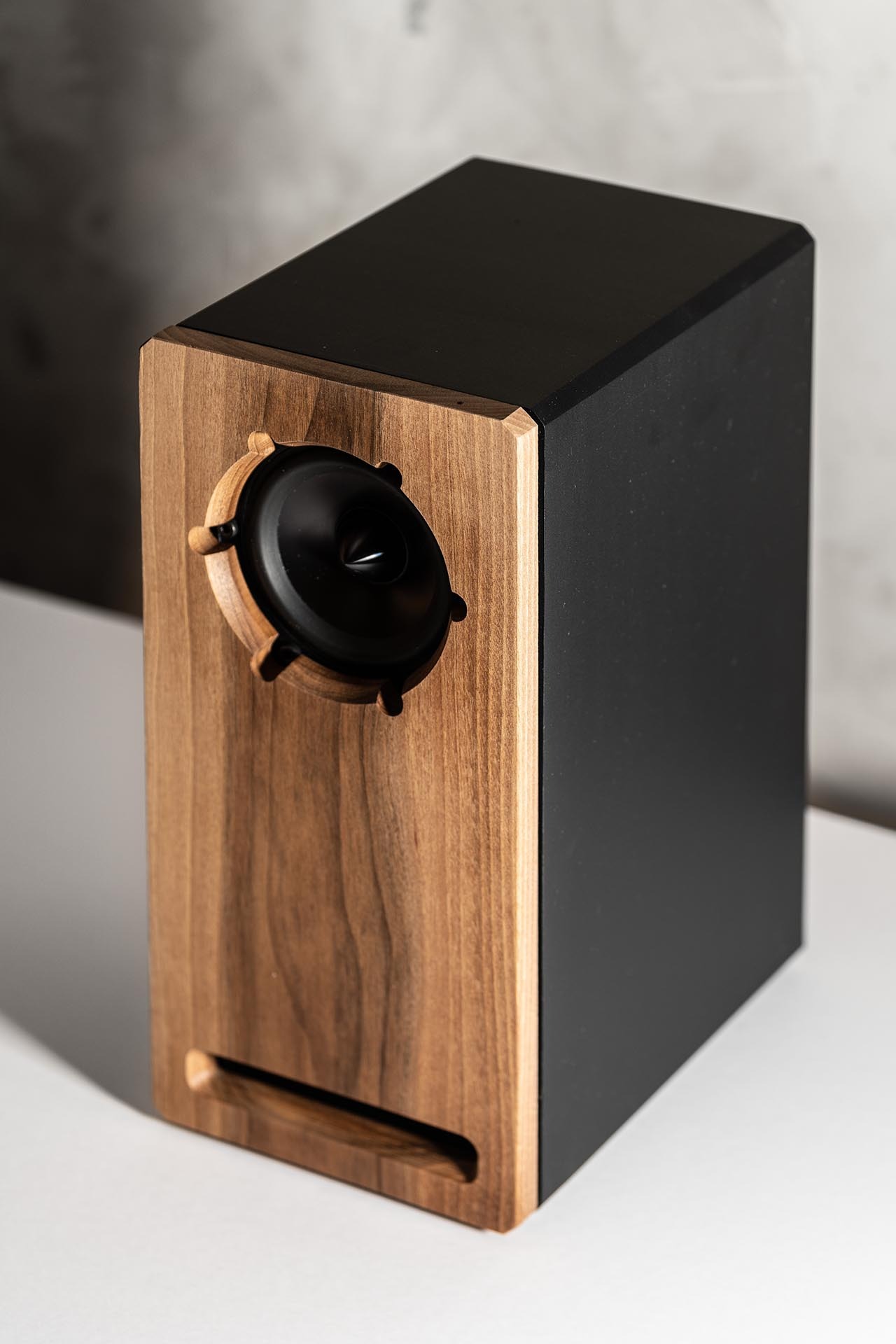

I must admit that after beginning to design a cabinet with speakerboxlite.com I found this article and chose to copy this design (for the technical part) since it was made with the full range drivers that I intended to use (the Dayton RS100-4).
My goal was to make small enough speakers with a small amplifier and a DAC to put on my desk and use them on my PC.

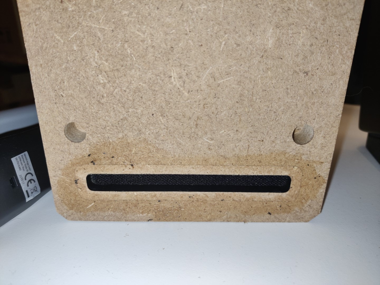

Since I didn’t like the design of the front panel with two ports, I changed the design a bit to cover them with fabric in a single slot.

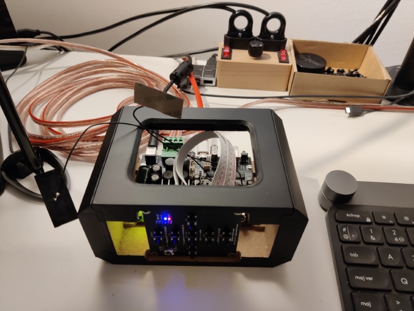

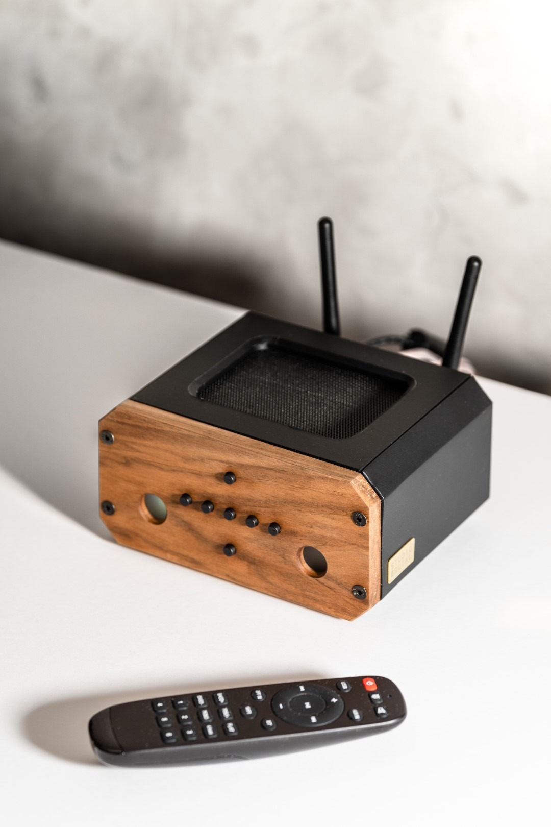

For the amplifier / DAC part, I found the Up2stream Amp v3 from Arylic which turned out to be just perfect for me since it includes a DAC with Wifi, ethernet, bluetooth and usb inputs, plus a mini-jack analog input. It’s sold without a case, so I could do the design of my choice.
I have no measurements of the frequency response, but I can say that it was a big improvement over my Audioengine A2+ (It’s also not exactly the same size) and that I’m now just waiting for an opportunity to get into a new project.
I hope you’ll like it, well, at least the look since I didn't really design the rest of it ;-)

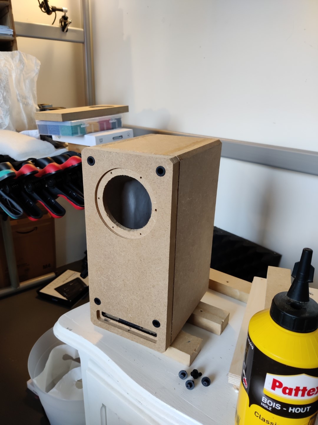

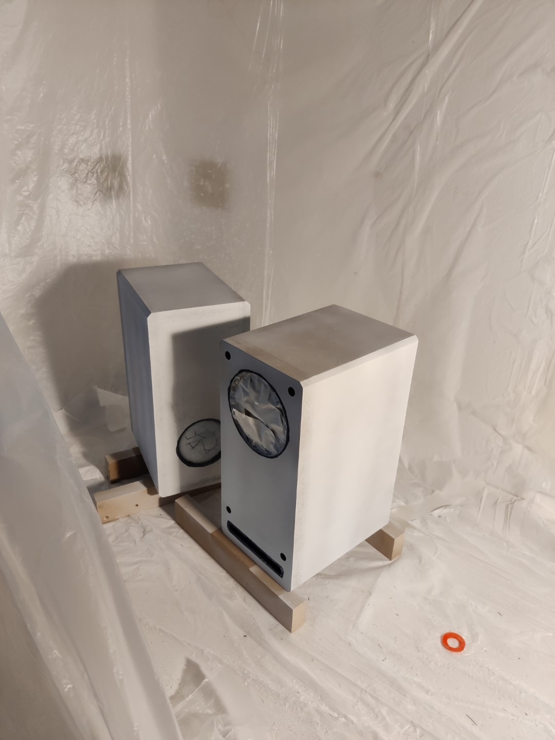

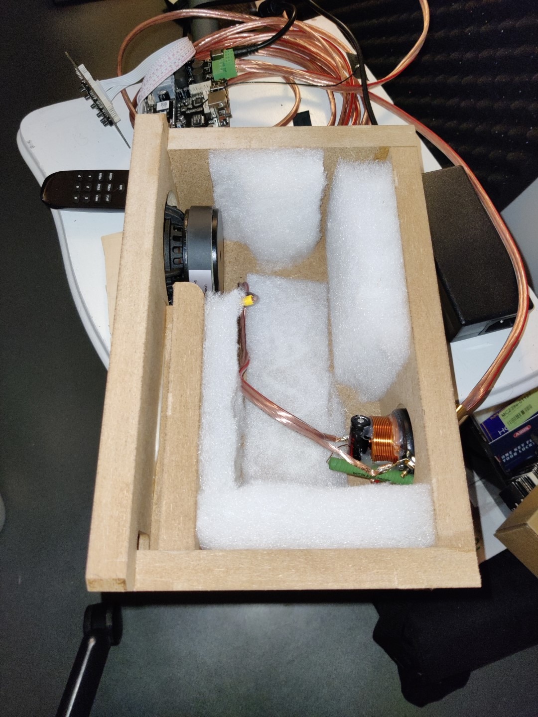

Some "not so nice" picture while it was made :

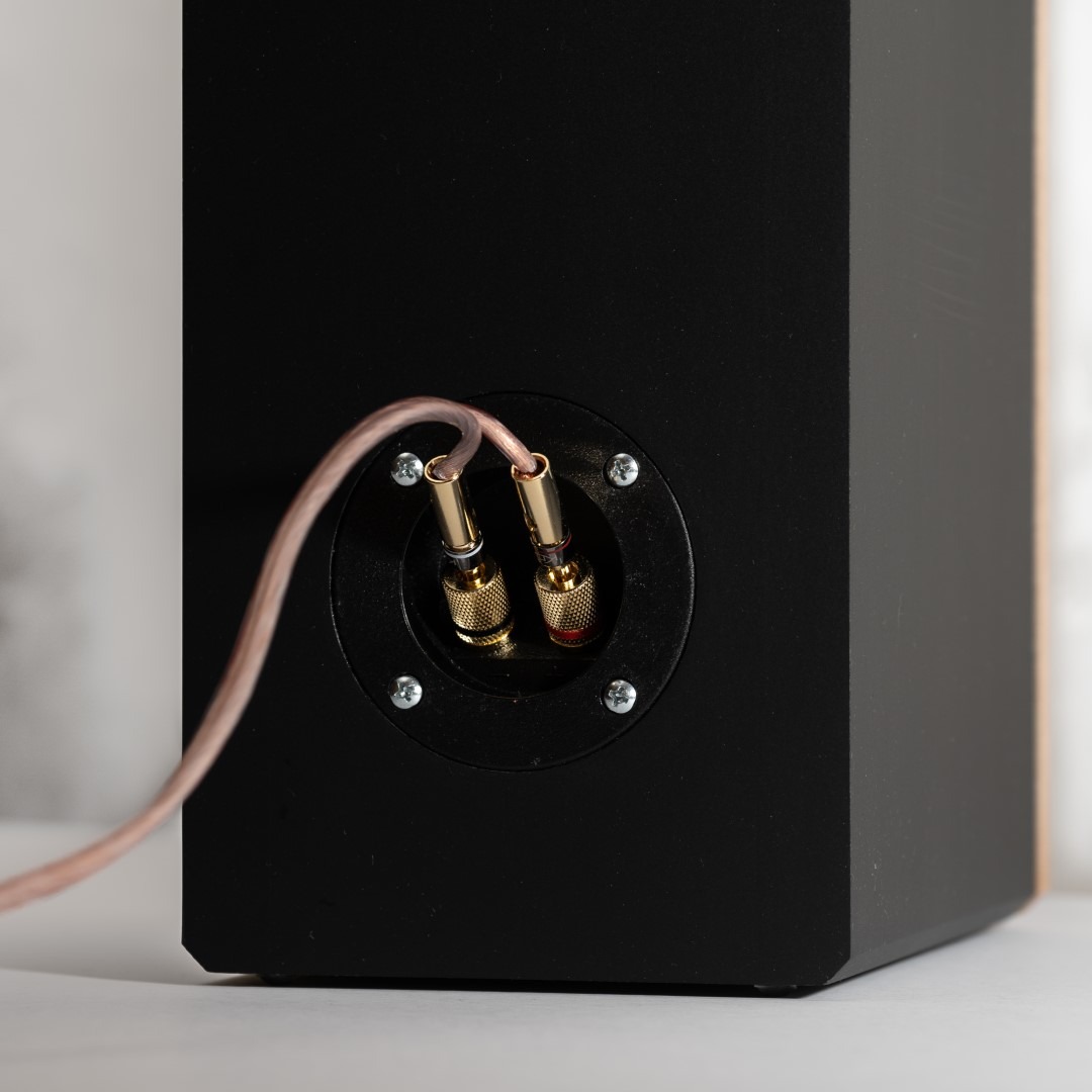

And some better photos made once it was finnished :

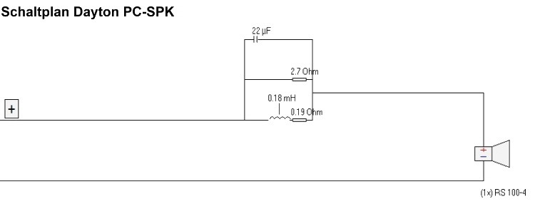

Actually there is an EQ, but you have to buy ACPWorkbench wich let you customize the Up2stream from your PC by adding filters and other things that I didn't took the time to check in details.
For the filter inside of the cabinet, I copied the filter found in the article on werner007.de
I draw it in Virtuix to see the effect, and it's apprently lowering the frequencies arround 3kHz in order to have a flatter frequency response curve.
