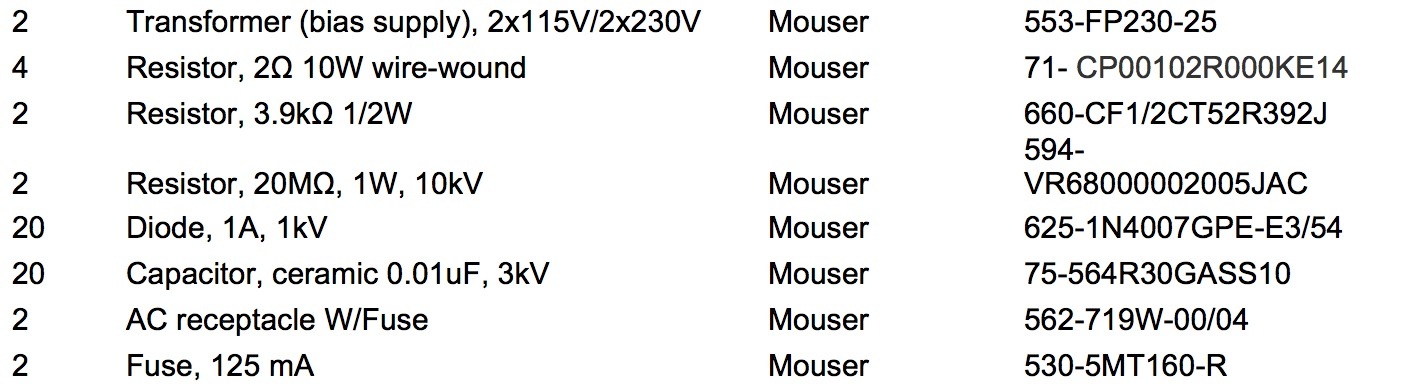

My bias supply is simple, cheap and reliable. I think it would work fine for your project if you omit the last 4 capacitors and diodes, to drop the voltage down.
Here's my parts list for two bias supplies, just reduce the number of diodes & caps to fit your need:
