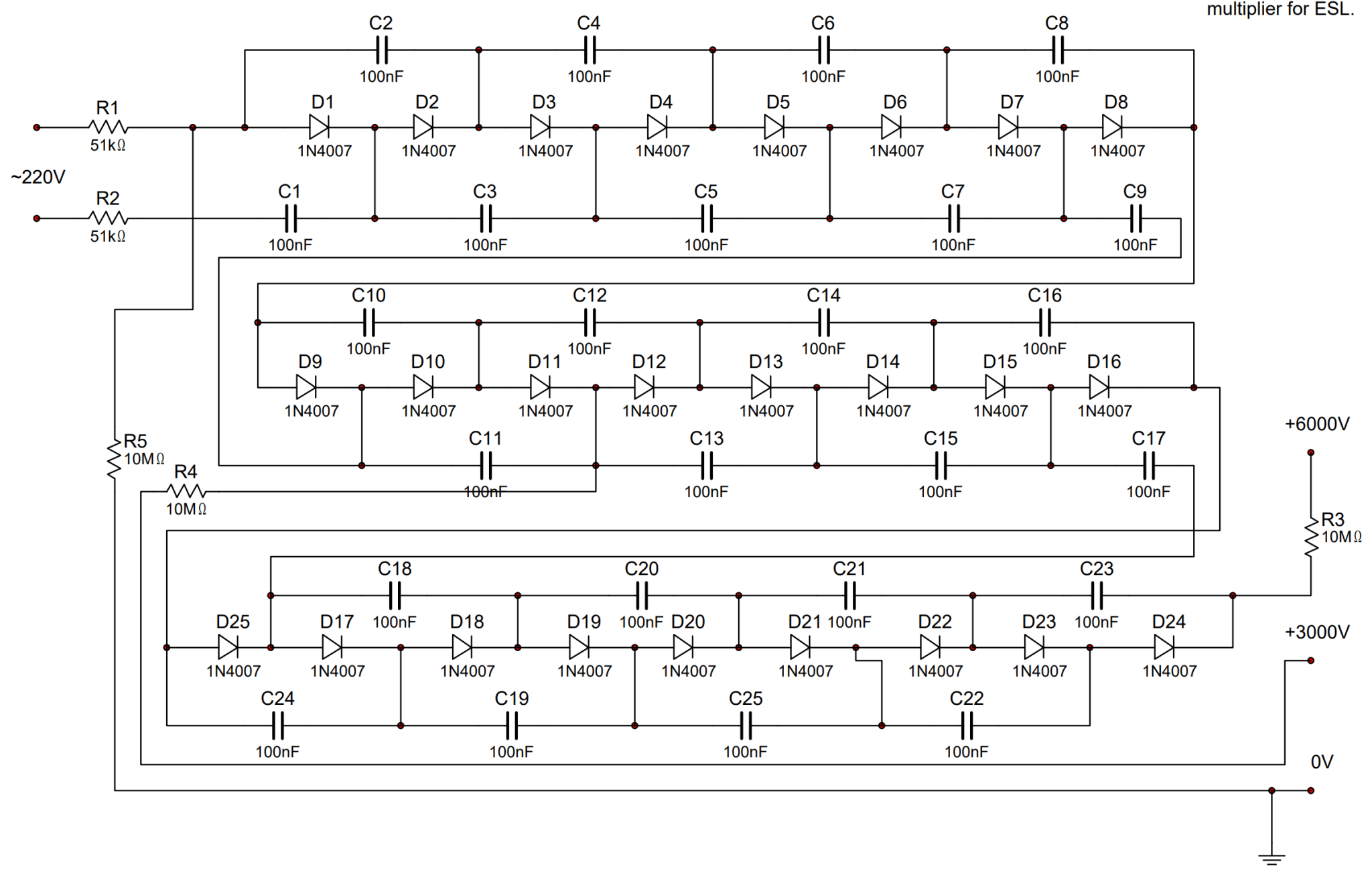

So the screen just arrived today, a quick measure with a multimeter told me that it is very conductive with <3 ohms of resistance in the surface area I will be working with. For now I will see if egg-crate + aluminum screen combination will produce a recognizable sound, and go from there.
As I am thinking of designing the high voltage DC bias supply, it would be of immense help if I can see schematics of such a circuit with specified transformer, resistor, and capacitor values. (I have in mind a transformer connected to a cockcroft-walton cascade voltage multiplier.) Problem is, plugging a transformer directly into the wall just sounds like a bad idea that will kill me (not sure how I would form a closed loop with the diaphragm circuit but the exposed parts are still dangerous), and I do not have an AC signal generator. I am waiting to gather all the electronic parts so I can buy them mostly in one batch from mouser, avoiding paying for shipping multiple times.
A proper design that will not burn the breaker and my wires down while supplying 1.5kV would be greatly appreciated!
Maybe I have to plug it into 115V AC mains after all.
Searching on mouser yielded a Hammond step down transformer 6K68HF (out of stock) that when connected in reverse, accepts 115 VAC and outputs 230 VAC, leading to a bigger cascade / appropriate voltage rectifier circuit to bring it up 6.5 times with room to adjust.
Or I could pick an even higher primary voltage and figure out a way to supply the lower secondary. Which is what the Hammond BE7G offers.

I think I will settle on the 24VAC to 347VAC Hammond BE7G as the transformer, and build a rectifier on top of it. Sorry for the questions above.
