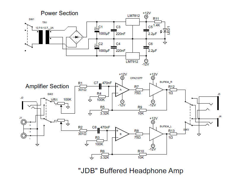

Hi all, I'm a long-time lurker and I've only posted a couple times. I'm currently in school to become an EE and in the time I've been in school, I've learned a lot compared to my earlier design efforts. So far I've built it up on protoboard and tests well on the scope and with my headphones. Anyway, about the amp:
-The heart of the design is a Burr-Brown OPA2107 op-amp and two BUF634 buffers, each with 250mA output each. The buffers are kept inside the op-amp feedback loop to compensate for any error that either the buffers or the op-amp create.
-Power supply is +/- 12V, 2A max.
-Inputs are switchable between RCA or 3.5mm TRS
-Outputs are switchable between 3.5mm TRS or 6.35mm TRS. I've also considered adding RCAs to the output so it can function as a preamp.
-The name is derived from my initials. Please let me know what you think!
(Not that it really matters, but this isn't a school assignment, so say anything you want to about it.)

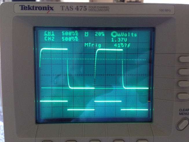

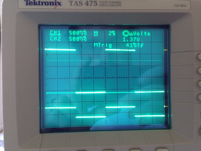

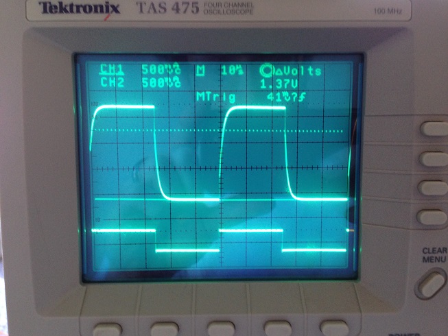

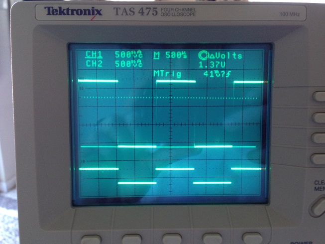

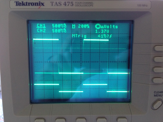

Some scope results for some proof it works. In order,
1: 100Hz square wave fed from function generator into input jack, output read at output jack, into 40Ω dummy load. CH1 is the output, and CH2 is monitoring input for comparison.
2: Same as above, 500Hz
3: 1kHz
4: 10kHz
5: 20kHz
6 & 7: Picture of the actual amp. Note this is an older picture and it has LHM6321 buffers instead of BUF634s.
I think the breakdown of the waveform >10kHz is due to it being built on protoboard, once I get my PCB finalized then hopefully things will look a little better.

That's great Joe, and its always nice to see real scope shots and measurements to back things up.
Only comments I would make... and its not finding fault... is that the 100k volume pot is perhaps a little on the high side and may be responsible for the slight high frequency roll off visible at 20kHz. That's because a filter is formed with the resistance of the pot and any input/stray capacitance. R3 and R4 also have the effect of altering the law of the pot somewhat.
Greetings from extremely hot and I'm-not-going-near-a-soldering-iron-until-September Kyoto.

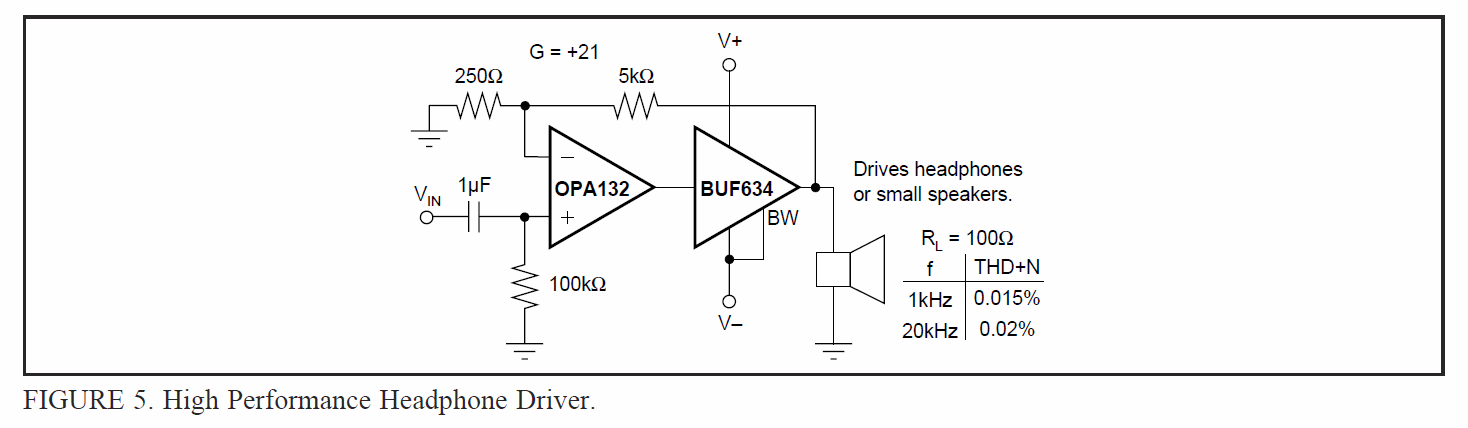

Your circuit is a simple re-working of the example from the BUF34 datasheet, reproduced below. No shame in that, though it would have been nice had you made that clear. Simonov, who posts on this forum from time to time, has a write up on his blog, here. There are many others.
1. As Mooly notes, the volume pot should be 10-25k, not 100k, as 100k is your load resistor and you want about 1/5th of that ideally.
2. A headphone powered by 7812/7912 is going to sound like every other headphone amp on the planet powered by 7812/7912s, i.e. washed out and grainy.
3. While 2.2uF after the vregs is the databook value, most audio circuits use much higher capacitance, especially for a headphone amplifier circuit.
4. R7, R8, and R12, R13 don't accomplish anything useful as far as I can see.
The buffered op amp headphone amp is one of those circuits that on paper should be ideal, but in practice doesn't seem to satisfy people for very long. My opinion, entirely empirical, is that this is attributable to 1) the nasty voltage regulators most people insist on using and 2) putting the buffer into the feedback loop, which probably causes more problems for the op amp than it solves for the buffer.

Thanks for the replies, Mooly and rjm!
I too wasn't completely sure about the 100K pot, but I eventually decided to use it because it's the only value of the Alps RK27 I can find. Perhaps I'll give a 10K RK097 a shot and see what happens. I agree it's probably the biggest problem I have right now with the amp.
That's interesting about the datasheet application for the BUF634. I don't know if I made it clear earlier but I first tried an LMH6321, then LME49600, and finally tried the BUF634. I don't know if it means I'm on the right track or if it looks like I'm a copy-cat! Thanks for the link to Simonov's page, I'm sure it'll be helpful.
What would you use in place of 7812/7912? As far as I can tell, they regulate voltage pretty well and supply plenty of current for what I do. I'm willing to try anything new as long as it doesn't cost me too much, what would you use? I also found that 2.2uF is plenty, but upon your recommendation, I'll try something a little higher. I did try 10uF tantalum but didn't change anything. Do you recommend sticking with film caps or electrolytics?
R7 & 8 probably aren't necessary but I put them there for a little protection to the buffers from the op-amp. R12 & 13 were added late in the process to help the circuit from reacting too much to headphones, and while it doesn't sound any different, it was visible on the scope that it did help a little. Again, probably not 100% necessary, I agree.
I'll try leaving the buffers out of the feedback loop to see what happens.
Thanks for the comments!
I tend to look at regulators this way (and everyone has their own ideas) in that the biggest problems is actually knowing and understanding what you are trying to accomplish. By that I mean identifying what problems you are looking to correct... if that makes sense 🙂
If your rails are clean as looked at on a scope and aren't modulated at all by the amp driving the headphone then your already at a good point. The problem with any regulator is deploying it correctly and what can happen is that you find the output at the reg itself is super clean, but add few cm of wire to its destination and its not quite as good. So to get that last few percent of performance you need to be looking at absolutely correct grounding techniques and super short wiring, perhaps with the regulators physically next to the parts they are supplying. And doing all that is much easier said than done.
I can't just tell from your pictures whether you have any local decoupling around the IC's. That's important when the regs are some way off.
Actually the output impedance of a 100k pot (on a low-impedance source) is 50k||50k = 25k max. (I'll blame it on the heat. 😉)
I'd be more worried about impedance imbalance. This part uses a cascoded FET input stage and as such should perform better than the average JFET input device in Samuel Groner's epic bunch of measurements when it comes to input impedance distortion, but a maximum difference of about 22k still is kinda high.
Reviews of this part mention some common-mode distortion, so a high-end design may attempt a common-mode bootstrap on the OPA... oh wait, it's a dual. I mean, one could still do it, as (L+R) generally >> (L-R), but I'd have my doubts about effectiveness and stability with even moderate channel imbalance...
I'd check stability the hard way - hang a 10 nF on the output, and if that passes, a 47 nF. The capacitance of a headphone cable alone may be in the 1 nF vicinity. It's not like I'd expect anything major with the relatively slow OPA2107 at a gain of 4 - the 1 ohms may already be far more than sufficient to ensure stability, and if lower Zout were desired, I'd give a Zobel network a shot.

Before you go any further, set the scope and amp up so that you get the same hf hash showing as above.
Now remove the scope probes from the amp and connect probe tip to probe ground. You should get a straight trace with no noise. Still keeping the probe shorted touch the tip onto the ground point of the amp you were using before.
Does the trace stay clean or do you see the noise return ?

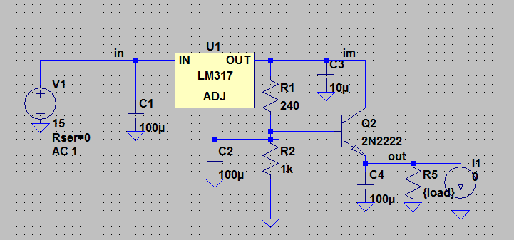

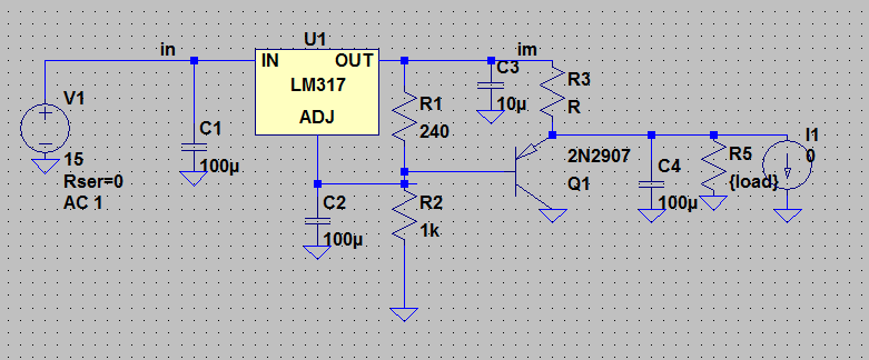

I suggest having a separate supply for the opamps (use TL431 shunt regs) and keep the LM317/337s (well slugged with a suitably large cap for low noise) for the buffers. This will largely prevent the buffer's switching noise affecting the opamp via the supply rails.
It is possible to use LM317/337 reference voltage and an additional BJT to do an extra filtering. Just put a sufficient value capacitor into reference node and it will give you much lower noise than TL431. If you need a lower output impedance, CFP can be used instead of a single BJT.
Disadvantage of this method is in some voltage vs temperature dependance, which usually not a big deal with opamps.

Thanks for the kind words... and its nice to see actual real scope shots to back up circuit designs and builds rather than just taking things on trust from simulations and so on.
So you've tried it all in a different location and with different test gear and its the same. That's sort of rules out what I was thinking earlier (try it non the less for interest though).
Have you any "local" decoupling around both IC's ? Its well worth trying a small cap (say 0.1 to .47 film or ceramic, perhaps in series with a 1 ohm carbon or metal film resistor mounted directly across the power supply pins of each IC.
VHF oscillation, hmm. That can't be the main feedback loop (it's far slower than that), so I guess we are looking at local oscillation around the buffer. Layout gets quite critical at frequencies like that. Do experiment with rail decoupling as suggested. (On a hunch, I would also try a small cap to ground at the buffer input.)
If that doesn't help, rail or ground inductances may be too high. Remember - the larger the loop area and the thinner the conductor, the higher the inductance. Hence why they use ground planes in RF. (You just don't want one under the inverting input of your opamp.) Speaking of which, maybe you can pick up some tricks for hand-building circuits suitable for RF from the ham radio crowd.
