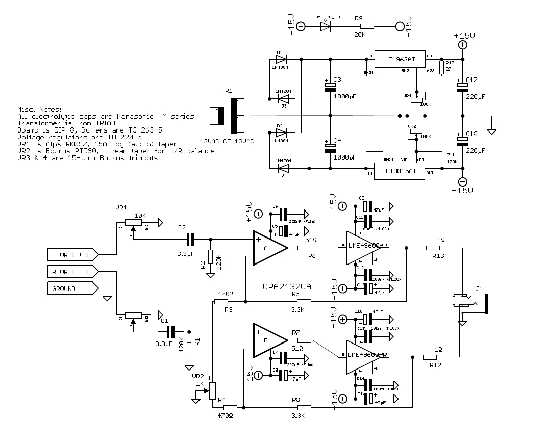

My first HPA design...comments please!
And you've done a great job 🙂 That's a fantastic looking board you have done, and all for a first attempt. PCB layout is no easy task, that's for sure.
Well done.
🙂 Thanks Mooly!
Everything looks amazing! Bravo!!
Do you have the final schematic?
Thanks! Nice seeing a fellow Denver citizen! I knew I forgot something, here it is. I also attached a PDF of the schematic in case the JPG is hard to read.
