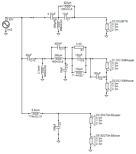

Now for the brain blender. I have used the Xsim program to clank out a crossover for this Frankenstein. I am attaching pics of what I have brewed up thus far and for all to critique and tell me what I am doing wrong (aka suggestions, ideas, or I'm on the right path). Again, I'm not going for audiophile, this is a hobby not an addiction for me.

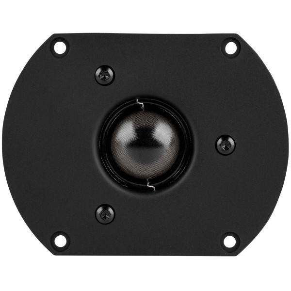

They have a truncated plate for that tweeter

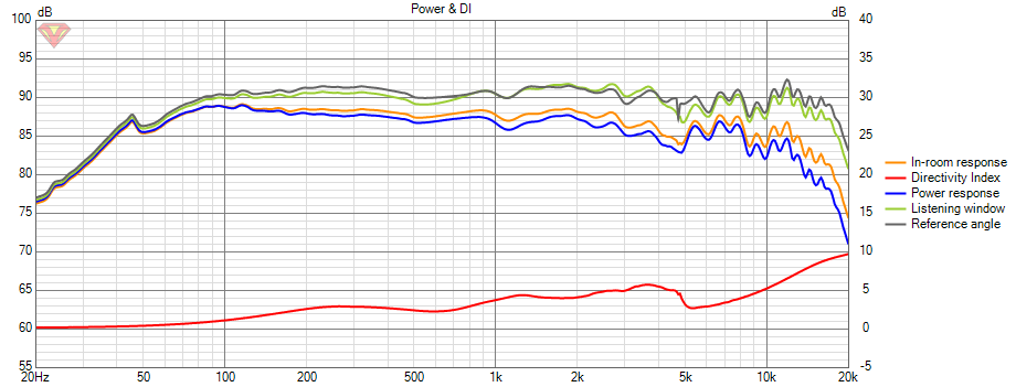

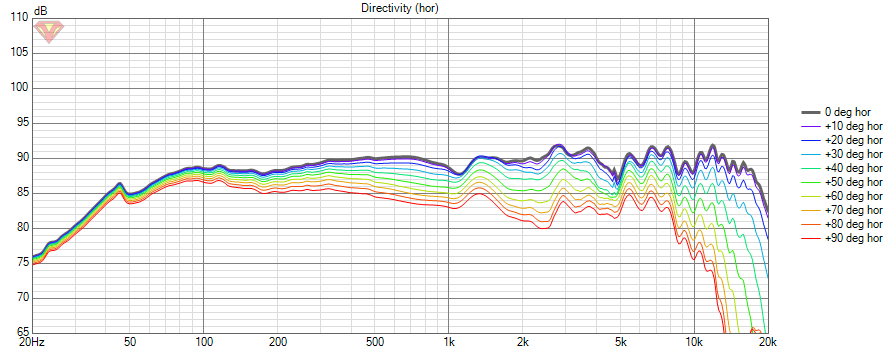

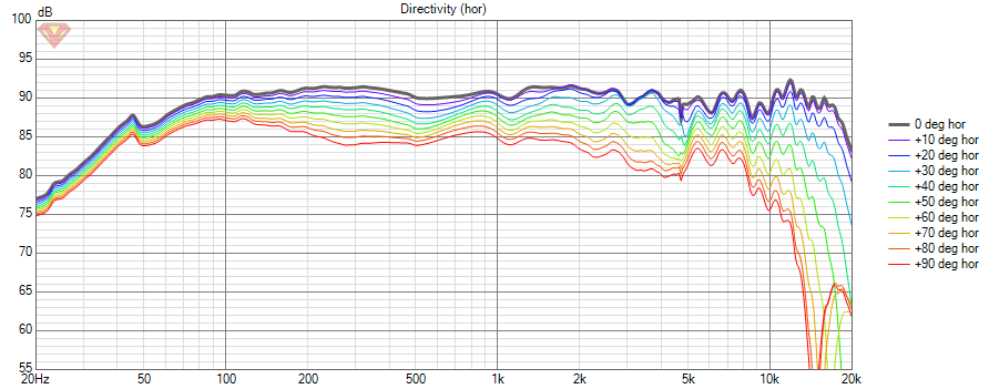

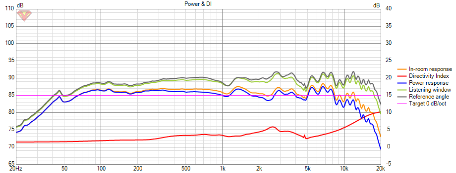

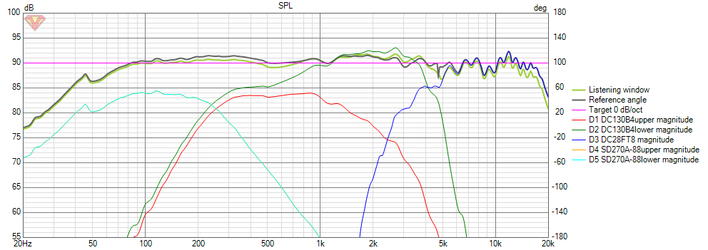

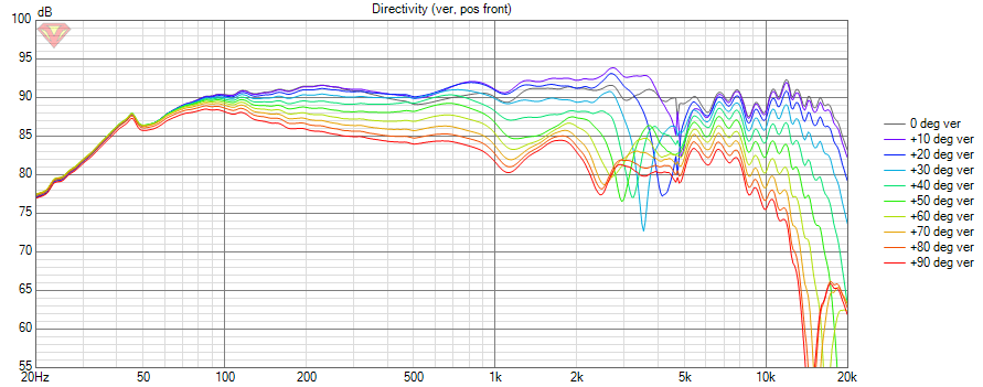

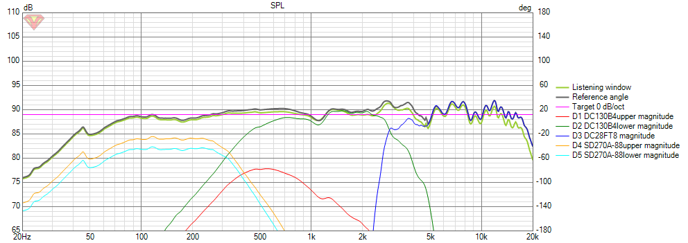

j\Just a quick look at my home work from the past few hours.

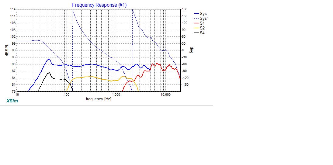

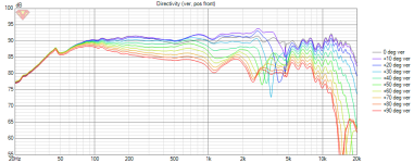

I know someone is going to have an absolute come apart with the subwoofer circuit. But doing that brought down that region, just not quite enough though. Have a look see. It also has that funny hook between 40 and 50 Hz. I was looking around the internet and from my understanding, baffle step compensation is based on the width of the front baffle. And, the resistor and inductor are supposed to have set values. But, when I tried that, the frequency responce didn't look good. So, I fiddled with it for a bit till I got to this point. Also I did another Wattage disappation graph to see what kind of trouble that would be.
I had the source set to 100 watts for a worst case scenario. But, all this figuring on my laptop may be for naught. Scottmoose threw out a whole mess of things that looked like French to me.
It's an artifact of how they took the measurements -in practice I doubt it's there as such.
Yes, for the first part, no for the second. Forget 'set values' -do what works. Most fixed figures are just keying off basic mathematical assumptions of a given set of dimensions; in practice, with real-world effects (diffraction kicking in, actual driver response) it usually isn't so pat as that alas -although that's also part of what makes it interesting / fun.

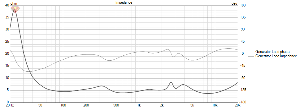

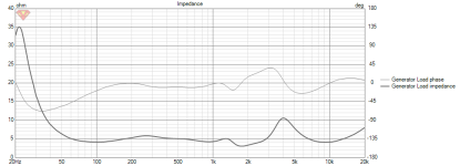

Short version is that somebody at Dayton has measured the bass units with a different method (drive level) to how the other units were done. 1m/w measurements are only comparable if all the drivers have the same coil impedance (Re), and preferably 8ohm. If they have different impedances, the output levels of the various drivers in practice will not be directly comparable. You need normalised 2.83v measurements (at a given distance, usually 1m) for that.

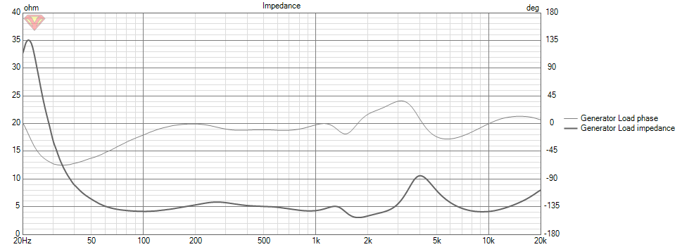

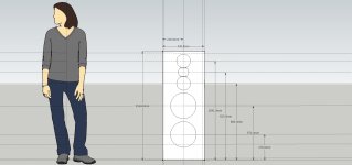

For whatever it's worth, you're crossing very low with those bass units, & even without an actual or a simulated box load, your low-pass filter is probably interacting with the driver's impedance rise at its Fs resonance (as in that ruddy great peak). Along with that ~170Hz crossover frequency is likely one reason you've got some titanic inductor sizes in there. In practice, I suspect you'll need to do a couple of things once you've got baffle-step simulated & spliced into both the FR and impedance responses: a slightly higher filter frequency, and probably a big LCR shunt across the driver to squash that low frequency impedance rise and ensure your filter works as intended. The values will still be large, but probably fewer in number. Conjecture as I'm writing on a laptop & not had chance to look at it properly -hopefully it could be avoided (no point in spending money if you don't have to) but I suspect something along those lines may end up useful, if you want to cross those woofers low. May. Possibly. Perhaps. Maybe. 😉

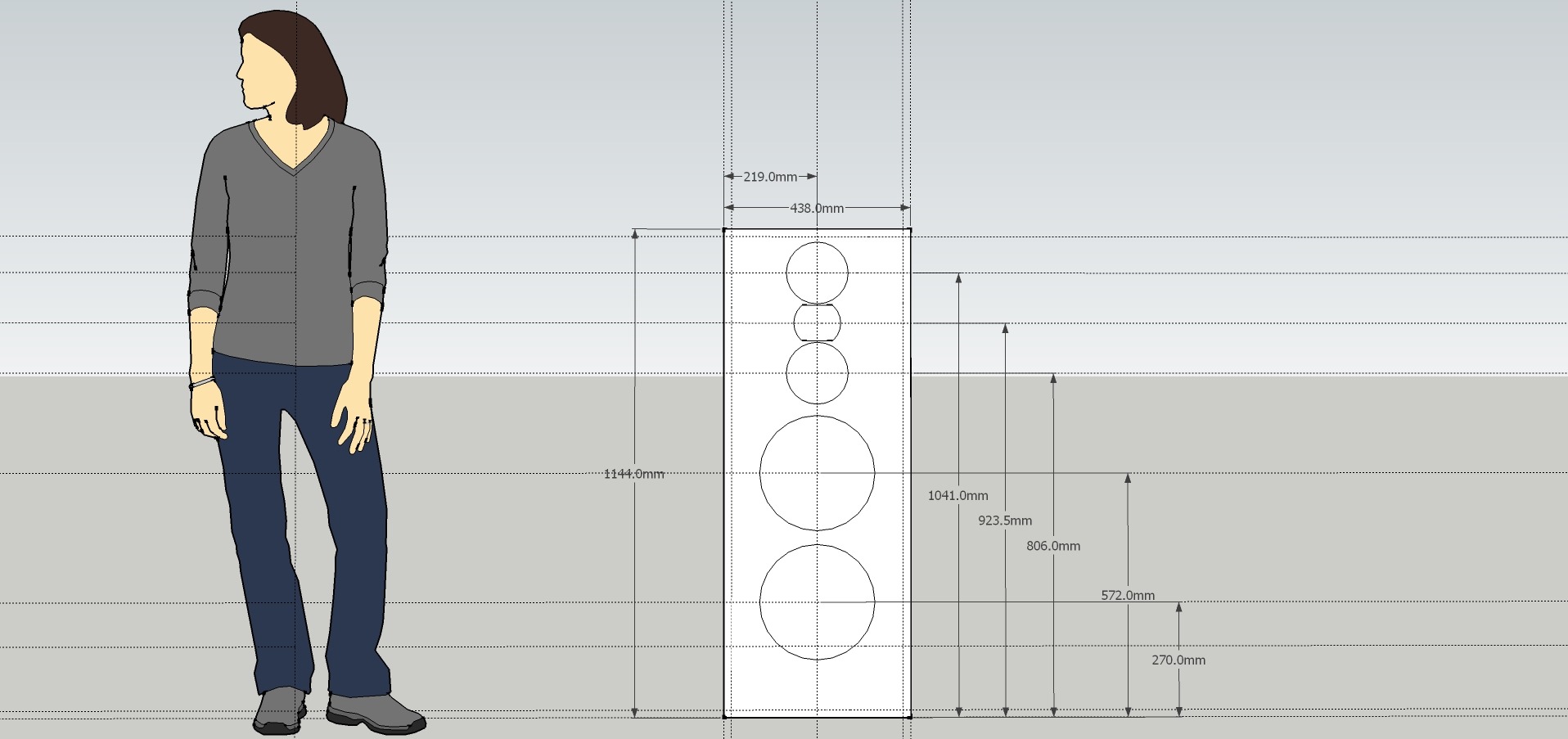

Think it only needs one mid
Did you sim the Baffle?

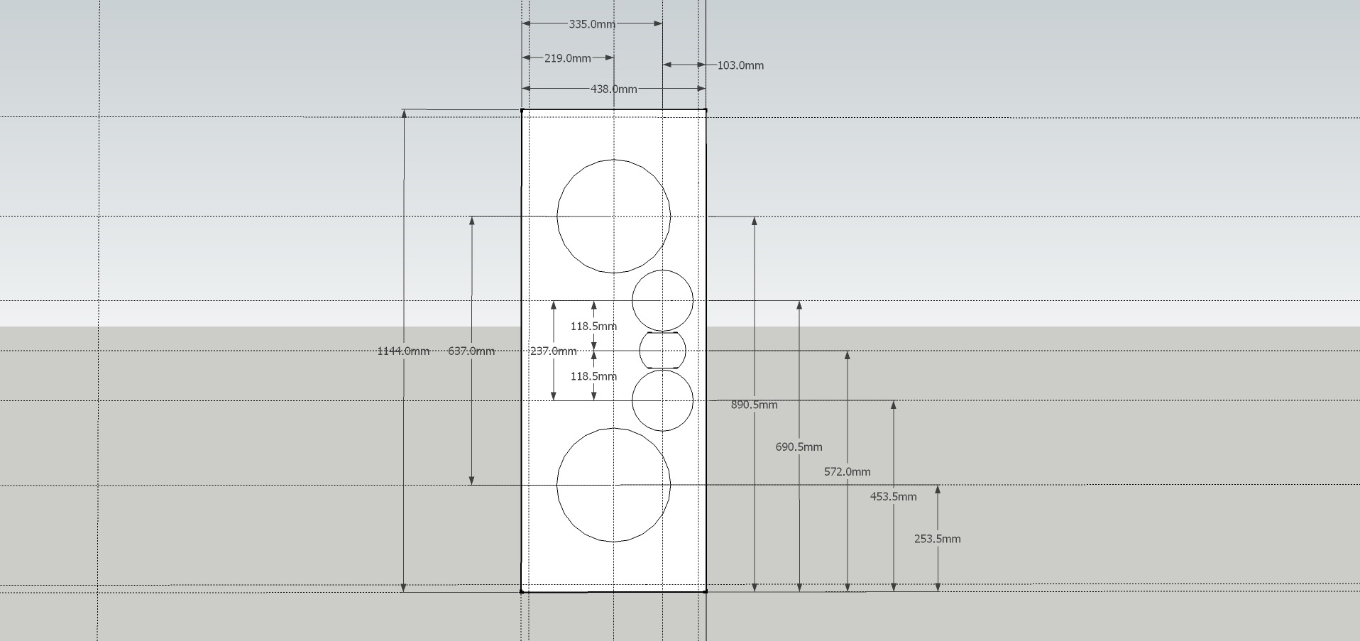

That is the spacing I used in the sketch up drawing.
Something I always do to make sure everything is good.
Unless you sim the baffle and center
to center spacing.
your shooting in the dark at how the
individual phase behaves. and where
actual baffle step is
I tried Appolito with drivers centered
and subs lower.
I could likely get rid of the series notch
if the mids were offset.
Was a idea, be easier with one mid.

@ridnroundlost - after baffle step losses you're around 86-88db system sensitivity. You won't need to pad the woofers with resistors. Also, you will only need a single midrange driver, and a single 8-ohm DC130B-8 will work.

I've had a 'quick' (not so very) & rough (very) look at a TMMWW configuration 'just because', assuming the listening axis on the upper mid; 86dB was my average, more or less as expected. Nothing fancy, just went with the pioneer's offset B2 for a nice power response at the expense of the usual even-order phase alignment; fixed L-pads on HF & mids for impedance & level matching, oversized zobel & an LCR on the box impedance peak (kept it sealed). Lots of much more refined options possible, just a check to see roughly what could be done with my simple hat on while keeping the woofer low pass down at ~250Hz. All looks viable enough, though chalk up another who'd probably stick with a single mid.
The twin would look good though. Pleasing symmetry. And lots of drivers. :devilr:
Just TMWW would likely work well.
Keeps the tweeter up higher.
Never liked dual mids. Makes vertical difficult.
Easier with dual 3" mids but the sensitivity is way too low.
With 4" more possible. And different tweet
To keep center to center tighter.

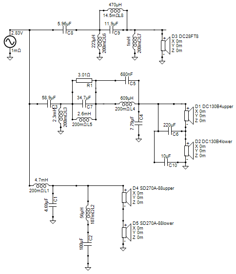

Yes > C8 @ 150mF did draw my attention, but I chose not to comment.
It is a rather unusual method of attenuation. I would use both mids @ equal drive (series) with a subtle Zobel R/C
and use simple two resistor attenuation.

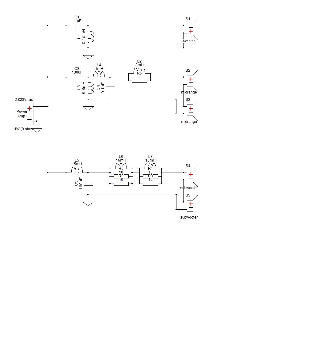

Although it would be hand drawn, I am thinking about presenting a simplified C/O network using standard values.
From what I have read here, the Dayton 10" subs wired as 2x 4 ohms have roughly the same sensitivity/output
as the Dayton tweeter (within a dB or two). However the Dayton mid/bass x2 are said to be of higher output.
So, with that I'm presenting a basic crossover network that has room for 'fun' tweaking.
There are two points I need to make regarding the design >
1. The resistors Rx & Ry are not only the means of mid/bass attenuation, but also a way to fine-tune response.
2. The reason I have not shown the polarity/phase of the tweeter is because I always determine this by ear,
by sitting in my listening position and using a 'phase flip/flop extension-lead switch' so as to make no mistake.
I am hoping that there are some 'smart cookies' out there to further elaborate on Rx & Ry.
*(if there is a way to import the values into simulation software, I would love to see the results)

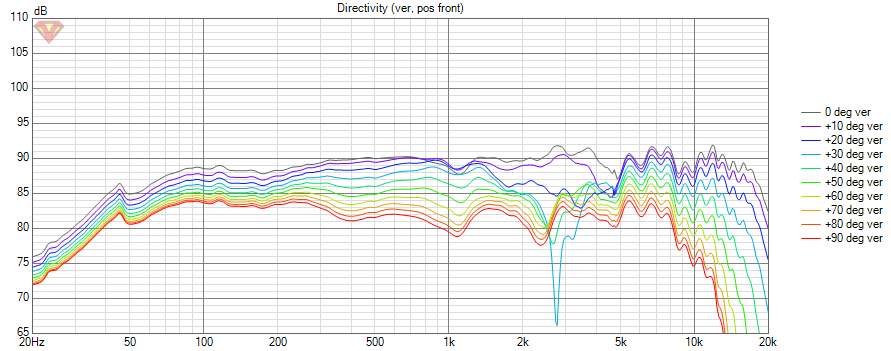

Assuming the idea would be to keep the listening position up high.
And going back too MTMWW format.
Most the issues with baffle step will be the mids
The visual aspect for most assume " centered" drivers which will increase
the baffle step.
Offset drivers would flatten the response, but might not like like the appearance.
Depends what the designer would want visual wise.
Keep in mind center to center spacing for a 5 1/4 mid will behave similar to a 10"
driver on the vertical. With MTM closer to 11"
