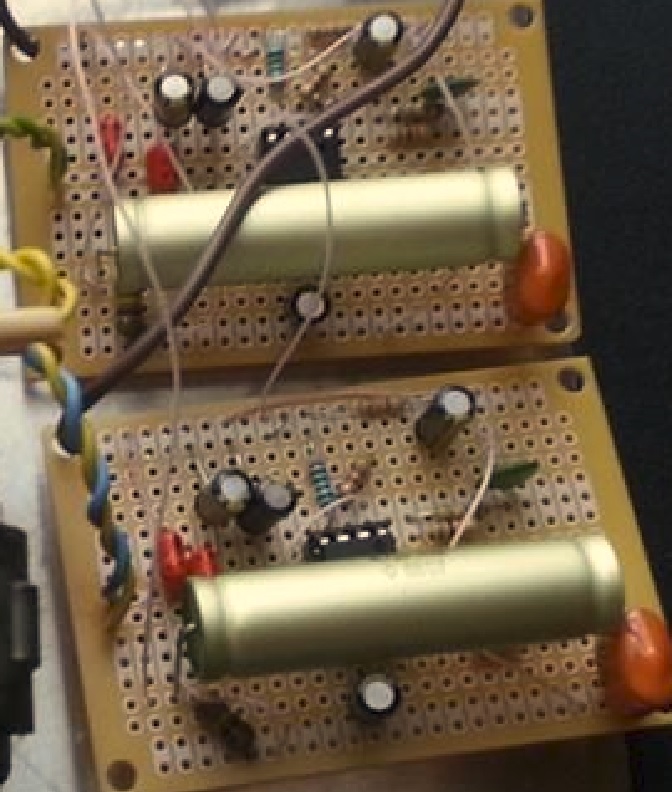

I'm reading this differently, constant whistling that's more noticeable when music's not playing.
Given the pic of the PCB with the distant hf and electrolytic bypass caps, I went with my own experience with opamp oscillation. Get the hf caps right next to the opamp and the electros close behind.

I've also noticed that there is this weird noise in the output sometimes that sounds almost like wind in a microphone. Can't really notice it with music playing but with the tonearm up, it's pretty apparent.

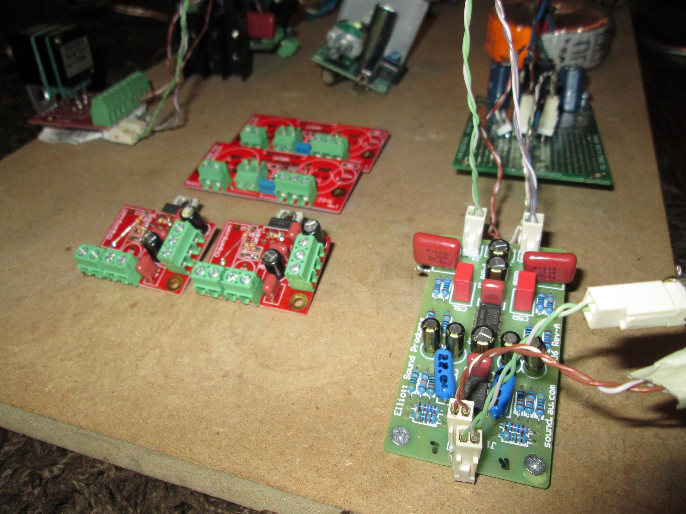

I'll relocate filter caps tomorrow and we'll see what happens.
Meanwhile, I've been spending a lot of time with vinyl and the AT95E is getting it's burn-in and I really like how this cart sounds with the Elliot 06 🙂
Tomorrow I might drop by the electronics store and pick up a few different op-amps to roll.
Also the 470n caps did help. When I tap my desk with the turntable on it, a low frequency "thump" can still be heard, but the woofers are not exactly flapping around in the wind anymore.

By the way, I have an Elliott P06 which has seen some use (I purchased Rod's board) and I quite like it. I also noticed a fair bit of cone movement and expected if I used it in the future to need some sort of filter, as indicated above and by Mr Elliott.

Can you show us the bottom so we can see the gnd?
The opamps may be oscillating for two main reasons.
Opamp PS
Solder the hf ps bypass caps (~100nF) directly to the socket pins and gnd as short as possible.
Put the lf ps bypass caps (~100uF, electros) close and as short as possible to gnd.
Feedback network
Solder the feedback res (180k, 100k) directly to the socket pins and as short as possible. (You could even go Surface Mount, a 1206 or 805 will fit right between adjacent pins)
Solder the other feedback res (4.7k, 2.7k) directly to the socket pins, then directly to the fb electros (22uF) and then directly to gnd (again all leads as short as possible.)
Arrange the rest of the parts around this, again as close and short as possible.
That should fix any tendencies towards oscillation.
