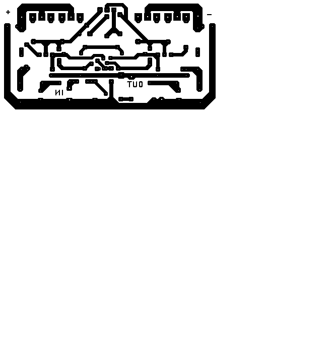

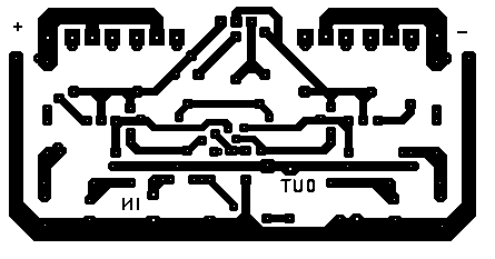

Hello
Here is my amplifier PC board lay out .These great .What I posted before you can use it but there is a small mistake . Two places 2 resistors cross each other in two places .
When I design the PC board I thought I will use two resistor on the bottom of the PC board .I forget the emitter resistors are already there .
Of course the PC board was design to the original signal transistor BC416C & 416C.
I will use BC550C & BC560C so please pay attention to the signal transistor different pin out .
Now the lay out perfect .
If you use BC414C & BC416C you just go on and use the board how it is .
If you use BC560C & BC550C please switch the lead of the transistor to feet .
Here is the correct PC layout , If you are interested I can write the parts next to the marks so you can easily build the amp if you are interested .
Please let me know !
Greets
Here is the corect layout !

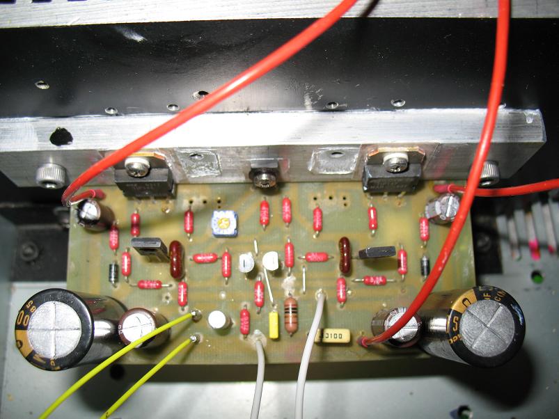

Latest tests
Hello
Here is the amp with the last mods .Now it really sound great.:)
Carlos if you willing to run a sim. test please do it now .
I change the power transistors , I use only one pair .
With two pair it does not sound great , the mids are a bit muddy and I missed the bass . The reason I don't know how to much darlingtons ..With unmatched darlingtons better to use one pair!
Now with one pair power darlington the sound opened up , more details the bass is punchy.
I change the original power transistors to TIP 142 & TIP147 from ST micro.
Also I change the signal BJT to JFet , I use 2SJ74BL & 2SK170BL.
Right now each side has different driver one side MJ340 & MJ350 sound nice but I have offset problem because the huge hFE difference between the PNP & NPN .
Another side I use Toshiba 2SA968 & 2SC2238 .These has less offset problem and the sound open up even more .
At the near future I will try driver from Hitachi 2SB649 & 2SD669 , I heard these are great transistors .
I can fix the offset problem 200mV .Choosing the right J fet combination or increase or decrease the 100K resistor value .Just a bit .
It really sound nice , I like it a lot . But still I want to do more test .First because no longer available the orig higher power BDW83C & BDW84C .
I'm planing to give a try to MJ11015 & MJ11016 .Al do with the TIP sound great .I'm satisfied with .
Here is the new layout . I do not have silkscreen (for the parts) I made the layout with the paint program.But if someone interested I can help , I will use color codes .
The amp has real tube like sound but better bass ,strong punchy bass not rounded like many tube amp bass .
It is very sensitive to each part , wires etc .
I use 40V PS and 120mA bias . My heat sink a bit small for higher bias .

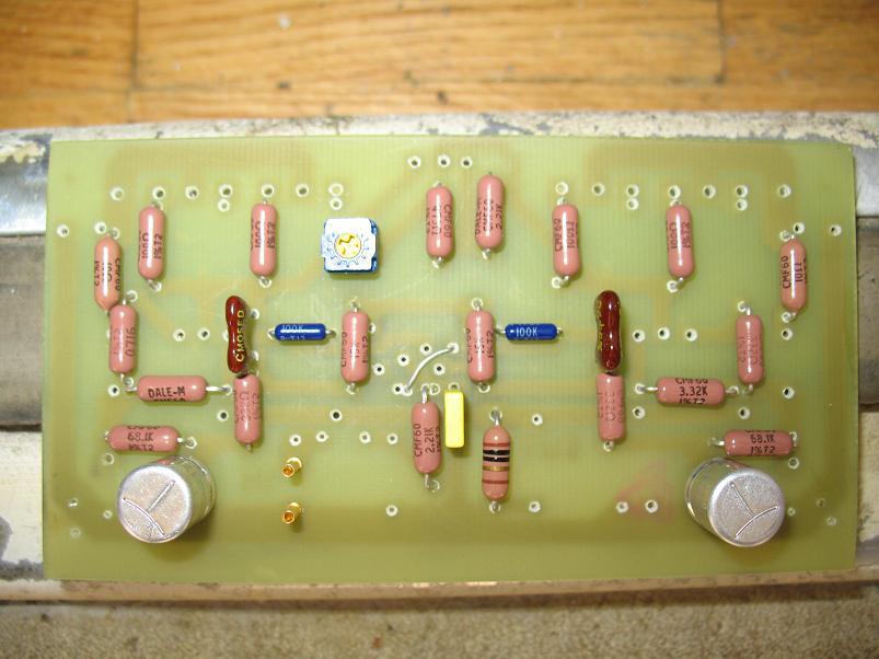

Hello
Here is the color coded PC board if someone would like to give a try .
Don't forget the two big emitter resistor those goes under the PC board .
Red transistors , J Fet (you can use BC550C/560C) to
Green resistors
Blue capacitors
Yellow trim pot
Pink diodes
Brown jumpers 3 of them
Sorry I do not have silkscreen but if you have any question I do my best to answer it .:)

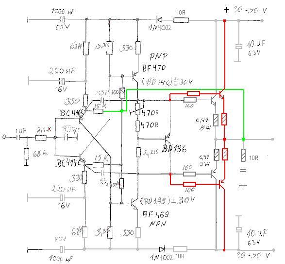

At some point, try using 2 pair again in your amp. If you use R22 resistors, you may find that it sounds far more dynamic with more punch. Going up in emitter resistance caused the sound you didn't like. This design is very sensitive to emitter resistance, and especially to the load impedance.
Can you do a rough schematic that shows exactly how your 4 transistor output was set up please?
The amp never ever clipped for me ???
Yes, that is to be expected. This design as it sits runs out of current at some point. The outputs can not be properly driven, so the current drops as the voltage across the emitter resistor and E-B junction rises in the output stage.
Imagine a positive going waveform. As the E of Q1 goes high, following the base connection, the base of Q3 is also raised in voltage. Both the emitter of Q1 and Q3 are tied to their base voltages by Vbe. That means that the emitter of Q3 is related to the base of Q1 closely as the Vbe drops are similar (but not equal). As current flows through Q3 a voltage drop across P1 develops. This subtracts directly from the E-B voltage across Q3, so the base drive is reduced as the current increases. Now also look at the source of the current used to run Q3. That would be R5, a resistor. As your output voltage climbs, the current flowing through R5 is reduced - right when you need it the most! Use a CCS in those two locations (positive and negative). That will maintain the available current as your output voltage climbs. What you really need to do is somehow modulate the current into the Q1 emitter - Q3 base circuit so it increases with increasing input signal voltage. Positive feedback. You think it sounds clear now? Just you wait until these things are looked after.
The way this circuit operates is a little different from the classic amplifier driver-output stage. The current supplied to Q3 via R5 is shared with Q1 (or stolen if you'd rather). Thermally coupling Q1 to Q3 and Q2 to Q4 creates some bias compensation. Not enough though, install some kind of bias circuit in there that becomes active as the output stage warms up.
This is one amp design I really suggest you don;t leave running all the time. Not unless you can create a very stable bias current. Also, the explanation above should explain why when you increased the emitter resistor, the sound quality suffered. If anything, you need to avoid creating voltage drops in the Q3-Q4 emitter circuits. You have to achieve this goal while trying to maintain good bias current control. These are opposing requirements, so added circuitry will probably be needed. Done properly, adding these extra parts will enhance the sound quality, not reduce it.
This is a really good circuit to study. The low level detail is amazingly good.
-Chris

Hello
Here is the schematic with the two pair power transistor .
I cleaned up a bit so you can see it better .
The red is the second pair transistor with the added resistors
The green is the feedback, just I made it clearer a bit.
I wait on your opinion !
Greetings
Gabor
