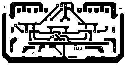

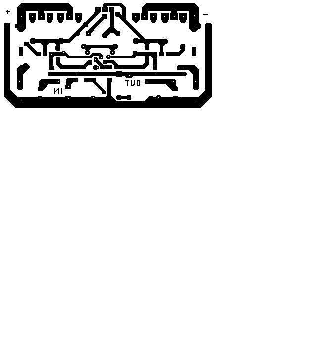

I post the lay out but if you want to use it you have to figure out the parts were they go .
I made the layout with out any software .
Greets

Hello
The schematic is at the first post .
There is a mistake , the input resister 2.2k not 2.2R
And you can use at the input up to 4.7uF capacitor .
Regards

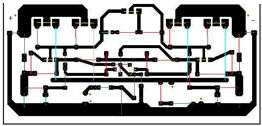

as far
as i can understand there is 4 output transistors in the pcb ... did you check if this is working properly and has no oscilation and so on ????
cause if you dont then you are the first one that parallel 4 output transitors of this type
the other one who did it was the nelson pass with the A40 boards ....
keep us posted about the progres

Hello
Yes I did and works better than only one pair .
Better bass , fuller mid range .More control over the speakers
It works much better , the designer told me to use 2 pair instead one pair .
I used over 50V power supply , I had that transformer in hand and it was a bit to much for 1pair darlingtons .
After I used two pairs and it sounded much better , no problem at all .
Greets

can we have
scope readings of this device ????
tip142-147 are famous for instability
also a complete new schematic will be also usefull ////
i wonder what resisitnce you have in the out of every transistor ???? NP used 0.68 per device
then again 50 volts rails ( dc i presume ) will produce easily 120w so there is a question of soa , thermal stability . and generaly iv never seen that before and if it works it will be very fine to see the complete thing ....
120w @8R ...and then how much in 4 ???? or 4 ohms is a total NO GO ????
seen similar application before but VI limiters for base limiting was a must
i trully hope that really works very fine but since i ve never seen that before i am a bit scpetic about it
regards sakis

Hello The schematic is at the first post .
Hi Gabor,
Sorry if i missed something, it appears your amp's end is showing driver and doesnt have output tranny?
mannycc
Of course it has
BDW83C/84C
BDW93C/94C etc
I didn't use scope I still I don't know how to use it .
But when the amp was modified the guy who gave me the schematic he tested with scope and he said it is fine .

That is why I needed to double the power transistors .
50V is a bit to high .
But the driver only set up to give you 100W in 4Ohms .
Now if I found the stronger BDW83C/84C with two pair I will use 56V power supply .
If I get only the BDW83C/94C I will use max 40V power supp.
Greets

ok
got the message ....
i dont want to dissapoint you but i think you are constructing a ticking bomb ....especially with 56 volt rails ....
please do your shelf a favour and install a protection device between the bomb and the speakers
it might work but if you try to play at 100% of power you will loose a pair of speakers

Hello
I used these amp successful a long period before I immigrated to Canada .
My fried still use it after 20 years !
That is your opinion these is a bomb .
Do you think I would suffer so much to find the parts and design the PC boards if I did not had these amp , or if did not have the amp a excellent sound .
I have many other amps at home like Aleph X , ProFet , DIY Naim ,
and I working on the Krell KSA 50 and many another project .
These I want to build again because it was my first DIT amp and believe me is a great amp .
My friend bias the amp 400mA and after 20 years still working well .
I sent to him a Symasym and he prefer these amp over the Symasym .
He not even kept the Symasym .
So these are the facts .
Of course if I use 56V rail I do not bias in to 400mA . If I use 40V yes I will do that with proper heat sink .
I also had Symasym , M Hiraga , SEWA and I didn't kept them .
These amp was tested with scope also but not by me , I don't have scope .But when we did doubled the power transistors it was tested . Everything was fine .
Greets

this is just an opinion
this is just an opinion please dont see it as apersonal attck cause its not
this ia a very long issue to talk still ....i havent seen any of these amps equped with this type of transitors working properly
add to this that you never scoped the amp
but to all this there is something forgiving ....there might be a posibilty that the amp is more stable with a lot of bias than it is with less .... this is just a hinch since this the way A40 from NP is working
trully i havent test none to be able to tell you ...i have a prototype of A40 ready with the original boards but since i have no good quality semis its still pending ...
if you dont mind sent me a complete schematic and pcb lay out i will construct and scope it very carefully for you
then you may keep the readings for feature reference

Yes now I see what you think
I do not push the amp more than 20W power .
I listen JAZZ , Classical . etc
These amp not for disco , I build these amp for the quality !
With higher voltage for some reason it has much better sound .Only that is why I want to use 56V rail . At first I had 51V rail with one pair power transistor and small heat sink . So yes it will cook the transistors with small heat sink when you start to push it . It happaned with me and took my woofer out . After we doubled the power transistors I had no more problem with it of course I used 5x bigger heat sink than at the first time .
I even built 8W amp the Monster Hiraga and it had power more than enough .
Regards

The schematic you find on the first page .
The lay out at the third page , I do not have the layout with the parts since I made the layout by the paint program on my computer . With out any software .
I have a lay out were the parts marked with different colored lines but after redesigned the layout to be smaller so I can use even with BDW93C/94C in case if I get only those .
I attach that layout but a bit different .
The emitter resistors they will go to the bottom of the PC boars after everything is already mounted it to the boars .
Regards
Regards
