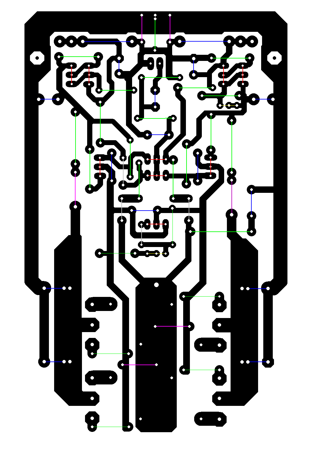

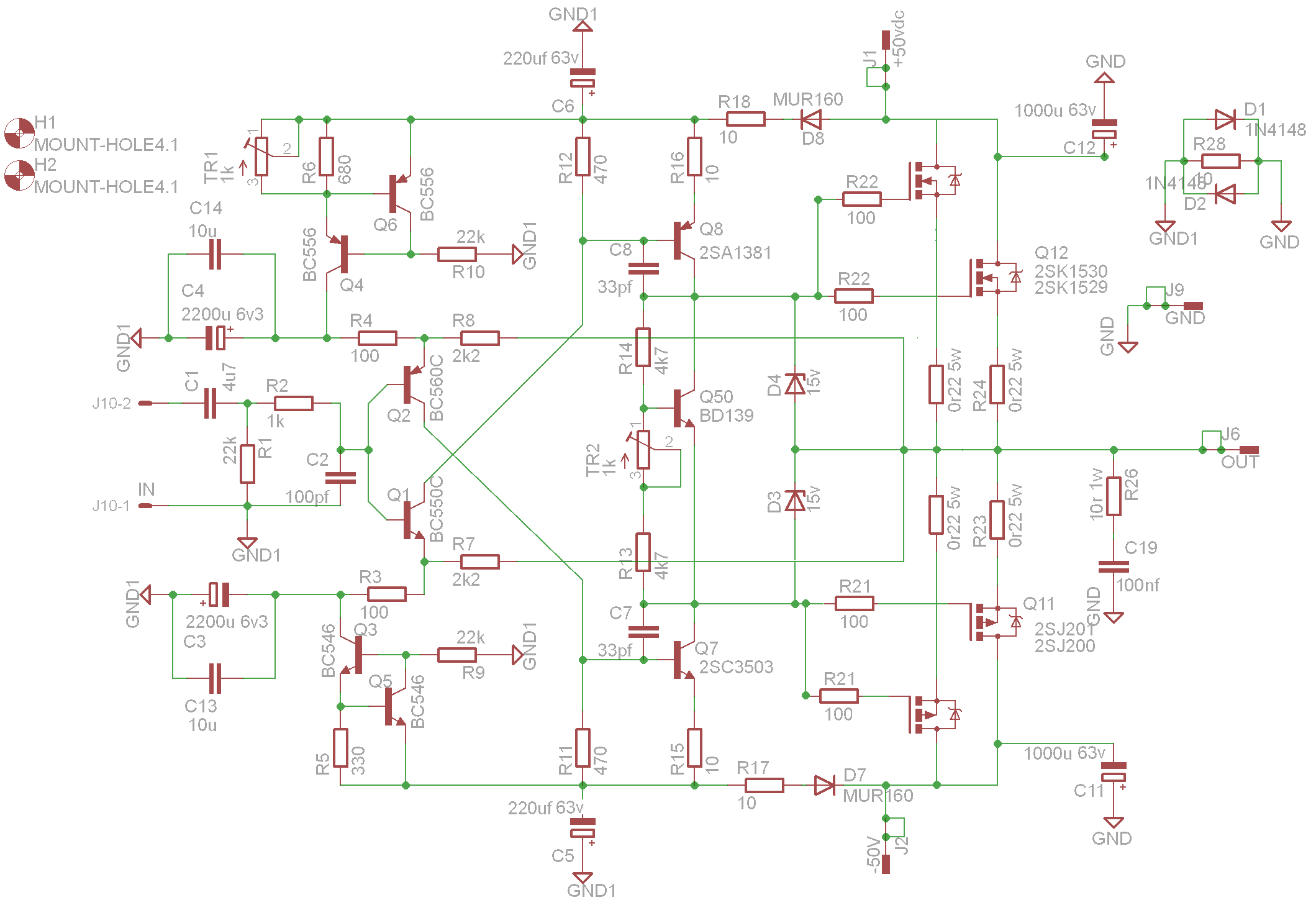

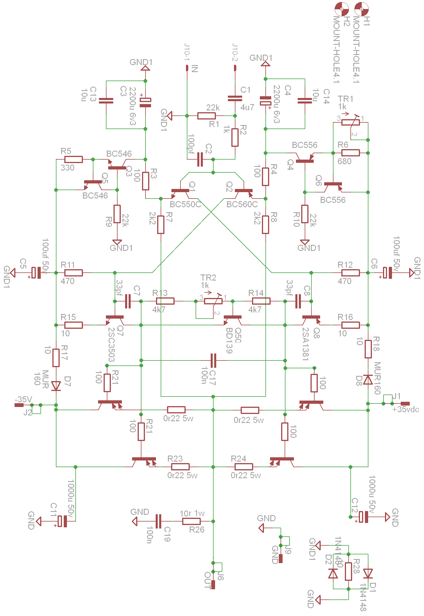

Today just finished the layout for the 2 pair power darlington but we can use the same layout for Toshiba 2SK1529/30 & 2SJ200/201 mosfet.
Between the two has only minimal difference so the same layout good for both!!!😀
The mosfet has 2X15 diode no 100nF cap the darlington has the 100nF cap and no diodes.
You can use TIP142/147 or BDW83C/84C if you can find the second one.
I want to test some Sanken darlington in these circuit, those parts was mentioned by me a couple page back.
The size of the layout 80X127mm.
The PS rating with darlington 40-45V with the 2 pairs , with the Toshiba you can go up to 50-55V.
Adequate heatsinking must, please do not under estimate the size of the heatsink.
These was the last layout for these topology for now, I think is time to build the amp...
The layout was drawn by hand so I do not have silk screen, I use color codded lines for the parts
These is a simple amplifier with few parts so finding out parts location must be not a problem..
Green = resistors
Blue = capacitors
Red = Semiconductors
Grey = Jumpers
Purple = Diodes
Any question you have please ask.😀
Greetings Gabor
