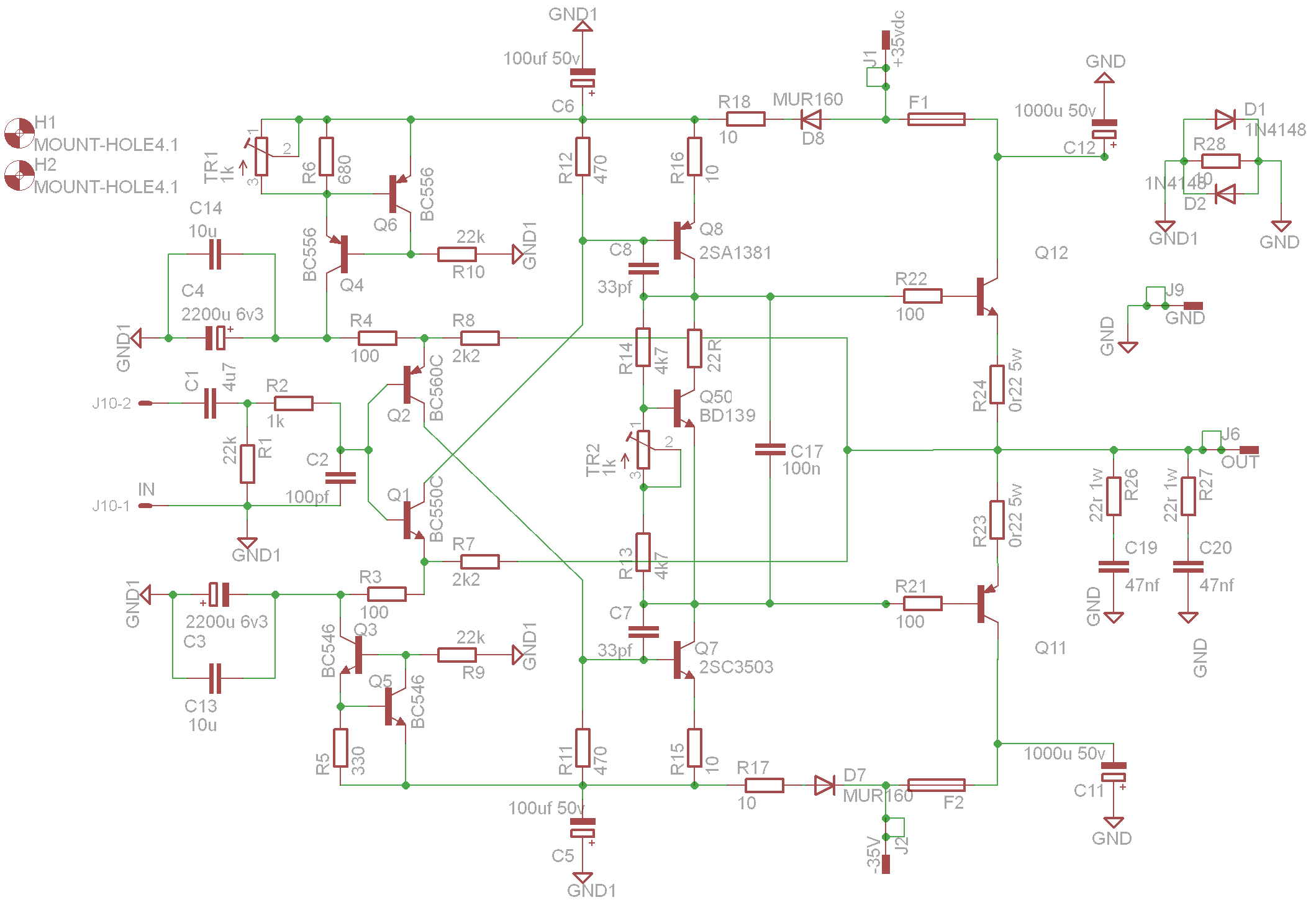

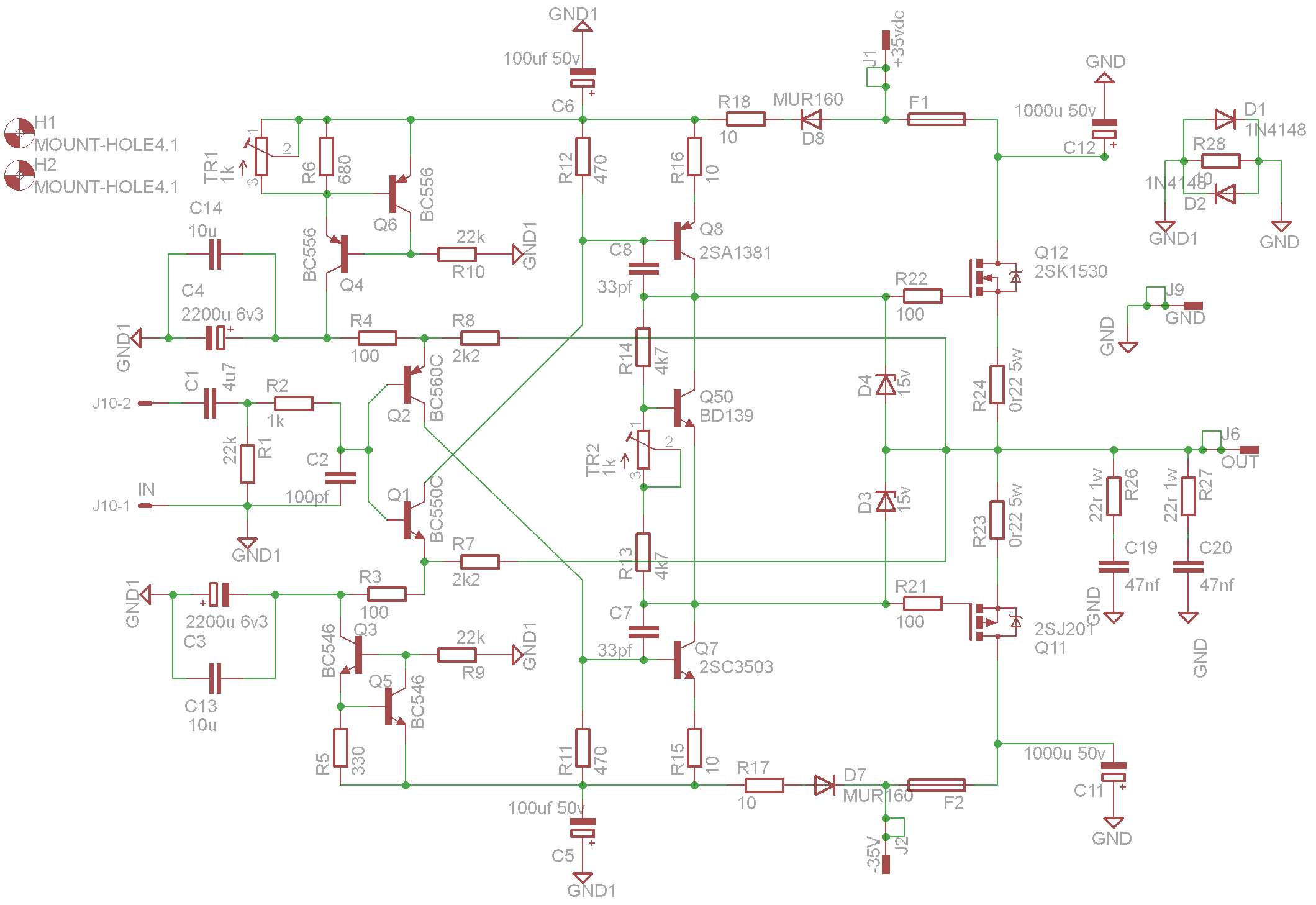

If you want to test the Toshiba mosfet here is the circuit, all do it was tested in the same circuit where the Sanken BJT was used. Since the layout was ready for the discrete darlington (Sanken or other power BJT) borys just replaced with these Toshiba
The result was excellent!
I think for these mosfet like to the LATfet and HEXfet enough a simple VAS stage so these was modified according to that.

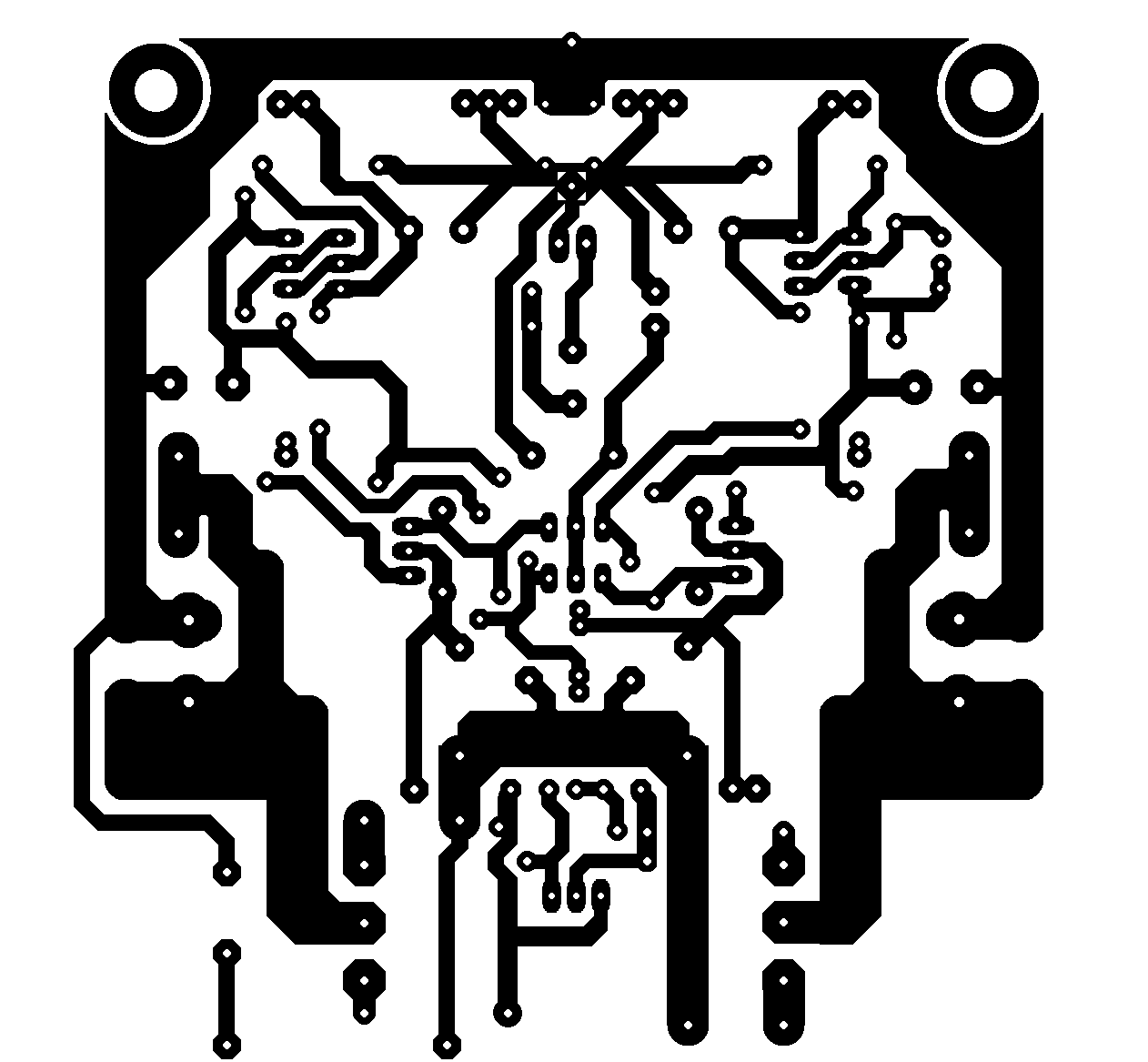

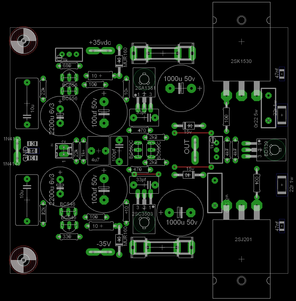

These layout with a small change can be used for HEXfet, Darlington and for Toshiba mosfet to.
I post the layout now, there is some minor mode since the designer use 1/4W resistor.
Also I modded so I can use the power darlingtons and I hate fuse on PC boards..
The layout must be open with the paint program, print setup 34% and that is the correct size.

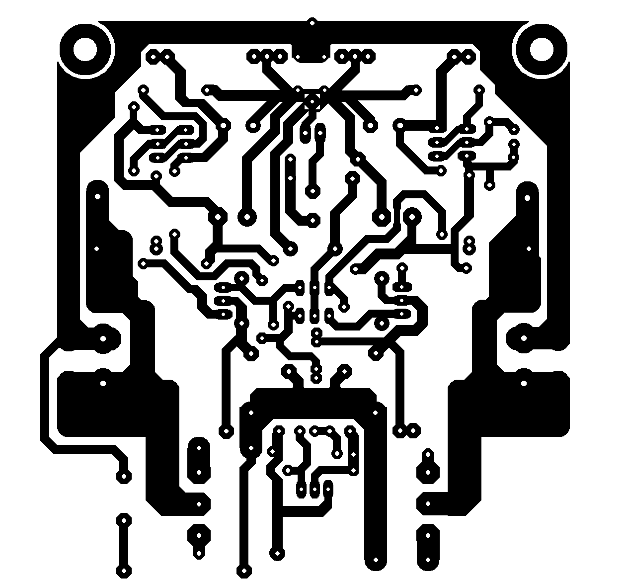

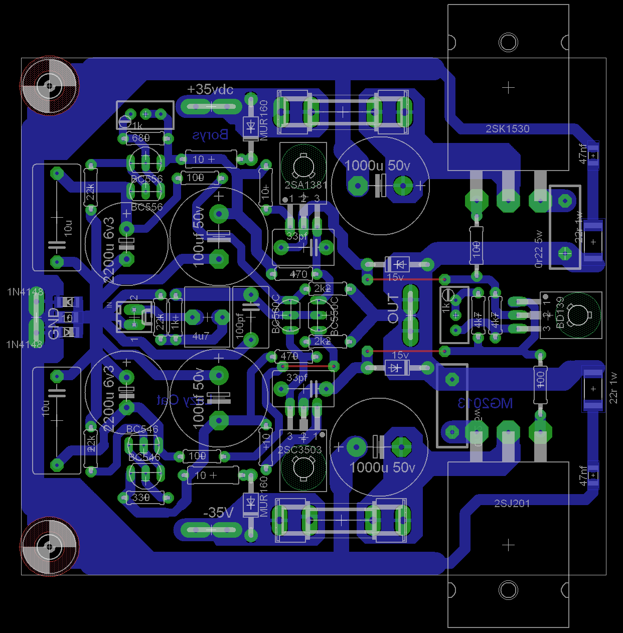

I went over on the layout and found a small error which was fixed and the two smoothing capacitor was disconnected from the signal ground and connected to the right place in these case to the main ground.
Now these layout is for one pair power darlington or one pair Toshiba mosfet.
See the circuit for the difference between the two power stage.
If you use Toshiba mosfet max rail voltage 40V in Class A/B
If you use darlington like BDW83C/84C or similar power rate max rail voltage 36V at 100mA bias.
Please do not exide the rail voltage or the bias under any circumstances.
It will blow up the one pair of the mentioned darlington can not be pushed higher.
If you need more power please double the output (must be matched).
The layout need to be tested, so if you go on and build it please take the time to check the circuit before you power it up.
After with the CCS test if the result is good or better than my orig I will make layout for two pair darlington or Toshiba mosfet.
