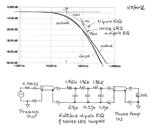

Passive RC eq
Ive been researching the Phoenix/Orion speakers and then came upon this discussion and it prompted me into action. Im going to build a small dipole speaker that uses 2 Pioneer 10" woofers ($6 ea.@PE) and a fostex 103 or 85 fullrange. I realize the woofers will have limited SPL but I want a taste of all dipole before spending big $$$. I would like to use the below passive RC eq/xo that S. Linkwitz shows to use w/ 12" drivers but I would like to raise the xo point from 100 to 140 or higher. I have no idea what components do what or which to change. Anyone using this setup or know which components relate to the xo point?
thx amt
I recommend you just go to diysubwoofer.org to get Brian's dipole.xls spreadsheet.
Just punch in your driver parameters and baffle size into that, and then play with xover point and order to fine tune your response. It'll plot your reponse for you as you play with the parameters.
Then just find some PLLXO design equations, like at t-linespeakers.org, and you're all set.

Leadbelly, Thanks for the advise but I wasnt able to figure out how the spreadsheet actually calculates the circuit. It gives me a Fequal that is apparantly the freq were the eq is applied but I have no clue as to what that is suppose to be. I saw nothing that allows for a xo point or graphing of the response. On the T-line site, the circuit for the xo is shown but adding in "eq" boost is not an option/ discussed. Am I missing something. I would use Mr. Linkwitz's formulas if I were far more mathmatically addept.
No, you certainly understand the the material as such. What I am saying is tweak the reponse of the dipole in the spreadsheet using ONLY the low pass filter. See how nice you can get the sub response, and at what point the LP point works out to to get a smooth response from the sub. If your FE103 can handle that as its HP point, you don't need the EQ, and you'll have less signal loss in the passive circuit.
