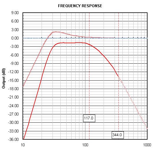

I'm not an entirely reasonable chap, so I decided I wanted an OB with a lower cutoff of 30Hz. Soon thereafter, I stumbled onto the hideously named Madison Executioner 21--Fs: 28, Qts: 1.17, Sd: 298 sq. in. ( :bigeyes: ) (These specs are from the sheet that came with the drivers and differ some from the specs published online).
When I used Brian Steele's OB spreadsheet to simulate these on 3'x4' baffles each driven by the cheap ($75ea.) PE plate amp with 6dB @ 30Hz boost built in, I found a match made in heaven--flat down to near 30Hz with no additional EQ. (the sim below has a 2nd-order Butterworth lowpass at 110Hz.) The combo was easy to do, sounds fantastic, and didn't break the bank.

If one is to be quoting Mr. Linkwitz, they should also be using his dipole models. The only variables determining excursion limited SPL are Dipole size, Xmax and Sd. Qts and active equalization help to determine frequency response but not max SPL.
The 21" Madison Executioner dipole in a 3' by 4' open baffle is an interesting design. According to the Linkwitz dipole model, expect excursion limited max SPL of about 101dB at 30hz, 3dB more than my current IB15 in a 24" H baffle. The ultimate variation of this design would be to use the 21" ExecutionerX, with twice the Xmax of the Executioner, resulting in 6dB higher max SPL at low frequencies. My planned dual IB15 dipole will have 107dB max SPL at 30hz, exceeding the THX specification.
I look forward to seeing pictures and measurements posted for the completed Executioner dipole.
Actually, if one is to use SL's methods properly, published Xmax is irrelevant. What is important is how much "real" Xmax you can use before distortion and/or chuffing noise become audible. That's why a single 15" IB driver (similar to the rest of the DVC, Tempest, Shiva family OEM'd from Eminence) doesn't "outperform" a pair of Orions even though, at first glance, it might appear that way on paper. Even the 15" Titanic Mk3 doesn't do it. 😉

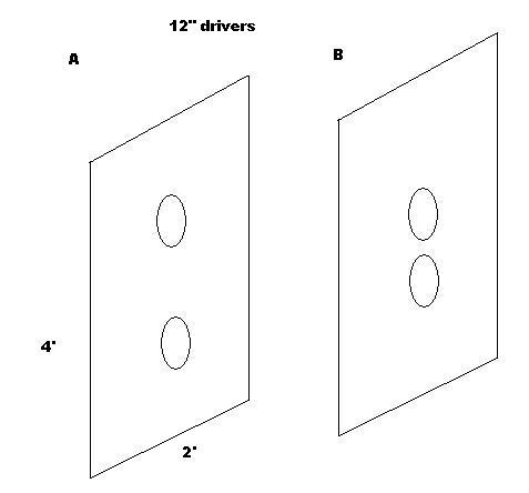

Assuming this is just for bass, I wouldn't do either for a baffle like that. Take advantage of the free ride of the floor. Turn it with the long edge on the floor and mount them as close together as possible and as close to the floor as possible. Don't forget to mount them facing opposite directions and wire out of phase to get the distortion reduction benefit of push/pull.
Is this just a test baffle? If it is, take driver cutout placement into consideration, so you can reuse them in your final design.
I should have mentioned that the 48" baffle is the middle plane of the H frame just like CHOPS dipole subwoofers. It will be powered by 4 channel GC, one channel per driver from active crossover....initial thought from 80-100hz down push pull.
It is not going to be a test baffle if sounds good...
So should I still mount them as close together as possible?
Chris
Why so big then? I'd have some concern about cavity resonance with that size unless the wrap around pieces aren't very deep. If it only needs to go up to 100, I'd do a W baffle. If it's good enough for SL, it's good enough for me. The one I made is only 15"x15"x19"deep using 12's and it does well into the 30's with no EQ and that's with cheap drivers of unknown specs.
If it's for something like a false stage for an HT setup, I understand the design, but I'd still lay it on its side and put them close together at the bottom. Did you have some special use in mind in addition to being a sub?
It is just a 24"x24"x48" H frame. It is not for HT. It will be two subwoofers for stereo use only. I am only using 2 way out of a 3 way active crossover at the moment. With the extra 4 channel GC I am going to try dipole subs and relief the Jordon JX150 seal boxes from either 80hz or 100hz down or even 60hz down since the crossover can adjust the low pass with a dial. I am more or less copying CHOPS with same size H frame but different and smaller drivers.
Chris

If you've got the room and don't care about the size, then go for it. One question though, what drivers are you using? If they are very high Qts then you could get a big bump in response at Fs and want to be more scientific about your baffle dimensions to make it work to your advantage. If they are low Qts drivers then you'll need to EQ to force them to make bass in the open.
Qts is low

I will most likely place it with your suggested way the long side on the floor and use it as a stand for the JX150 100litre seal box, so that I should still have around 5 foot space between them for access to the dvd player and preamp..
Chris
Speaker stands is the ideal location, but it makes a W baffle even more desireable because of the limited cabinet vibration. In a W config the mechanical energy of the drivers offset each other. Then you'll have a nice small stand for putting the Jordans on a smaller baffle with some small wings for support and a little extra baffle width. Dipole bass is great, but dipole midrange is to die for.
Before you build anything, take a 4ftx4ft or 3ftx4ft piece. Mount the 2 woofers in the bottom and one of the Jordans a little off center. Is likely to turn into your whole speaker at least until you decide to fancy up your baffle.
