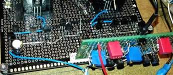

Ah, I'll have to re-work the DC-servo board slightly then as I made the 1Meg resistors swappable and the 470K resistors soldered in place.
Soldered the wires from the PCB, but not yet to the DC-servo board.

Tried with the R-Core in the JHL clone chassis and LT1083 vregs.
With the changes made to the jfet buffer I got around 1.4vdc offset, slightly better than before. I had not put the suggested 10K to GND as suggested though as I ran out of time for diy.
Also noted that on the right channel, the CCS's got hot, but on the left channel the non-ccs BJT's got very hot.

So on the FET buffer... if there is a difference in temp between the two channels then that can only be one (or combination) of two things. The CCS currents are unequally... which is unlikely if the correct current defining resistors are used, and secondly, the DC voltages are different perhaps due to imbalance in the FET's. That's more likely, and a small difference in voltage across one or other of the CCS transistors would appear to make it run hotter (and its partner cooler) than the ones in the other channel.
I'll re-work that part of the board, the CCS's.
The strange thing is that the CCS to the far left in the pic is the one getting hot for that channel, and none of the CCS's on the other channel but the two BJT's between them. (As seen in the pic in my previous post)

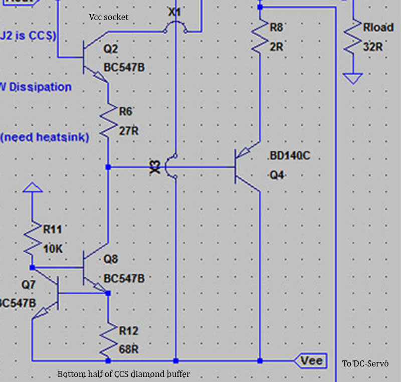

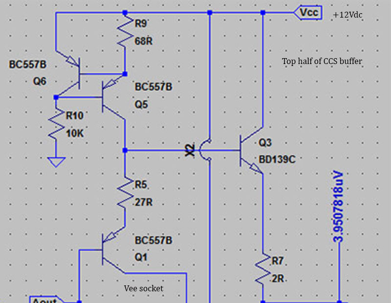

Probably best to show it as a circuit diagram really, and point out 'this ones hot', 'this one is cold' etc together with voltage readings ... circuits make sense 🙂, pictures much less so because you are the only familiar with the layout 😛
Very true, my bad 😱

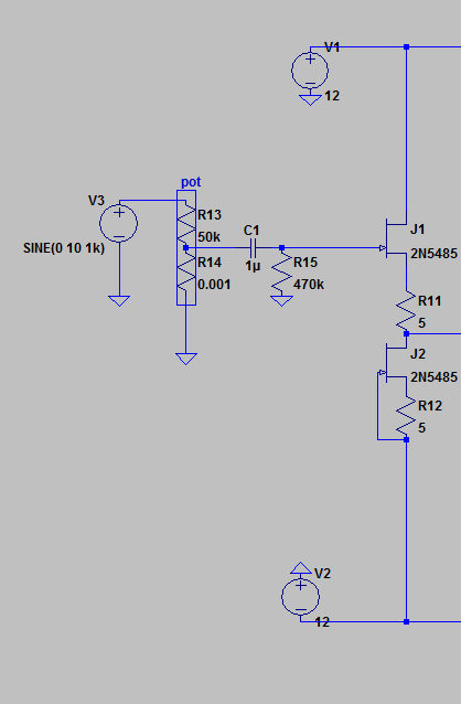

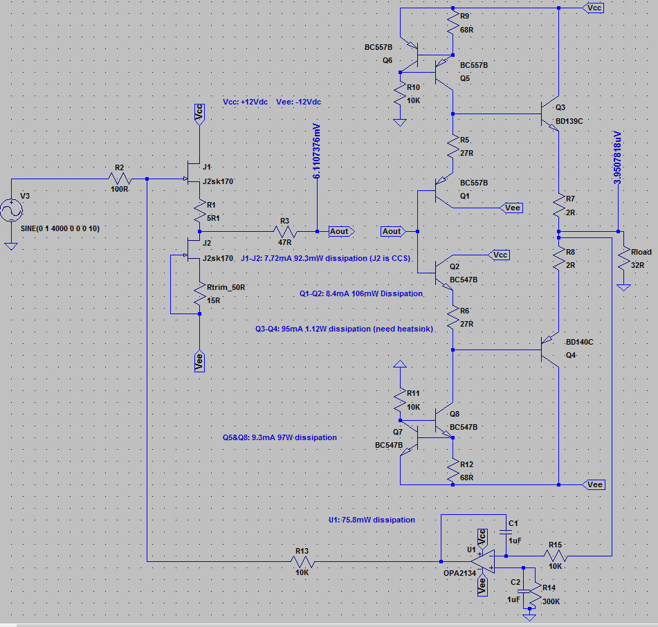

I'm suddenly not sure about the value of the resistors used between 1uF and the 2SK170's (shown as other fets in schem), and the vol-pot is not attached to the circuit yet.
The DC-Servo is removed from the circuit for now, and was incorrect anyway IIRC.
Soo, for one channel the top CCS (Q5, Q6)gets warm, not alarmingly so though.
For the other channel Q1 and Q2 gets HOT, barely able to touch them after <5min of being powered on.
I've only tested the circuit with +/-12Vdc so far.

Q5/Q6 and Q7/Q8 should be equally hot as long as the following conditions apply.
1/ The 68 ohms that define the currents are correct and equal in both upper and lower CSS.
2/ The voltage on Q5 and Q8 collectors should be equal and 'opposite'. If you have significant DC offset (the output is not at zero) then that means Q5 and Q8 will have different voltages across E-C. Although the currents should be equal, the one with the highest differential across it will run hottest.
Everything is about symmetry on this type of circuit. The base current into Q3 and Q4 should be approximately equal and be a very small percentage of the current available from Q5 and Q6.
If you remove the final output transistors Q3 and Q4 then the circuit should settle to a symmetrical condition with equal dissipation in upper and lower halves. Once you get an imbalance of more than a couple of volts then that starts to become noticeable in temperature changes between upper and lower halves.
If the two channels are very different in terms of temperatures then you need to go back to the basics and measure the current flow in each CSS and see where the problem is... because something must be different to reflect as a higher operational temperature.

This is what I was thinking, something is not as it should in the Diamond buffer circuit.
I'll re-work it and while I'm at it put slightly less overkill heatsinks on the BD139/BD140's lol.
I have a bunch of BD139/BD140's with B and Vf written on them, maybe swap the ones on board to some with as close of the above numbers as I can find?
Could spend an hour or two measuring BC547/BC557 or BC550/BC560's as well to get some with close numbers?
measure ther voltages around the CCS
Vr9
Vbeq5
Vr10
these Vbe should read ~600mVdc to 700mVdc
Vr10 ~{12-2*Vbe} = ~10.7Vdc
Calculate the current through R9 (Ir9).
Measure Vr5 and calculate Ir5
Base current of Q3 + Ir5 ~= Ir9
Repeat this check for the -ve half CCS

I'm not so sure that matching bjt's will gain you anything here. Any differences due to mismatch should be minimal among devices of the same type number, certainly as far as defining the CCS currents and so on.

Replaced the 0805 resistors with 0.4w vishay's.
The un-even heat problem seems to have been solved, I think one of the CCS resistors (in the neg rail CCS feeding the bottom BJT's, the channel having very hot Q1&Q2).
DC offset still over 1.6Vdc though.

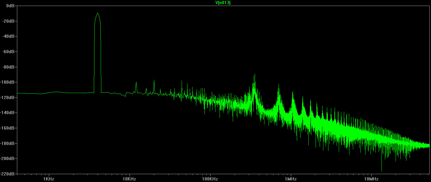

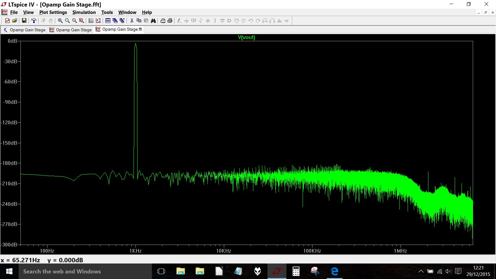

Well, despite it's difficulty to get stable, I've started working on a AD797 based input board for the diamond buffer.
The FFT looks OK I think, alot better than the Jfet buffer FFT did.
I dropped the supply to +/-10Vdc and the output resistors of the BD139/BD140 to 1R5 from 2R15.
I'll use DIP8 sockets so that I can easily swap single opamps.

You might find opamp models a bit optimistic in their distortion results and FFT profile although whatever you are using for the AD797 is at least giving something in the way of realistic results.
This is from a non inverting op-amp buffer circuit that I developed.
