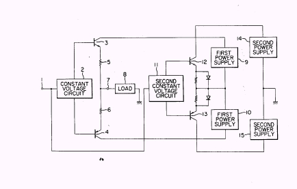

My error. It is the Sano circuit, patent # 4,115,739
by Sano, Hirosha, Hirota.
Brilliant piece of work, wish I'd thought of it.
One of these days I will definitely make a project out
of it.
Assigned to Matsushita, I believe, so only used by
Technics (Panasonic). I'm not at all sure they used
it at all, although I have seen posts on the SS forum
asserting that it did exist.

What made the Sano circuit so special? How scalable is (was) it? Are the components (devices) to put it together still on the market?

Perhaps somebody here will be so kind as to post the
cover page diagram of the Sano amp (ref # above), since
I don't have a copy and am inept with graphics anyway.
It took me 5 tries on the last schematic.
The Sano circuit used two power amplifiers, one a low voltage
complementary follower biased at very high levels, say 5
amps or so, whose power supply ground is driven by a
beefy Class AB amp following the same signal. The supply of
the Class A stage rides the output of the big amp, and you
get an efficient Class A stage with high power and high
bias.

Since this is a very interesting stuff, I've made a zip file containing the whole patent #4,115,739 stuff.
But the size of this file is about 900K, and my Internet connection is very (!) slow :-(, so if anyone wants to receive this file (one html page plus 16 jpegs), please let me know, so I can send it once and for all.

SANO Amplifier
When I read the first mention off this circuit
I was very surprised. In 1987 or 1988 I build
my first Class A circuit and it was one of these.
Before this I build various class B amps.
Philips kits, Edwin, Cressendo from Elektor,
stuff like that. Also made quite a few amps using
an IC called TDA2002 and later TDA2003 in various
configurations.
I had (still have) a 1982 article which I
had looked at lots of times, but somehow I never
came round to actually building the circuit.
So in 1987 I did. I remember not being able to
find the needed OpAmp, TDA 1034, so I replaced
this with a NE5534. After a few weeks (and a some
problems) this thing was finished and I used the
amp for quite some time.
My SANO was replaced, and collected dust until
2 or 3 years ago when I ripped it apart. I needed
some of the parts. So all I have left is one of the
veroboards. A picture of this board, sano1.jpg, is
in the attachment of this post.
Yesterday, I punched in the schematic (sano2.gif)
in simetrix. Since I ran in to the limits of simetrix
I removed/replaced a few parts to get a simulation
version (sano3.gif).
