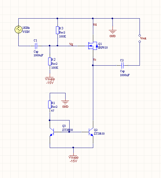

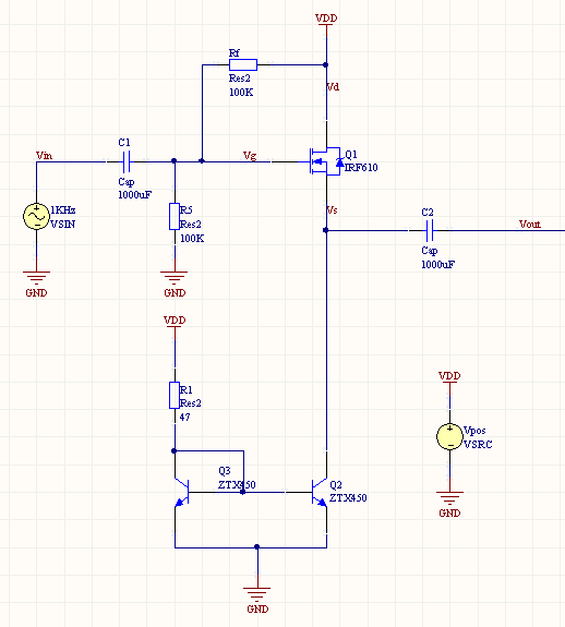

I am in an electronics class in college and I am working on a headphone amp for my final project. The class is the first electronics class, so I need to stick to something fairly simple. I need to be able to analyze the entire circuit by hand, so nothing really complicated. I am thinking of a simple voltage follower with no voltage control since it will be used mostly with my computer. How does this look to you guys? Am I doing anything terribly stupid? Any simple changes that would improve things? I know the circuit seems trivial, but I am pretty new at this.
Vdd = 15V
Id = ~300mA

you have shown a CCS loaded, source follower, in single ended mode, powered from a single polarity PSU.
The maximum current available from the follower <bias current.
That bias current flows through your current mirror.
Check your current mirror dissipation.
Check the high pass filter at the input of the amplifier.

Back to my amp: the BJTs in the current mirror dissipate about 900mA, how big of a heatsink should I be looking at? My simulator (Altium) does not give me a power for the mosfet, but it is biased at 300mA, how much heatsink is appropriate for that? Is there a standard method for calculating heatsink size?

Headphones are over 100dB/mW, 1W would play over 130dB. Most phones are around 30R, so the bias need be no higher than about 250mA or so.
Hi Chad
A couple of comments:
a) 1000uF for the input coupling cap (C1) is way to high. Something like 1uF would be better.
b) The current source built around R1, Q2 and Q3 is very inefficient (and not very good). As is, the power dissipation in the amp will be about 4 watts in R1 and about 2 to 2.5 watts each for Q1 and Q2. i.e. About half the power is wasted in R1. A more conventional CCS like those shown below would waste less heat. I'd vote for the 2 transistor one. BTW, the second one uses a LED as a zener. They make nice voltage references - low noise, low dynamic impedance etc, and pretty too.
c) ZTX450 is no good for the CCS, it's power dissipation is too low. Something like a BD139 would be better and can be mounted on a heatsink. See here for a list of other medium power transistors.
d) With single supply and large coupling caps, you need to beware of thumps at switch-on and switch-off. This can be a pain to sort out.
e) Don't forget to check power supply rejection. With mains power and ripple on the supply line, a fair amount of hum will leak into the signal path, mostly through Q1's bias resistor and the resistor feeding the CCS. It's a good idea to add an extra RC filter for these.
f) Heatsinks are rated according to their thermal resistance (in degrees centigrade per watt). e.g. If a transistor dissipating 2 watts is mounted on a heatsink rated at 10 degrees/watt, then the heatsink temperature will be 20 degrees higher than ambient. The transistor's case temperature will be a little higher due to the thermal resistance between case and heatsink, however this is low (maybe 1 degree/watt), so it won't make much difference here in a low power circuit.
Cheers - Godfrey

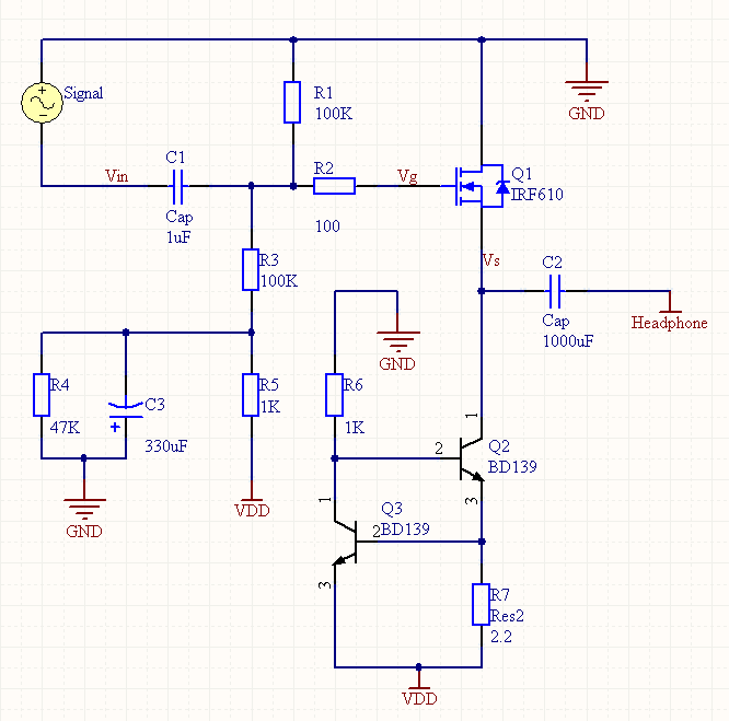

Turning the thing "upside down" with a positive-earth power supply can have some advantages:
a) Current drawn from the power supply is constant, so there's no signal current flowing in the power supply wiring. This can help with cross-talk.
b) Any ripple voltage on the power supply will not be applied to the Mosfet, which will help the PSRR, assuming the current source has good rejection and other PSRR issues are sorted out as well.
c) You can probably just short-circuit the output with a switch or relay during turn-on and turn-off to avoid thumps, without damaging anything.
p.s. I'm too lazy to draw all the other changes so pic below only shows the "upside down" configuration.
p.p.s. You need to add a gate-stopper resistor for the Mosfet to avoid oscillation.

Sorry, that was a typo. I wanted to say 900mW. They each dissipate about a watt at loud listening levels, even more at max output. The mosfet is indeed biased to 300mA.
Godfrey: Thank you very much for the detailed analysis! I will try to incorporate all of your suggestions. The current mirror used here was what was taught in class, and I admit that I didn't do enough research on alternative current sources. The upside down amp is also a really neet idea.

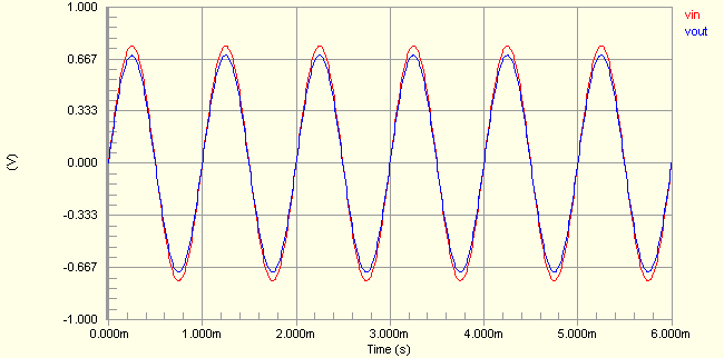

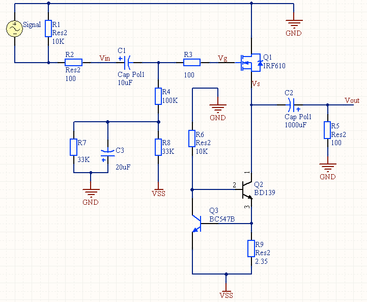

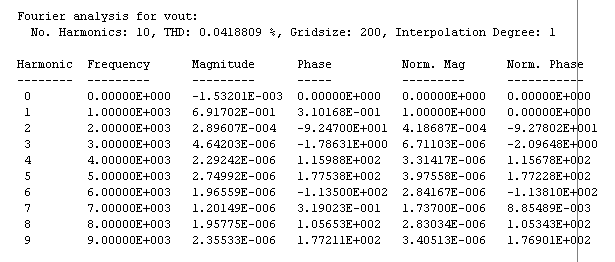

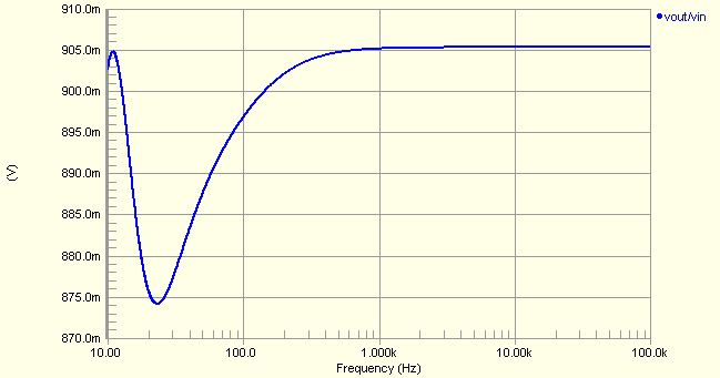

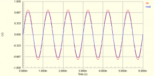

Ok. I have had some time to incorporate most of the modifications godfrey recommended. Right now my simulation uses an ideal power source and only has one channel modeled, so I haven't been able to quantify most of the desired effects. I did do a simulation of power supply ripple with the new bias filter circuit and it dramatically lowers hum. I don't think I understand how to implement a filter for the CCS. Each time I try to do it I actually make the hum larger then the output signal. Any ideas?
Any other improvements I can make that wouldn't dramatically overcomplicate the circuit?

Hi Chad
You can make it a bit simpler by removing R1 and increasing R5 to about 47K. That will also allow a much smaller value for C3.
To filter the CCS, you'd need to split R6 into two 470R resistors in series, and connect the mid-point to Vdd through a capacitor e.g. 100uF should give about -23dB @ 100Hz for that ripple source. I'm not sure if it's worth it, though - sim and see. What did you try before that made it that much worse?
On second thoughts, maybe it's a good idea to keep C3 quite large e.g. 100uF. Then the output voltage will take a few seconds to rise and fall at switch-on and switch-off. This should help to minimize thumps in the phones. The idea is to have the R4/R5/C3 time constant much larger than the C2/headphone time constant.
High impedance phones could still be a bitch, though. Maybe a 100 ohm resistor across the output (in parallel with the phones) would be a good idea to help with charging and discharging C2. This will help with high impedance phones and also avoid putting 7Vdc momentarily into the phones if the amp is switched on before the phones are plugged in.
Cheers - Godfrey

So, I built this design and found some strange problems. First, the biasing resistor for the CCS (R6 in the new schematic) needed to be dramatically increased. Without a much larger resistor the current source did not work with |Vss|>10V. It caused a really strange distortion where just after the positive peak of a sine wave the output would dramatically distort with high frequency noise then settle back down before reaching 0V. Its hard to describe, and it took hours of playing around before I realized it was the CCS. Once I realized the CCS was to blame I tried to lower R6 thinking I needed more current, but that made it worse. It was not until I raised it all the way to 10K that everything straightened out. Why is this?
Next: It hums REALLY loud when the input is disconnected. With the input connected to a source it is as quiet as could be, but unplug the source and the hum is nearly as loud as normal listening levels.
Also, the sound quality is not exactly what I had hoped for. It is noticeably better than my macbook pro phones output, but not dramatically better. Using my 1st gen iPhone as a source the difference in sound quality is almost negligible. There is still a small difference, but not at all what I was expecting. Just for reference my iPhone has always sounded better with my Grados than the MBP.
Any ideas?
