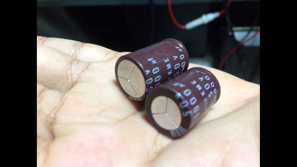

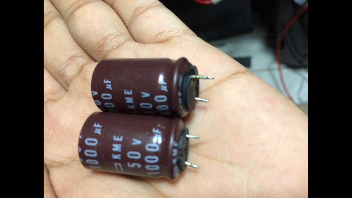

I remove 4 1000uf Cap and test the amps, lightbulb bright slightly and there is dc voltage at speaker output, and now, the chips who start warm, im afraid to damage the speakers & my phone if i connect it to speaker lol
There i upload image cap that i remove from right & left amp, the left cap seems normal, and right cap that get hot are start to swollen

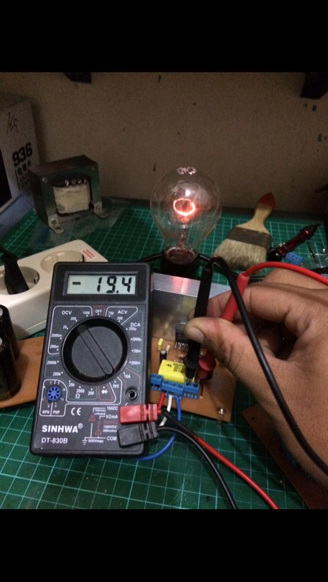

You mustn't connect speakers yet.

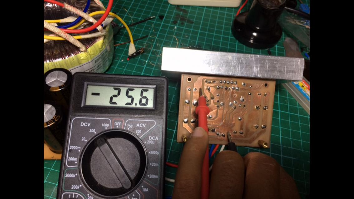

Now set your meter to DC volts and put the black on the main power supply ground. Confirm that pins 1 and 5 have POSITIVE 20 volts (whatever your supply is) and that pin 4 has a similar NEGATIVE voltage present.
If that is OK then you are really getting into needing to look at this with an oscilloscope to see what is happening.

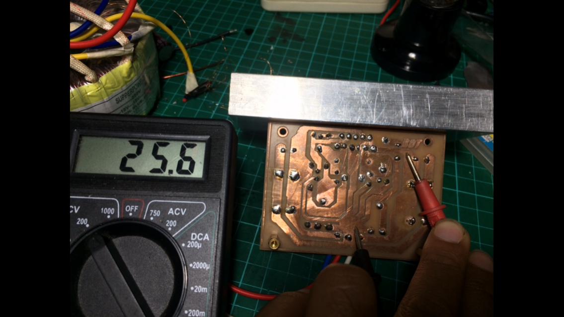

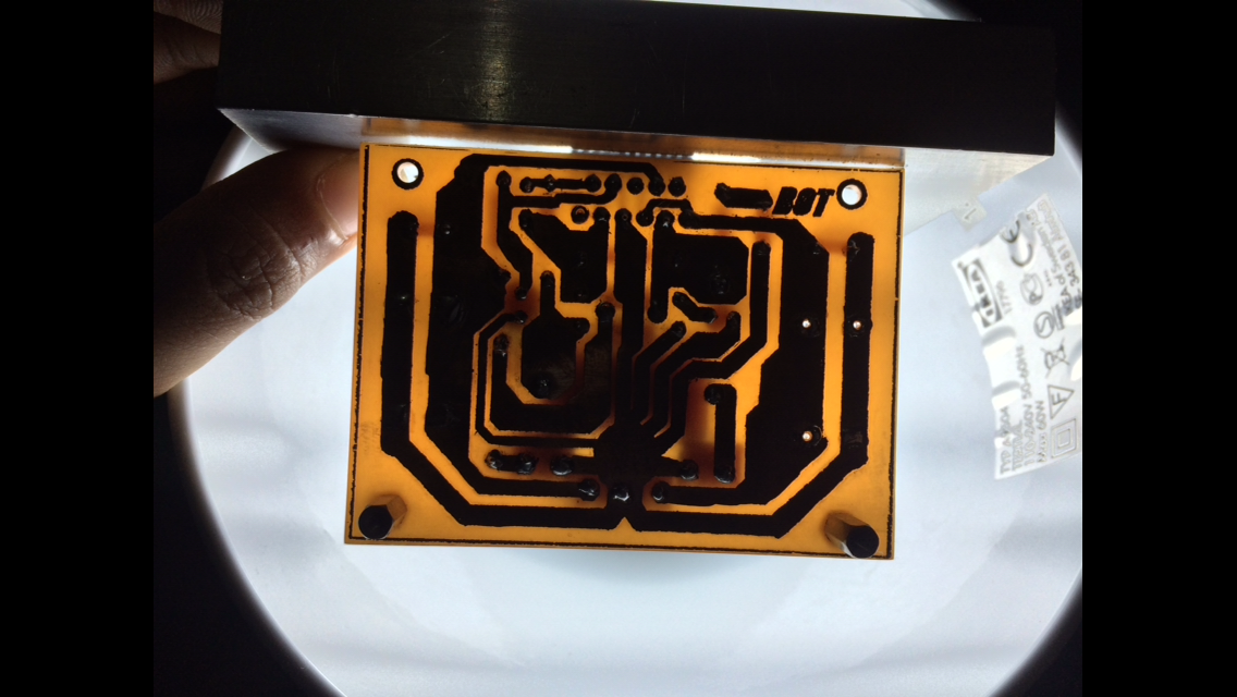

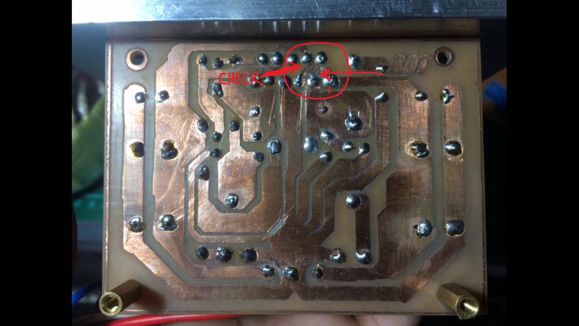

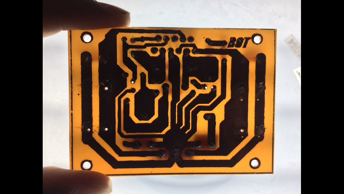

Attached it is one of your picture showing the back of the amp board. By enlarged it using Paint shop something look suspicious like you have a bridge between the positive and the negative pin. Would you please check it to see if there is a bridge or not.
any ac at the speaker output?
My ugly meter reading ac at dc current sir,
It looks good at my meter & under the light sir, its only the flux that i havent clean it yet, pls have a look at pic

Its reading 24-25 vdc sir, pin 1&5 , 4 are directly from the power supply board, the current are following my psu,
Is there a chance that some of the capacitors have the jacket and it's negative symbol on the wrong way around?
If only i blowing one cap i believe the case is posible, but until now i have blown 3 caps & damaging other 3, i believe the symbol are on the right way air

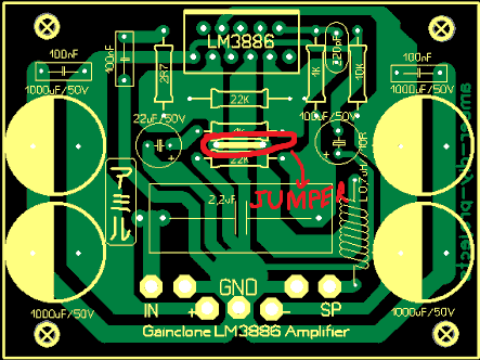

Should i change layout sir ?? I contact designer of this layout, and himself havent build this amp yet
