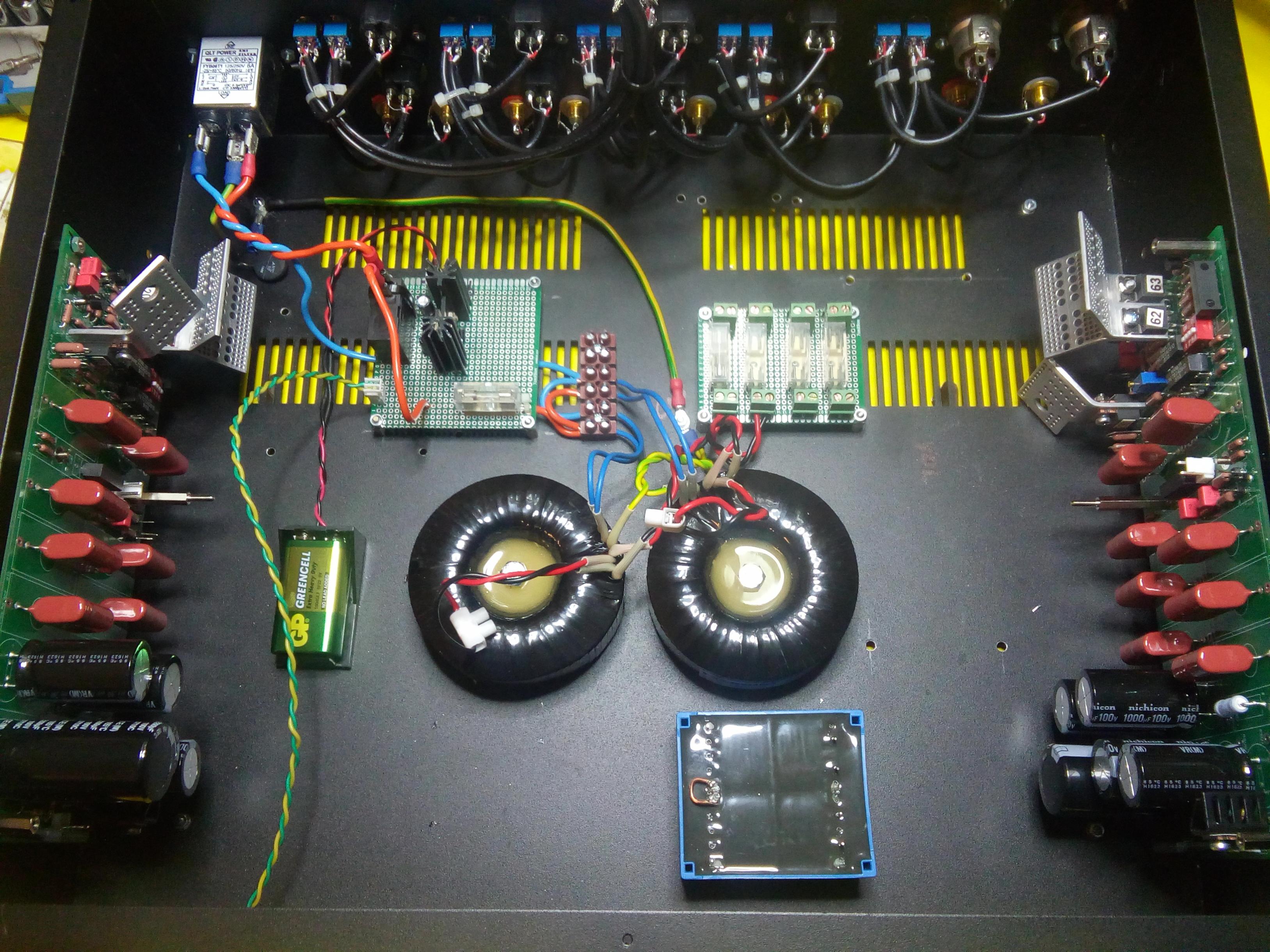

I have pulled ground from the inlet ( IEC) and attached as close as possible but I have ground also from the transformers that should connect close to the transformers. Can I connect a wire from transformer ground to inlet ground?

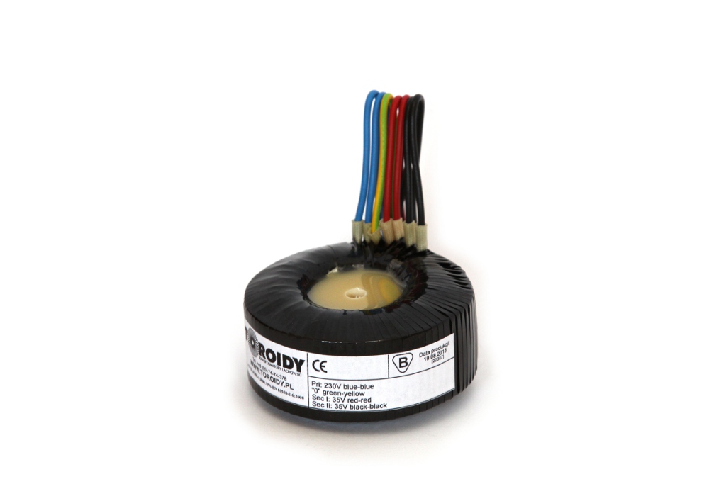

Checked the transformer now when I came home.... 03:30 and it look like this
To me that looks defenitely like ground, "0" is yellow/green so I want to connect it to the chassie close to the transformers and then lead a wire to saftey ground so I dont have ground loops running around my chassis.
When we are at it I have two 50VA transformers with 2x30V secondary. They look exactly the same as on the picture above so...
Primary side Blue/Blue and Yellow/Green which is the ground
Secondary side 2x Red and 2x Black.
I have understood that I take, from left to right (or right to left for the ones who want to do things differently but then you have to imagine the colours differently....😛😛) Red (first pair) goes to Aleph P1.7 AC, Second Red (first pair) goes to Black (second pair) and second Black (second pair) goes to Aleph P1.7 AC. This way I would take out 1x60V instead of 2x30V, have I got it right?
If you think that I am crazy asking this is because it is now 04:10 and I have just been working 9 hours so bare with me, pls!😉

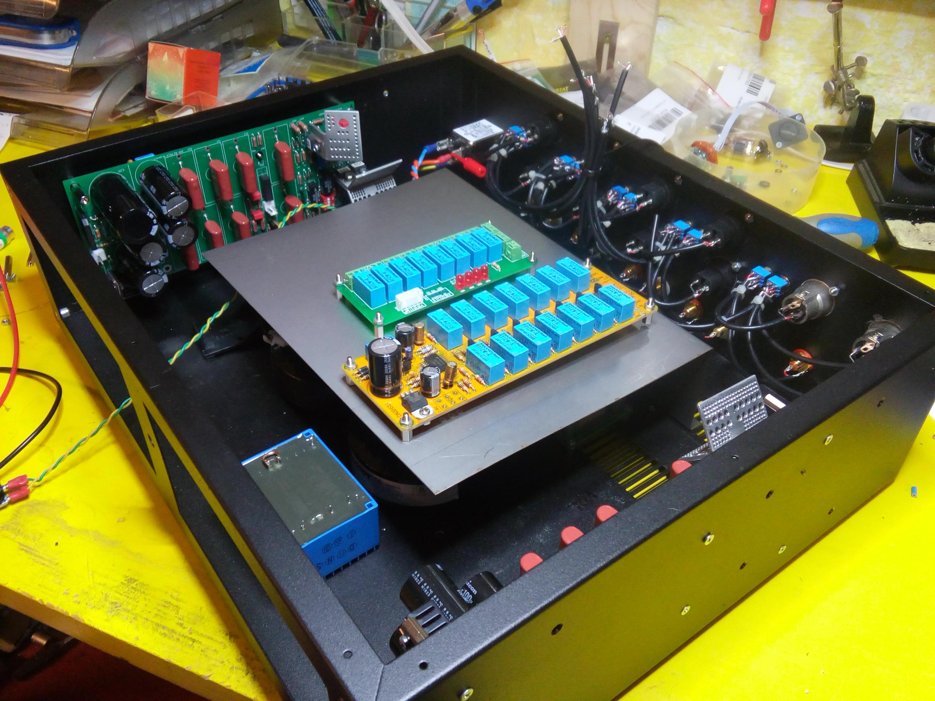

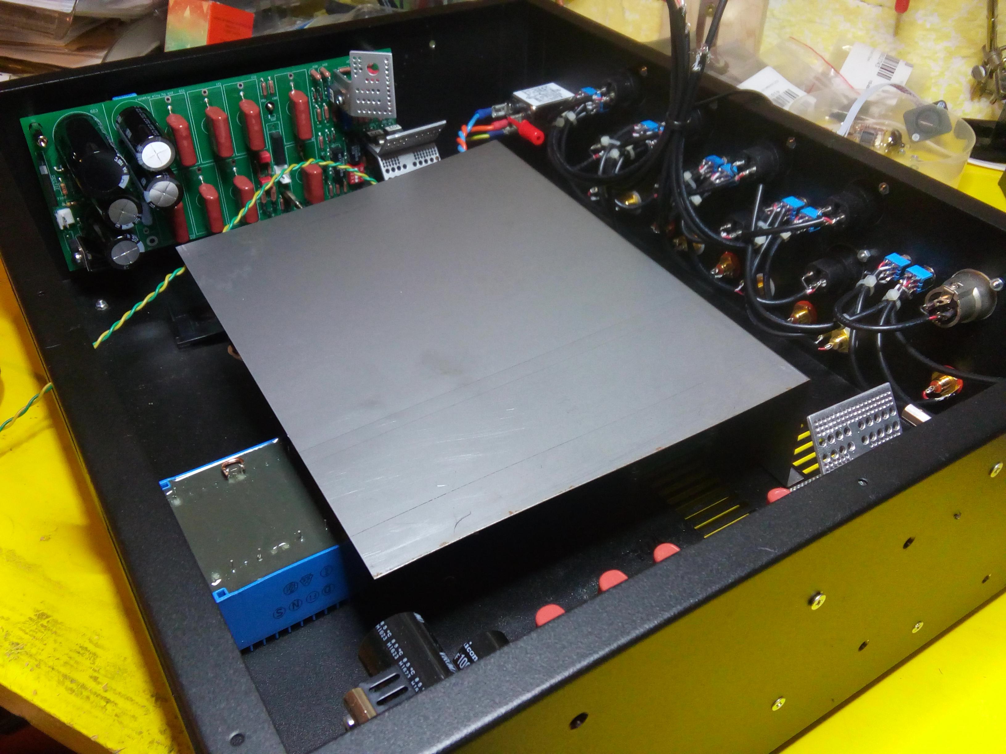

I had to find a solution for my transformers and cable routing.
I had an idea to separate all mains from low voltage and suddenly I realized that it was not that simple but after some thinking I came up with this solution.
I use a steel plate that come up over the transformers and regulators needed. This way I keep the high and low voltage "downstairs" while signals will only be "upstairs" with minimum of interference between the two.🙄
My idea also fit the Aleph P1.7 pcb:s that Koja (really nice layout having signals in one end and feeding in the other end) have made since I have 60V feeding towards the front of the pre amp while signals go in/out towards the back of the chassis. If needed I can seal the "bottom floor" entirely by mounting sides on the steel platform but I think this solution will be pretty sufficient.

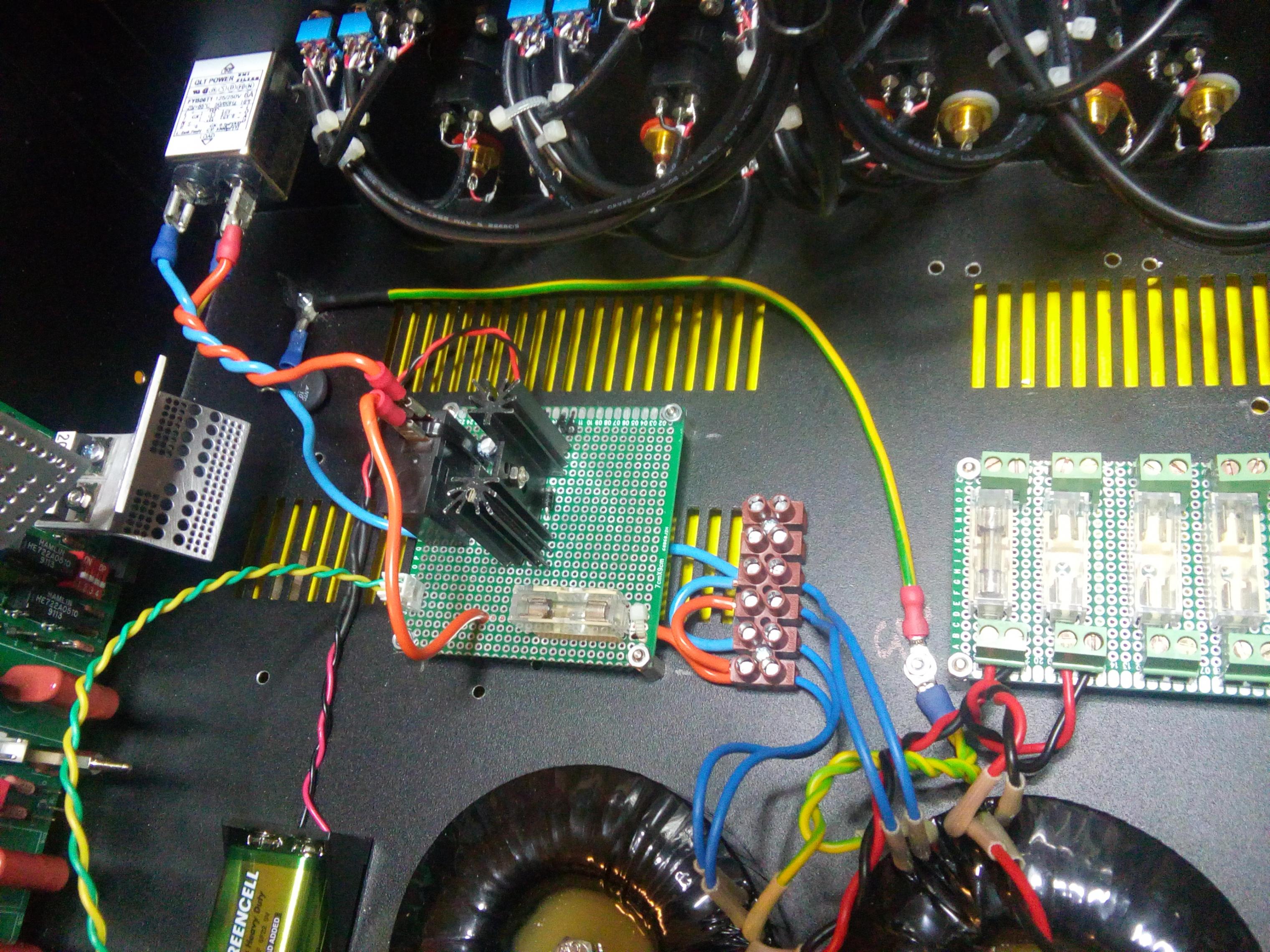

I have made a simple L7805 regulator for the relay switching on/off the mains that is feeded from a 9V battery but today when I wanted to test the transformers it turn out that the battery is half dead and didn't activate the realy that is a 5V relay. So my qustion is does the relay draw any current when not activated?? (And yes, I am going to put another fuse so I have separate fuses on each transformer)😎
I was of the impression that if I don't press the on button there should not be any current flowing so why is it that my battery is discharged....??🙁
Can it be that the caps in the regulator is discharging after a while when unused and that the battery compensate that discharge all the time so that some small current is drawn all the time??
Then the question is, can I prevent this from happening or can I run the relay directly without the regulator or do I have to switch to another realy then (or battery)?
I thought that the battery should work for longer than 2 days even if it was not that fresh from start otherwhise I have to take 230V front of the chassis and put an ordinary switch up front but my idea was to work a relay via battery not to have 230V running through the whole chassis.🙁
