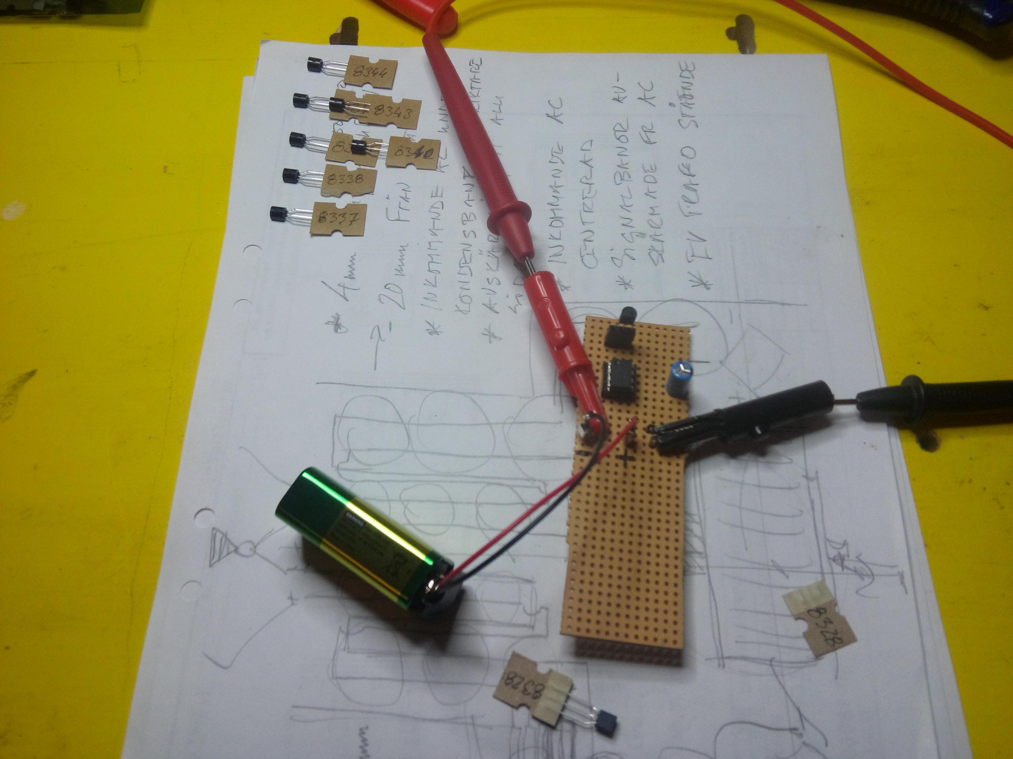

ztx vs bc
A question when I am at it....
Here in Sweden it is a little tricky to get hold of ZTX so I decided to go for the BC639/640 since they where as close as I could get to match the ZTX450/550.
I have measured at room temperature and at 35 degrees celsius so I have a close match but also a some idea about temperature drift.

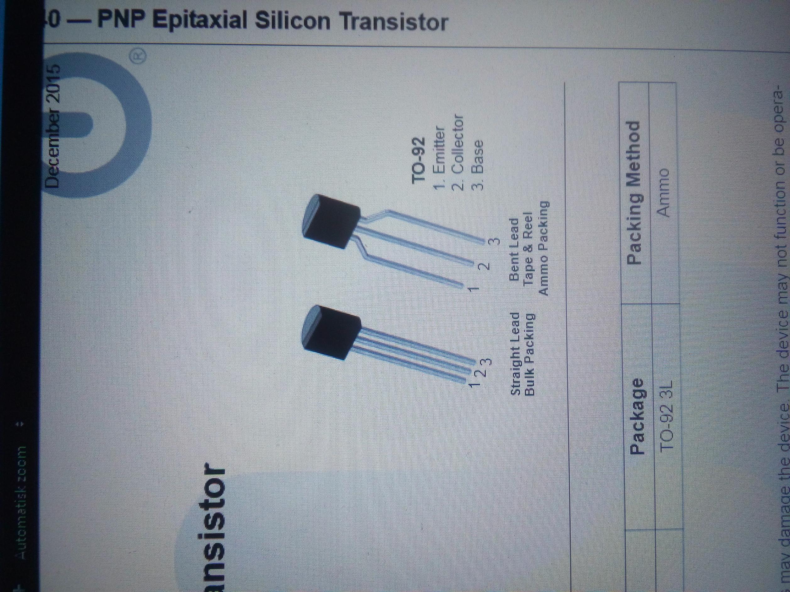

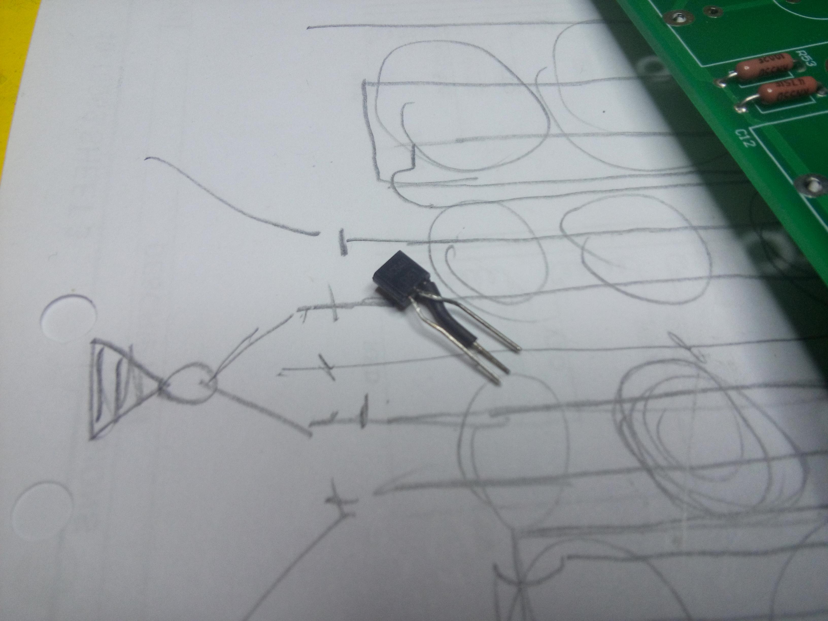

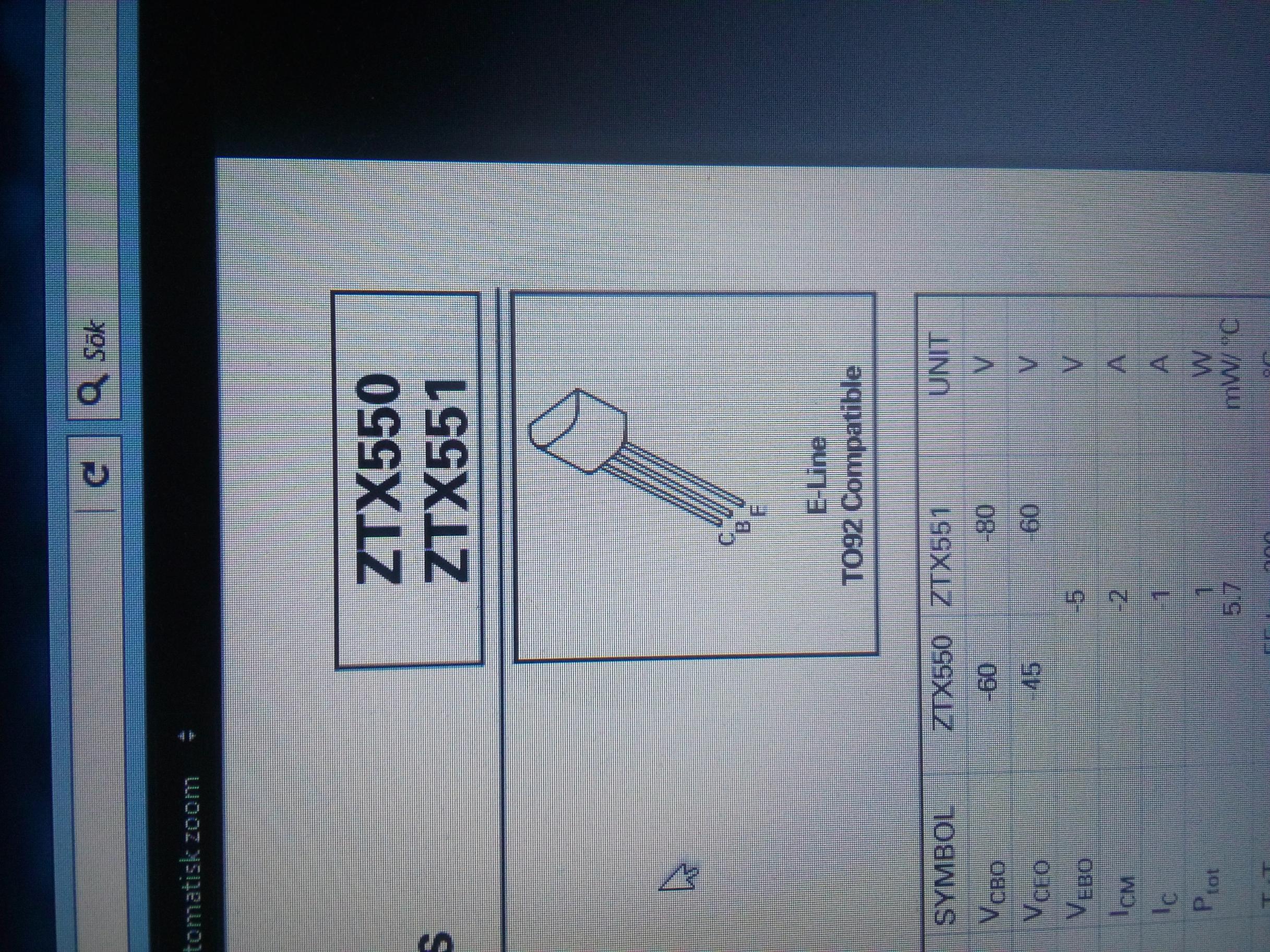

Now after matching I should start to solder but then I got confused, the Base, Collector and Emittor are somewhat strange or is it me being utterly stupid.
I am aware that it have been said that when using BC550/560 and other replacements you have to turn them 180 degrees but since I have choosen BC639/640 they seem to be different yet. Base is not any longer in the middle but as pin 3 so now it seem that I have to turn them like 90 degrees, cross the legs or....... am I right or utterly stupid???

go figure pinout by yourself
regarding matching - there is absolutely no need for that
ZM; I have figured it out, just that I had some 40 pieces of BC639/640 at home so since they match the ZTX in voltage and ampere I was only considering that at first. It was just when I started placing them on the board that I realized that pinout was different from other BC mentioned here at the forum. Will give me a little longer legs than intended and I have to crimp a protection on one of the legs where crossing the other. Not a problem just unconvenient.🙁
When it come to my effort in matching.....
Yes I know that is is not needed but on the other hand, now I have measured all my transistors for future need, I have also vague control over the thermal drift which mean that for other projects, it is done.

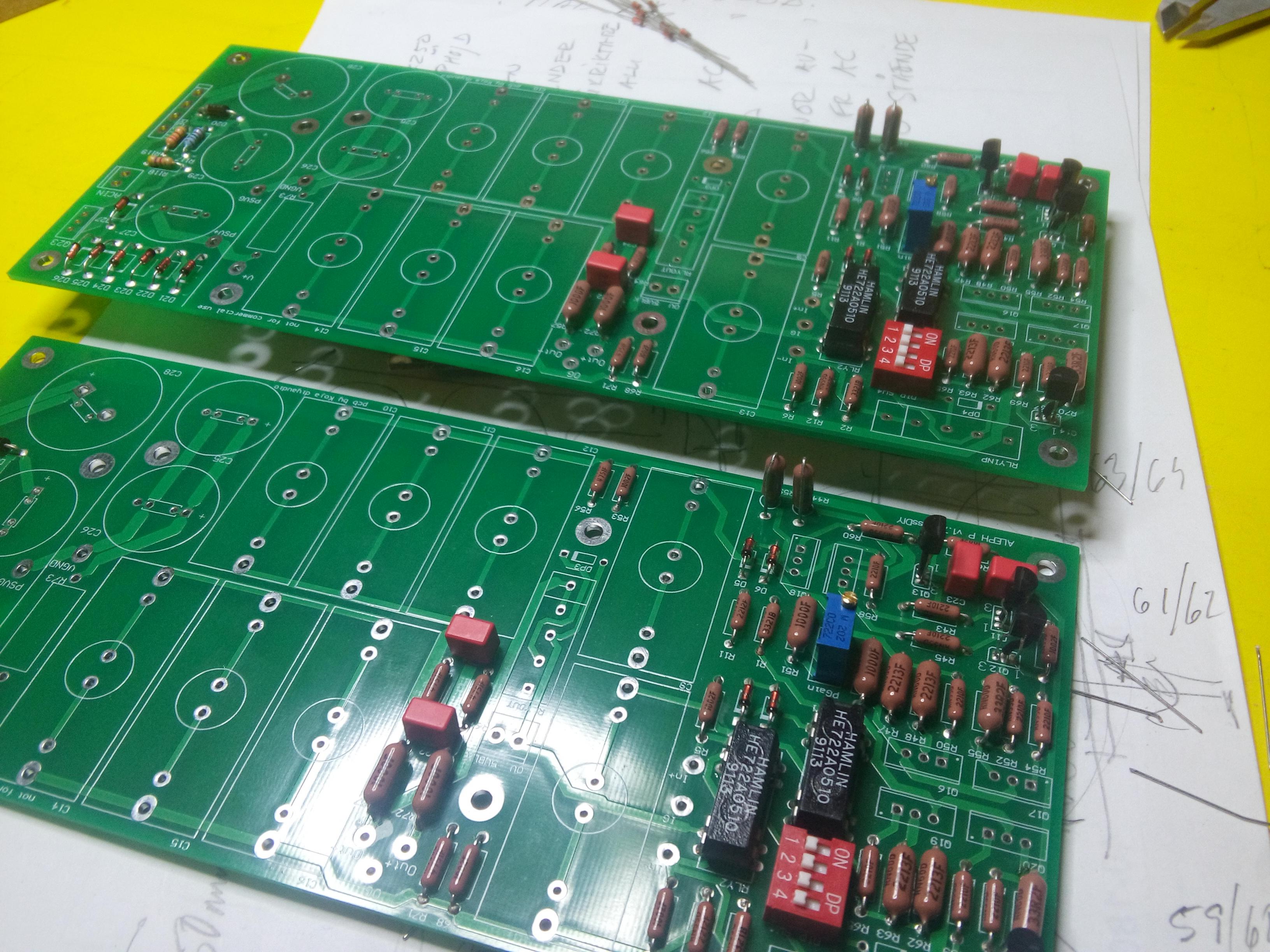

Starts looking like christmas.....
Slowly, slowly things are put to place and I hope to have at least the P1.7 up this year (together with my Damn Good 300B amp that is also coming together). Yes I could have built it faster but I have a family also and since my working hours are a little odd I have to take care of the house also every now and then.😱
I did figure out the pinout so I had to change collector and base, after that they are the same as ZTX.
Now it looks like I have some transistors on the board that need to go to the toilet cause all of them have crossed legs.😀😀

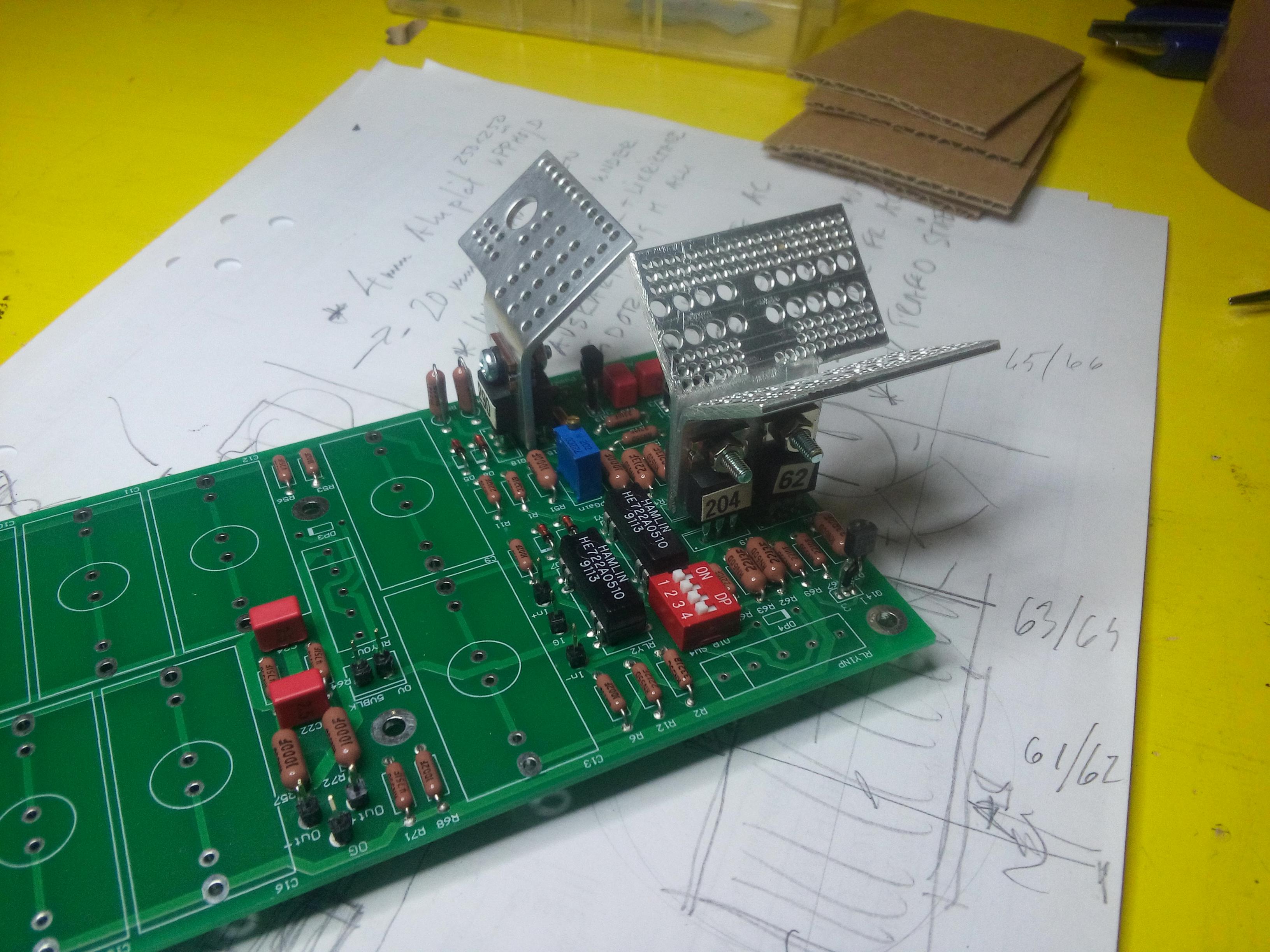

Heatsink??

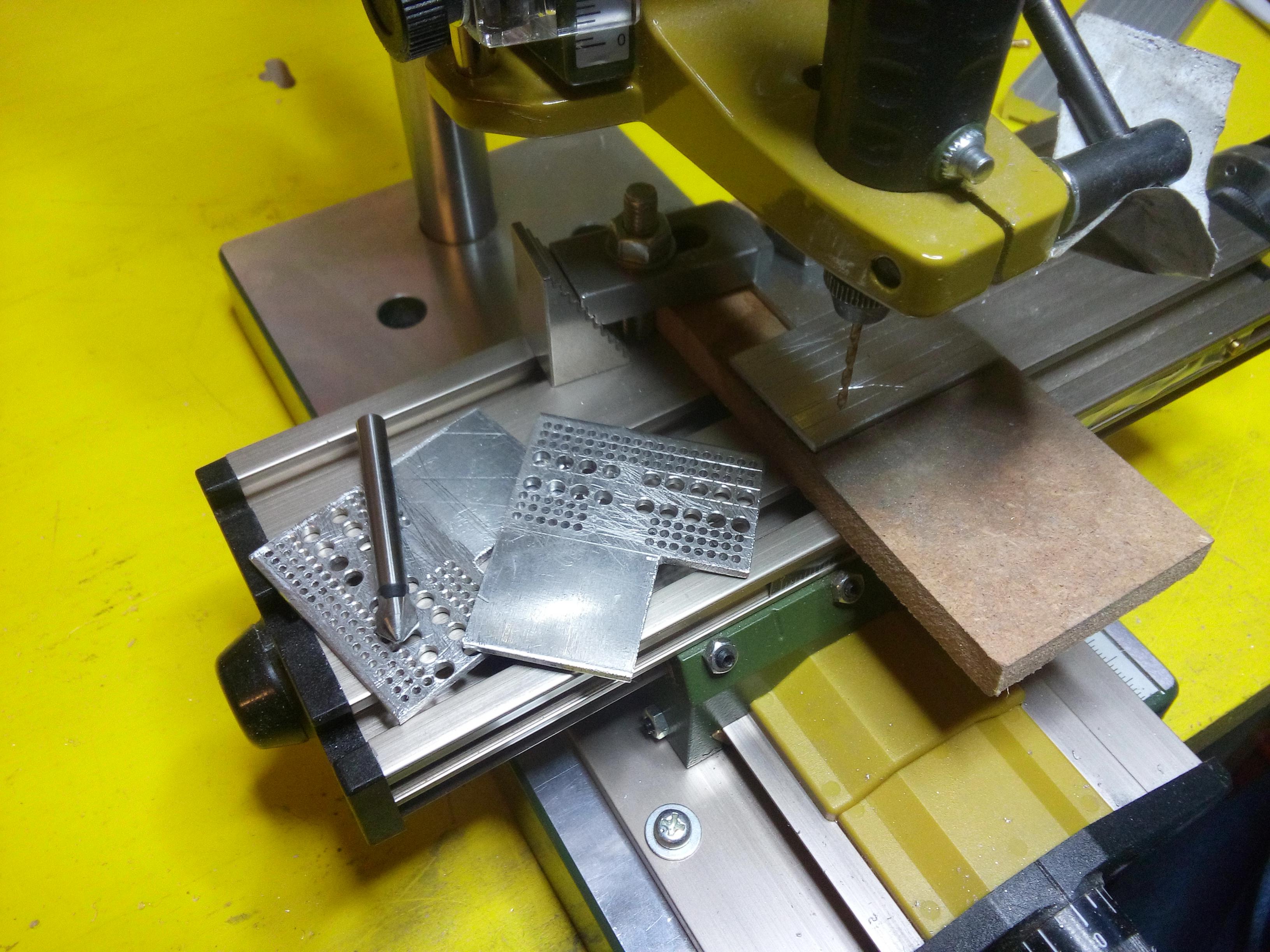

Don't know if you could call this a heatsink but it will, from theory 🙂confused:😕), dissipate some heat just like a heatsink.
Home made yes, but I have made them on basis of thermodynamic laws and the fact that eddie currents in the airflow, created by the many small holes will help the upward draft along the aluminium plate, tranferring the heat effectively to the surrounding air.😎

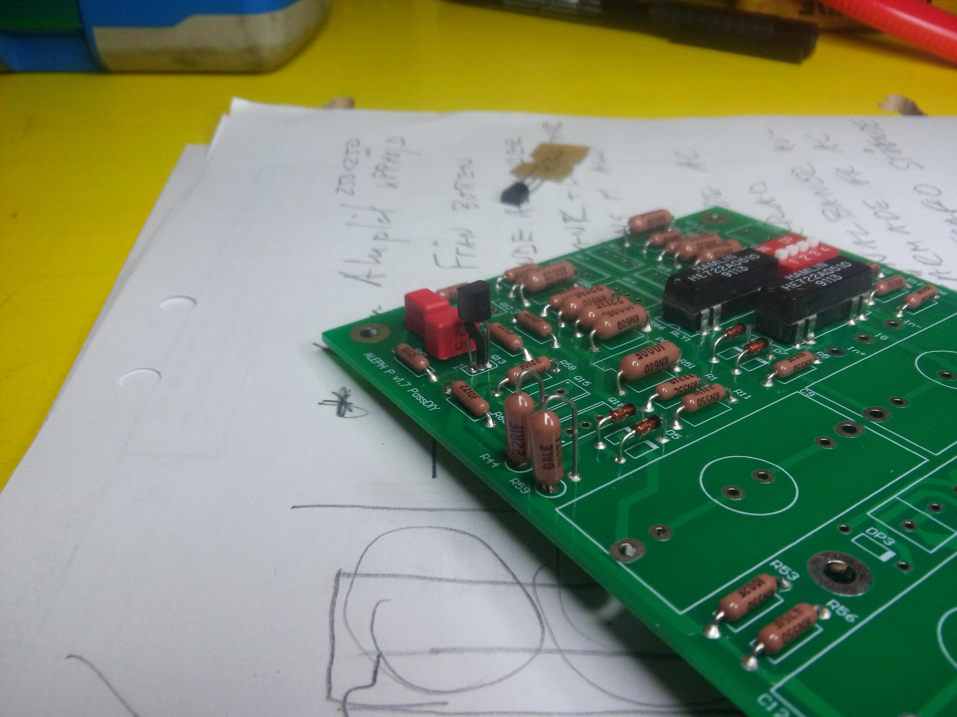

Now I only miss some very important caps and the relays missing in the picture then I am almost ready to heat it up the first time.
As far as I can measure resistance at this moment, measured at several points, indicate that the two channels are within 0.2 % of eachother and that I hope is a good sign.

Also came to think about that I have a temperature probe for my DMM so I could monitor the temperature at the same time.
Came to the conclusion that measuring at the same temperature was more important than waiting the same amount of time (in this case appr. 5 minutes to reach a near stable reading) for the readings.😉
Given a stable temperature of 27.2 degrees I now measured between 4.382 to 4.475 Volts for 10 of the mosfets then I had to give up cause the battery had lost about 0.2 Volts and I didn't have any new at home.
Yes I know, I am looking to buy a variable power supply but right for the moment I don't have it so battery will have to do for now.😛
Will continue tomorrow with the rest but I could at least pick out two that was measuring only 0.005 Volt difference for use in the power supply for my Aleph P1.7.
When I have measured all of them maybe I will choose another pair that are a little more off in measurment if I will be able to keep some better matched pairs by doing so, since the matching is not critical for the PSU.
Thank you all for advices and help.
