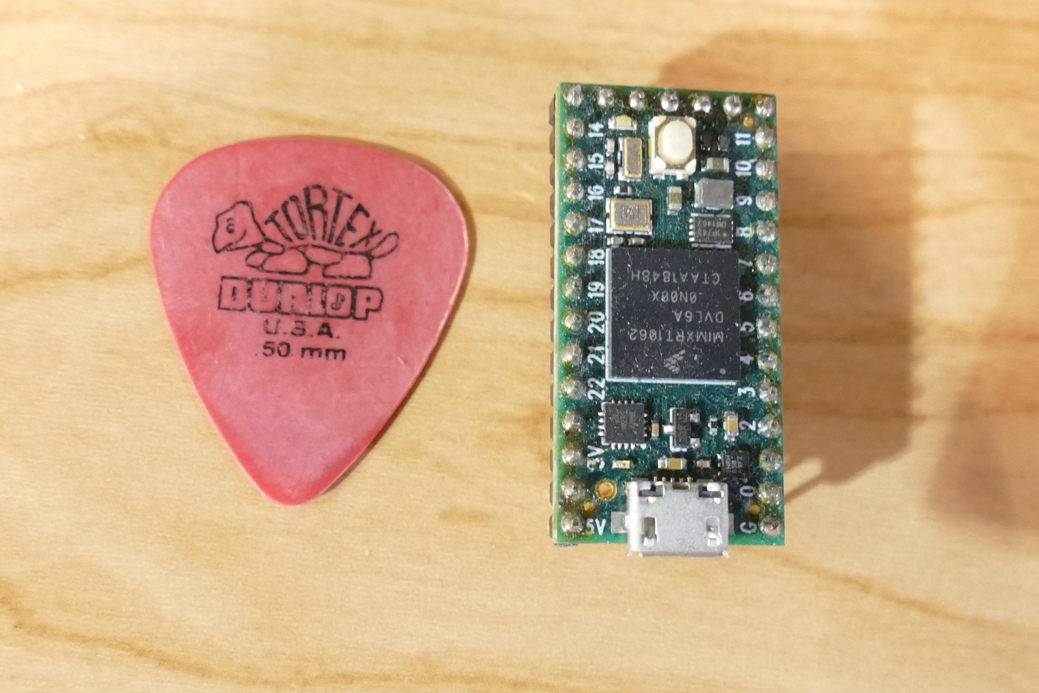

Small, cheap single board 32 bit computers that run at near 1GHz have become commonplace since I last played with a wired guitar neck. I'm sure a lot of new ideas will pop up when I get back to it. This 32 bit bad boy runs at 600 MHz and can be overclocked to almost 1 GHz. I have one running three polyphonic MIDI synthesizers simultaneously. It should be able to run a guitar.........

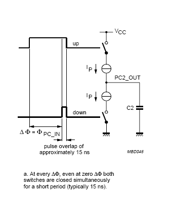

You must have used the older CD4046. There is the newer 74HC/HCT9046A with a better VCO and a charge-pump based loop filter (like you mention). The charging / discharging current is set by a resistor, with no resistor required for the loop filter anymore. Note that most pins (except 1 and 15) are the same as in the 4046.Musically, the cap-charging-through-resistor exponential acquisition meant for long glissandos, the stupid thing never quite "got there" in tune in a musically playable way. ... It did occur to me that perhaps if I used a bipolar current source to drive the loop filter, the the acquisition ramps would be linear and perhaps that issue would be solved.

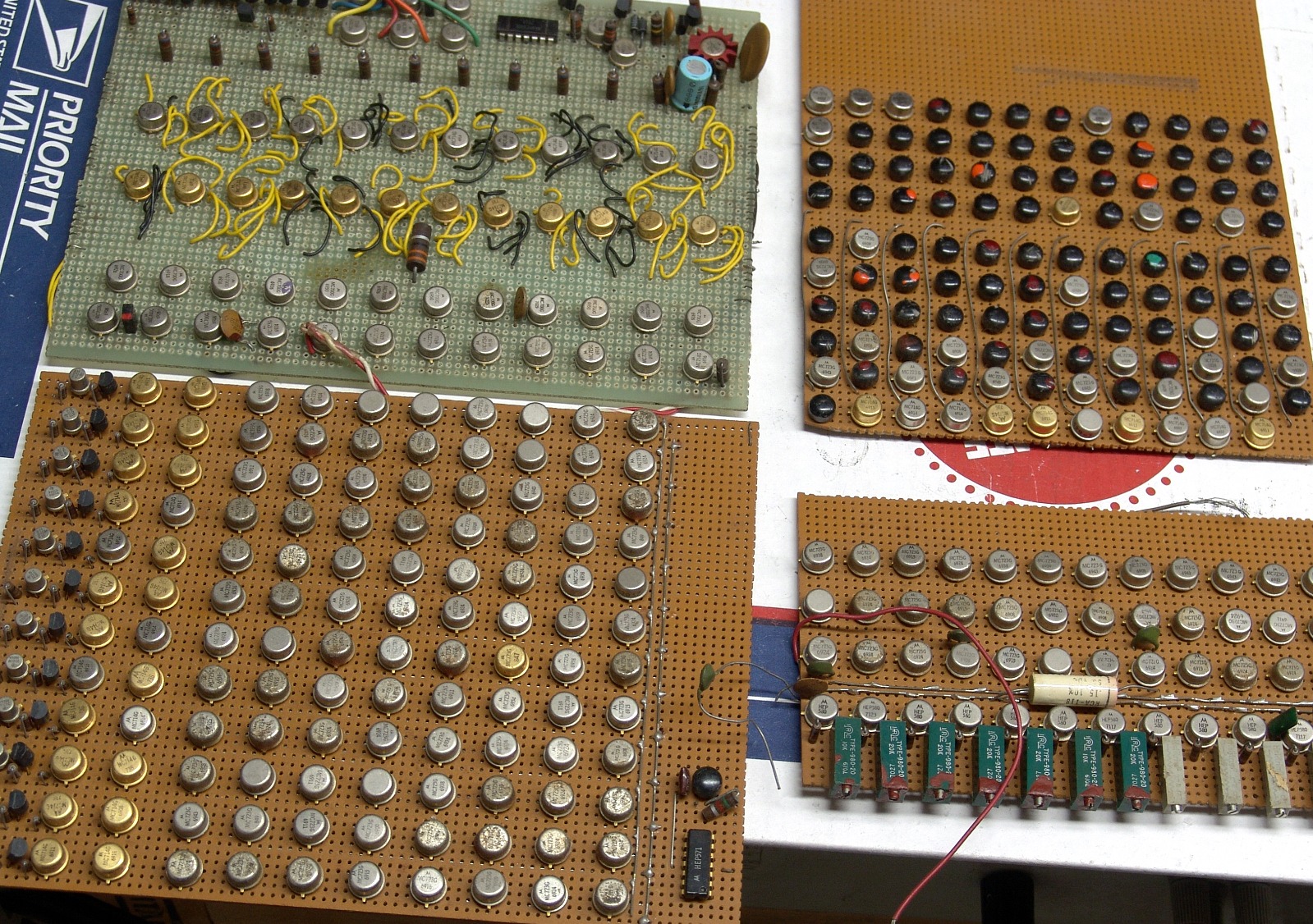

Hello everyone,
I have been fascinated by the Guitar since I was a teenager.
Many years later, when I was an employee at Scully Recording Instruments Co, Inc. , a fellow employee and I had a discussion about guitars, when he brought up the possibility of a stringless electronic guitar. At that time neither one of us had any idea as to how to construct such an instrument.
Soon thereafter I visited the US patent office in Washington, DC and to my surprise found quite a number of patents of just such instruments. As none of them appealed to me, I set out to design my own version of a stringless electronic Guitar. I did not know enough about electronics to design my own music producing electronic circuits and decided to purchase the music producing circuit boards of a Schober Theater Organ in kit form. The intent was to house the organ components in an external transportable console as they would never fit into the body of a guitar.
The next step was to design the circuitry that would go into the body of the guitar itself. I knew, that would require a very large guitar body and the largest guitar I was aware of in the mid seventies was the large 12-string Guild model that John Denver played. So, I purchased a guitar case for that model and reverse engineered the body and neck dimensions from it.
Then I realized that, I needed some form of touch sensitive switch for the fingerboard and one of my colleagues at Scully's suggested that I could turn a transistor on and off by connecting a power source to the base of a transistor with my finger. That worked. I then created a fingerboard that incorporated 24 touch switches, two octaves. Then I decided to make the fret spacing a uniform .800 inches with strips of abalone inlayed where the frets would have been. I also made the sides of the neck / fingerboard parallel to each other as a tapered neck / fingerboard is only needed as the frets get closer together near to the body of the guitar. There are 144 (24x6) transistors under the fingerboard.
The guitar was to incorporate an electronic capo, and because being electronic, and it can't be seen, I place 11 red light emitting diodes into the side of the fingerboard to indicate where the capo was located. And since I wanted the guitar to be a switchable right and left hand instrument, I placed another 11 LEDs into the other side of the fingerboard.
I machined the neck of the guitar from a billet of 6061-T6 aluminum on a Bridgeport vertical milling machine. The underside of the neck is shaped like half of an ellipse which I machined with a ball end mill by placing the neck fingerboard side down on the machine table lined up with its X axis. I then draw filed and polished the neck and had it anodized and dyed black.

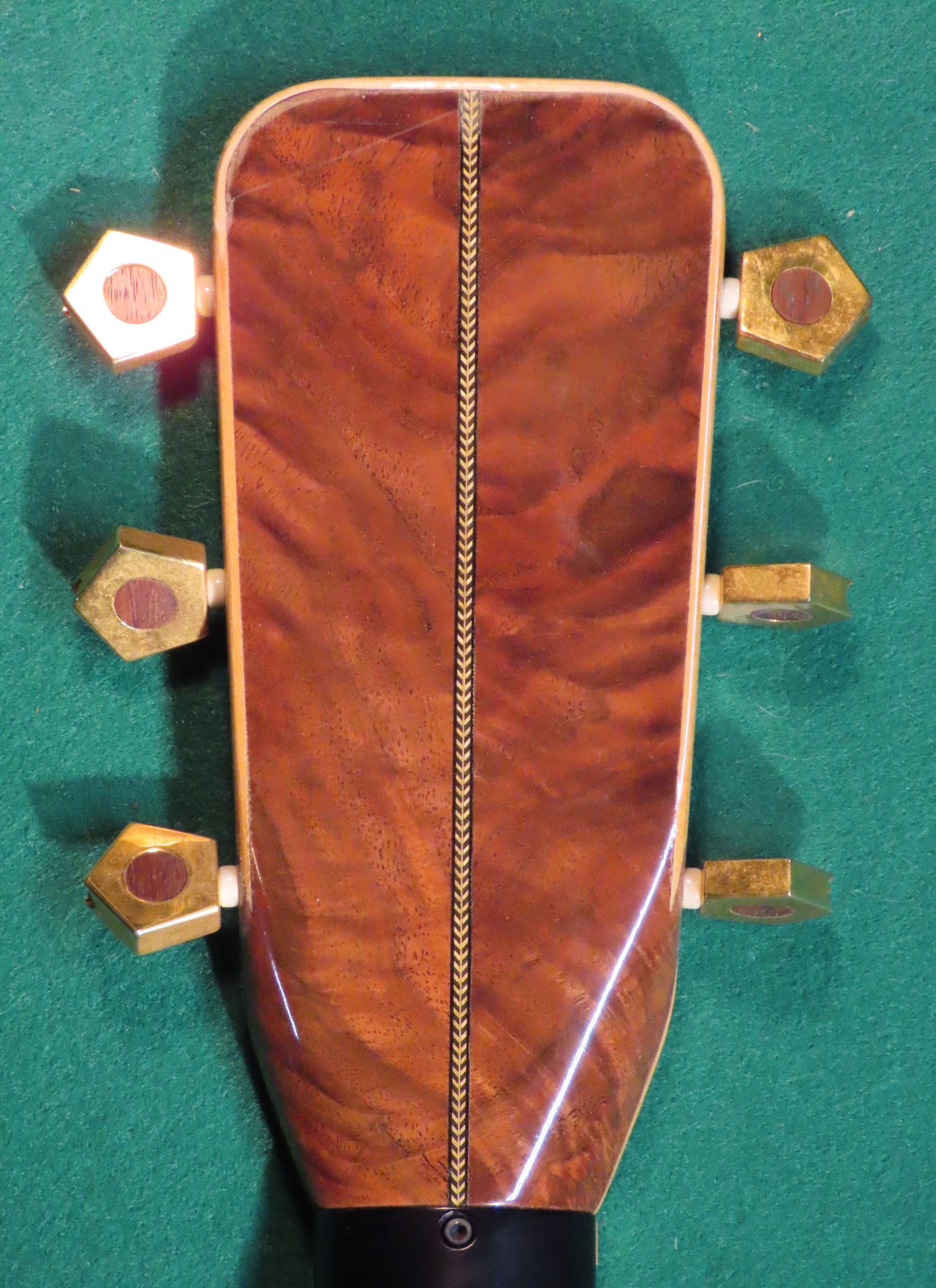

Finally, when I saw how ugly a guitar neck without a headstock looks, I designed and built a headstock consisting of two book-matched pieces of walnut with maple binding and herring bone inlays front and back. I also inlayed abalone "strings" into the headstock and finally attached some mock tuning machines.

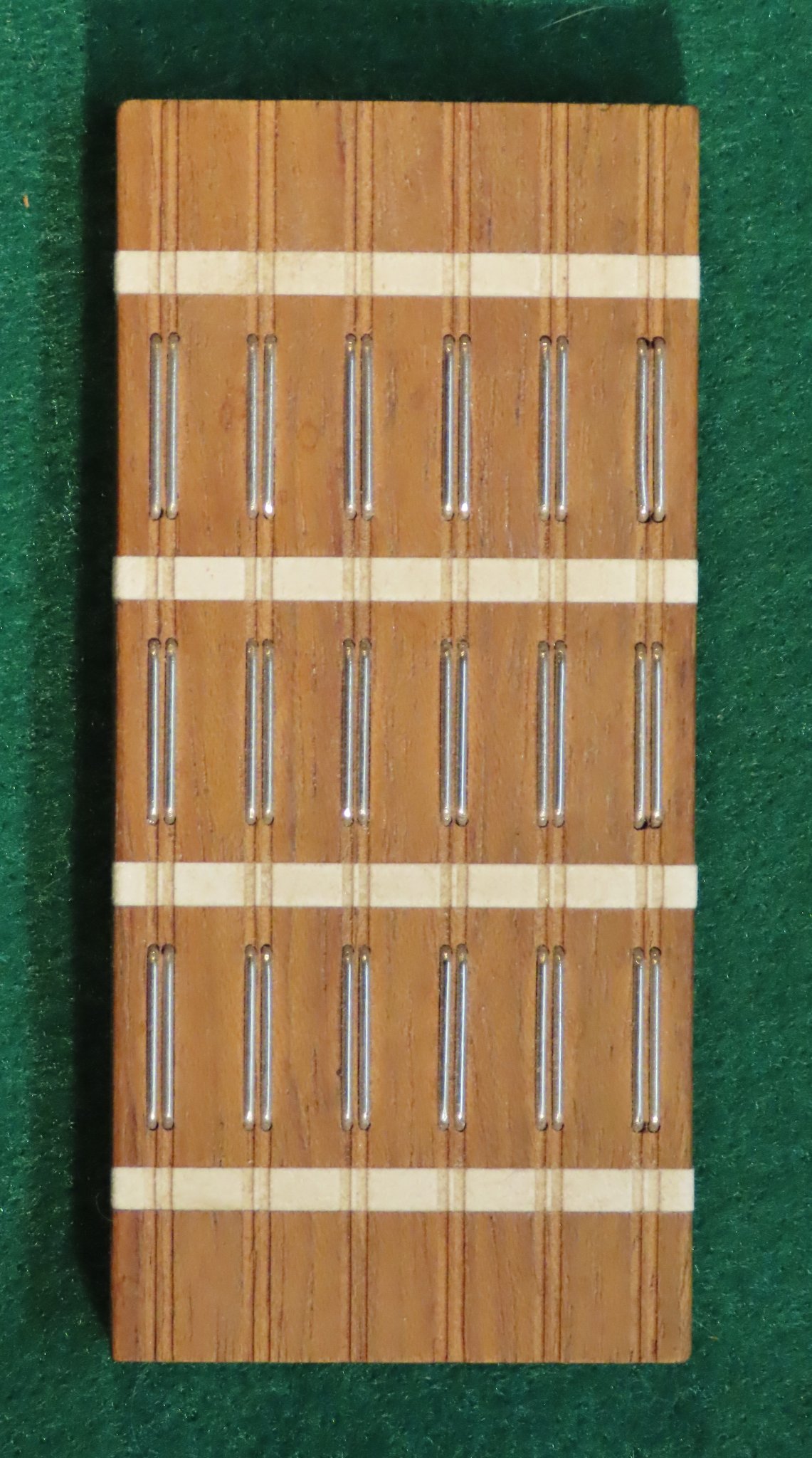

The first picture shows the touch switch test with equally spaced flush "frets"
The two parallel "wires" are connected to the base of a transistor and a source of power (5VDC if I remember correctly)

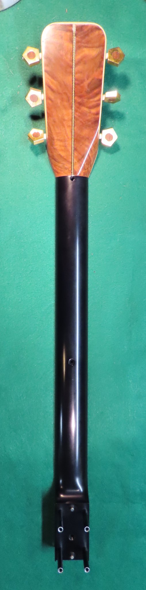

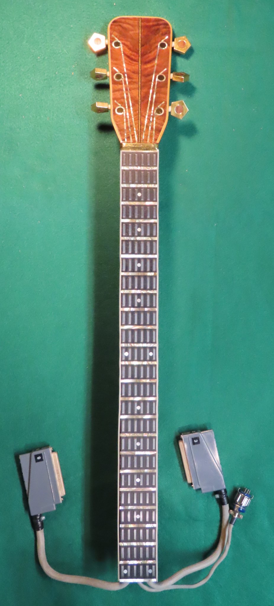

The second picture shows the complete neck. The two Cannon connectors connect three strings each to the body electronics. These connectors are reversible to turn the instrument from right-hand playable to left-hand playable. The single Amphenol connector connects the LEDs to the body.

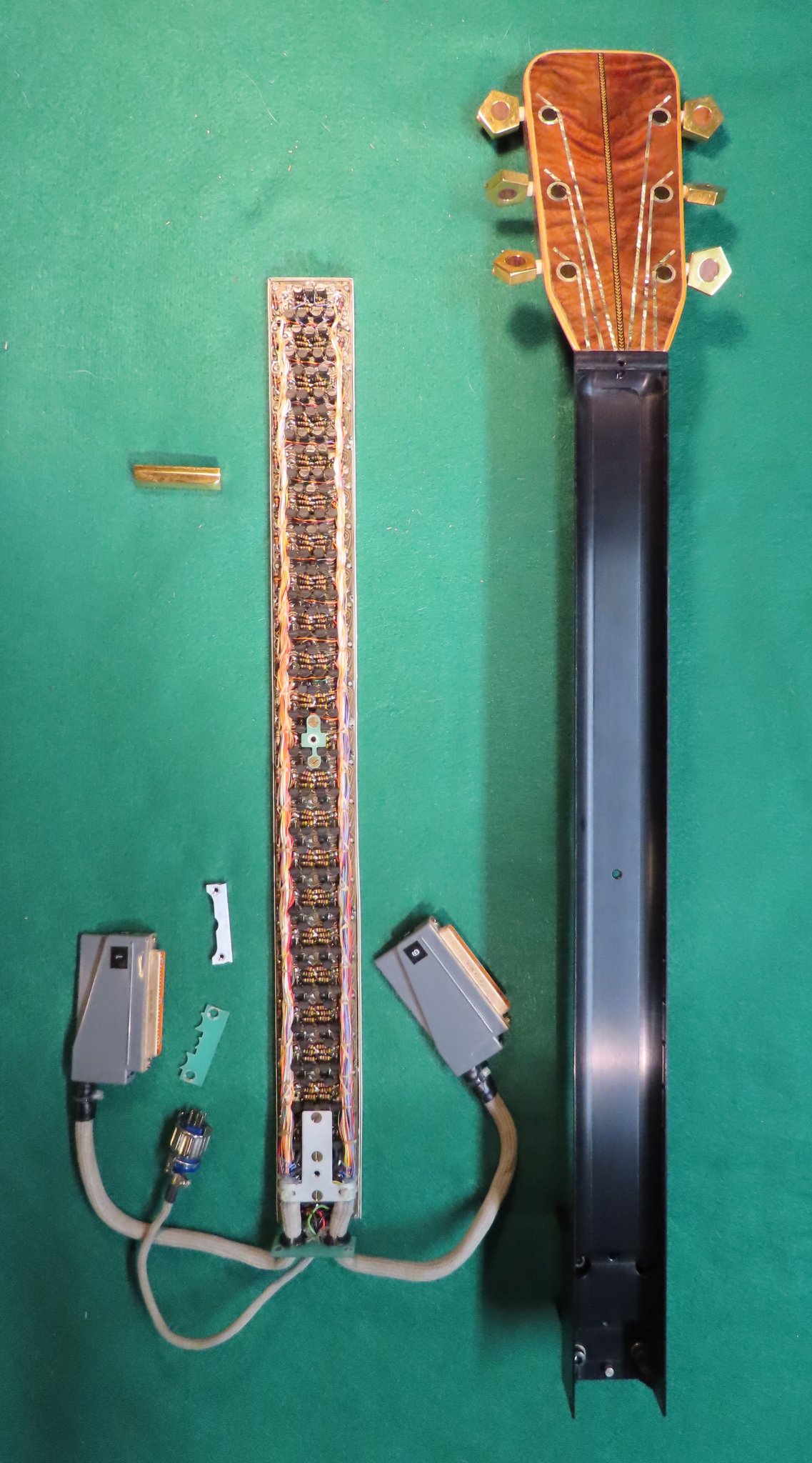

The third picture shows the fingerboard removed from the neck and placed upside down. It contains 144 transistors.
The fourth picture shows the back of the neck.
The fifth and sixth pictures show the headstock.
In my next post I will describe the body electronics, the picking switches and the "open" tuning design.
