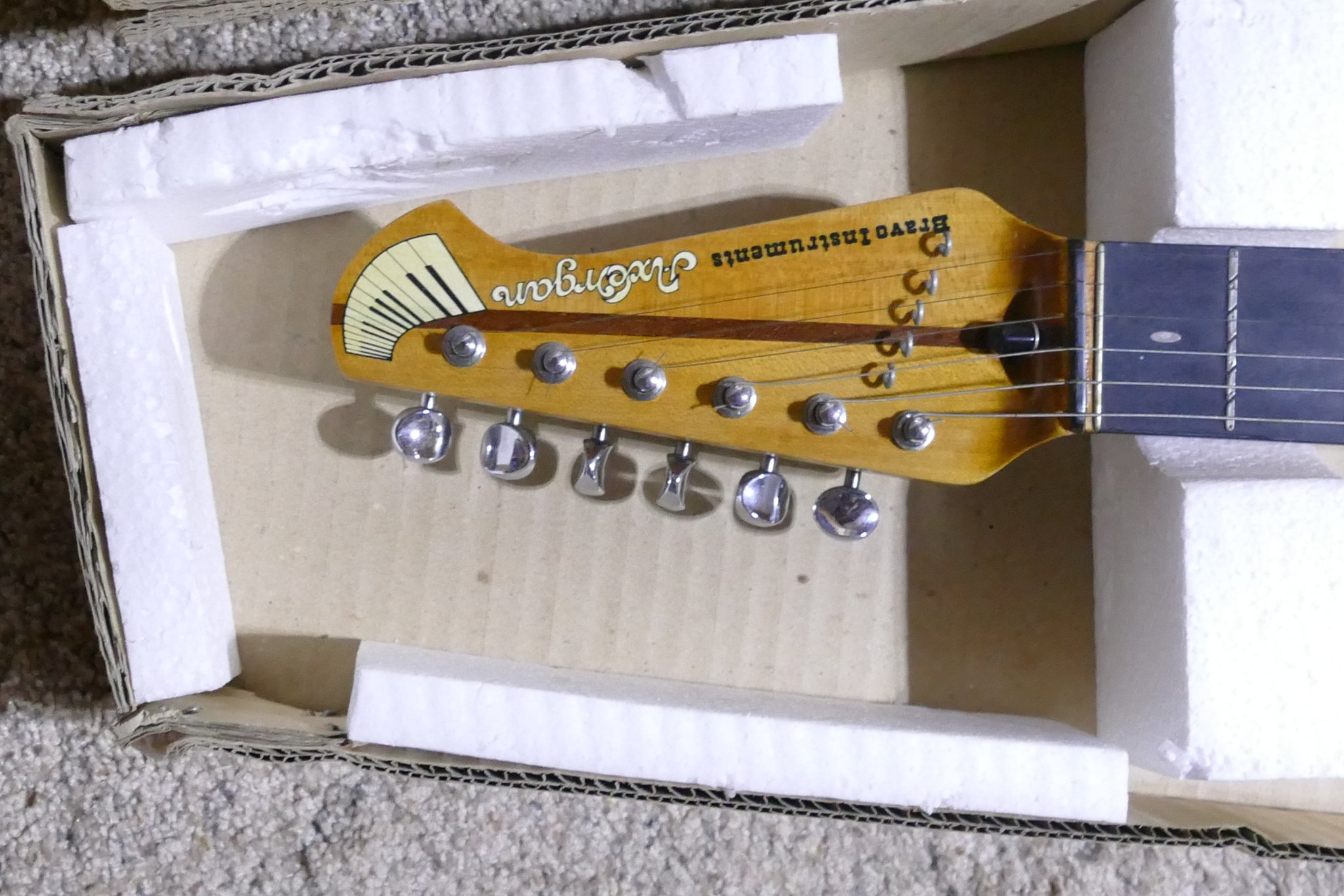

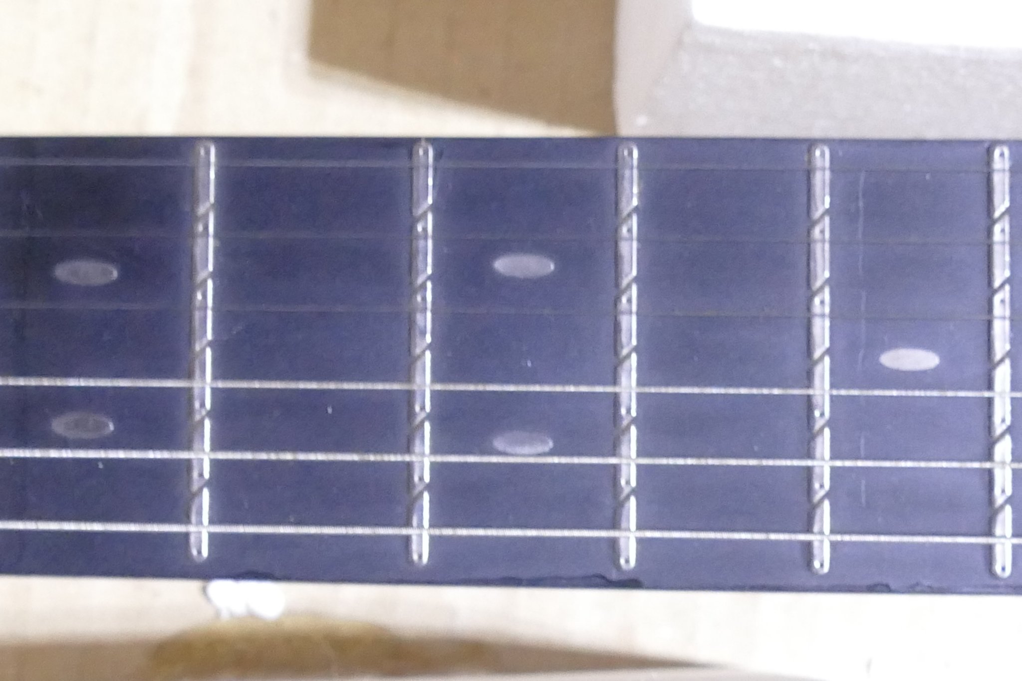

Nice looking neck and details! I like the "string" inlays going up to the machine head "posts". The somewhat corny caps on the tuners are adorable as well. Looks like a substantial effort was made. Are the transistor switches 'reliable' in being associated with those contacts? There's a difference between works and works reliably. Just wondering if that has to do with the % RH in the room, how nervous the player is, etc.
I guess I'd have to see the other half to comment further, that which initiates the sound. You mentioned virtual capo with LED markers, that implies open strings sounding, so there must be something that the right hand does to 'pluck the open string.
I think it maybe better to replace transistors with MOSFETs (e.g. MMBF170), as they're easier to turn-on, even in presence of the said variables. Being a charge-driven device, a MOSFET also appears to be more suitable for the job when compared to current-driven transistor.

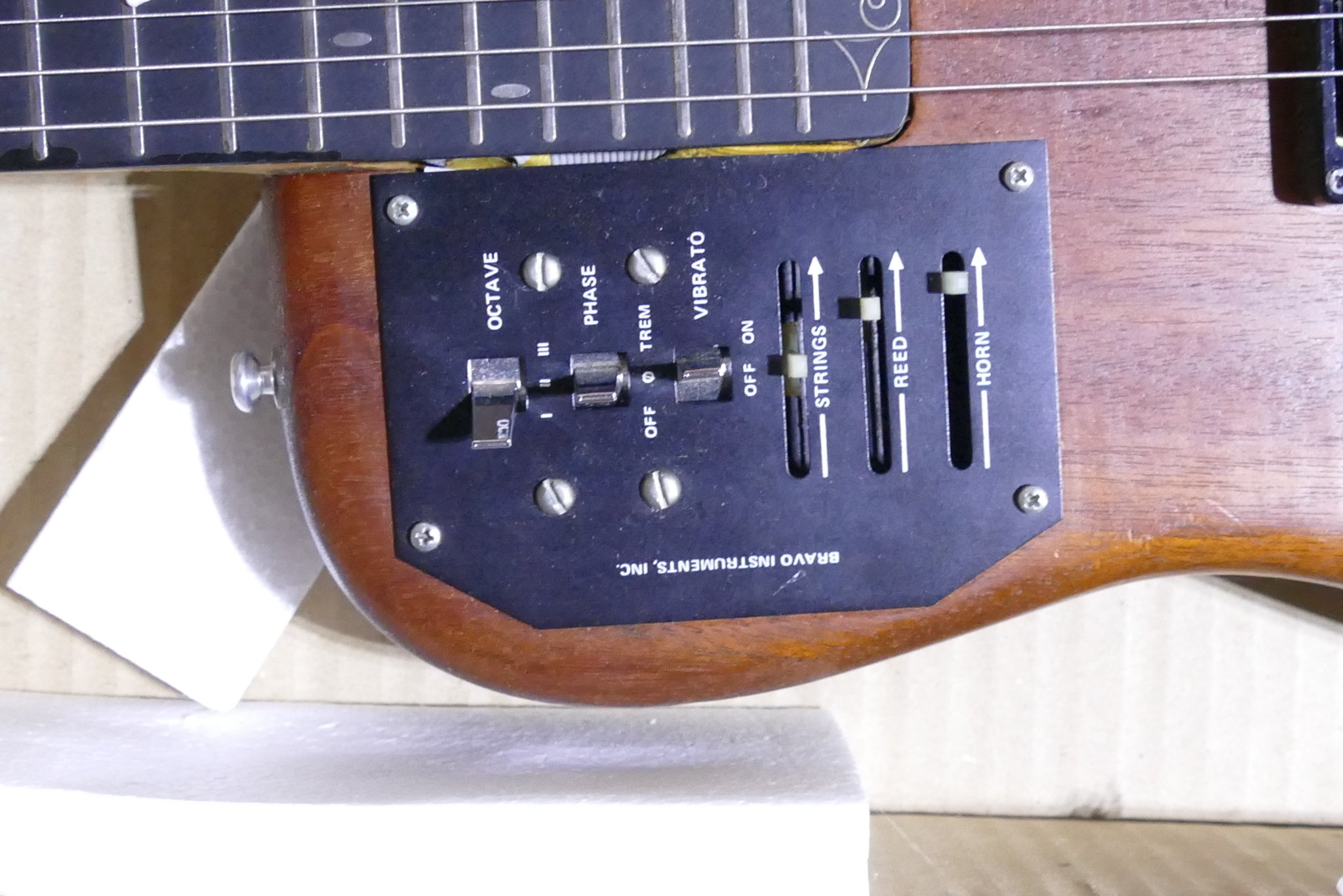

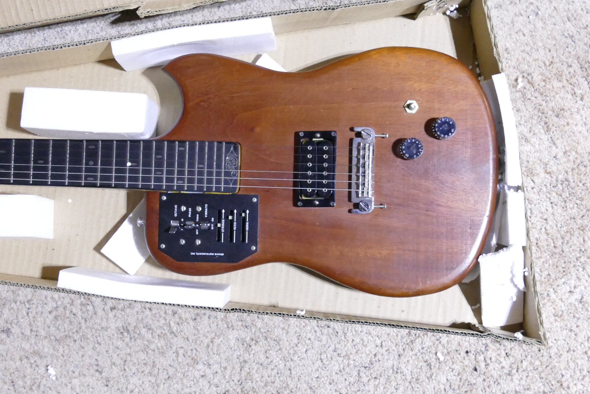

In this post I will introduce the body of the instrument and its contents, particularly the picking switches.
The picking switches basically consist of a wire form resembling an over-sized paper clip. The material is music wire and its diameter is .045" which represents the average diameter of the six strings found on an acoustic guitar, strung with medium gage strings. The two legs of the wire form are fastened to a base made of Delrin. Also mounted on the base is a Delrin coil housing with a coil of magnet wire. Inside the coil is a soft steel pole piece with a chisel shaped face and behind that is an Alnico magnet.
After I built a single picking switch prototype, I tested it with an oscilloscope and then I designed a "string" of four picking switches mounted on a single Delrin base. The whole device basically functioned like an ordinary electric guitar pick-up.
I then placed six picking switch assemblies next to each other, supported by Delrin brackets to form the complete picking switch assembly. The end result is that, I now have an assembly of twenty-four picking switches. Each picking switch is connected to its own amplifier on a printed circuit board.
Most of the mechanical parts of the instrument exist as sketches. The are accurate but they are sketches nevertheless. So, I spent the last several days, recreating some of them in my world-class CAD program which I didn't own 47 years ago, in order to make it easier to understand the functioning of my instrument.
The first image shown is the body of the instrument with all its contents.
The second image shown is the prototype of the picking switch.
The third image shown is an isometric view of the second image.
The fourth image shown is a CAD version of the complete prototype picking switch assembly.
The fifth image shown is a CAD version of a "string bar" of four picking switch assemblies.
The sixth image ditto of the fifth image.
The seventh image shown is the complete picking switch assembly with the finger board at its left side.
The final image shown is one of the picking switch amplifier printed circuit boards.
