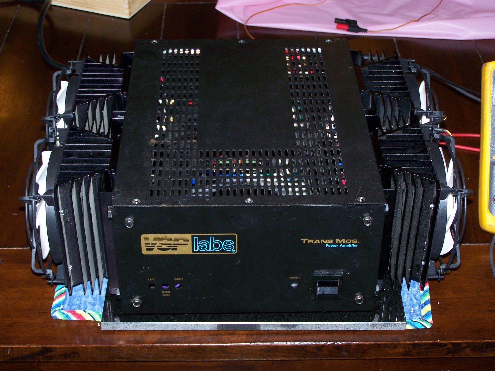

R9 is changed out for 5k and everything is perfect.
I have it biased at 150mV and I have 0mV offset.
I am waiting 30min for the temps to come up and then I will bias again and adjust offset.
My fans are going strong and I'm sure I won't hear it over .5W output power.
I am at 300mV bias now and I have 1mV of offset.
I will wait a bit to see where the temps normalize.
@ 200mV after 2 hours my middle pin temps were 38C
Ambient Temp: 23C
Bias: 300mV
Run Time: 3 Hours
Hottest Middle Pin Temp: 49C
Coolest Middle Pin Temp: 45C
Adjacent Heatsink Temp: 38C
Offset: .5mV
Rail Voltage: 22.4VDC
Secondary Voltage: 18.2VAC
I think all is well, after lunch I will have a listen.
