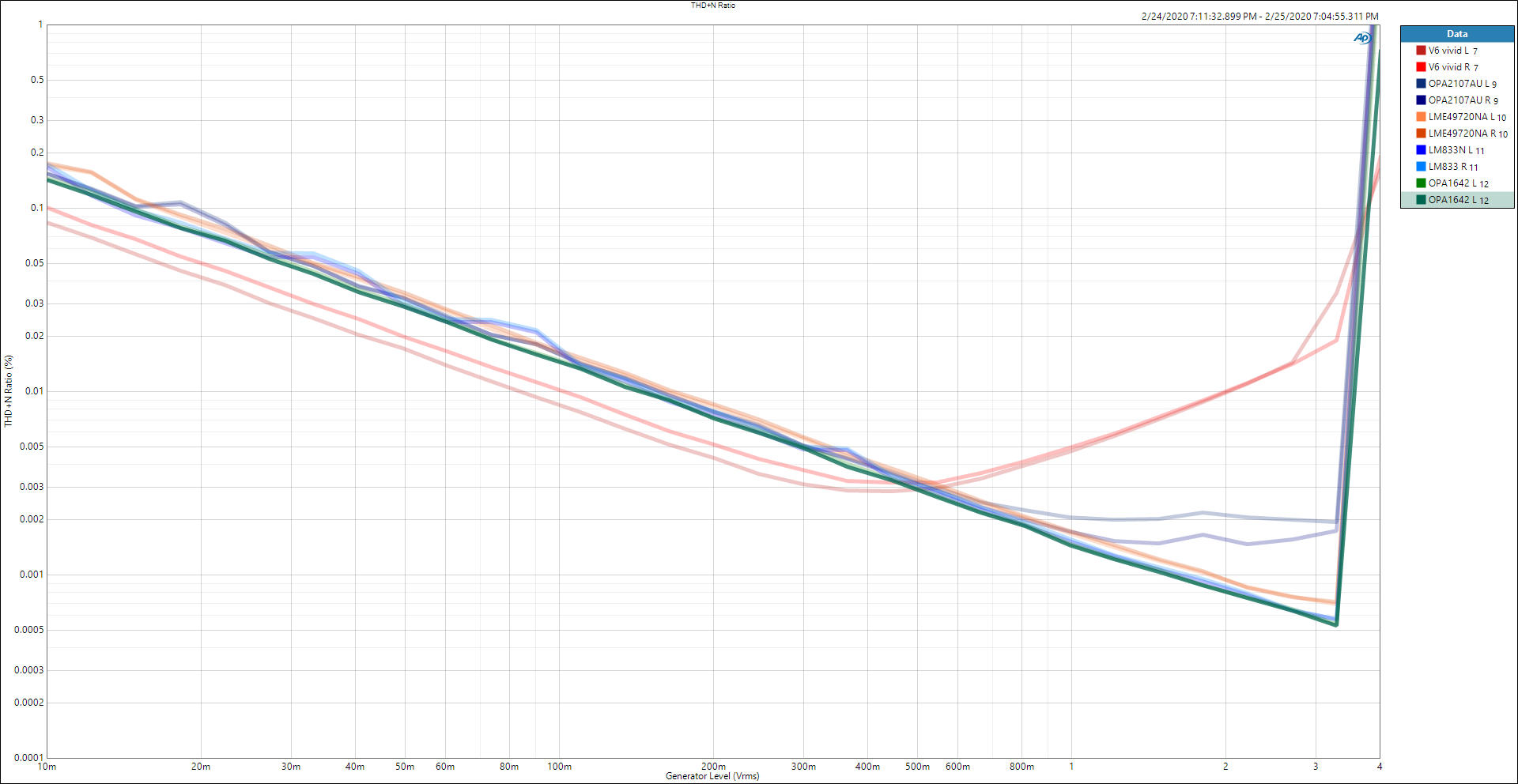

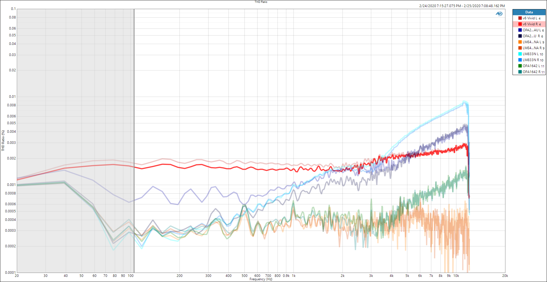

I've been measuring various Op Amps (Burson V6 vivid / OPA2107 / OPA1642 / OPA2156 / LME49720 / LM833N) with Audio Precision APX555.
The objective measurements can be found here.
Overview:
Sighted subjective comparison was also performed. (blind testing still pending).
Yes, the V6 burson has higher distortion at highest output levels (above ~5Vrms), which realistically is never used in my case.
I have yet to perform better measurements and identify criteria that could correlate with my subjective impressions.

No NE5532 or LM4562 comparison? (Thanks for the hard data, BTW, its good to see this).
(And 1/f noise measurements (noise spectrum) would be nice, not sure I've seen those for Burson's)
Oh, for the THD measurements what is the test circuit? Common-mode distortion only shows up in non-inverting
topologies, and is often important.

To clarify, I am not measuring the Op Amp or its specifications itself, but rather how it behaves in my specific headphone amplifier circuit.
LM4562 is said to be basically identical to LME49720. I ll look around, I think I have the 2 that you mentioned left somewhere.
As for the circuit topology, it is a nested voltage gain with mostfet output transistors.
For schematics, see my blog (signature) or Diyaudio link:
"WHAMMY" Pass DIY headphone amp guide
I'm just learning to do some proper measurements. I am still looking for the equivalent of a waterfall, but for the attack as well, using audio precision.
By the way, I would not do the full blind test (due to coronavirus), but for the 3 DIP8 package Op Amps I got, putting a sticker with number on them listening and then revealing the chip behind the number works out nicely.
So far 2 rounds of 3 op amp blind test, I had 100% recognition for each. I'll have to ask a friend/colleague for blind test including DIP8/SOIC/V6 vivid.
