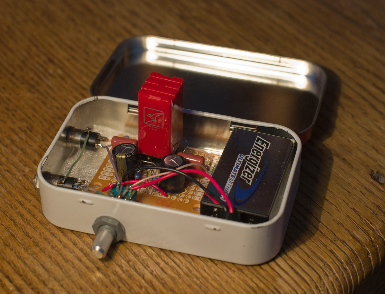

My first setup- as pedestrian as it sounds, is a Basic CMoy circuit used as a general purpose preamp. The only modification is the use of a TLE2426 rail splitter reference to an OPA134 active ground scheme. I usually run my favorite opamp here- the OPA2132P. It's quiet, clean, and sounds good, with a characteristic dark/mellow Burr-Brown "signature" that I happen to think sounds flatter than some more expensive opamps. I also have a pair of OPA627 on a browndog adapter I run on occasion, although it's a trivially simple circuit for such a fancy chip. It performs excellent in this preamp, but it doesn't really shine too much better than the OPA2132 in this application- maybe for use with very clean reference monitors, or very nice headphones. I also have a selection of other opamps on hand I will call out on occasion for comparison.

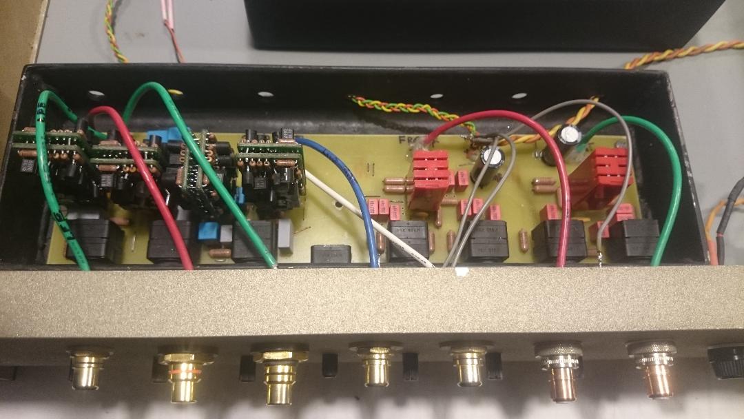

I have used monolithic and discrete opamps significantly in R&D over the last 5 years. The V6 Vivid are close to being the most transparent (only second to Sonic Imagery 992/994 discrete bipolar). The Sonic Imagery is very demanding on the power supply. The Burson are not quite as demanding, but they won't perform best unless they have a very localized power supply capacitance. See if you can put a 100uf Nichicon FG across the +/- rails right at the op amp location (bypassed with a .1uf MKP of course). Or even some 47uf on each power rail very close to the op amp.
Hi friends
IC3 and IC4 of deq2496 were used in output buffer
amplifier sony ta fe600r player ibasso dx90
I tested the deq2496 at flat settings when you plug it into the device, the AB class will sound like A class from A amplifier. A remarkable point,
The V6 Vivid Opamps have a very vivid voice. Neutral and detailed sound with a tight bass effect dynamic field perfectow and medium tones are very accurate and have exactly as needed. Bass is quite low and deep
The V6 Vivid has a clean and clear treble response.
Highly dynamic, impressive and detailed musical.

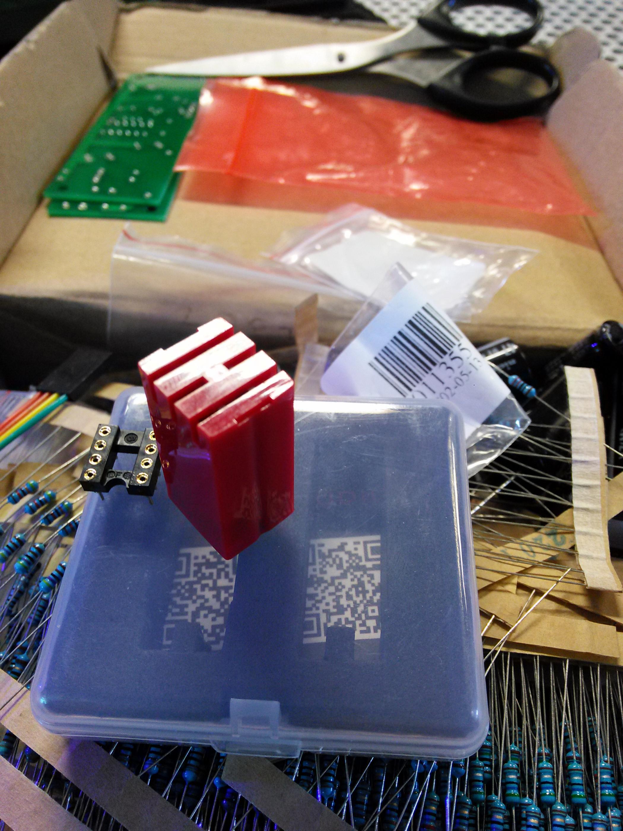

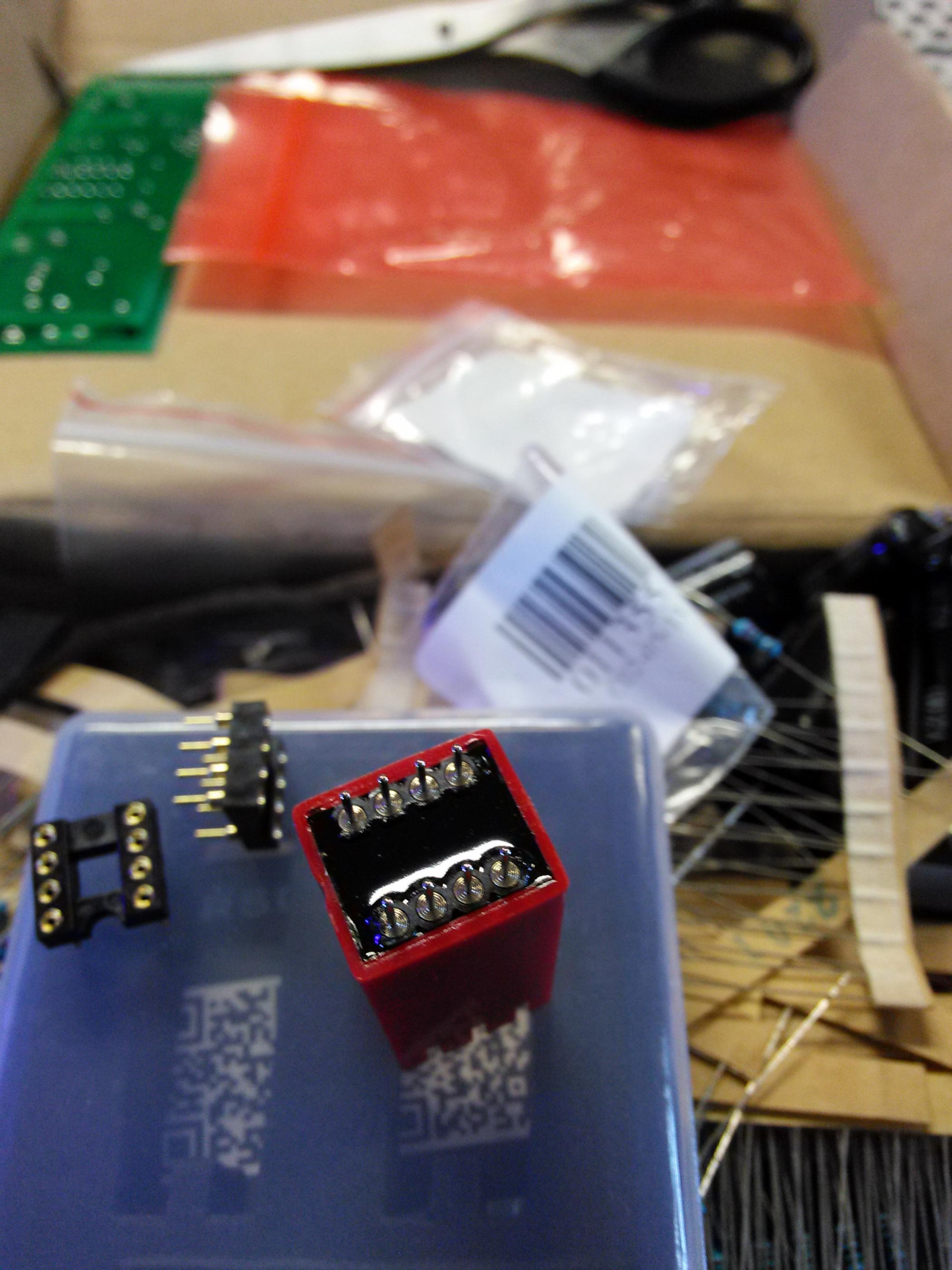

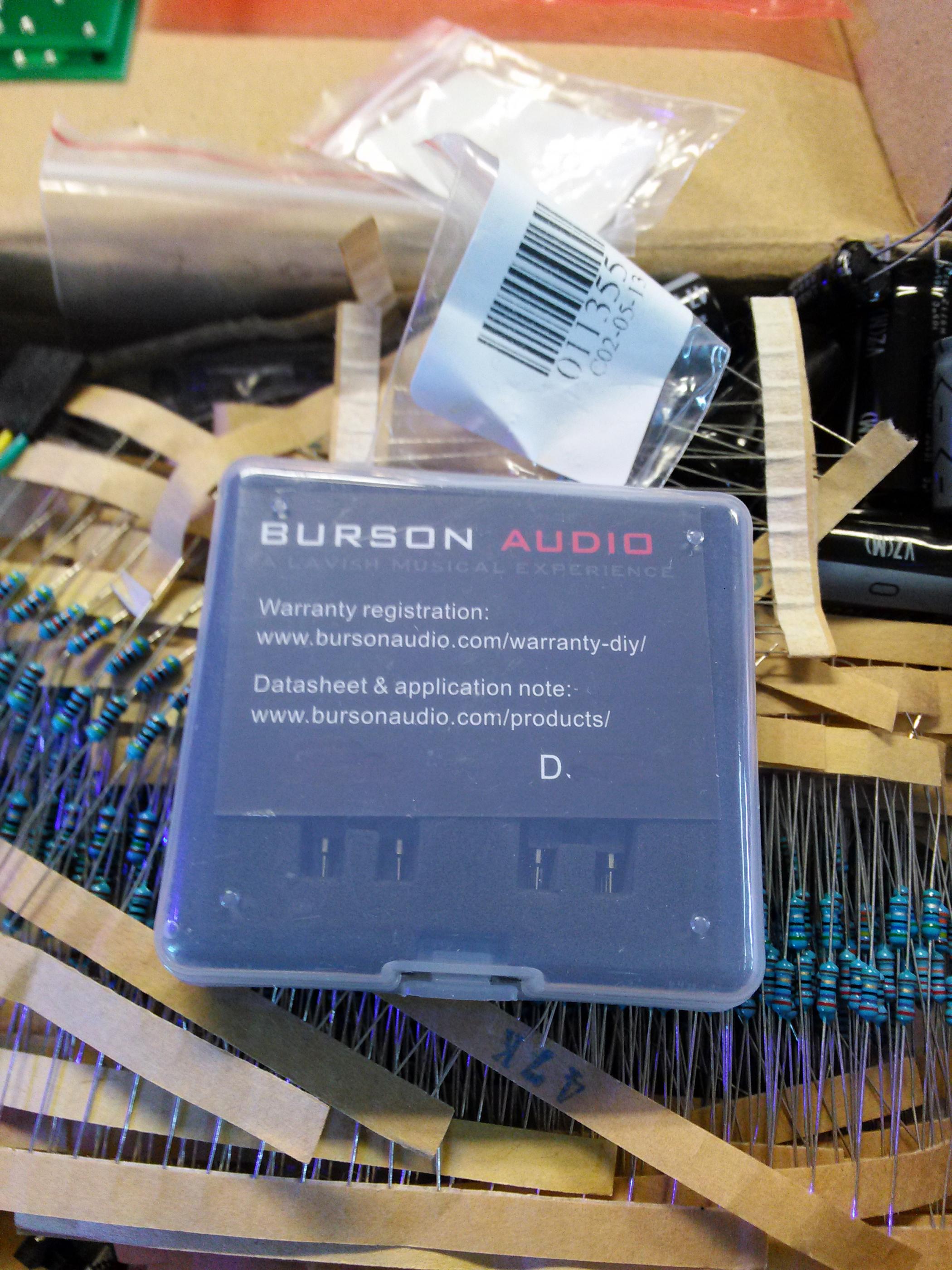

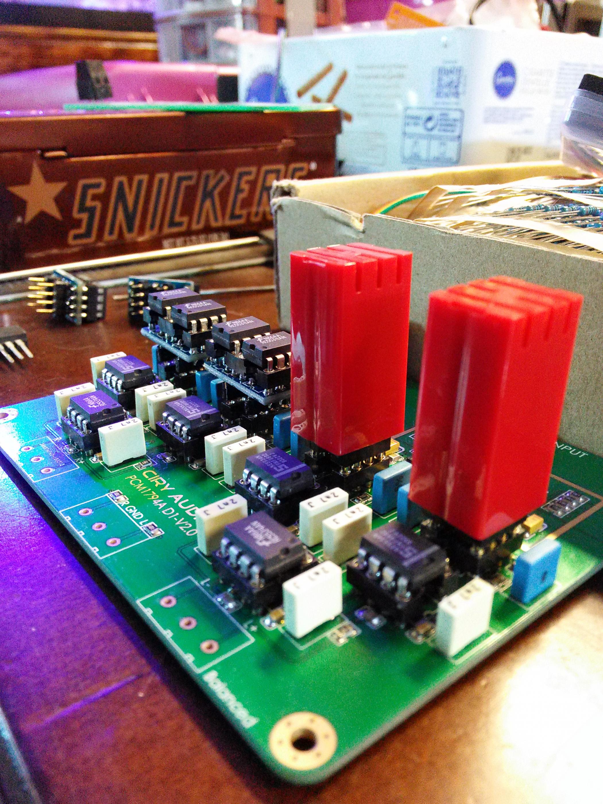

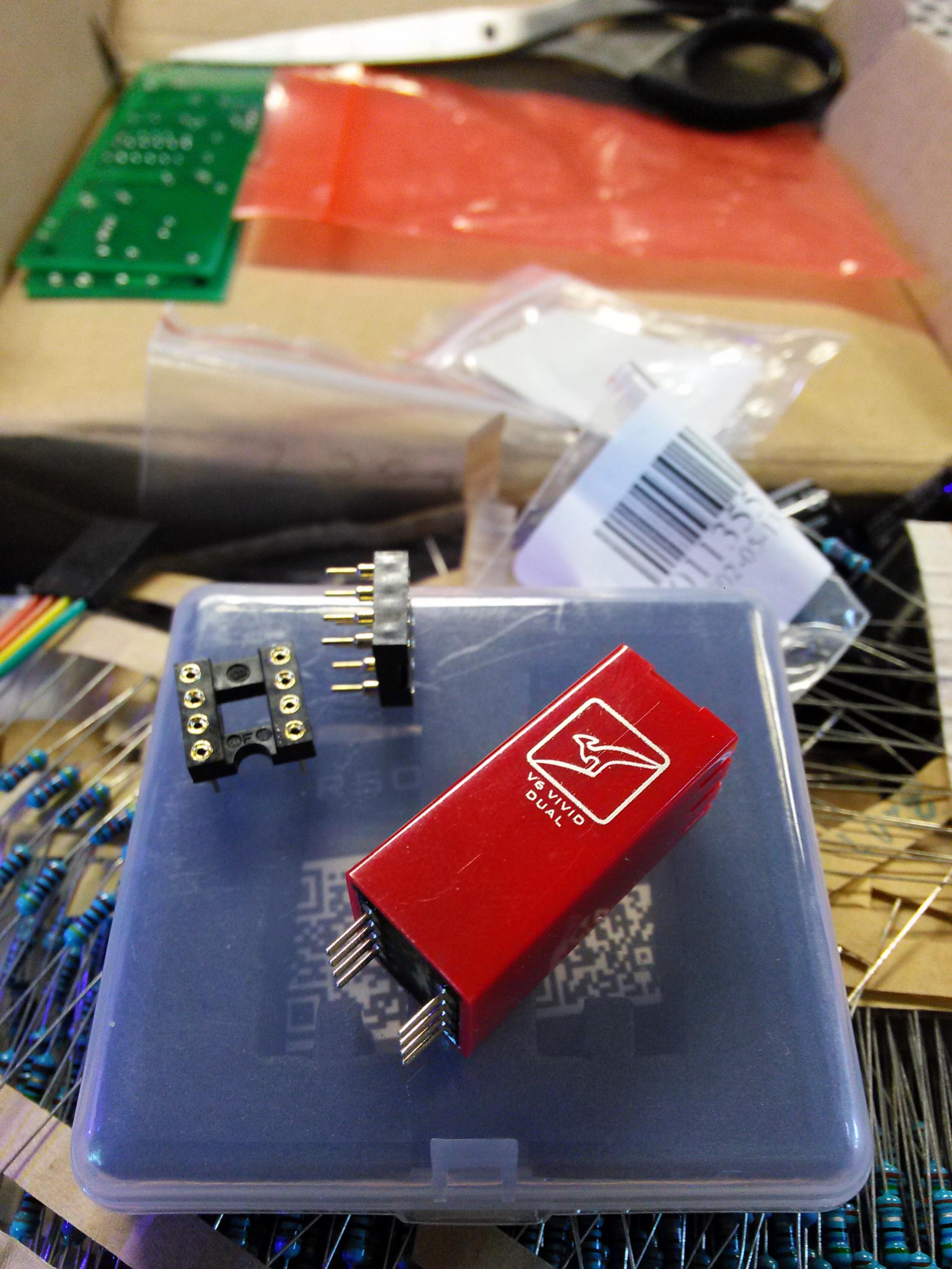

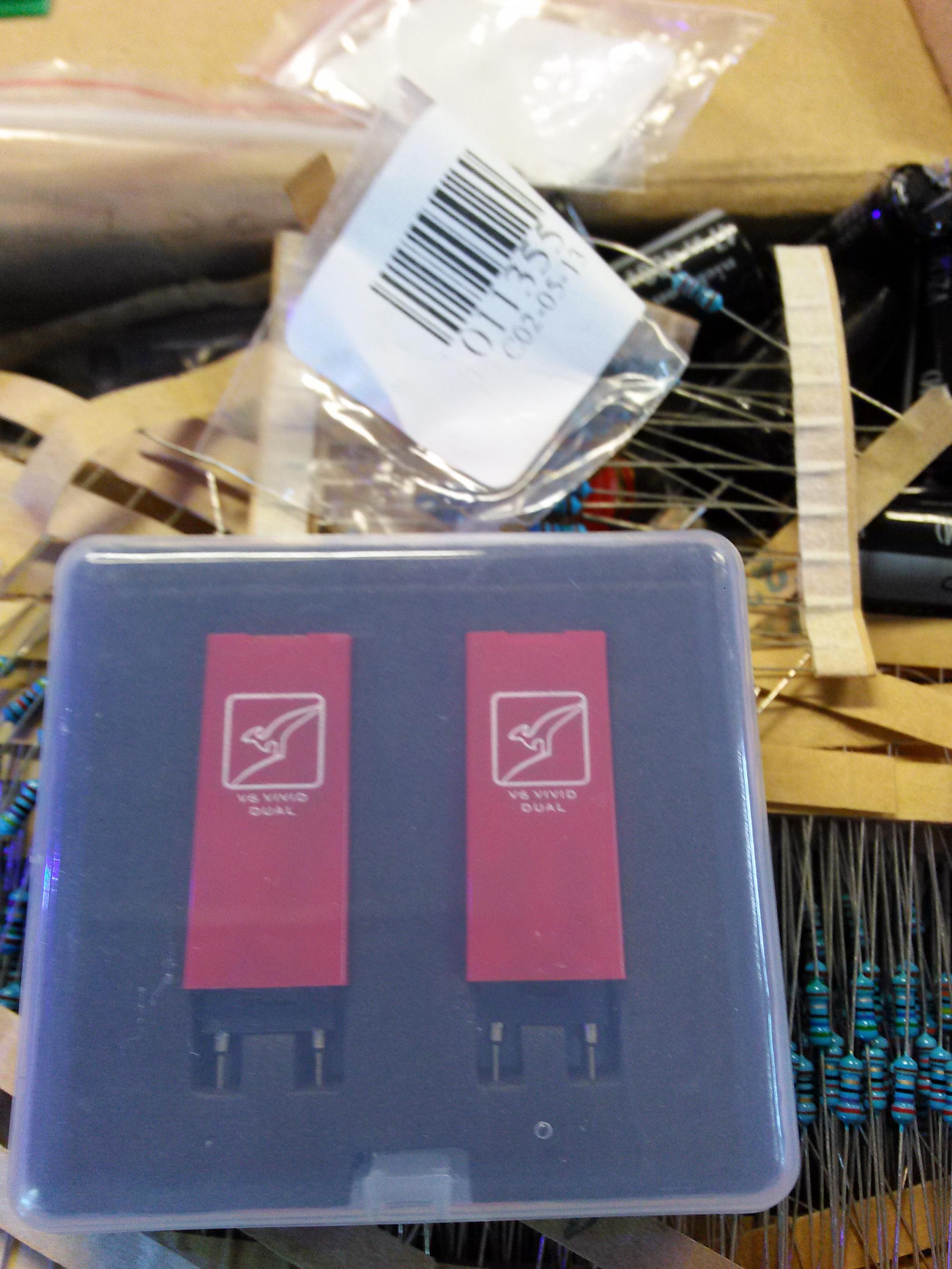

Sorry for the long wait, severe lack of time and persistent hand tremors have kept me from spending much time with a soldering iron, and DIYaudio in general. I managed to almost complete a board that I plan to use these in, and of course now that I've gone to take pics the Cmoy amplifier I built for these is missing
This is just some preliminary pics to show how they are shipped, and the size compared to other options.
They ship in a nice little snap-shut plastic case, with a dense, tight-fitting foam insert, very nice attention to detail honestly.

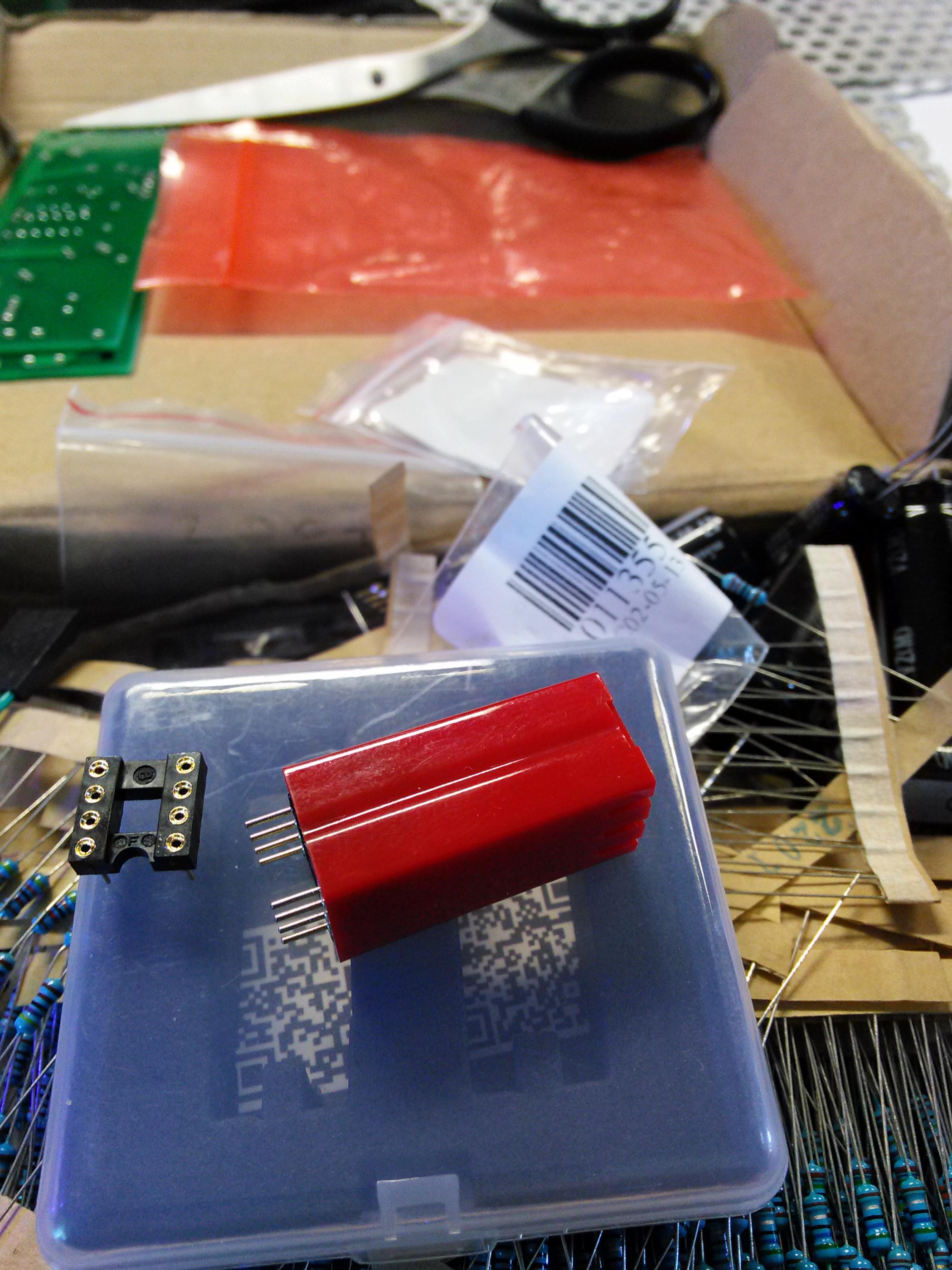

They come with a pair of gold-plated DIP8 sockets, which is a nice addition.
They also are potted in epoxy at the bottom, and feature nice machined pins-

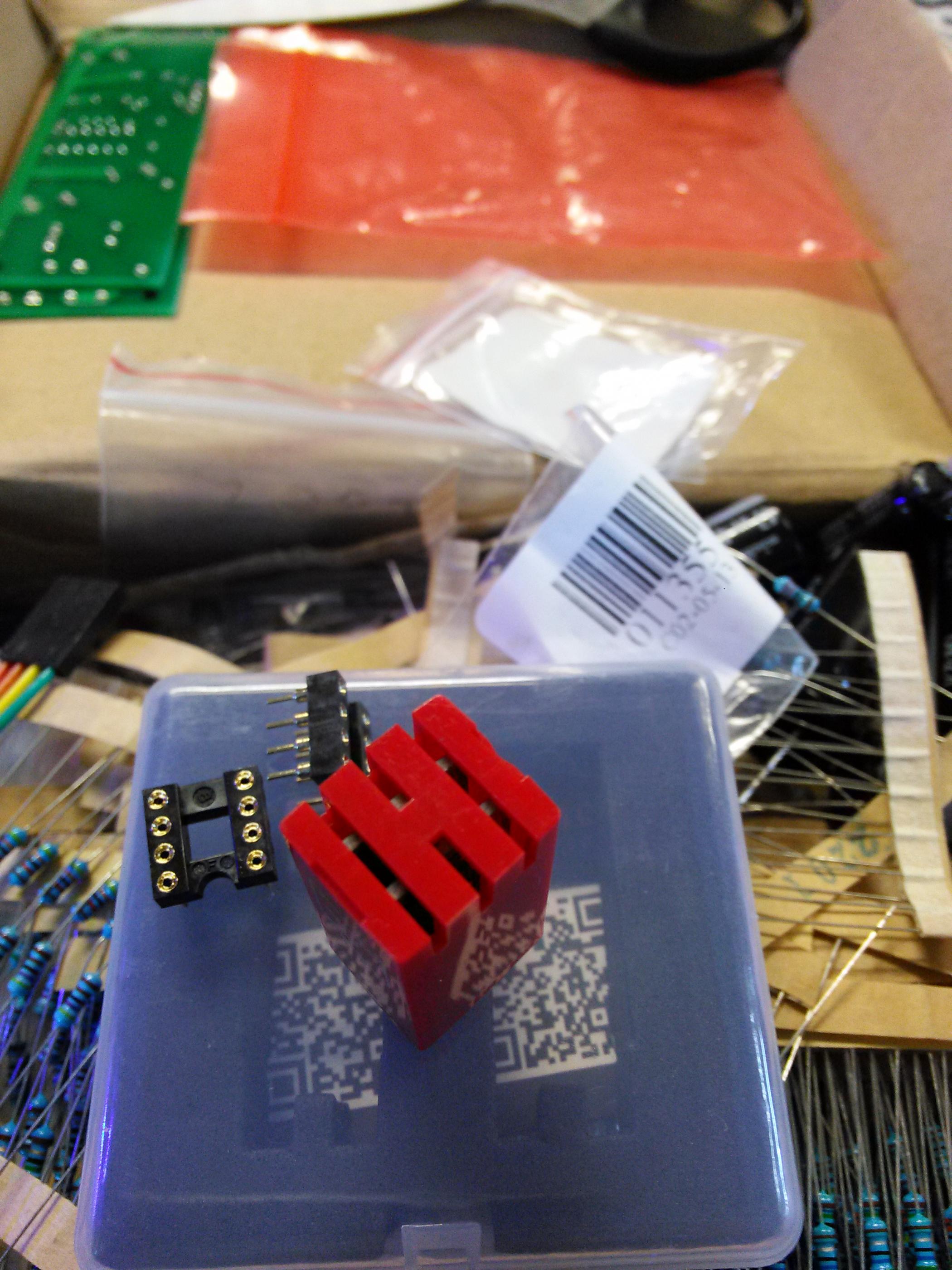

The case has ventilation slots at the end, and you can see two internal PCBs. With no openings on the bottom to draw air through I'm not sure how effective these will be, but they don't seem to run all that warm so I don't think thermal issues will be a concern.
They do feature a prominent notch along the entire length of one side, corresponding to how they are located on most "standard" DIP8 opamps. It'll be hard to miss which side is which

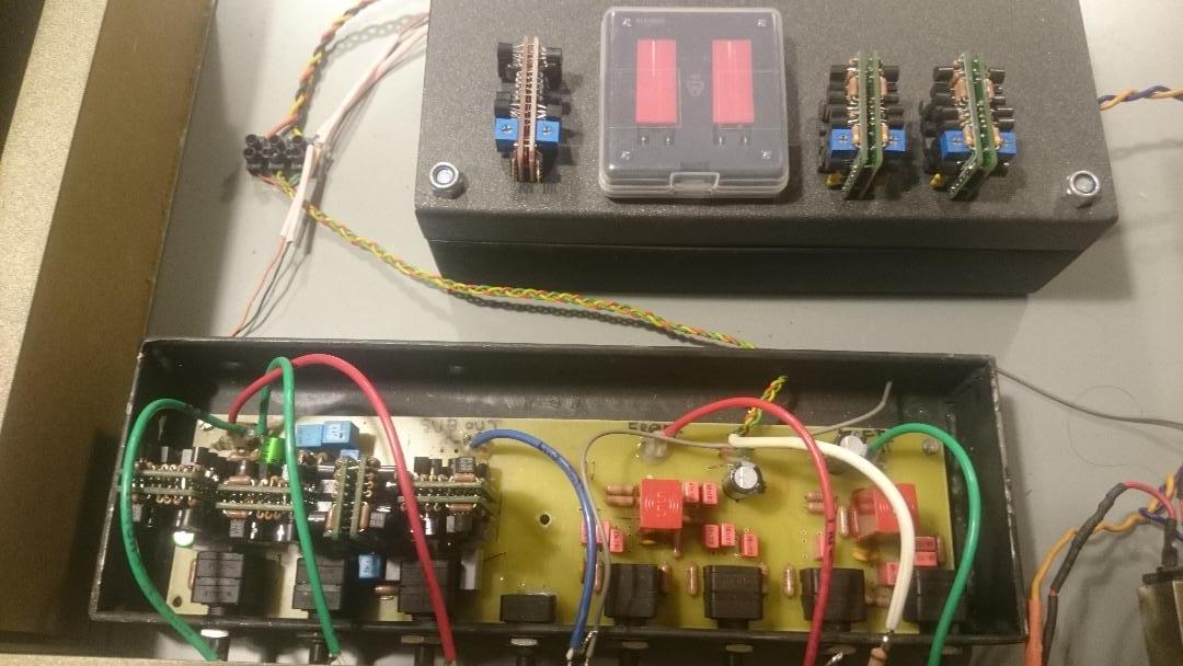

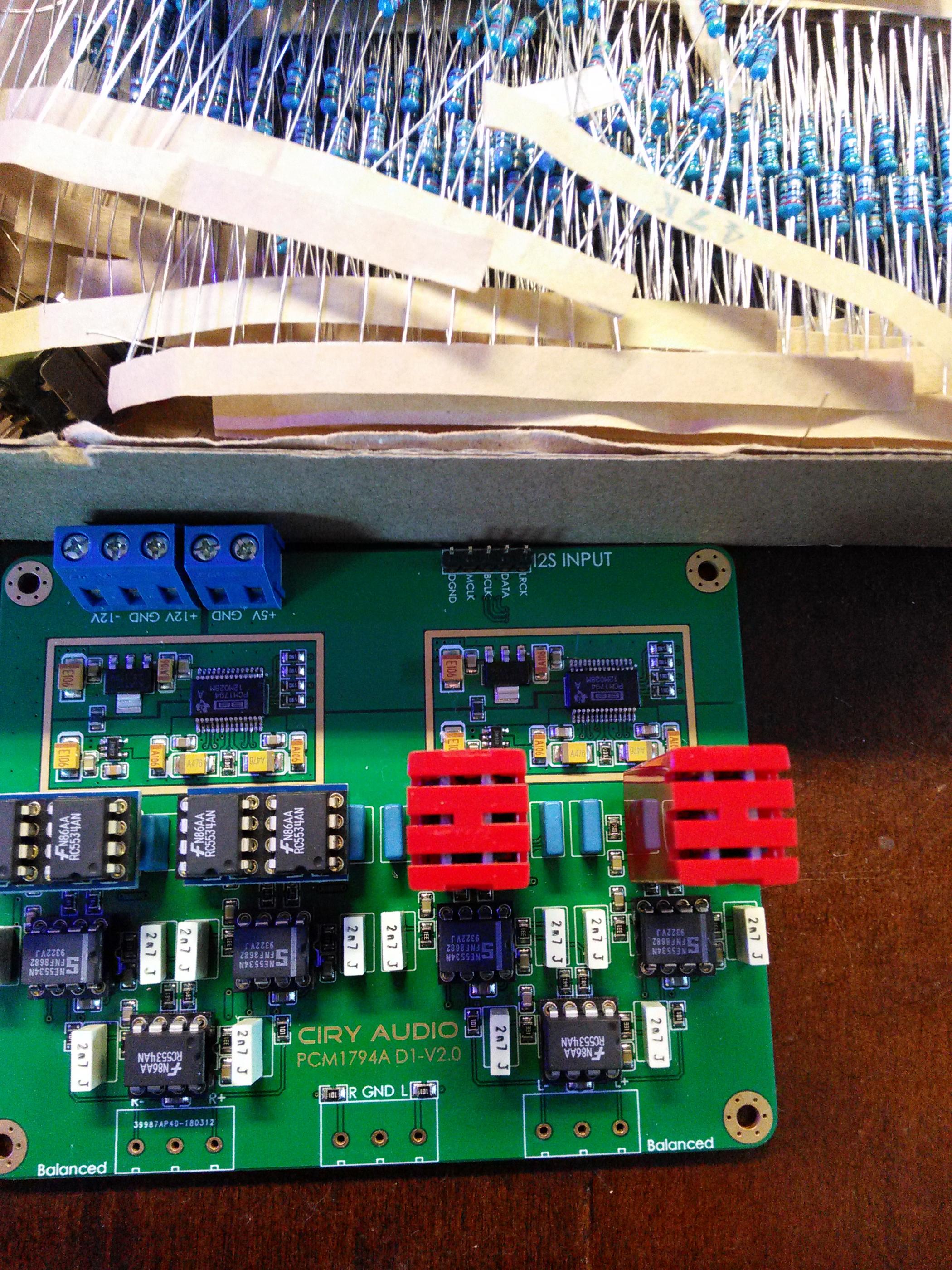

Here's a shot of them installed on the in-progress DAC I'm working on. Nice comparison between single opamps, dual singles on an adapter, and the Bursons. These guys are tall- twice as tall as the dual single adapter boards once installed.
They are however quite narrow, which may work out well for installation into commercial gear where the chassis may be large, but board space is cramped-
Initial listening impressions in the Cmoy were good, but the DAC isn't ready yet to comment there, of course. I'll dig for the Cmoy and get some pics soon. Initial listening impressions there are that you really want higher voltage for best sound, two nine-volt batteries in series worked well. Sound very, very close to the OPA627/637 opamps, but with their own signature that's hard to explain. Laid back, but detailed? I'm really bad at those sort of descriptions, but would love to put these on a THD analyser setup, and see what the frequency response is like.

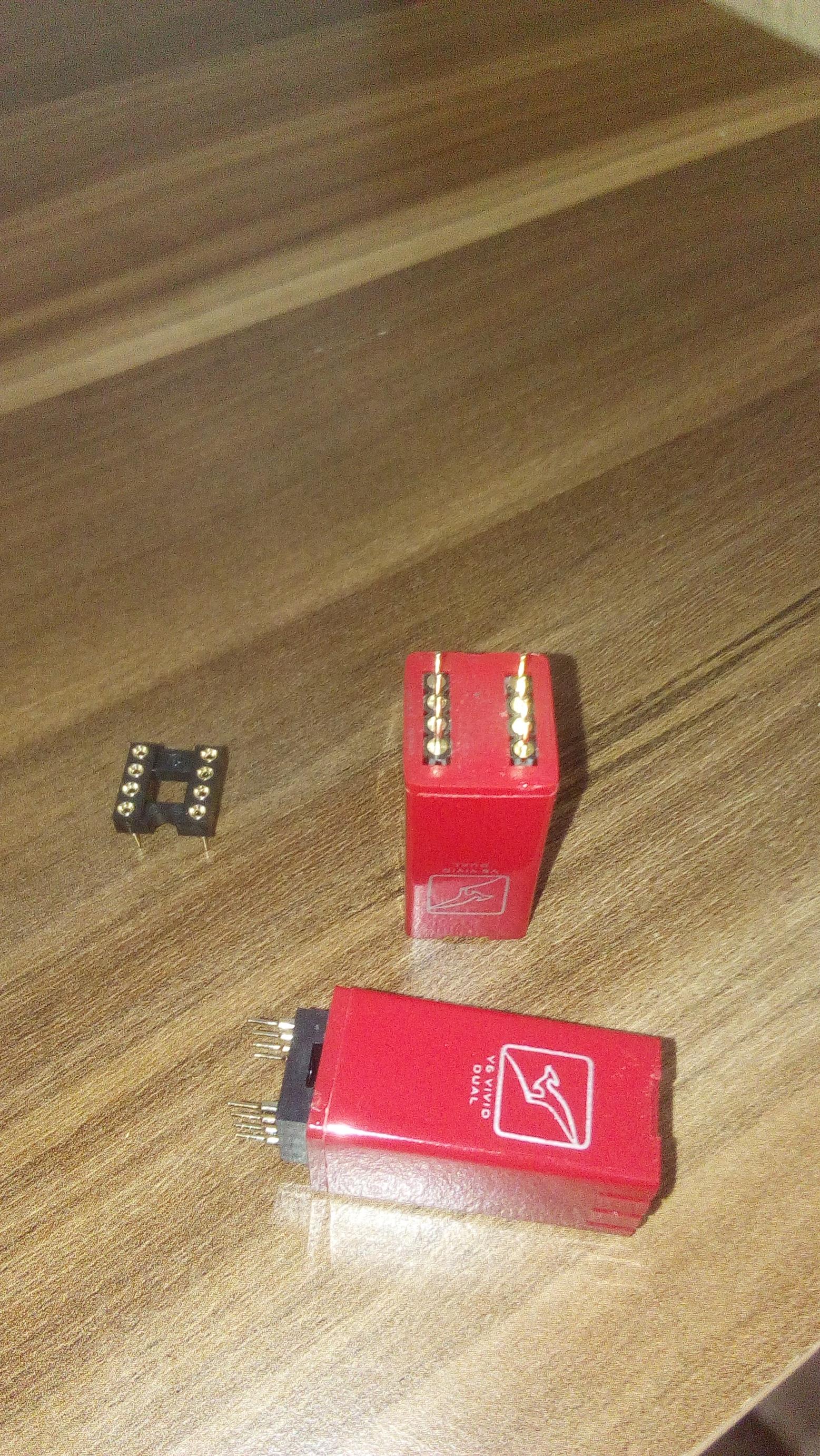

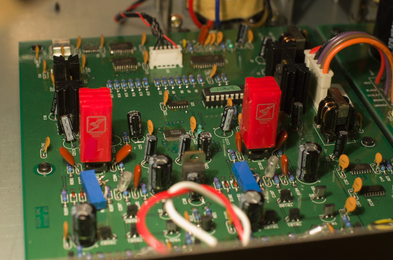

My burson v6 vivid dual dip8
Burson V6 Vivid
Before I start writing a review of my listening impressions of V6 Vivid I would like to thank Charles and Burson Audio for their generosity to supply me with the last generation of V6 op amps.
The package arrived in excellent condition with a delay, I suppose due to the Easter holidays or slower postal procedures but without any problems at customs.

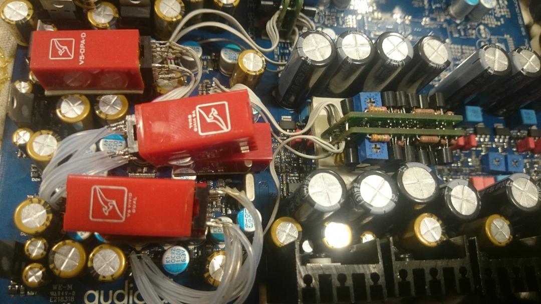

Speaking frankly as an old Burson fan who has over 15 op amps (as you can see from the attach.) starting from the older ones like V3 generation, through V4 and V5 I was expecting that V6 should be on step further in sound improvement.
My main Hi-Fi rig consists of Audio lab M-DAC, diy tube preamp with 5687 tube, Primare A32 Dual Mono Amplifier and Pioneer/TAD S1 EX loudspeakers which I consider as a very analytical system. Also I have another active system with P.Audio concentric mid/high loudspeaker and Beyma 15” bass. And of course DIY active x/o fully moded with three generations of Burson op amps ! Music that I listen is mostly classical and orchestral jazz.
So I decided last month firstly to change op amps in my DAC and as I know my sound quite well was expecting to hear difference immediately.
Originally DAC was equipped with NE5532 and NE5534 op amps which I changed them two months after the purchase with Burson V5 generation. So I took V5 out in the I/V position and installed V6.
The sound...hmmm...The first impressions of the jury consisting of two old and experienced audiophiles, one professional musician – prof. of clarinet and myself is the holographic 3D stage, huge as a trunk of a Cadillac. It is the difference that is obvious at once after the first 2 seconds.
Also I know from my earlier experience in capacitor testing that Mundorf Mcap Supreme Silver/Oil caps can produce an excellent three dimensional illusion and I put them in place of my FT-3 coupling caps at the output of the
tube preamp. And that was the situation I have never experienced before. Simply stunning! A very good combination regarding 3D stage. But something was missing and the sound after a longer period of listening became fatiguing with metallic and sort of aggressive ingredient among many others virtues. Yes...the dynamic was better comparing with previous V5 or NE5532, sound had more details with controlled bass.Sincerely speaking I am afraid I was listening to highs with a lot of sibilance which shortly after became annoying.
But I remember I read somewhere that Bursons need 100 working hours for burning in to show their real nature. Was that recommendation coming from their technical team or not can’t remember really. And I spend the last 15-20 days listening to a local FM jazz radio at very low level.
Last week the jury gathered again and we played our favorite music. The change of the sound was obvious although I admit I was not firm believer in burning in of opamps. For loudspeakers - yes that is rule but for the rest of the electronics...hmmmm....I don’t know...simply can’t explain....
Now I am positive! Vocals especially females lost their aggressiveness, acoustic and amplified instruments sounded more natural and the bad recordings show their bad sides. The overall sound was with a lot of details and with balanced smoother character. Everything was enjoyable and non fatiguing.
Next couple days I continued listening to different musical material and mostly was impressed with the female vocals coming through Vivids. Perfect harmonic rich structure. The voice of Natalie Dessay was like never before – clear and rich.
After a week I moved and changed complete system with active x/o and PA drivers.
Put all Vivids alternatively in high pass, band pass and low pass sections and listened carefully. There was always significant change in the sound overall mostly noticed in the midrange and in this system it was consisted in details. I suppose it was due to the higher sensitivity of the drivers. A lot more information, more tiny details than previous BB2604, V3 and V5 had reproduced. Bass was also punchy, deep and veeeeery fast ! Highs were very extended, clear but with a pinch of aggressiveness (these are by the way PA drivers…!) which I suppose is welcomed for those listening heavy metal or rock music.
So are these V6 Vivids worth the money?
First it is all dependable of the quality of the complete Hi-Fi system what and how much will you hear the difference. My system is highly transparent and can show every change in the chain. Or if you put it in another way less expensive and lower quality electronics and loudspeakers might not show such a big difference. So be careful!
Anyway Burson Vivid V6 are excellent op amps and I highly recommend them.

Like other folks in this thread, I responded to an ad from Burson calling for people to review their latest generation opamps. I was selected to test a pair of their dual V6 Vivid opamps in some of my DIY projects, and was sent them free of charge (provided I posted a writeup such as this one). In both of my test cases I made back to back comparisons with the excellent OPA2132, which I have been using for many years.
Chu Moy
I built this Chu Moy headphone amp on half of a RadioShack (remember them?) vector board. It uses the schematic from Tangentsoft, but it uses a single 9V battery supply instead of the recommended 18V.
In doing some listening I found the Burson had more detail, was smoother and less harsh. Cymbals in particular sounded more natural. I noticed new details in familiar recordings, for instance I was able to tell for the first time that on a particular track guitar strings were being plucked by hand rather than with a pick. When I was doing something else in addition to listening (browsing this forum or playing a phone game) I found the music harder to ignore while the Burson was in the circuit.
The 2132 exhibited some noise (hissing) which differed between channels which may indicate the voltage was too low for the 2132. The Burson had much lower noise in this application.
Musical Fidelity A324
This DAC shipped from the factory with NE5532s in its I/V converter role, and not long after I bought it (second hand), I removed them from the circuit board, and replaced them with DIP-8 sockets in order that I should be able to do tests like this one. At the same time I removed the output DC coupling caps as well as a resistor and replaced them with a short and a potentiometer respectively, in order to null DC on the output. This mod was the idea of GeorgeHiFi and they describe it here: musical-fidelity-a3.24 mods.
OPA2132s have sat in those sockets since I conducted my first tests several years ago. I plugged the DAC into a SOHA-II hybrid headphone amplifier and AKG K-701 headphones into that.
When I plugged in the Burson, I noticed changes similar to those I saw in the Chu Moy: less sibilance/reduced harshness, with better instrument separation. I noticed new details, for instance, what I previously thought was an instrument was someone singing. It did something which I find a bit hard to explain, in that it made dynamic/volume changes seem more pronounced (does it have more gain?), which made things seem more dramatic. Overall it was somehow simultaneously smoother yet more detailed.
In both the Chu Moy and the Musical Fidelity A324, it seems like the Burson V6 Vivid is a straight sonic upgrade over the OPA2132, which is something I rarely encounter.

Burson Playmate OPA upgrade
To the replacemant of the I/V OPA1612, the Burson V6 vivid dual operation amplifiers arrived. Thanks for Burson & Carlos!
Here we can see the new opa-s on my photos.
OPA1612 V6 vivid
The Moode audio player 6.3.0 was my music playback (as usual) for the Raspberry Pi 3B+ single board computer.
I was surprised by the quality of the Audiophile Lounge internet radio (320 kbps mp3) playing similarly to a live quality flac music source as OPA1612 was replaced by the Burson V6 Vivid.
The Burson V6 sounded superior to the 1612 and it clearly heard at the first listening section.
My very first impression was that I am listening to an amazingly lifelike music.
After a hundred hours long continuous usage, the well-known music became more detailed and nice, when new textures appeared.
I noticed the very nice atmosphere of the recording stage as well.
Gregorio Paniagua: As the music plays on, the instruments were not could be heard as spot-like, but more defined and well-spreading. Every note from the chords could be correlated to the strikes of the strings. The shaw-teeth were counted by one by one while the power saw worked. The fluting had a nice airy sigh.
Natalie Dessay’s singing and the rich textured voice of the instruments from the baroque era are sounded like a live concert experience.
Yello:When I heard just the bass section only, it made a fully detailed, very soft and rhythmic impression.
I was fascinated by listening to Hong Kong High-End Audio Visual Show album because of the well dimensioned, huge stage effect and clear tune.
Interestingly, the tracks of albums compressed with less bitrate (like 128-256 kbps mp3) are enjoyable, and well reproduced.
