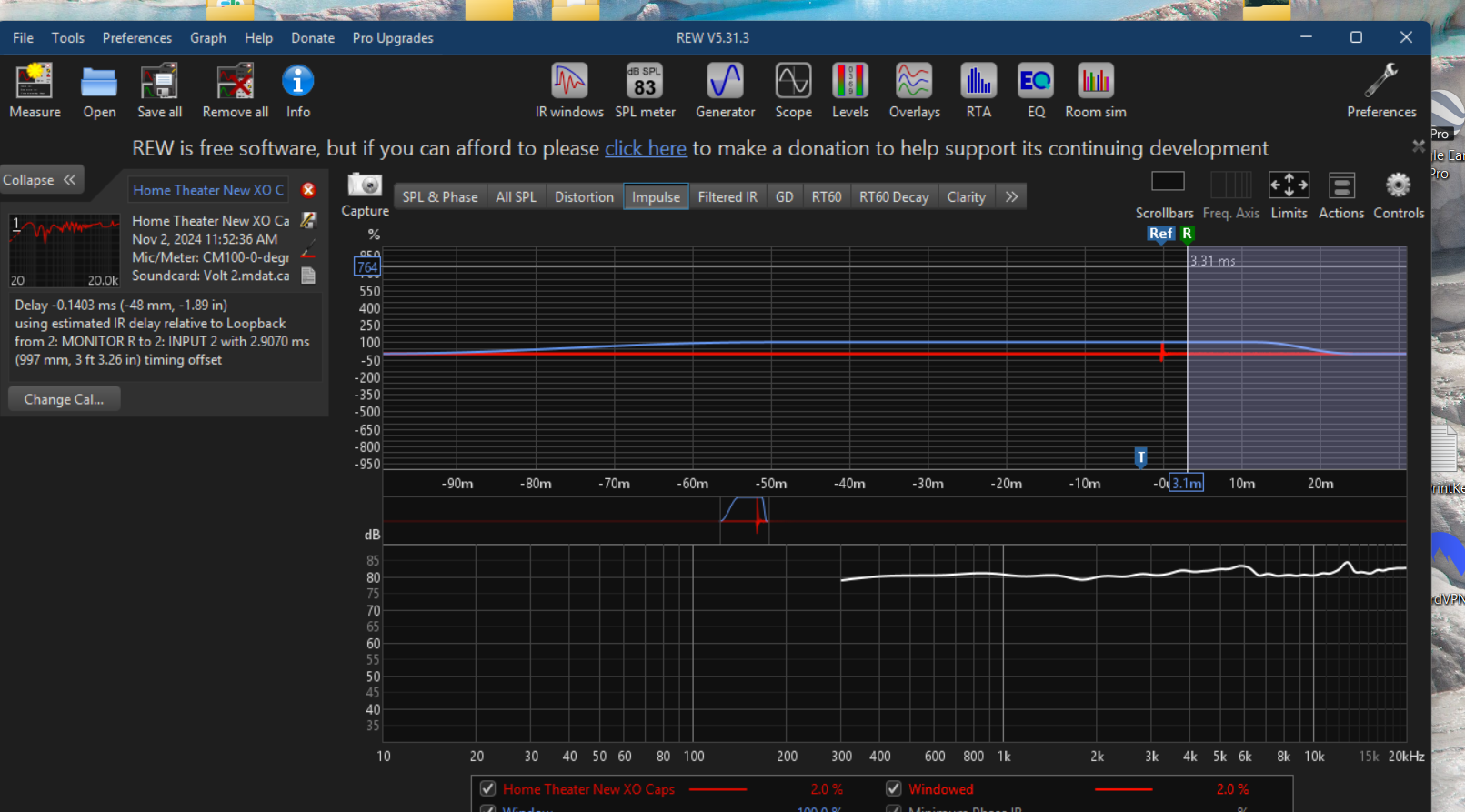

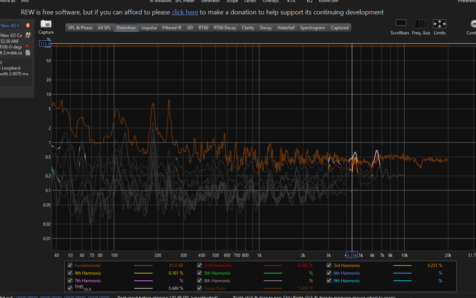

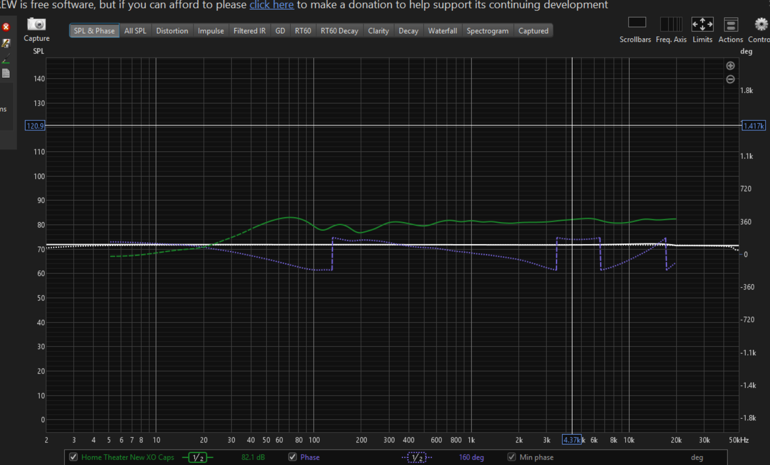

This is it gated. At some point I plan to take everything I've made out to a field and put it on a very tall ladder so I can get full range measurements. Averaging a little over 0.6% distortion. Within 3db accuracy. Low end is all messed up because I took these at home in my very small Chicago living room.
Pretty decent I think

The speakers frequency response might be decent, but I can't quite tell because you are using more than a 150dB wide scale with 10dB divisions. It is more common to plot the response with only about 40dB for the entire vertical axis. Can you do that?
Distortion is good above 500Hz, not as good below. You didn't mention what sort of SPL level you are using for playback during the distortion measurement, and this is important to know. If that is at 104dB at 1m then wow. If that is at 84dB at 1m then we are talking about something more normal for home hifi.

Thanks! That would be great if you could do outside. It's also possible to do a gated measurement >300-500hz so its pretty accurate even indoors and then splice a nearfield below 300-500hz like JA/Stereophile. On axis and off axis of course. Maybe scaling 40db to 90db or so so like Erin does gives a pretty clear picture.
