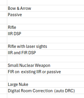

The lesson was that the ills of passive components like capacitors and inductors are far less onerous than the evils of complex active circuits. Anytime you can solve a problem using a "bow and arrow" instead of "nuclear weapons", you should.
I can see how in yesteryear that was probably true, say 20+ years ago. And maybe then it was fair to classify the ends of the spectrum so radically different...ala bow and arrow vs nuclear weapons.
Here's my idea of a current weapon comparison chart ...🙂

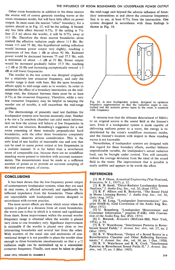

Have you made a system with this ideal alignment?I wouldn't say floor bounce is one of the things you need DSP to solve. In fact that would tend to be the wrong way to address that problem.
I would start by reading this hoary classic paper by Roy Allison
"The Influence of Room Boundaries on
Loudspeaker Power Output"
https://audioroundtable.com/misc/Influence_of_Room_Boundaries.pdf
The way I recommend you deal with floor bounce is the way Allison Acoustics and Boston Acoustics did it back in the 80s which is a 3 way with a woofer crossed over below the frequency where the floor is more than 1/4 wavelength away, and your midrange quite a bit further up. NHT had a good approach in the 90s as well.
Or go with a 2.5 way, where you have several smaller woofers in an array down to the floor and each is a different distance. That also mitigates floor bounce.
There's no real elegant way to deal with it when you have a 2-way, other than a 2-way with a full range driver covering 200hz-20KHz at some distance away from a woofer that's near the floor.
I do find this interesting that it sort of flies in the face of conventional hifi speaker placement. Everyone always says to move it at far away from the wall as you can whereas this is showing the closer you can get it to the wall the more flat you can make it.
I did, many times, for some projects.Have you made a system with this ideal alignment?
On the picture is Allison One. That kind of woofer placement demands 3-way loudspeaker.
Well, it is conventional, if the loudspeaker is designed that way. Many good examples through the years.I do find this interesting that it sort of flies in the face of conventional hifi speaker placement. Everyone always says to move it at far away from the wall as you can whereas this is showing the closer you can get it to the wall the more flat you can make it.
But in many rooms it is impossible to place loudspeaker close to the wall, so many loudspeakers are designed that way.
This paper explains pros and cons and what and why for on the wall loudspeaker placement, with measurements: https://jeeit.feit.ukim.edu.mk/index.php/jeeit/article/view/347/328

Both approach have some validity. Although with typical commercial loudspeakers, the close to wall placement usually needs electronic equalization, to tame the excessive low frequency energy.I do find this interesting that it sort of flies in the face of conventional hifi speaker placement. Everyone always says to move it at far away from the wall as you can whereas this is showing the closer you can get it to the wall the more flat you can make it.
Woofer-mid crossover frequency of Allison One and Allison Two is pretty low at 350 Hz, so it doesn't matter much if it is at the center or off-axis.What is the measurement method used then? Just right dead middle of the two down the center of the baffle as if it were one driver?
