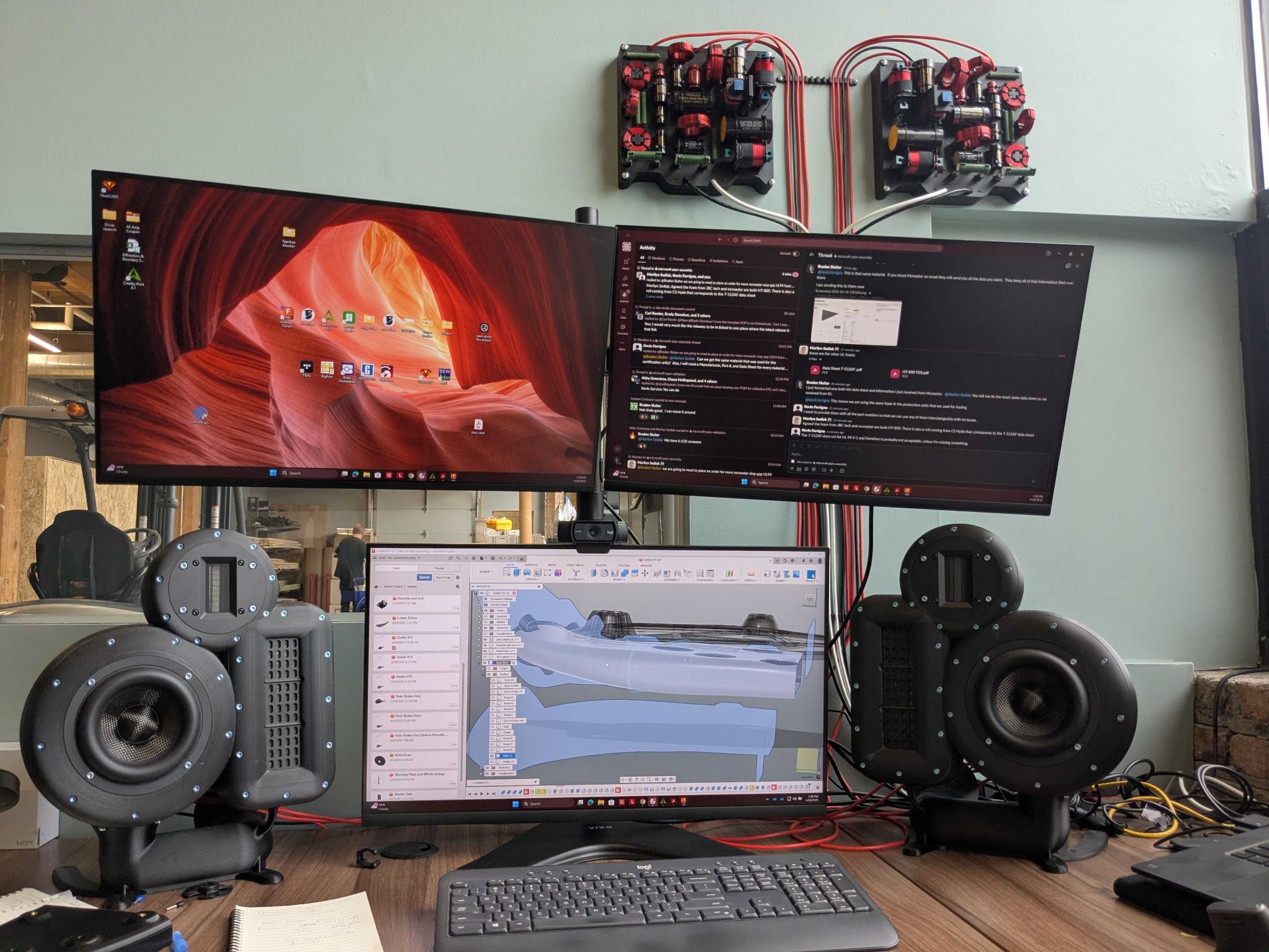

Well, @Bmsluite is not agreeing with you:
There is a big difference between something that has to sit on a desk and something that can stand in a room. The design he proposed would not fit within the print area of the 3D printer.
The other design he proposed would have covered 1/3 of my upper two monitors or, I would have had to move my monitors so high up that I would strain my neck to see them.
It is for an office. I have to do actual engineering work in there. The kind of engineering work that actually pays my bills.
This was the available square area possible to be used practically which, in the engineering land I live in, is everything. Pragmatism is king.
Your tweeters could be vertically aligned with the midrange drivers using the same printer.
A restricted horizontal listening position is even more confining at a desk than in a room, as the direct to reflected ratio reduces with distance, masking off axis polar frequency response deviations.
As a guy who's sound engineering work "paid the bills" (before retirement..) the first thing I notice in a speaker design is that any vertically non-aligned driver arrangement creates unsolvable polar response problems, and require the crossover (yours look very nice) to be a compromise for one horizontal alignment axis at one specific distance.
Using stereo desktop monitors with three video monitors, my head would definitely move side to side and rotate enough where that arrangement would be unacceptable.
I can notice that problem even with a single 21" monitor, and my HF hearing is definitely far below "normal".

They could not. Not with the necessary wave guide to tame the planar mid. I have hundreds of hours of CAD and design into those monitors. I tried just about every configuration in theory, and soooo many in reality. The only way would have been to offset them which would have made them 3 pieces and thoroughly screwed up the impulse alignment of the drivers.
Well this was a trade off. I'm a sloucher in my chair. I move more vertically in my chair than I do horizontally. I modelled it both ways and decided to vertical and hortizontal offset of the drivers was better to have a slight horizontal cancellation with less of a vertical hole. I am literally bobbing up and down in my chair right now as I write this so I believe I made the right decision. I almost never move side to side. I actually can't, because my desk is an L and I sit in the crux of the L
