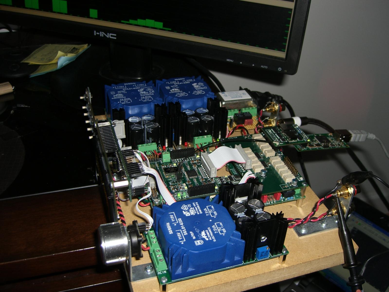

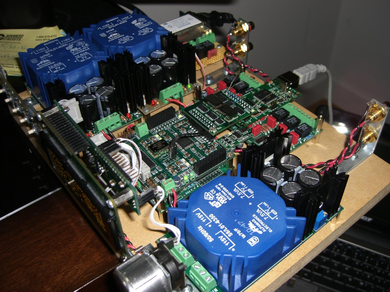

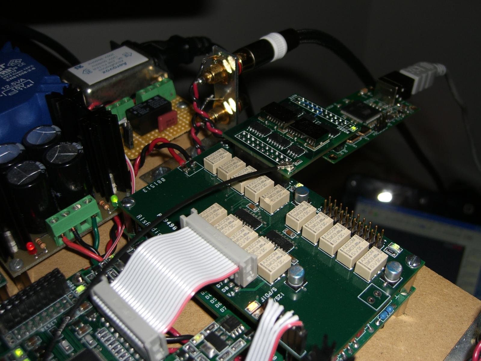

Hi Everybody,
First let me thank everybody that has expressed interest in this project. I really really appreciate it. I've been working diligently nights and weekends to complete the design so that I can make it available to everybody soon. I'm still on track to meet my completion time frame in post #65.
I'm happy to report that Amanero is working flawlessly with the new adapter board that provides synchronous re-clocking. The adapter connects directly to the DAC for those that prefer USB input only operation, or it can be connected to the Input board that provides switching between 8 stereo channels of S/PDIF, or two separate channels of I2S or DSD with all 8 channels available ideal for digital crossovers or surround sound.
I've attached three pics. The first pic shows Amanero plus the adapter board connected directly to the DAC. It's resting on top of the S/PDIF board, but the S/PDIF board is not connected. The second pic is a close up of Amanero plus adapter board connected directly to the input board. The third pic is just an overall view with foobar2000 playing in the background.
If anybody has any questions please feel free to ask.
Best regards,
Al
Best regards,
Al
Hi Al,
Thanks for the update.
I'm interested in a stereo kit. I have few questions for you.
1. Why did you re-clock the the input from Amanero usb board? If the USB board has re-clocking after isolation from usb receiver chip, can I connect it directly and get the same advantage?
2. Can I connect one i2s input and spdif input directly to DAC board and use the ES9018's on-board multiplexer to toggle between the inputs?
Ravi
Ravi
Hi Ravi,
The Amanero does not provide isolation on the outputs. The outputs come out of a CPLD and then connect to the output header. The Atmel USB chip provides the input data to the CPLD. I re-clocked the CPLD I2S/DSD outputs to reduce CPLD additive jitter.
You can connect I2S/DSD and S/PDIF inputs to the DAC directly but you'll need a way of controlling the necessary on-board registers to toggle between the two inputs. The ES9018 will not do it automatically.
Thanks for the interest. I'll put you down for a stereo kit.
Best regards,
Al
Best regards,
Al

Hi AR2,
Thanks for the complements. To your questions.
1. Does I/V converter reside on the same board with DACs or is separate?
Nop. The I'V is a separate board that connects to the DAC through headers. The I/V stacks below the DAC. If you look at post #2 you'll see a picture of the I/V board. On each side you'll see female headers that connect to the DAC's male headers. Adjacent to each female header you'll see a male header for connecting the DACs outputs to the I/V section using jumpers. Since I'm using 4 DACs in parallel per channel there's a jumper in every position.
2. Since I already have Acko's DAC boards with ESS 9012 would it be possible to use main control board and input board separately from your DAC and I/V board and control registers in my DACs through I2C connection?
I don't see why not, the I2C signals are available on a 8-pin header, but currently I don't have a separate controller board. The MCU is on the DAC board. If there's enough interest I could provide a separate controller board.
3. How would digital crossover be implemented ? Would you drop Mini Sharc between Input Board and DACs? Does that means there are separate I2S inputs to DAC board?
For the moment I'm thinking of using a miniDSP. All the I2S signals that I need for stereo 2-way crossovers are available on one of the headers. If you were using a Sharc, it would connect directly to the DAC, or you could use the input board if you need more than one input. It board provides two additional inputs to the DAC. The MCU allows the user to select between the three different inputs.
4. Since you are synchronizing clocks between DACs and Amanero and reclocking, how that will work with MiniSharc that functions at 96KHz only? Obviously, I am not sure you are using MiniSharc, but cannot understand how would you use Mini DSP with this set up.
My DAC setup will work with any audio standard with the flexibility to switch between synchronous or asynchronous clocking.
5. Any reason that you decided to use PIC microcontrolers and not Arduino, since Arduino is very popular as controller for ESS DACs.
No real reason. It's what I had in-house so I went with it.
I hope the answers help. If not let me know. Thanks again.
Best regards,
Al
