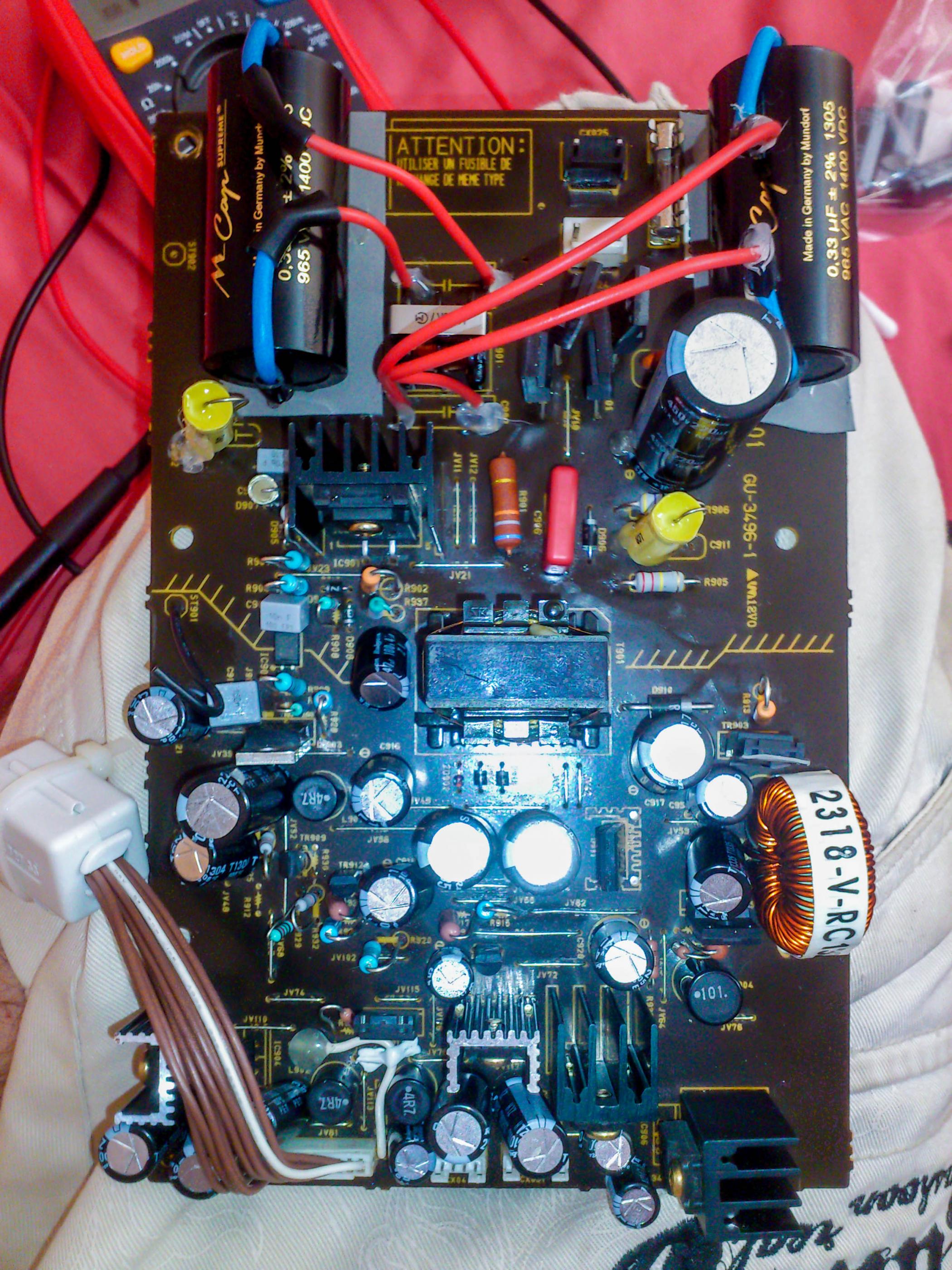

part list
ALL CF RESISTOR Replaced with
WELWYN - MFP1-6K8 JI - RESISTOR, 1W 5% 6K8
TE CONNECTIVITY - LR1F15K - RESISTOR, METAL , 15K, 0.6W, 1%
WELWYN - MFP1-470R JI - RESISTOR, 1W 5% 470R
WELWYN - PR5Y-3K3BI - RESISTOR, 3K3, 0.5W, 0.1%, 15PPM
WELWYN - PR5Y-2K2BI - RESISTOR, 2K2, 0.5W, 0.1%, 15PPM
TE CONNECTIVITY - LR1F22R - RESISTOR, METAL , 22R, 0.6W, 1%
WELWYN - MFP2-47R JI - RESISTOR, 2W 5% 47R
VISHAY BC COMPONENTS - 5093NW68K00J - METAL FILM RESISTOR 3W
WELWYN - PR5Y-47KBI - RESISTOR, 47K, 0.5W, 0.1%, 15PPM
WELWYN - MFP2-680R JI - RESISTOR, 2W 5% 680R
WELWYN - MFP2-220K JI - RESISTOR, 2W 5% 220K
PANASONIC - ERX5SJR47 - RESISTOR METAL FILM, 0.47 OHM, 5%, AXIAL

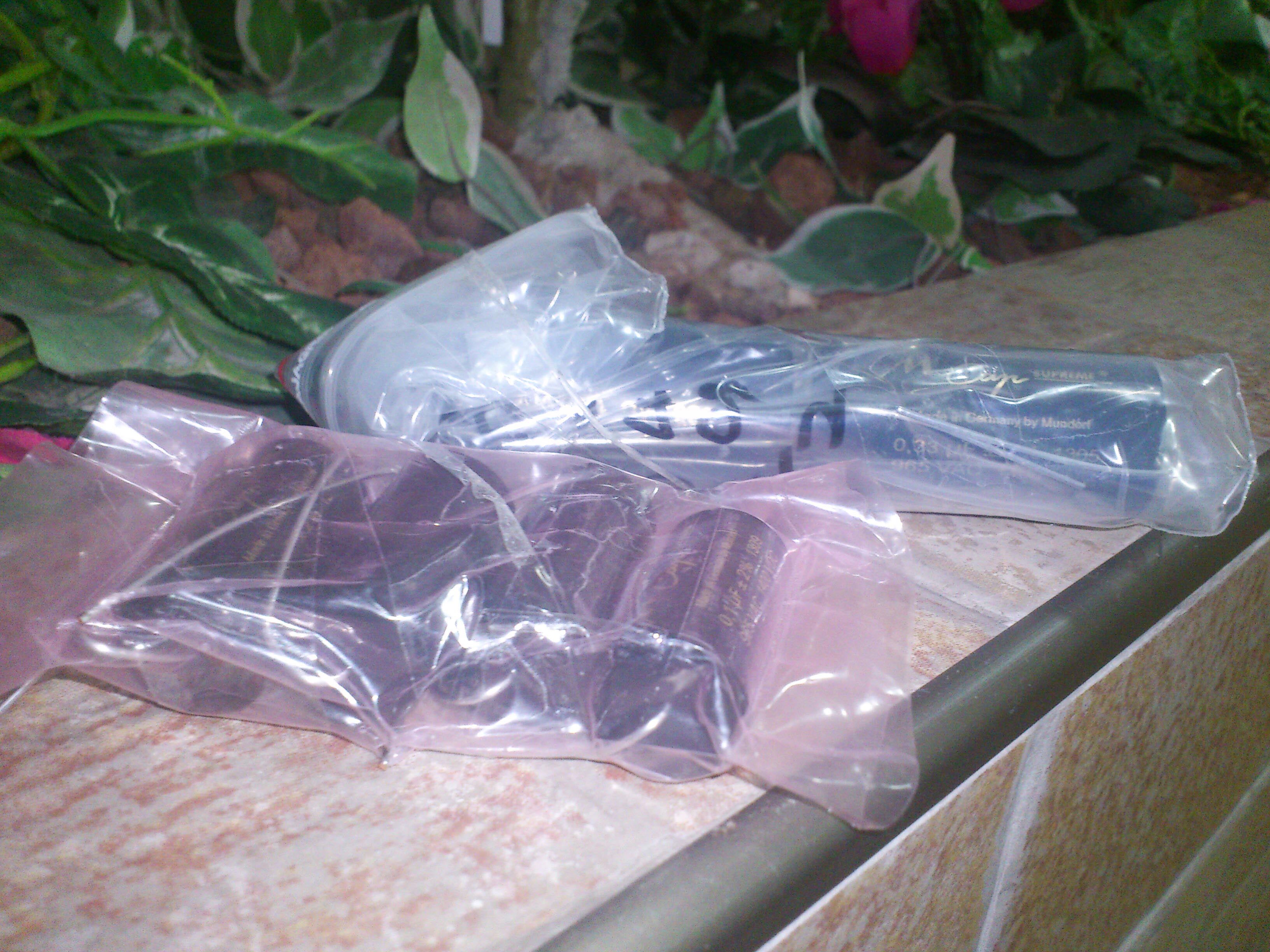

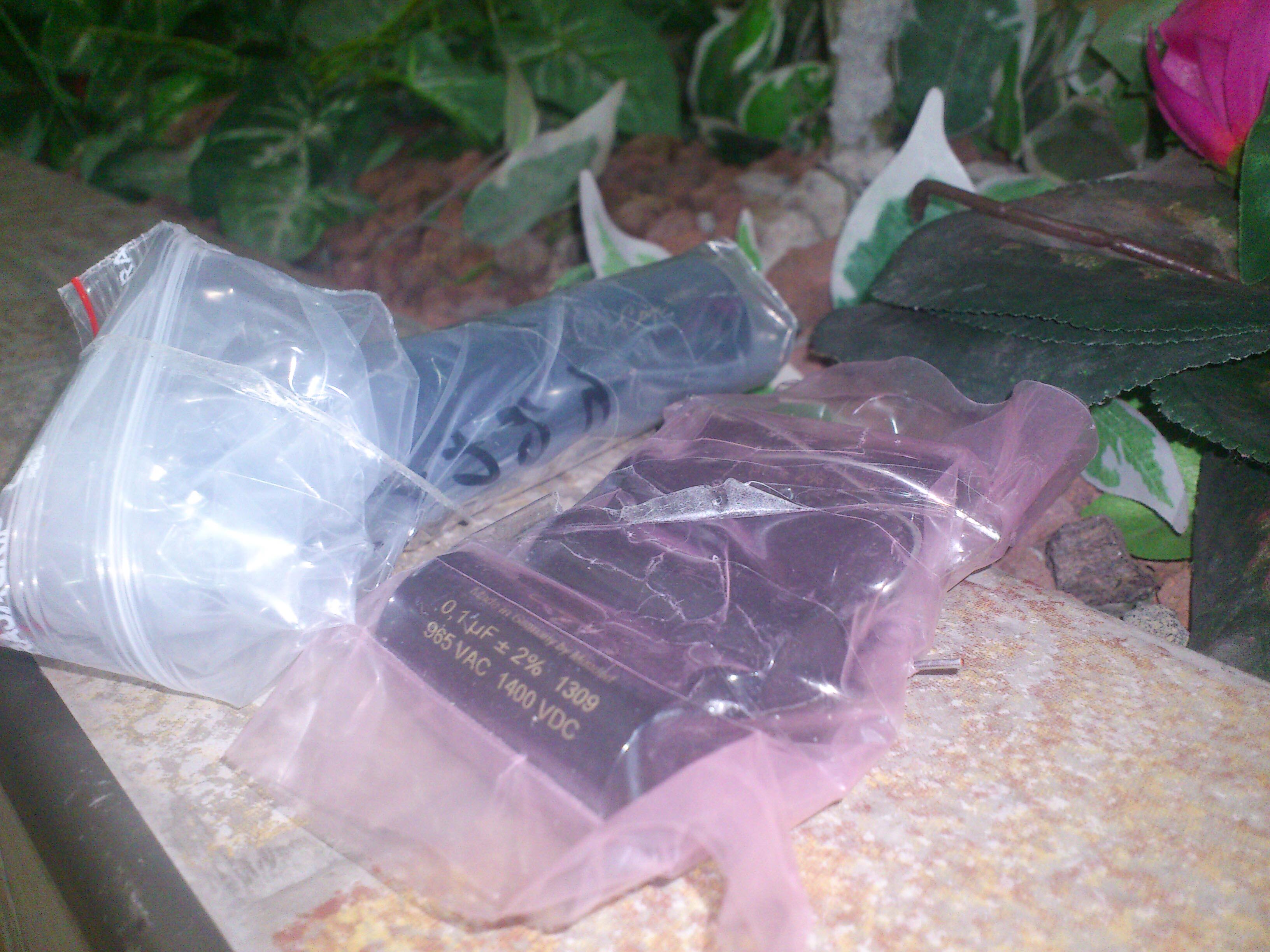

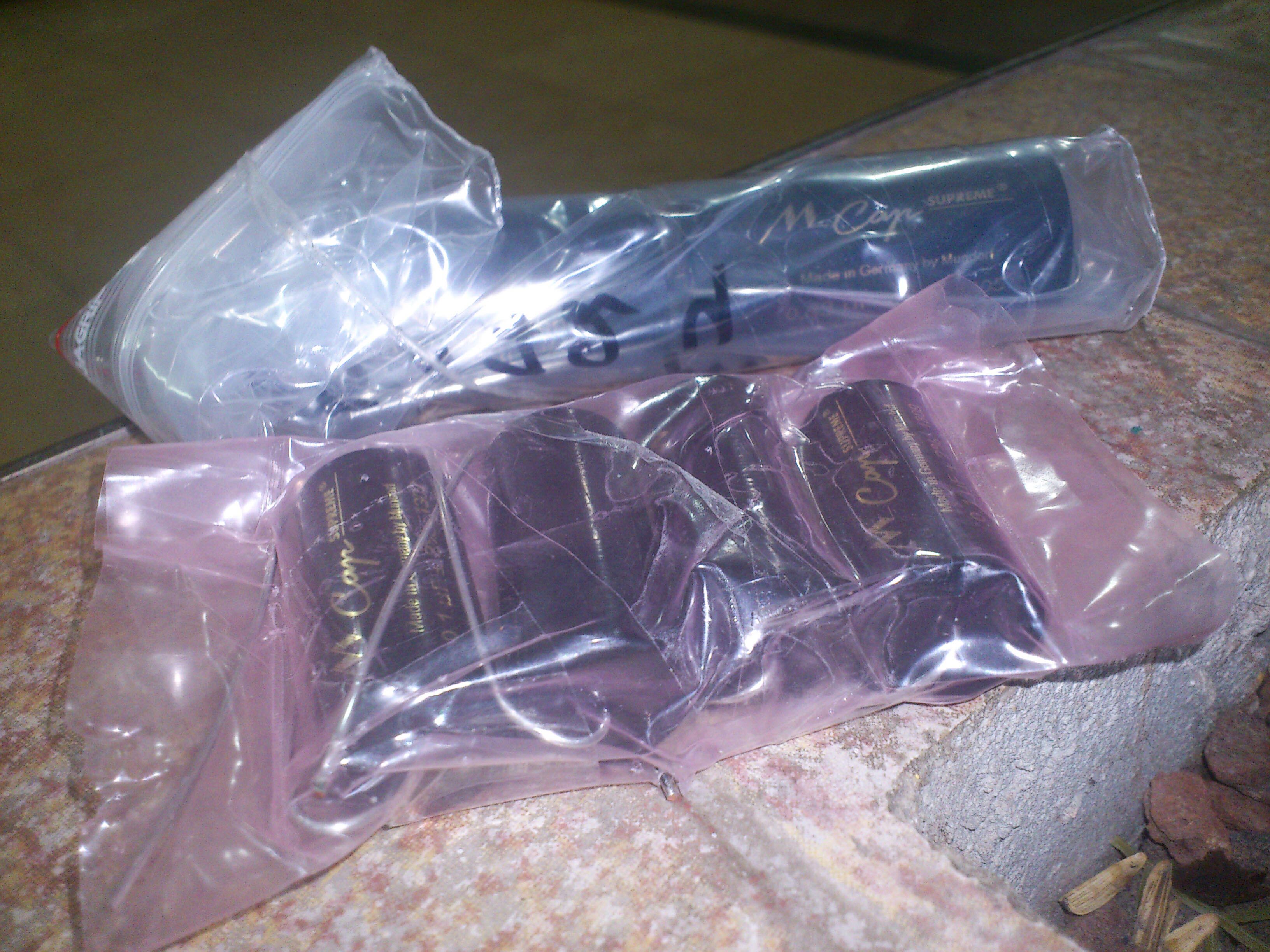

I increased the value
Two filtering capacitors of regulators
9+
9-
from 220UF
TO
1000UF
RUBYCON - 25ZLH1000MEFC10X23 - CAP, ALU ELECT, 1000UF, 25V, CAN
film capacitor 470pf
Replaced
VISHAY ROEDERSTEIN - KP1830147631 - CAP, FILM, PP, 470PF, 630V
film capacitor 2200pf
Replaced
LCR COMPONENTS - PC/HV/S/WF 2.2NF 1KV - CAP, FILM, PP, 2.2NF, 1KV, AXIAL
film capacitor 220pf
Replaced
WIMA - FKP1T002204B00KSSD - CAP, FILM, PP, 220PF, 1.6KV, RAD

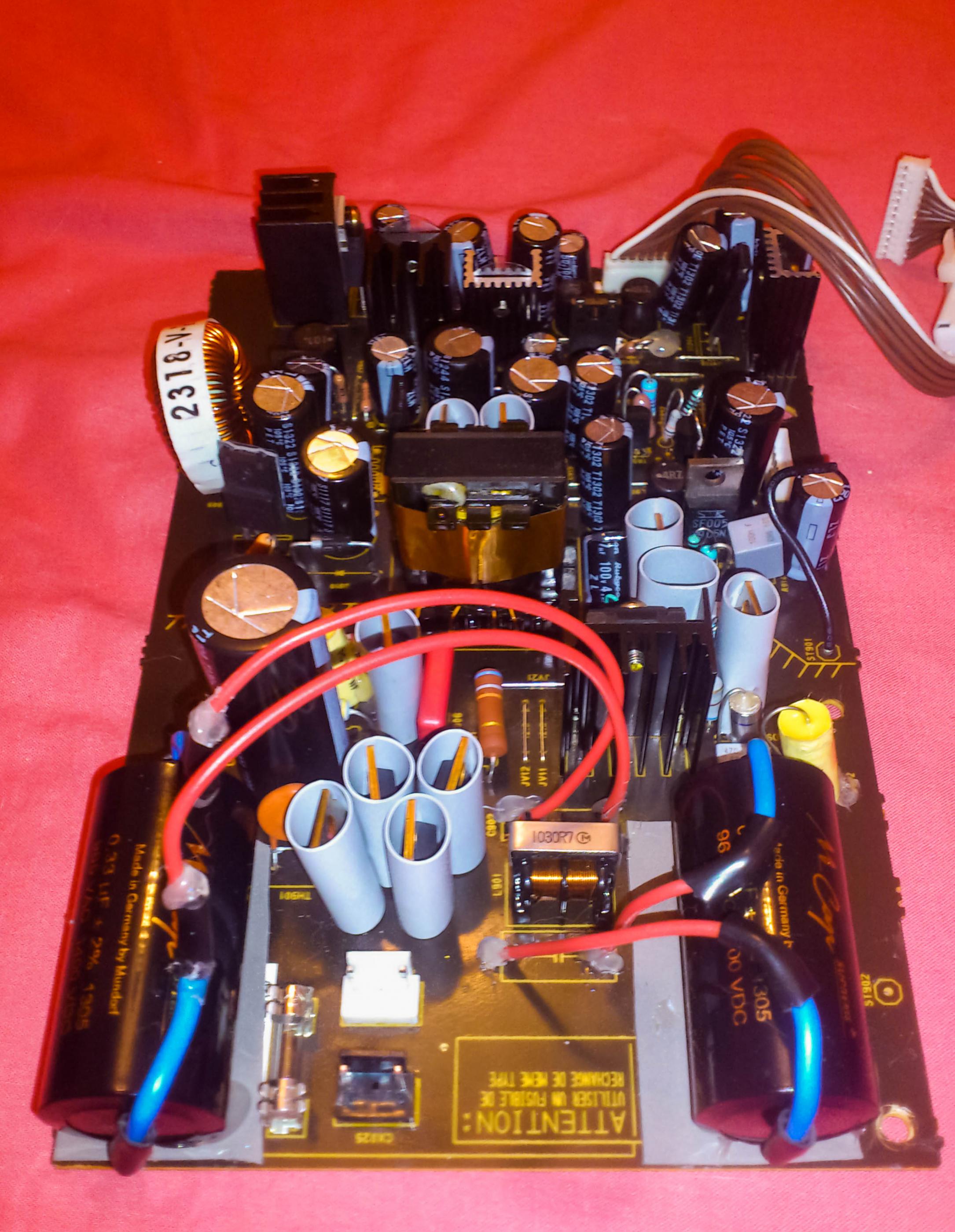

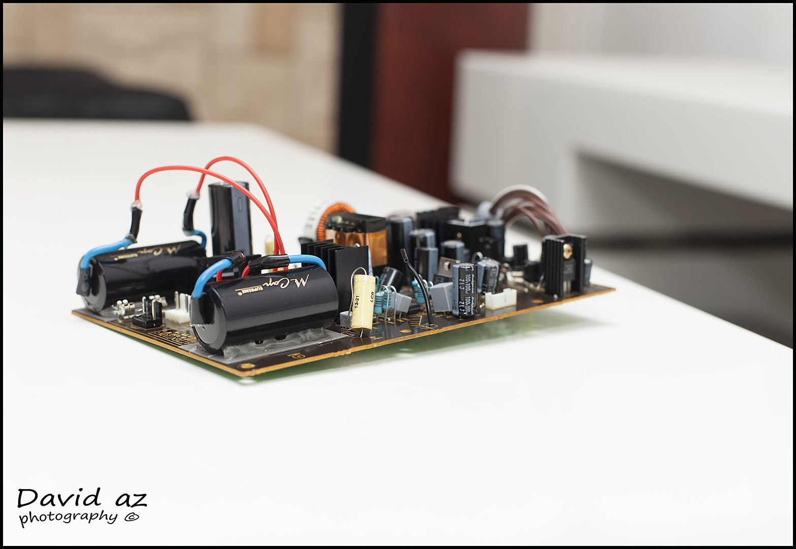

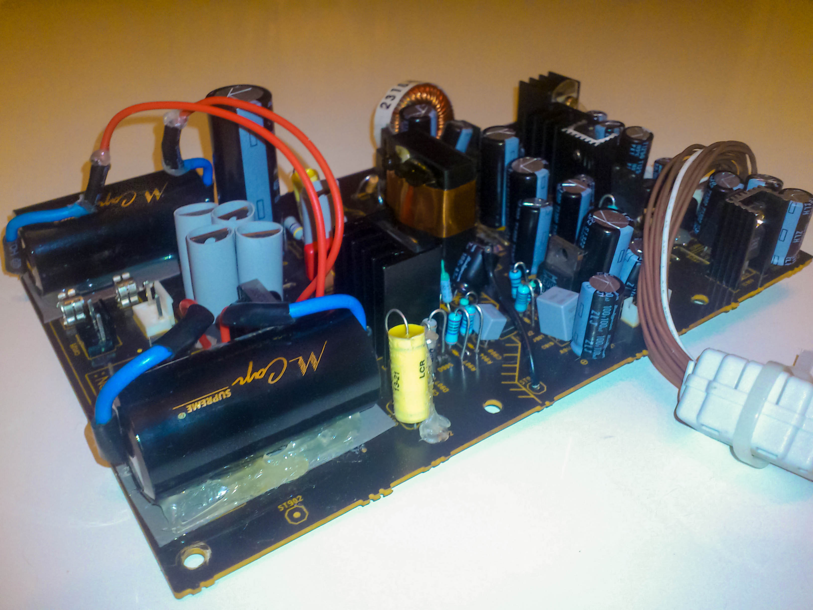

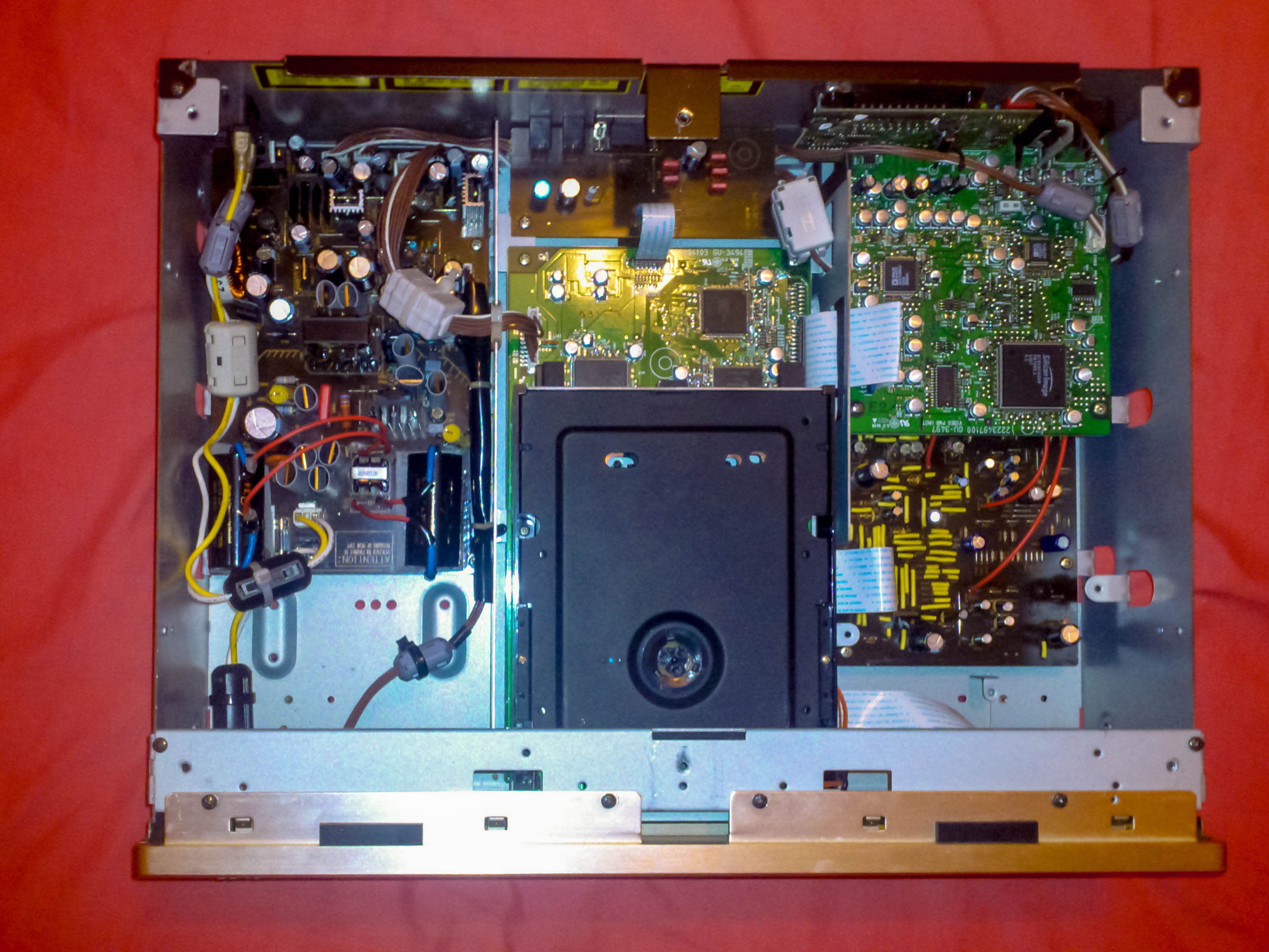

This is the final finished project on DVD DENON 2900
After yesterday I finished the power supply
Today also I changed the audio circuit to the internal wiring
Auric Hook-Up wire 18AWG, stranded copper (made in USA) - Red
(Yellow wiring point to point Made from NEOTECH 3001 cable)

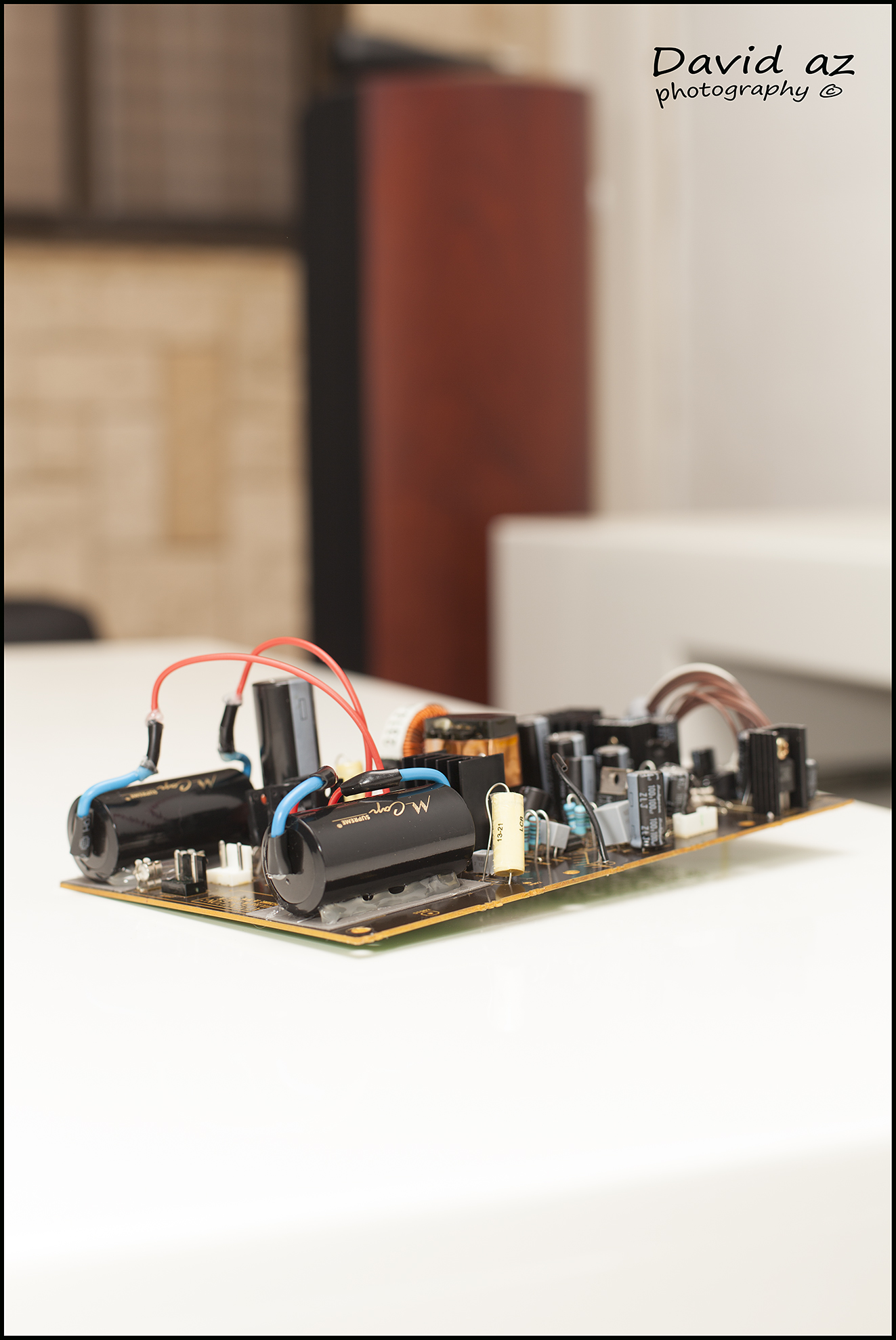

I finished
The project on the power supply of the DENON DVD 2900

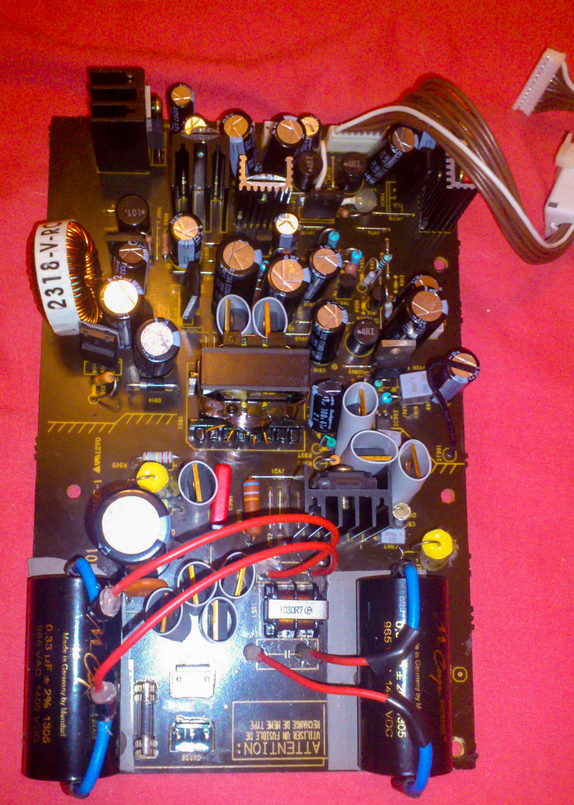

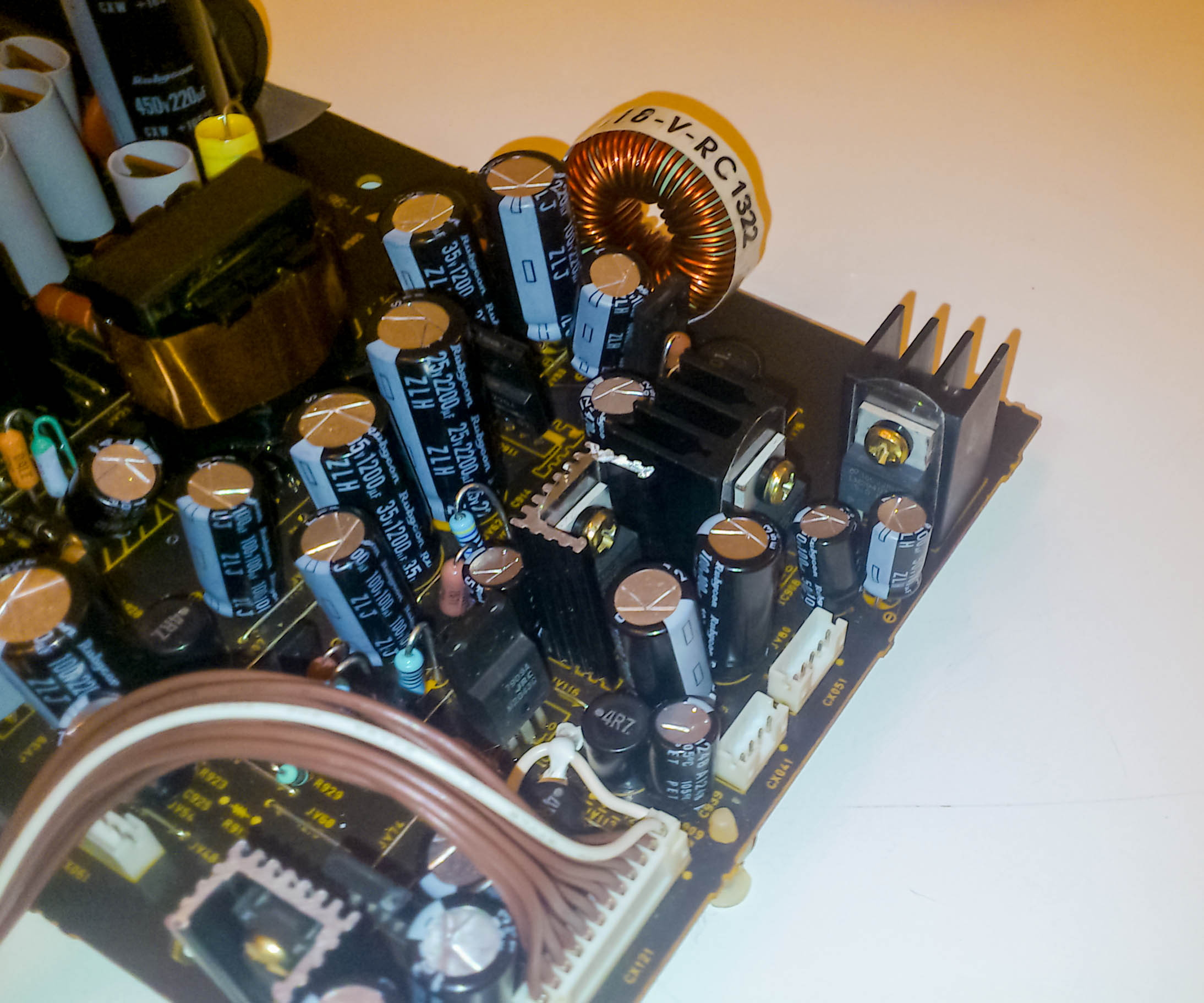

One of the best improvements I made to the power supply of my
denon dvd 2900

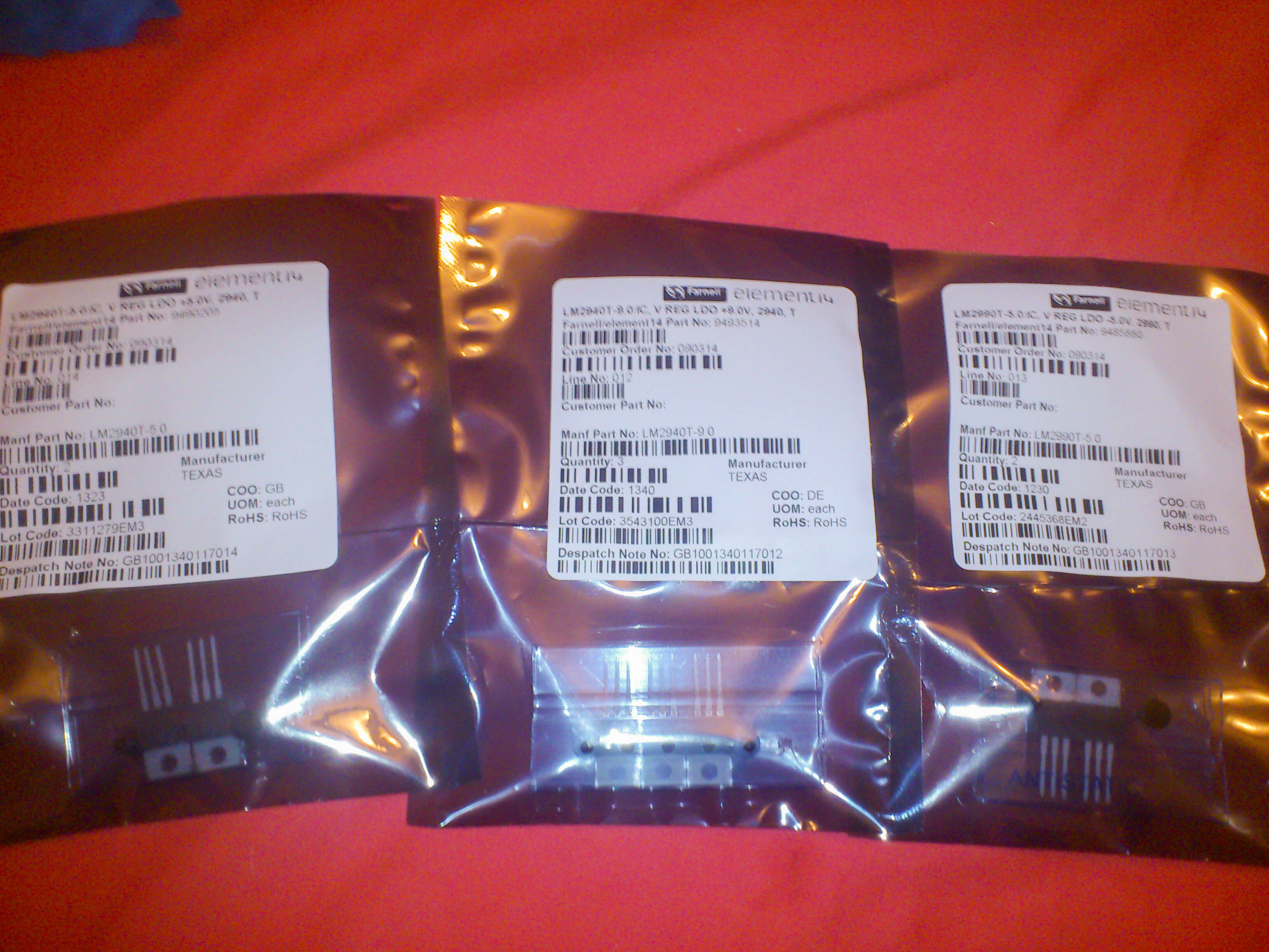

The regulators
7805
7809
7905
Switching Regulators LDO
LM2900T
LM2940T

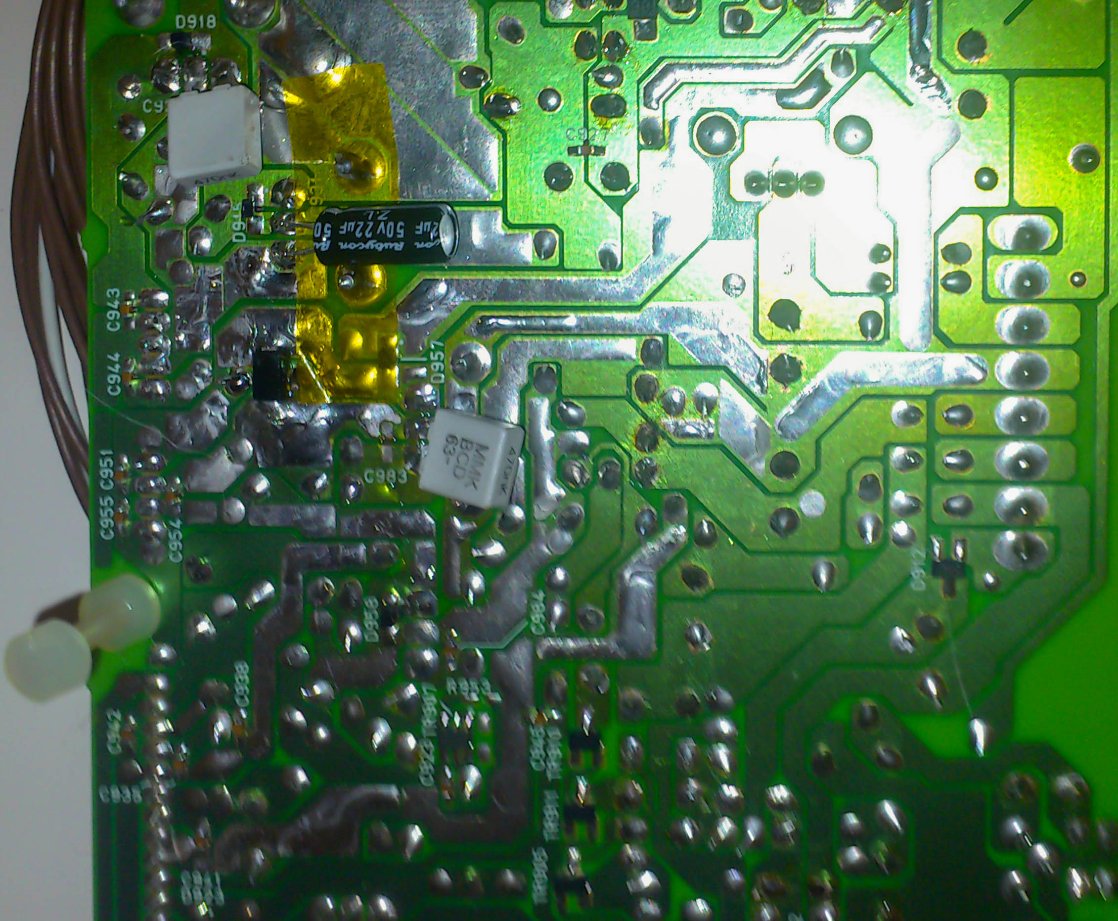

To Everything work properly I had to make changes to components such as input and output capacitors
LM2900 regulator negative voltage 5 V
in the output of the regulator
i left the 100UF RUBYCON ZLH
in the LM2900M
There is only a requirement that the ESR does not exceed 10 ohm
At the input to the LM2900
I changed the SMD capacitor
0.1UF
to Electrolytic capacitor RUBYCON of ZLH 22UF 50V
Polarity
( - ) Input regulator
Ground
LM2940T regulator
9 +
5 +
in the 9 +
I replaced the capacitor RUBYCON ZLH 1000UF
its ESR too low.
Is replaced by a capacitor of 100V 100UF RUBYCON ZLH
ESR fits that criteria
ESR = 110Mohm
in the SMD output
0.1UF
Replaced to get film of EVOX
470NF
5 + voltage do the same

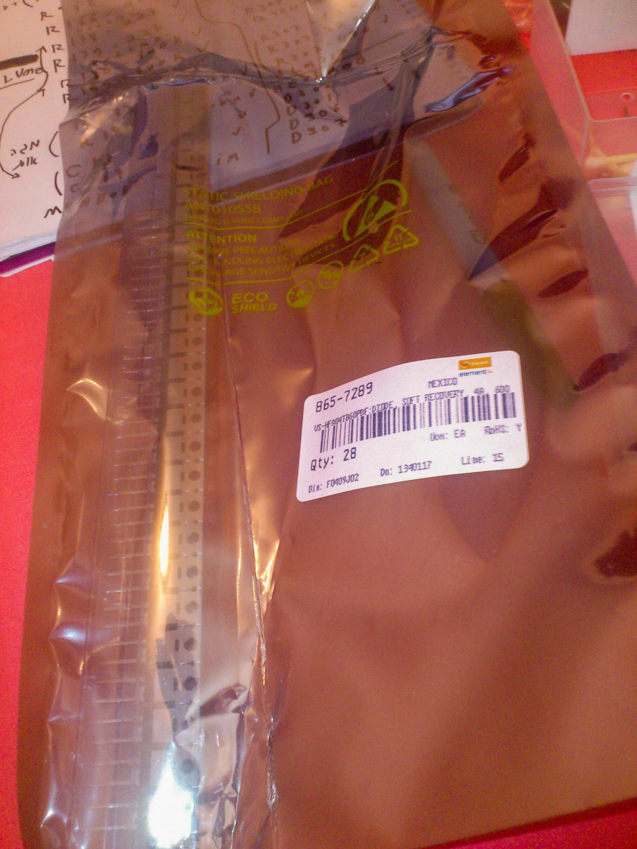

The previous Hdiodotbfam bridge I put diodes T0220
FRED
Now been replaced by the more advanced generation
HEXFRED
A huge difference in sound much cleaner and detailed
And timing improved a lot
Really great regulators i recommended
denon dvd 2900

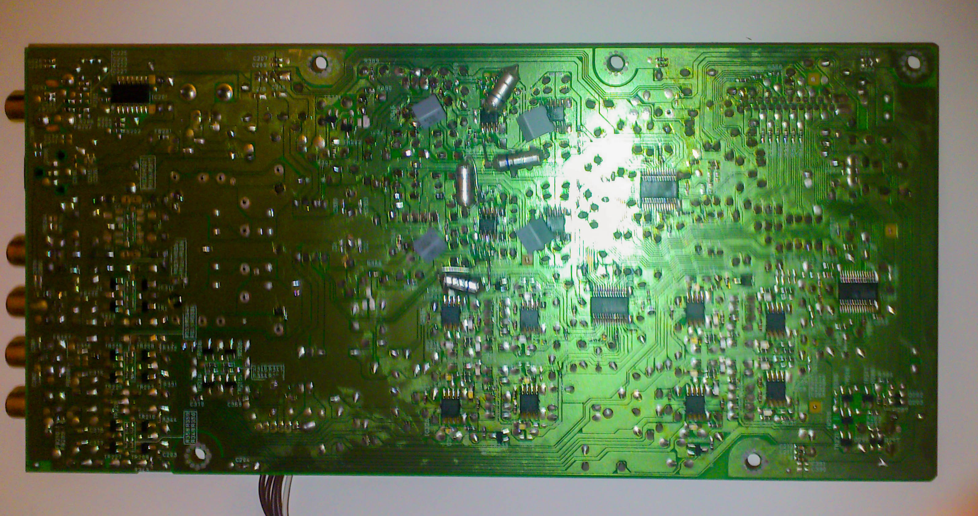

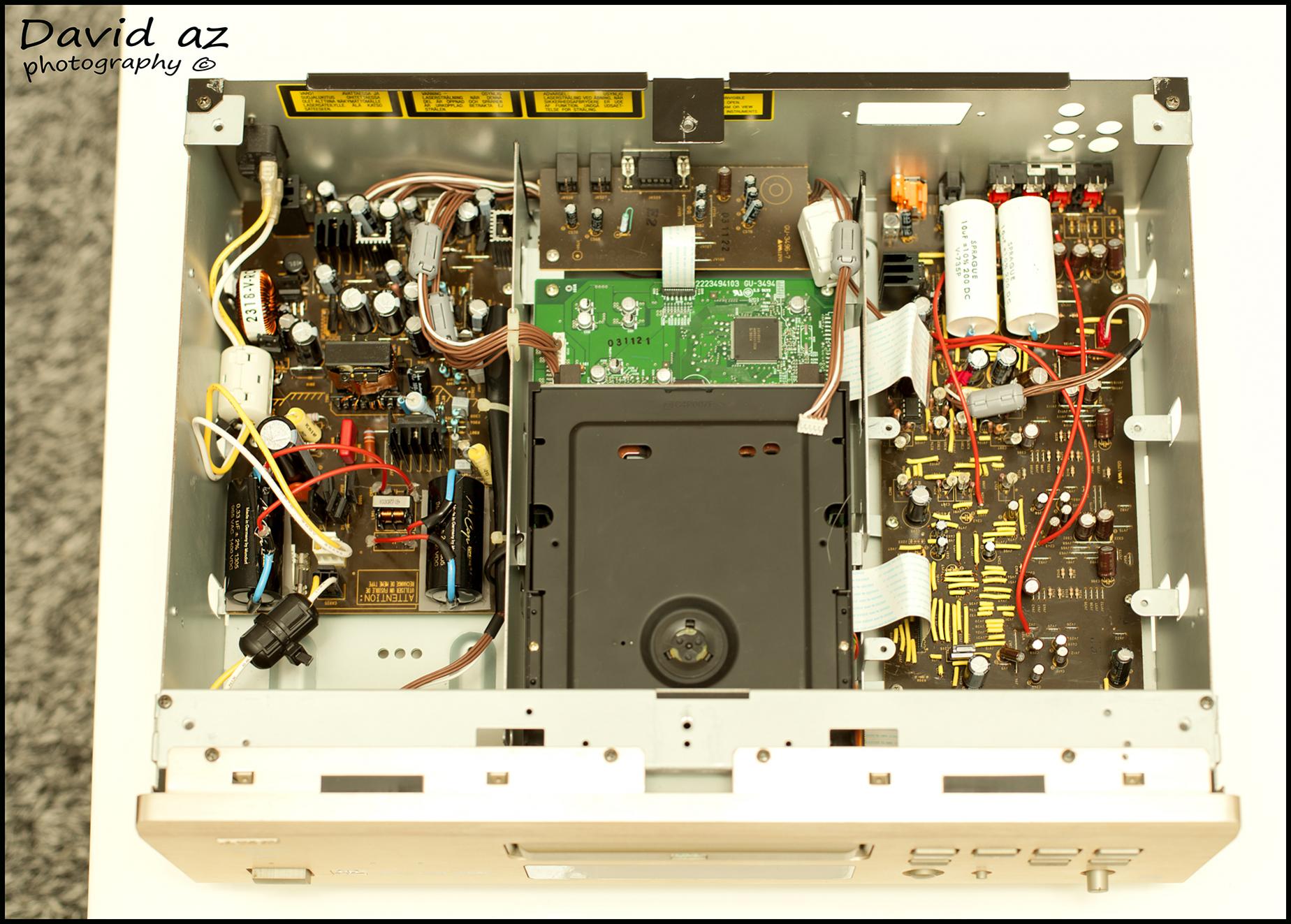

dlaczego tylko 4 operacyjne sa bypas na zdjeciu .na plycie jest 10 ?
why only 4 are operational in the picture disc on bypass is 10?
Even with translations into English I did not understand exactly what you mean 🙄
na zdjeciu jest tylko 4 opa 1662 z bypassami /vishay 1830 / .denon ma 10 takich opa ,...
I replaced all of the OP AMP
LM4562 in the I / V
OPA1662 in the high frequencies filter
AD826 in the BUFFER
you not see the all the filter capacitors
Because
That I did not photograph it
before I put All of them in the ciruit 😉
I made a lot of changes in the DENON 2900
thet i not shoot 😉
Thank you for the informationdziekuje za informacje 🙂

By the way Question bro
I now order tantalum capacitors
For voltage regulators
LM2900
LM2940
With ESR 1.3 OHM
There is a brand you recommend
dazzz, why would you use a high ESR caps?..and i would prefer to not to remove the SMD on the power supply. 🙂
Because of LDO Voltage Regulatorsdazzz, why would you use a high ESR caps?..and i would prefer to not to remove the SMD on the power supply. 🙂
Need a stable ESR at high frequencies to avoid oscillations
all ldo regulator has a limit
Minimal and maximal
Of ESR
Tntlium capacitor has stable ESR and because it
thay used in LDO voltage regulators
