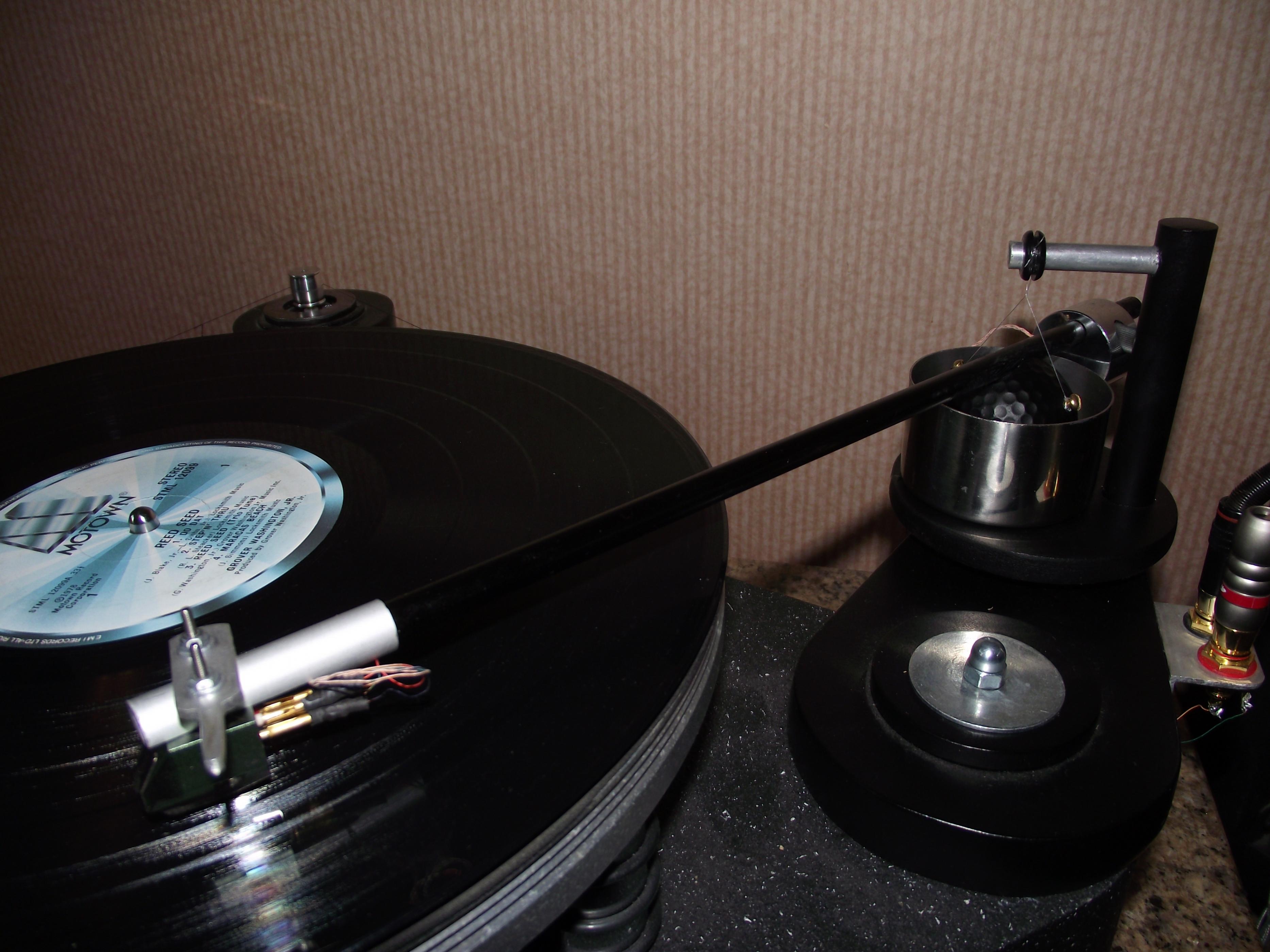

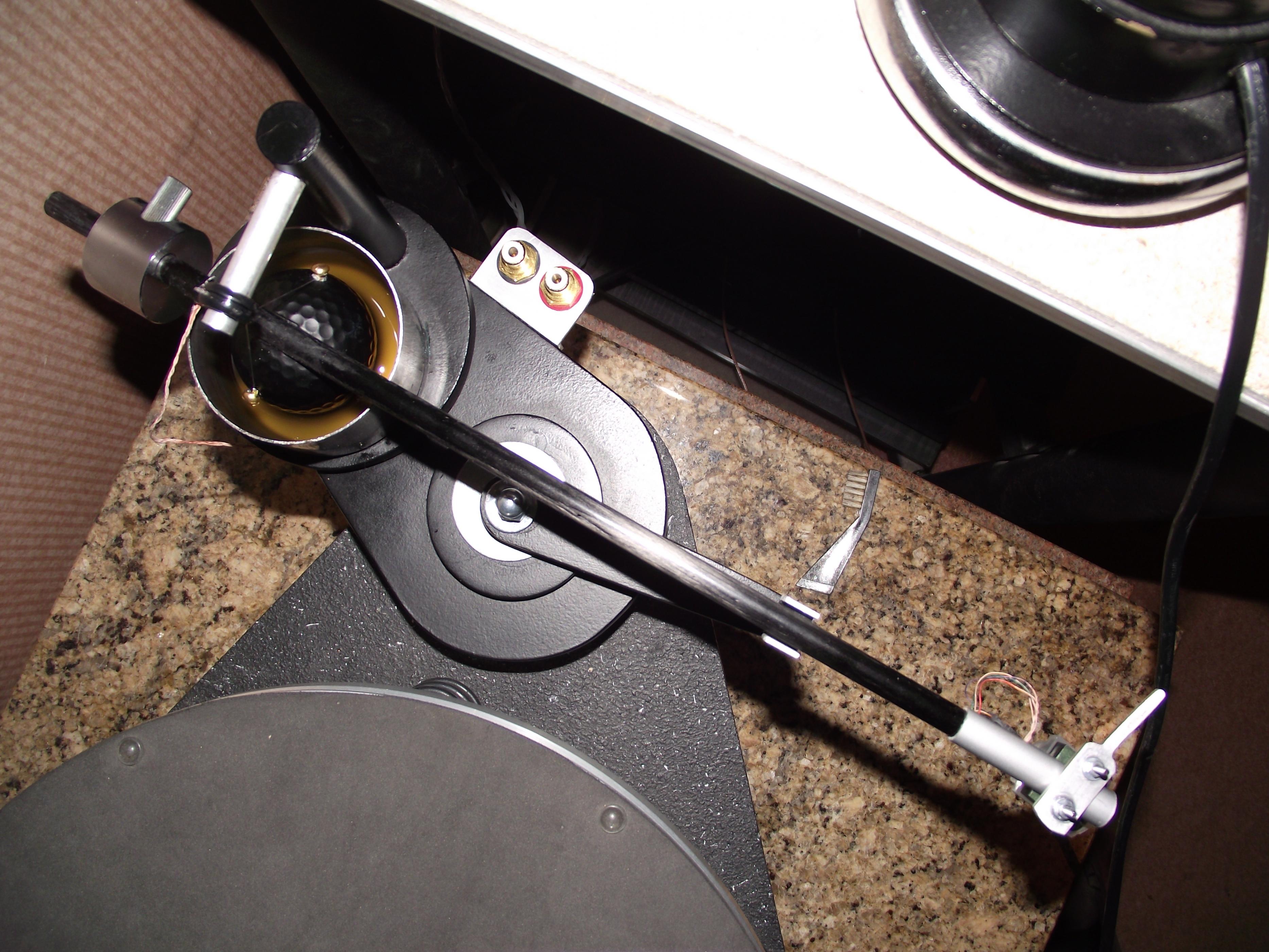

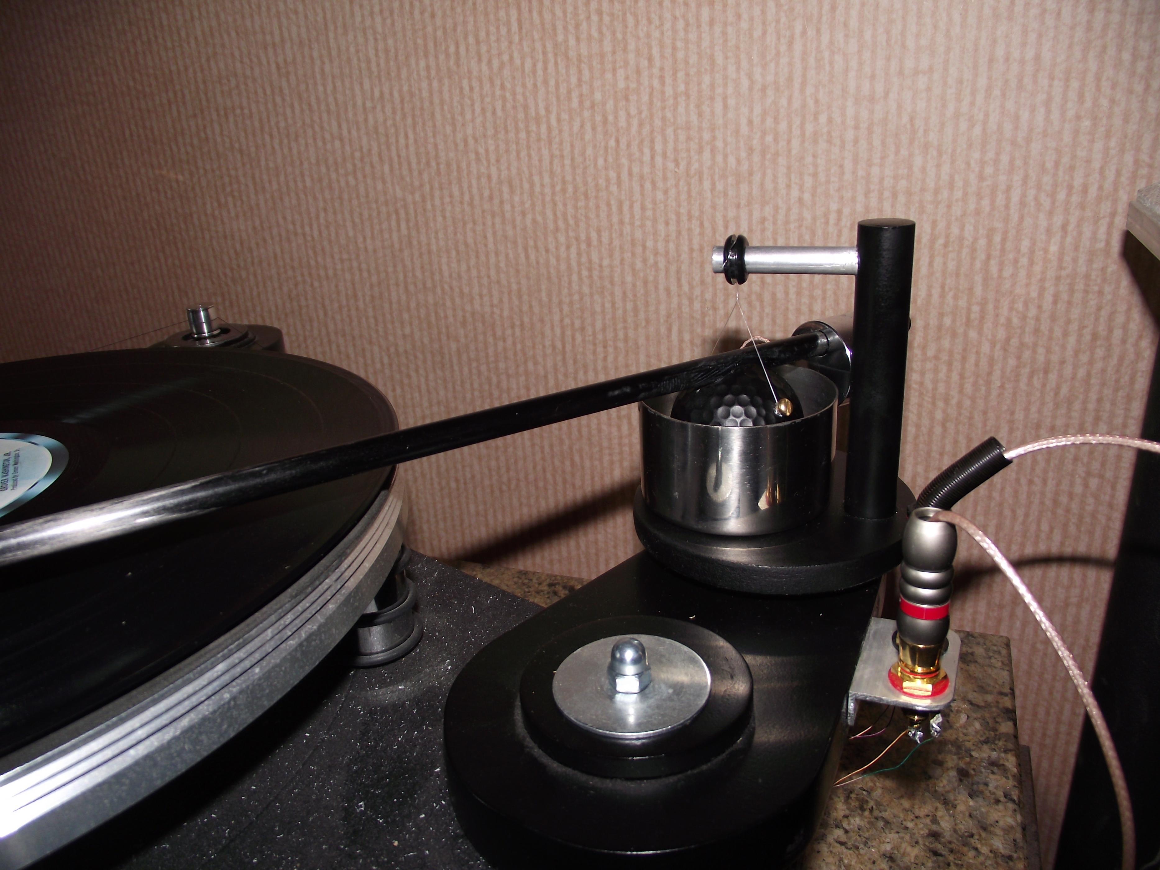

Here are pictures of my latest version of the WT arm. I've been building these for over a year now and I have to say, it's the easiest arm in the world to get good results from. This one took around 2-3 hours to build!
How does it sound? Is it better than the others I have constructed? I'm getting to a stage now where there is a base line of excellent performance and each model I make sounds 'different' in one way or another-no better/no worse!
This one has a carbon fibre tube, filled with fine sand as the Bill F. one does. Next one will be using an arrow shaft. I've become a big fan of the arrow shaft after building a few of Nanook's arms. Thanks to Stew for this-Also I understand that you are contemplating building a WT clone, Stew. Have a go-couldn't be more simple.

Hi
It's a stainless steel toothbrush holder cut down-just the right diameter for the golf ball-cost £1.96 from Asda (Wal-mart). Looks good too

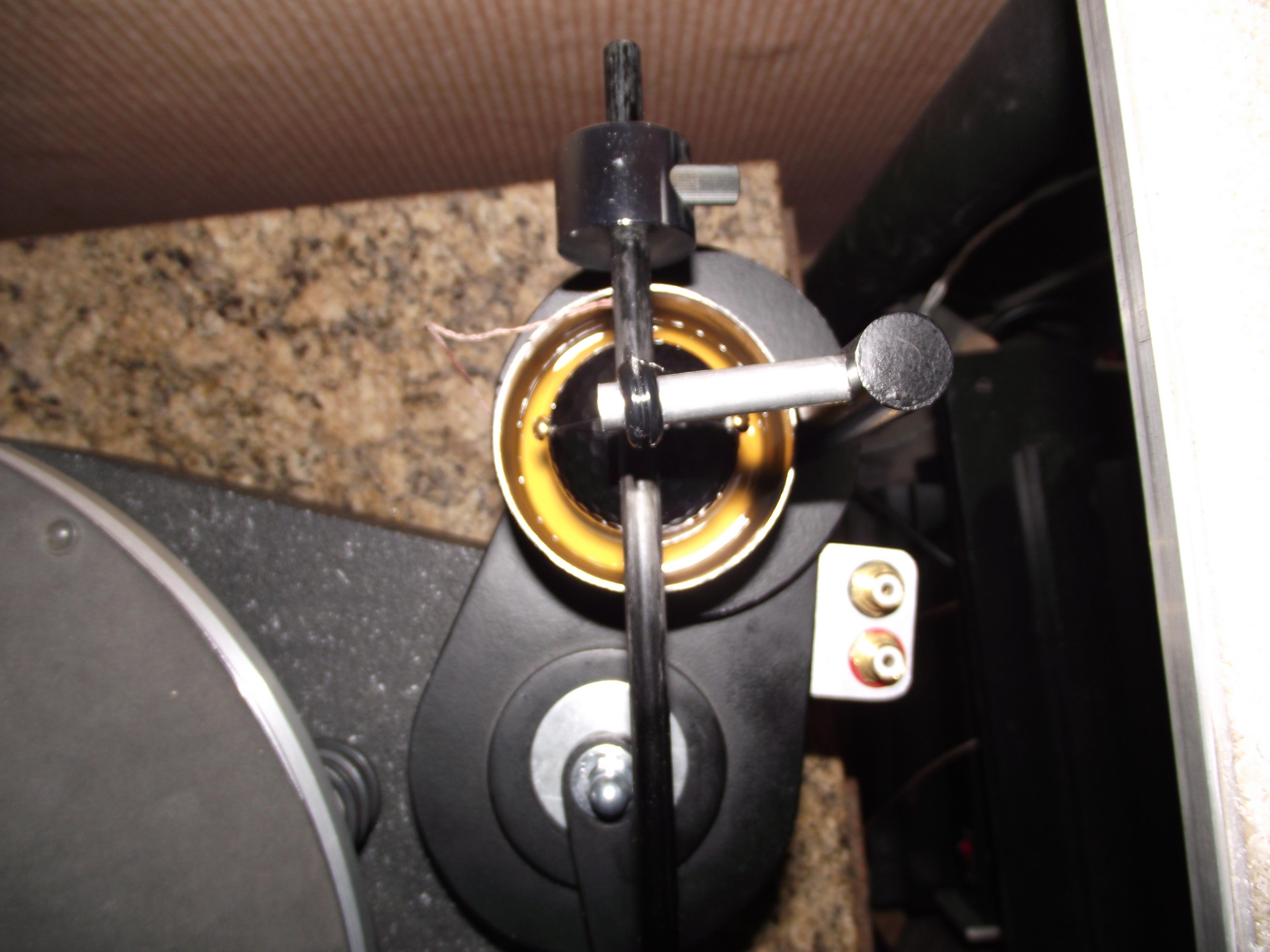

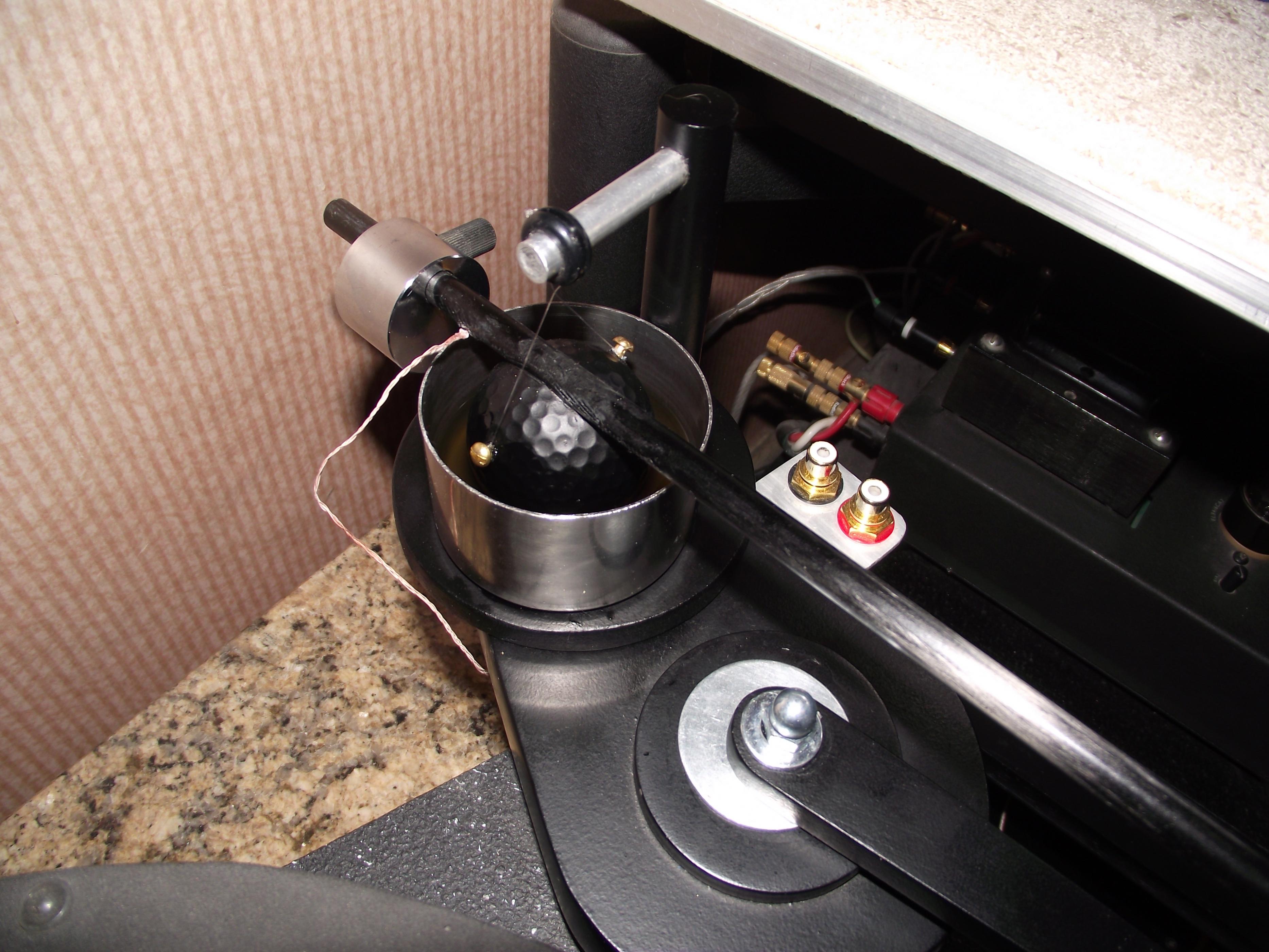

Nice job Chris,
Are those two slotted brass screws holding the mono filament in place ?
Is the arm base a cam on a pivoting second base, to get the extra distance from, say a standard fixing hole ?

Hi Jay
There is a single bolt under the base to mount the arm-it's off-centre to allow adjustment to be made. The fixtures for the monofilament are brass screws. Next stage is to use an aluminium arrow shaft instead of carbon fibre. I'm also going to experiment with fluids of different viscosity. Anyone out there know what WT Labs actually use? I'm convinced that this is a real improvement on all other arms I have tried or made.

Hi Chris,
It has been ~20 years since I built my WTA so the memory is a bit foggy, but I think it was 10,000 CS. The commercial WTA took about 9 to 10 seconds to descend from 1.5" maybe 2" to the record surface. Great fun to watch. I got 4 different samples from Dow Corning and tried them all. The one that duplicated that drop time was the one I used. Later I will look for the can, read the label and get back to you. If you have access to a real live WTA, golf ball type, try the drop test. The silicone fluid at 10,000 CS is thick stuff. My arm was a pretty close copy of the real, original model.

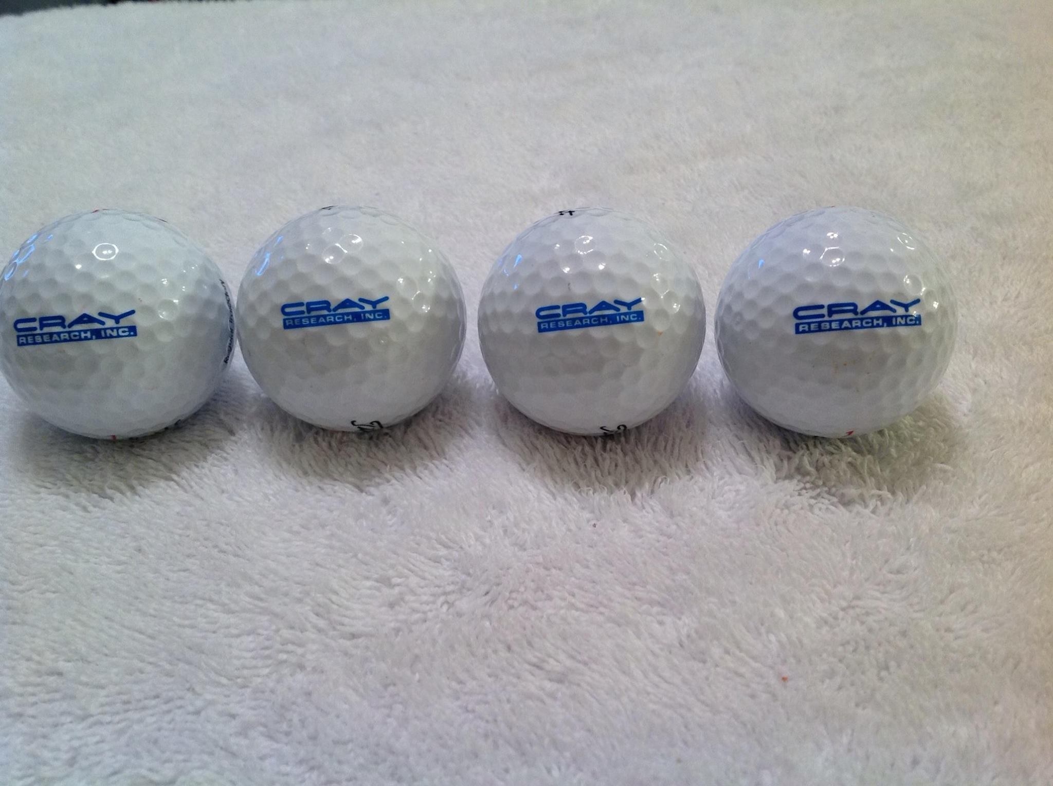

Hi guys...
In preparation to trying my hand at a WTL type tonearm a few years ago, I bought some of this: Team Associated shock fluid. I'm unsure if it is the correct weight (this is the 10 wt) , but they have it in various weights. Now in the UK or Europe, I don't know where one might get that, but I'm sure there would be similar from perhaps brands that I am unaware of. It could be that this is just re-bottled and packaged fluid, but Associated states it is made (in the U.S.) by Lucas Oil Products,who make many additives, lubricants and fluids for high performance (full sized) vehicles.
Now just gotta find a golf ball, a couple of screws, bah, blah, blah. I've got the stuff to make one of these, I'm just being stubborn.

Thanks guys I have found some fluid suppliers in the UK and I'll twist the father in laws arm to part with a couple of golf balls
Bill I had realised that the ball wasn't supported as such by the silicone but thanks for the hints regarding the thread twist for the anti skating.
