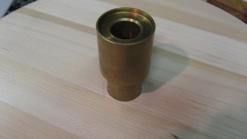

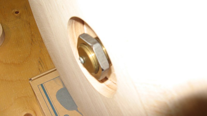

The bearing mounting hole fit and finish is so great that it fits like it was machined on a CNC lathe. The bearing will be perfectly held in place on the platform. Take note that the bearing is not installed yet on the picture. It is lifted to show the mounting hole.

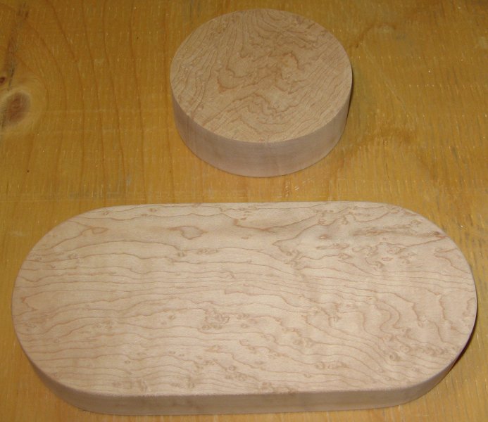

Very, very nice Sylvain! That will look wonderful when you put a finish on it. I am going to be doing the platter and plinth in aluminum due to the fact that I have access to the machine shop. I will try to clone the following:

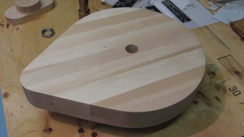

The lead shot dampens resonances as well as adding mass.
AFAIK the stuff to use is no. 9 lead shot, and for the plinth you need to shoot for between 40% and 60% of the mass of the plinth to be lead shot. So weigh the plinth and then you know how much you need to add. A mug full of lead shot I think weighs about 2kg if that helps give a visual fix. I think no 9 is about 1.5mm diameter. Gun reloading places will have it. I used about 20kgs in my TT, which weighs in total about 55-60kgs, so I'm slightly under the 40%.
I drilled 35mm holes in mine and basically drilled them all over whereever there wasn't going to be a mounting bolt. Having said that I did put more around the bearing mounting and under where the armboard mounts.

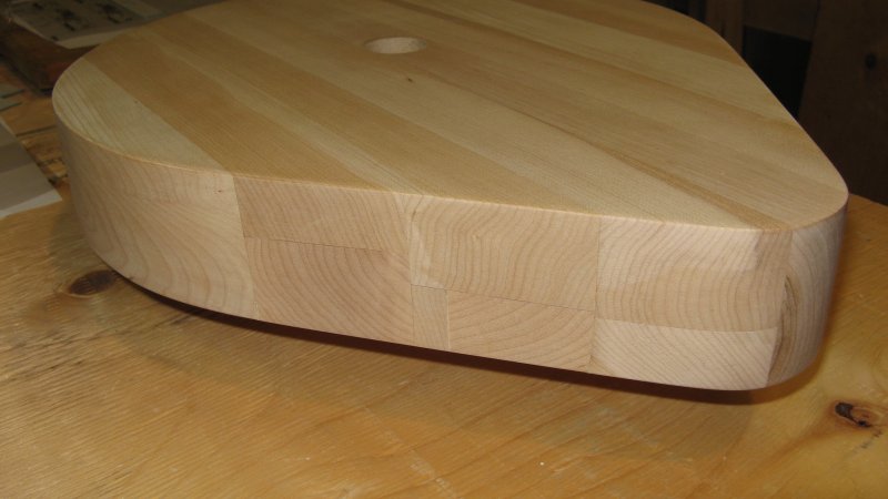

In my case I made my plinth from layered MDF and plywood. What I did was glue up all but the last layer, drill my holes, fill them and then add the last layer, glue up and then go back and finish the surface.
If you have a hardwood plinth already done, eg like algar-emi then what you need to do is make some plugs to seal in the lead shot.
AFAIK, the other thing is not to pack in the lead shot, but fill, tap the plinth so that it settles and then thats enough.
