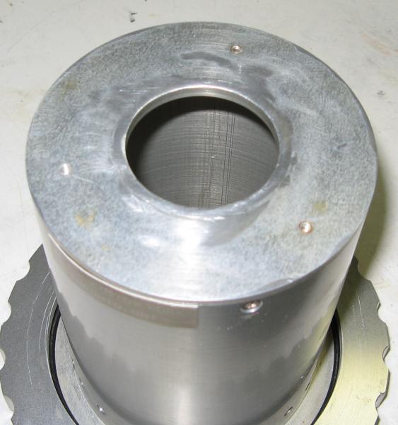

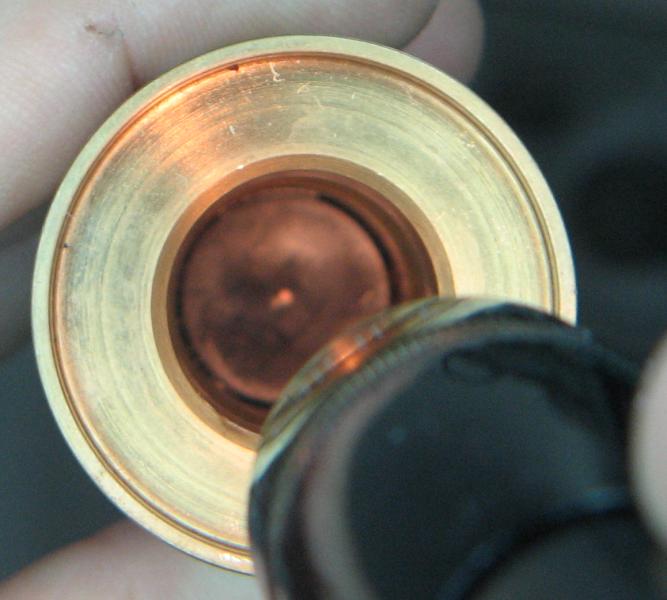

Hi. I'm puzzled. Looking inside the bearing sleeve I can see a black plate with a small brass dot in the middle, see the picture. I think there is already a thrust plate in place. From the bearing documentation, the bearing sleeve bottom should look like brass all the way to the bottom and end to nothing. Any idea what I got there?

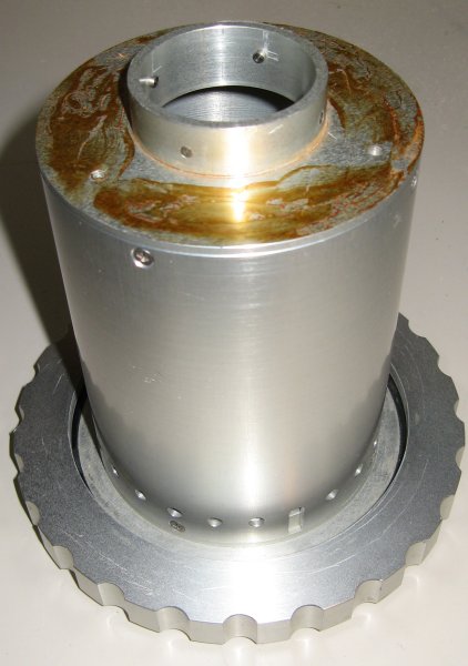

I found a very nice piece to be use as motor enclosure. It is kind of an antic, a very hold sensor that I saved years ago as souvenir. Originaly, it was a sun radiation sensor used into an automated weather station.

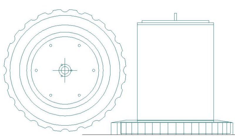

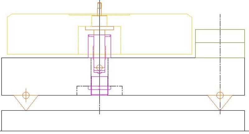

The case is very nice. Just a few mods and it will be a world class motor pod to use with my Teres. To validate all dimensions I entered all parts into AutoCAD. Here a side view of the table, platter, bearing, etc, resting on a plate. I'll need to plate because my motor pod is slightly too high, but it is so nicely done that I don't want to cut the case.

yep. I know that - what you have there is an early thrust plate. I had one of those too. What it is is a brass plate covered with a very thin layer of teflon - and the teflon is worn through where the ball runs on it. When you have it out in your hand, it look slike the protective film that comes on polished brass sheet. I took the layer off mine because it was loose anyway and I was afraid it would bind on the shaft.
To be honest thats whats in mine right now and it works fine - but I did get the newer thrust plate from Chris as well. When ever I get to change the oil I'll put it in then.
BTW, compressed air is about the best (and maybe only) way to get it out. Follow the reassembly procedure from the Teres site.

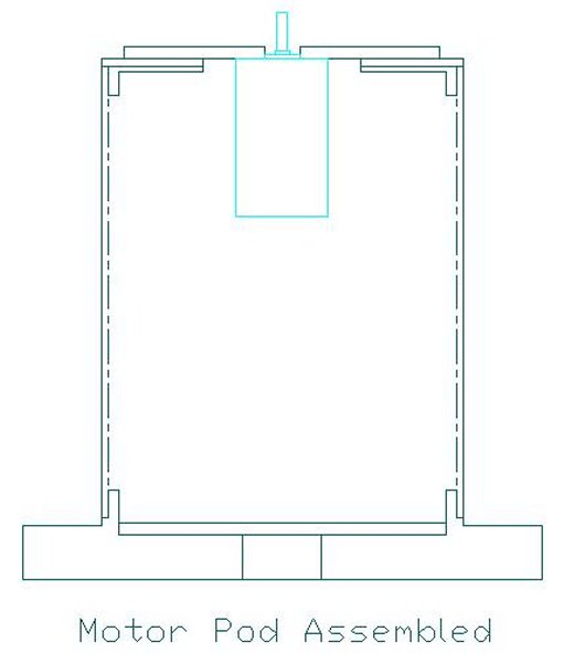

Here a slice view of the proposed motor pod with the motor in place.
There is plenty of space too add lead pallet to add weight. One of the nice feature of this assembly is the large, heavy base for a perfect, leveled motor placement on the turntable shelf.
I will install a section of PVC tube inside the pod to insulate the motor from the lead.

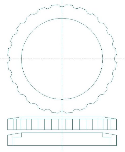

This sensor casing was covered originally by a glass bulb. So a large nut was screwed on the sensor bottom plate to hold the glass in place. This nut is very nice and big, adding some weight and look to the motor pod. Here a drawing of this big nut. It is more than 6 inches in diameter 😀
And now the complete ACAD view of the assembled motor pod. The actual sensor casing will be modified by cutting the small length of pipe on the top plate. This original hole is big enough to let the motor pass through. Then I'll install a new 4mm mounting plate on top of it with the motor mounting holes. I may also add a motor power on/off switch.
Looks good alright.
