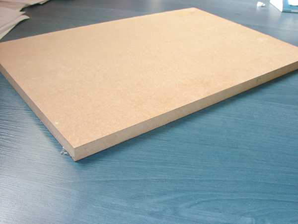

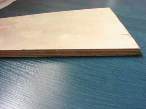

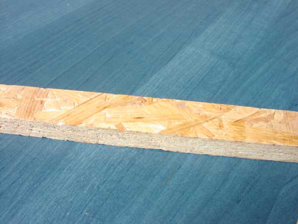

vytas, in order, that looks like baltic birch, MDF, veneered particle board (?), and OSB.
I second the suggestion for MDF. Baltic birch will work too, but it will be more expensive.

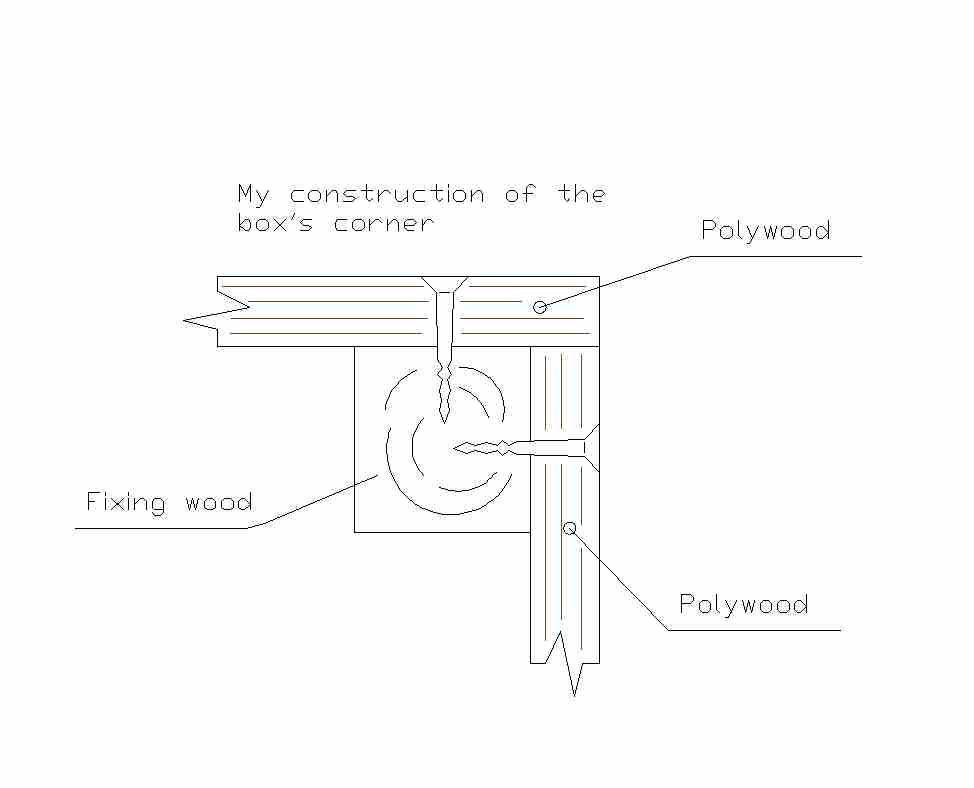

Here I am again… ok this project was unsuccessful… I tried to put inside solids, but did not get better results. It was even worse usually. I attached the picture of my box’s internal construction. As far as understand the construction is far, far away from perfect 🙂 this box could be good only for dog 🙂
I can't make out your picture. Use PNG for line drawings instead of JPG then you will not get corrupted images.
Construction looks good to me - as long as the block is large enough and wood glue is used.
I use that method of assembly on my PA speakers and it is firm.
