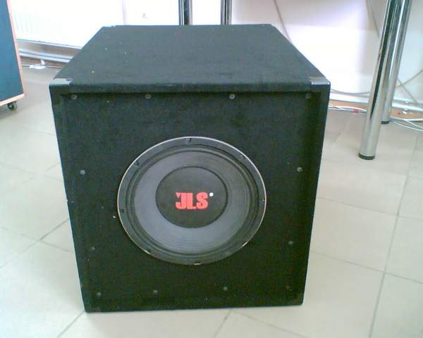

My diy Subwoofer – I didn’t see (hear) anything worse
Tell me which material you prefer?
the first:

Notax said:
Khm....
You did it all wrong.
Make bass-reflex box, parameters:
Vb=55 L (1.94 cu.ft) (netto volume)
Fb=52-54 Hz (53 Hz) (tuning frequency of bass-reflex tunnel)
Dt=140 mm (diameter of BR tube)
Lt=180 mm (BR tube lenght)
Good luck.
Vytas, look at my first post again.
Fb=53 Hz, Sd=531 cm2 (I supose, there is no 12" with 615 cm2) and Xp is something about 7 mm.
Now, Dt=sqr(53 Hz * 0.0531 m2 * 0.007 m)= 0.140357 m (140 mm)
In formulas, all is in SI system of measures, and you got results in SI.

vytas, how is things progressing for you?
Have you tried any of the suggested ported designs yet?
I have tried some sims and get f3 from 40 - 50Hz depending on how much bandwidth from f3 and up that can be of use without eq.
How is your setup regarding amp, filter and existing speakers you want to complement.

Here I am again… ok this project was unsuccessful… I tried to put inside solids, but did not get better results. It was even worse usually. I attached the picture of my box’s internal construction. As far as understand the construction is far, far away from perfect :) this box could be good only for dog :)
