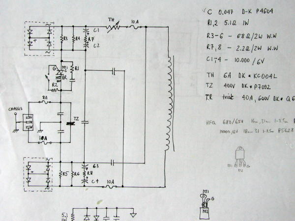

mrfeedback said:AC Polarity into each piece of equipment is another consideration here - one day I will build a power conditioning/distribution box with switchable polarity for each of the AC outlets and seee what effect this can make.
To make a polarity switcher you would need to use switches, right? Switches are never as good as hard-wired cables. I wonder if this might not (theoretically at least) degrade the performance. Of course, it could be nice to be able to easily experiment with changing the phase, but in a final assembly (after you're done experimenting) I believe it would be best to leave the polarity switcher out.
Maybe the polarity switcher should be a plug-in module, or rather, something you connect along the way. Imagine a little box with a male power connector in one end that you connect to your filter/distributor and a female in the other end. It contains the switches to reverse polarity. You could plug this in when you want to test different polarities, and when you've found which one works best, then you could disconnect this box. What do you think?
For safety, any such switching would need to be carried inside the case, after the mains switch and fuse. of the equipment in question. Mods such as this should also be clearly indicated, so some poor bloke doesn't kill themselves.
Another soloution is to use twice as many sockets - half wired one polarity, the other half wired inverted.

Maybe I wasn't clear enough of what I was thinking - I should have been considering that we're talking about lethal mains power here.pinkmouse said:For safety, any such switching would need to be carried inside the case, after the mains switch and fuse. of the equipment in question. Mods such as this should also be clearly indicated, so some poor bloke doesn't kill themselves.
The idea is to have a closed box, not too unlike the filter box (but probably smaller) that is completely closed. The only way you can interface with it is through the plug that goes to the filter and the socket that you plug the connection into, and the polarity switch. Thereby it should be as "safe" as a filter (safe if it has been built properly by someone who knows what he's doing - this is nothing for beginners! - and considering that we _are_ dealing with mains power).
Was that better Pinkmouse?
Yup, but my main worry is that by reversing the polarity of the mains lead you lose any protection you have from internal fuses, leading to a fire risk.
You also have the chance of someone who is unfamliar with what you have done getting a belt, as what was at neutral inside an piece of kit, is now live. You also risk putting mains voltage across EMF/spike caps that are not rated safely for this.
To re-iterate, the only proper way of doing this is to have a switch that swaps over the primary leads into the traffo. There is no other safe way.
You can use two fuses, one on neutral, one on hot wire.
No, you don't have to worry about that.
No need for that.
This is totally wrong unless you guys have household wiring that's completely different from continental Europe which I doubt?

fdegrove said:
No need for that.
I don't know, but this schematic is right out of ML amp.
Looking at the A.C. side of all things electronic it shouldn't matter one bit where the fuse is put...be that live or neutral.
The second fuse seems to be of a different rating, I have no clue why.
Either way the less I see those buggers the better...😉
Erratum humanum est...or something like that.
Well, having that out of the way, the only reason for going down that path is assuming that perfect symmetry would be achieved....it won't hurt but I hope ML had made his orderbook for their xformer stating a pefectly symmetrical xformer as well.
I can think of some other reasons to choose that path but none of them would have anything to do with safety...
Cheers, 😉
