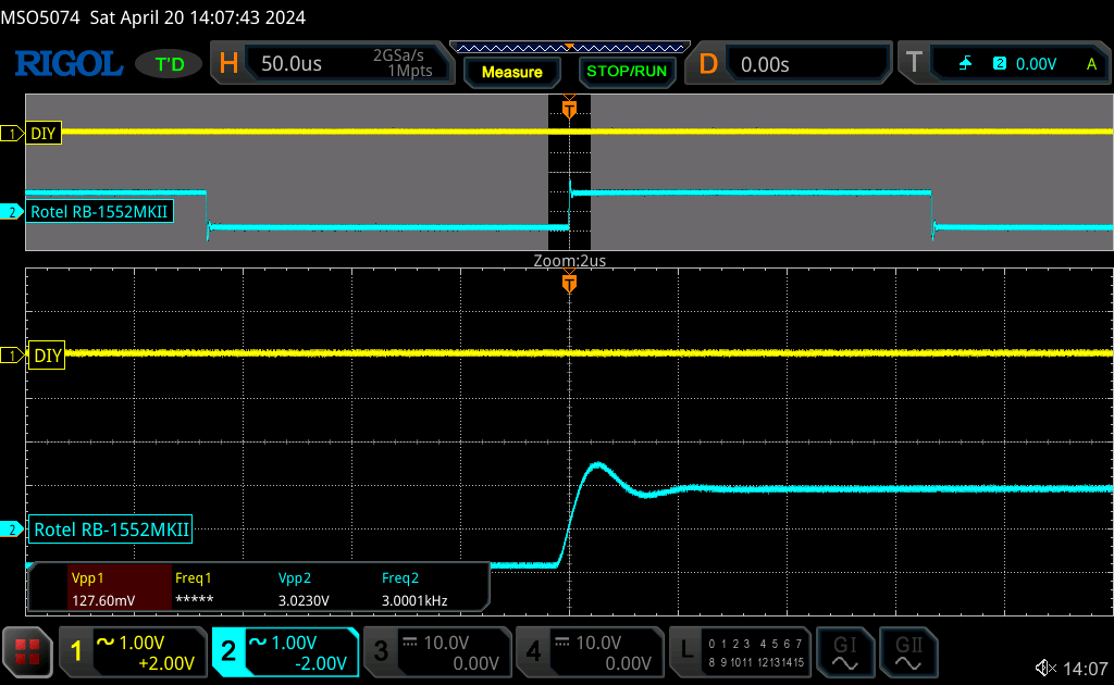

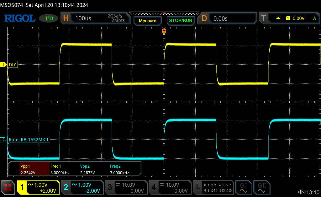

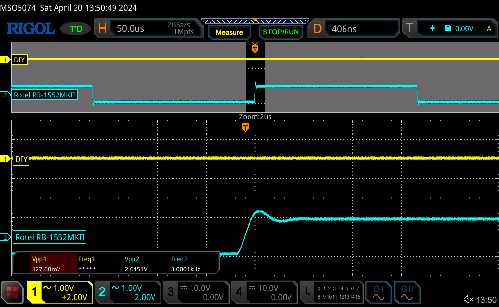

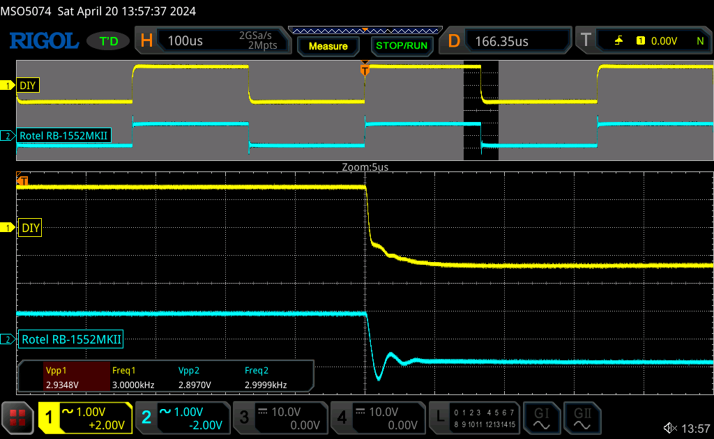

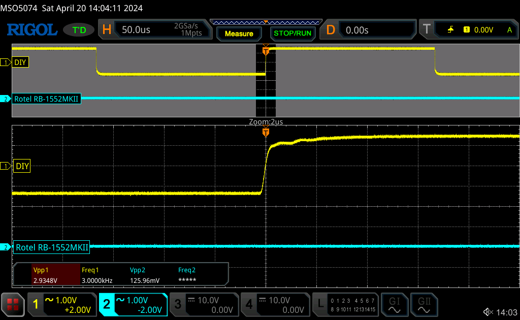

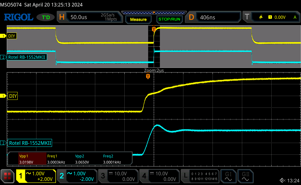

Well, I started to test with the resistors and capacitors I had in stock. I did all my tests on the right channel of the DIY amplifier and compared it with the right channel of the Rotel RB-1552 MKII. Tests were done at 3 kHz square wave and 3 Vpp at the output.When you test your amp, one of the things you have to do is spend a few hours with a range of capacitors from say 100pF up to 2.2uF in parallel with 2 Ohms, 4 Ohms, 8 Ohms, 33 Ohms, 100 Ohms and open circuit looking at the stability. This test is done at 2-3V pk-pk output squarewave at 2 or 3 kHz.
For the resistors; I made 2 Ohms with two 1 Ohms/8W in series, I made 4 Ohms with two 8 Ohms/2W in parallel and finally I use one 8 Ohms/2W for itself. For the capacitors; I use one 100 pF (that explain why the 100 pF captures are separated for the DIY and the Rotel), 10 nF and 100 nF.
I had to stop at these values because I made a mistake while testing 4 Ohms with the 100pF. I am pretty sure I made a short at the speakers posts because it happen while testing the 4 Ohms and 100 pF in parallel, But I had already did the test with 2 Ohms||100 pF and 8 Ohms||100 pF. I don't see why a middle resistor value could have made my output go crazy...
When I did the bad test (shorted, I think), the scope was showing a square wave without sync, and I saw smoke coming out from my DIY channel in test. I stopped everything. The two 8 Ohms resistors were so hot I couldn't keep them in my hand. The Zobel resistor R11, just before the L1 inductance make smoke and kept a brown color. When I compare it's value in circuit versus the other clean channel, I measure 3.3 Ohms for the bad one and 5.5 Ohms for the good one. Unfortunately, I don't have a replacement resistor in stock. Now I am wandering if I still can use the DIY amplifier knowing that this Zobel network is only active at high frequencies, am I right?
Anyway... Here are the tests results. The Yellow trace is the DIY output while the Cyan trace is the Rotell RB-1552 MKII output.
I started with 2 Ohms only:
4 Ohms only:
And 8 Ohms only:

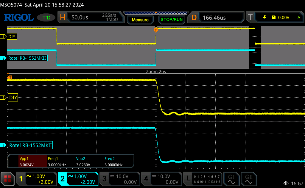

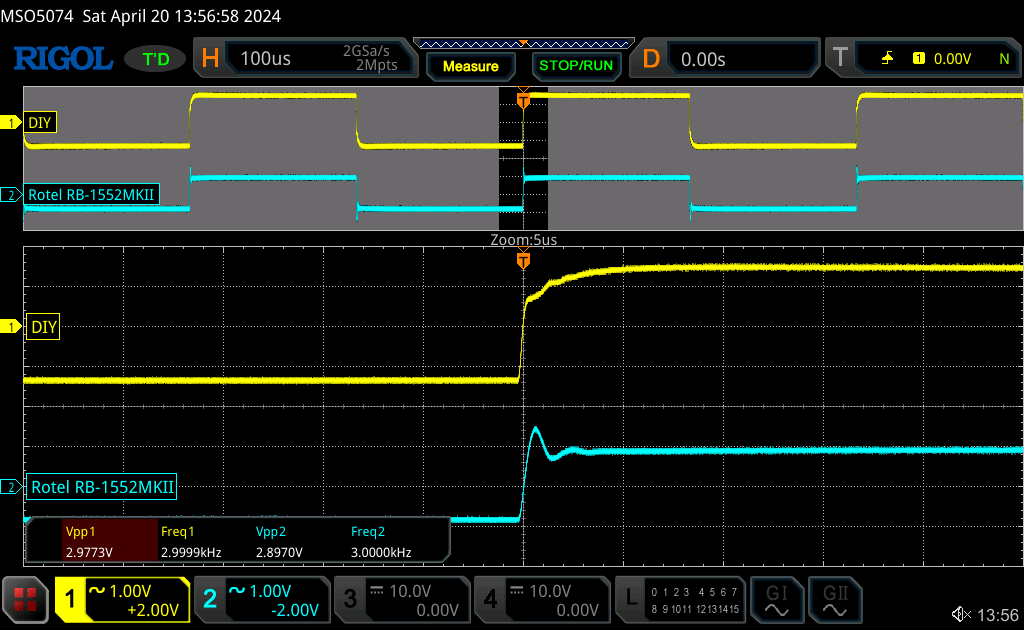

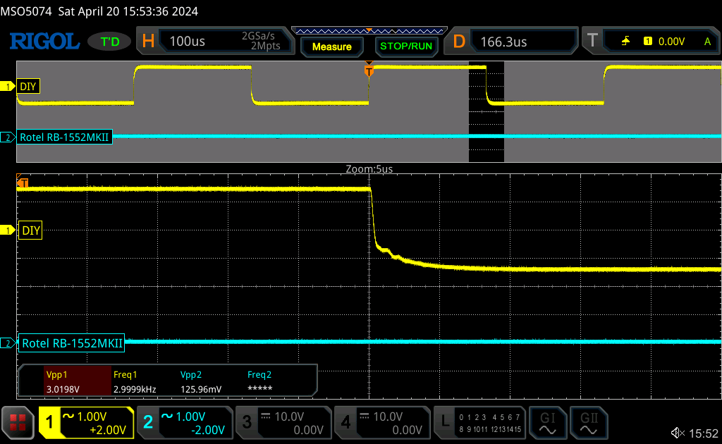

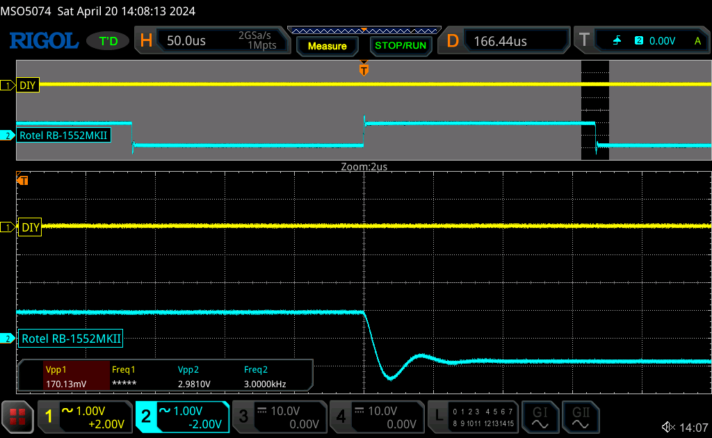

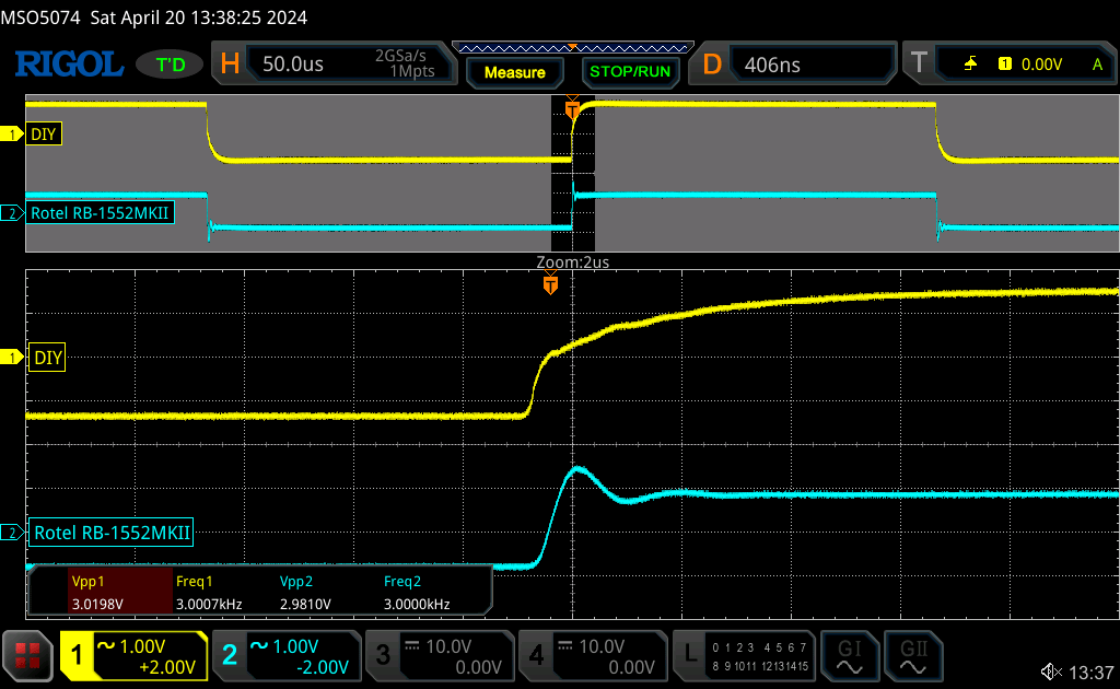

Then I found one 100 pF. With only one cap, I had to do two separate captures; one for the DIY and one for the Rotel.
For the 8 Ohms||100 pF, I also made capture of the falling edges:

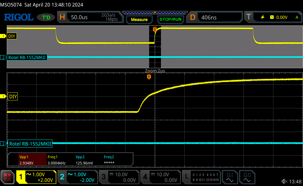

Unfortunately, while trying to test the 4 Ohms||100 pF, I made the short and had to stop.
And if it is really a short, it prove that the Short Protection circuit does not do it's protection :-/

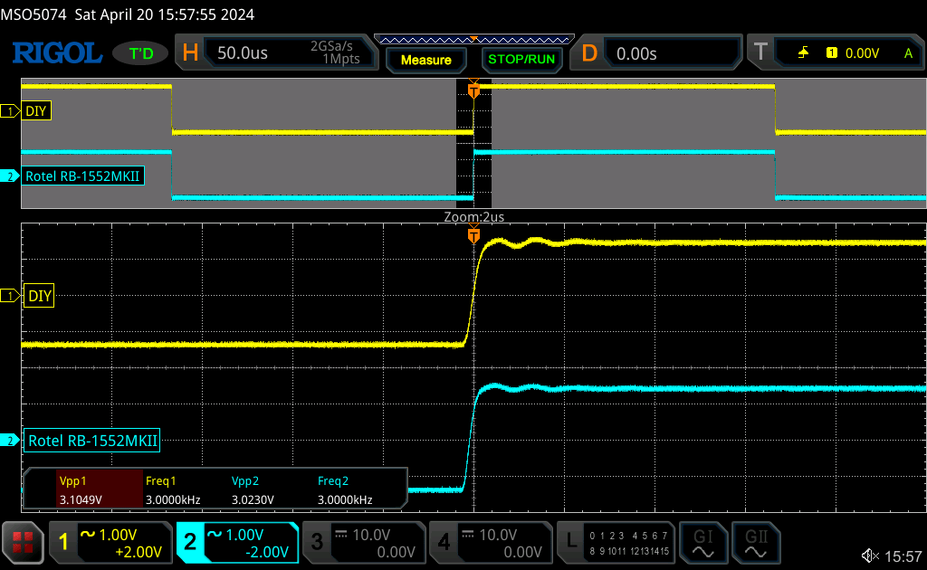

I wanted to confirm that I did a short. So I redo the 4 Ohms|100 pF test, this time taking my time to assure a good connection. Everything is fine again...
4 Ohms|| 100 pF:
And I compared both channels open to see any difference resulting from my bad test. I don't see any difference. The Cyan channel here is not the Rotel, but the left channel of the DIY. I didn't take the time to replace the label.
4 Ohms|| 100 pF:

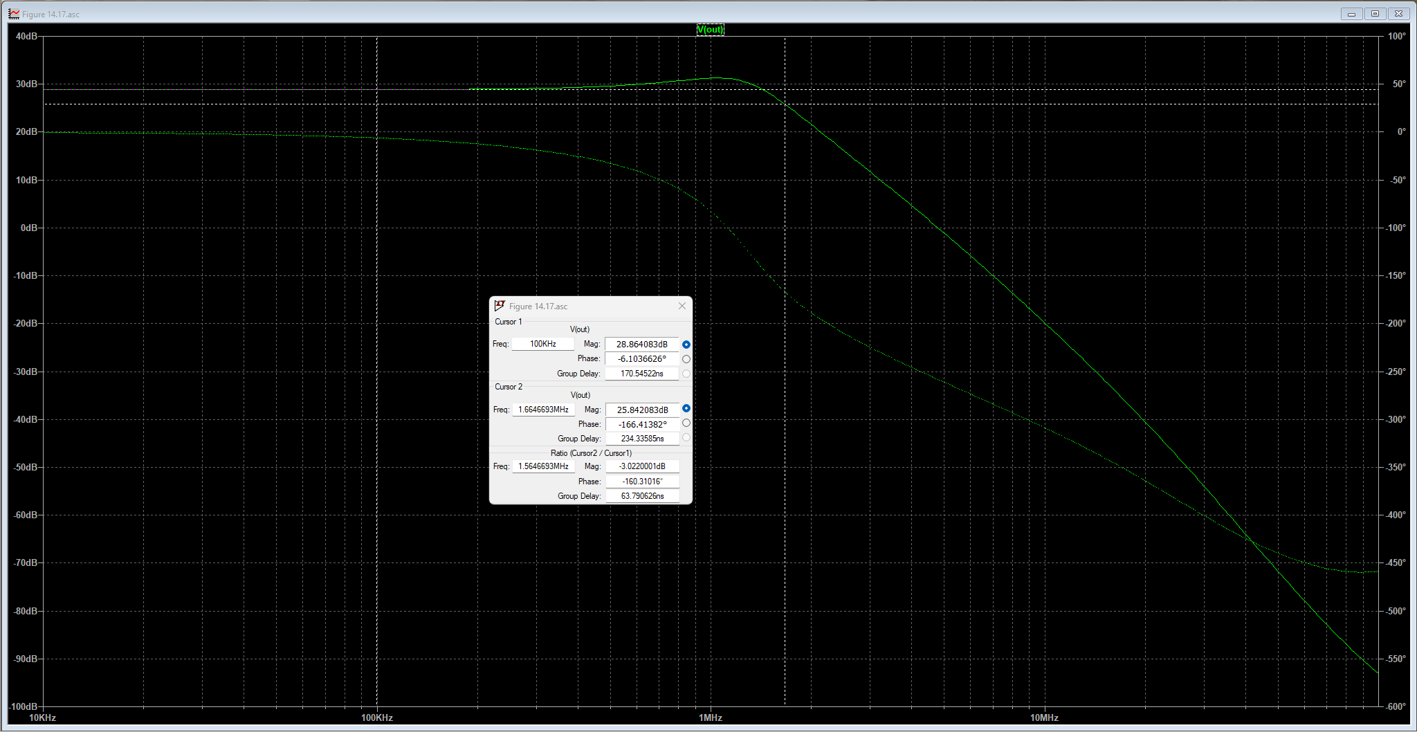

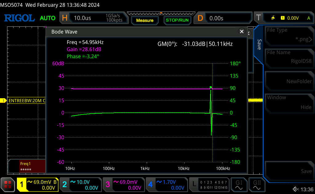

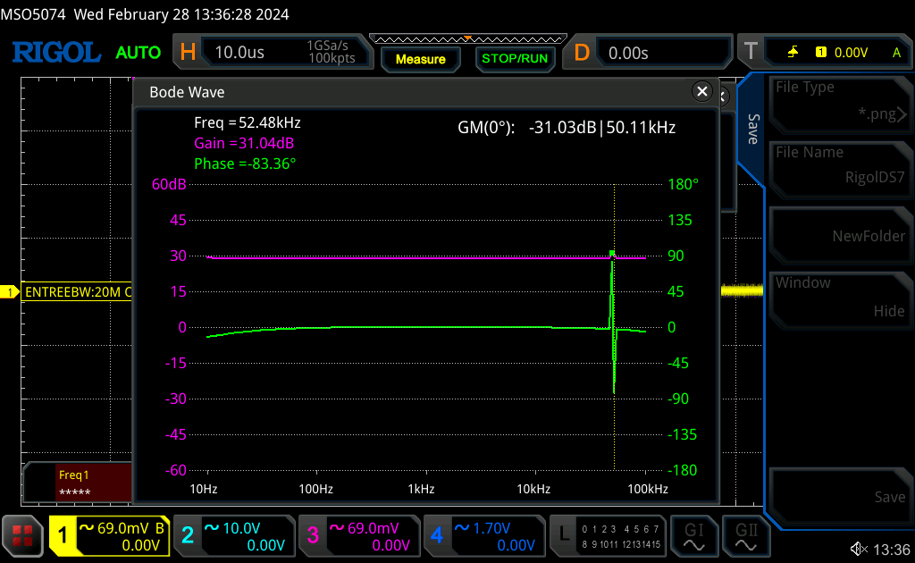

Yes. I have done a lot of simulations in LTSpice, Playing with C301 and C401 values. Here is one capture done with, If I remember well, the actual values.Just for completeness sake, have you done a loop gain plot of your amp in a sim? This will help you understand if you have enough gain/phase margin.

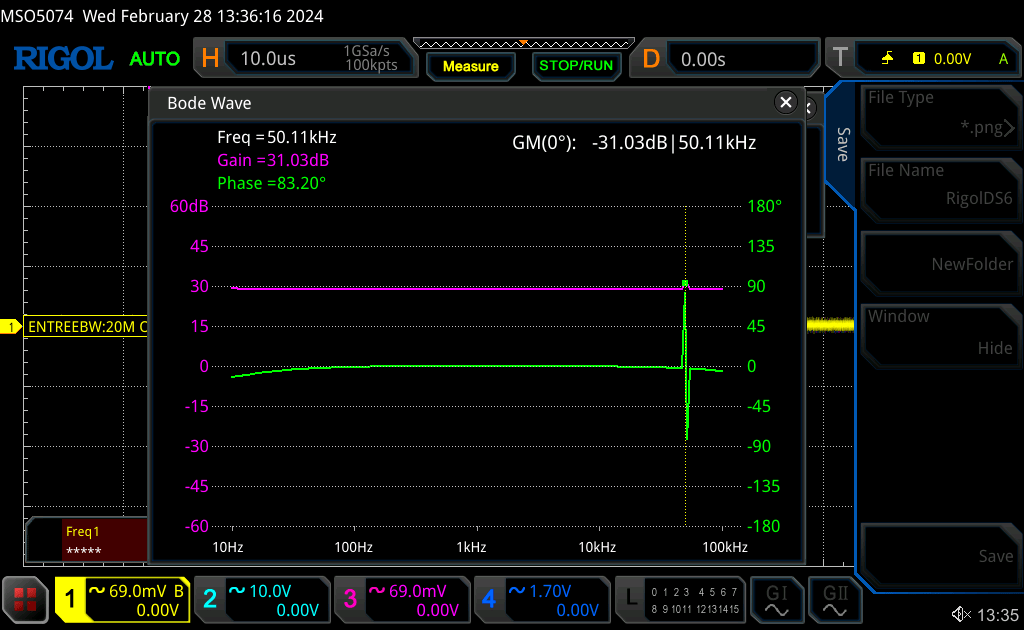

Also, some scope outputs in real life. I am not sure if I should worry about the glitch. Sometime the Bode Wave of the scope have weird transitions like this one, and when you redo it the glitch is not present.
Can you confirm how did you simulate Phase Margin / Gain Margin ? I'm not sure what I see on that 1st plot (cursor selection)....
Edit: I see Bonsai's post now; yeah this plot, cursors, and numbers look weird...
Sevy, see this post for the guideline how to simulate Phase Margin:

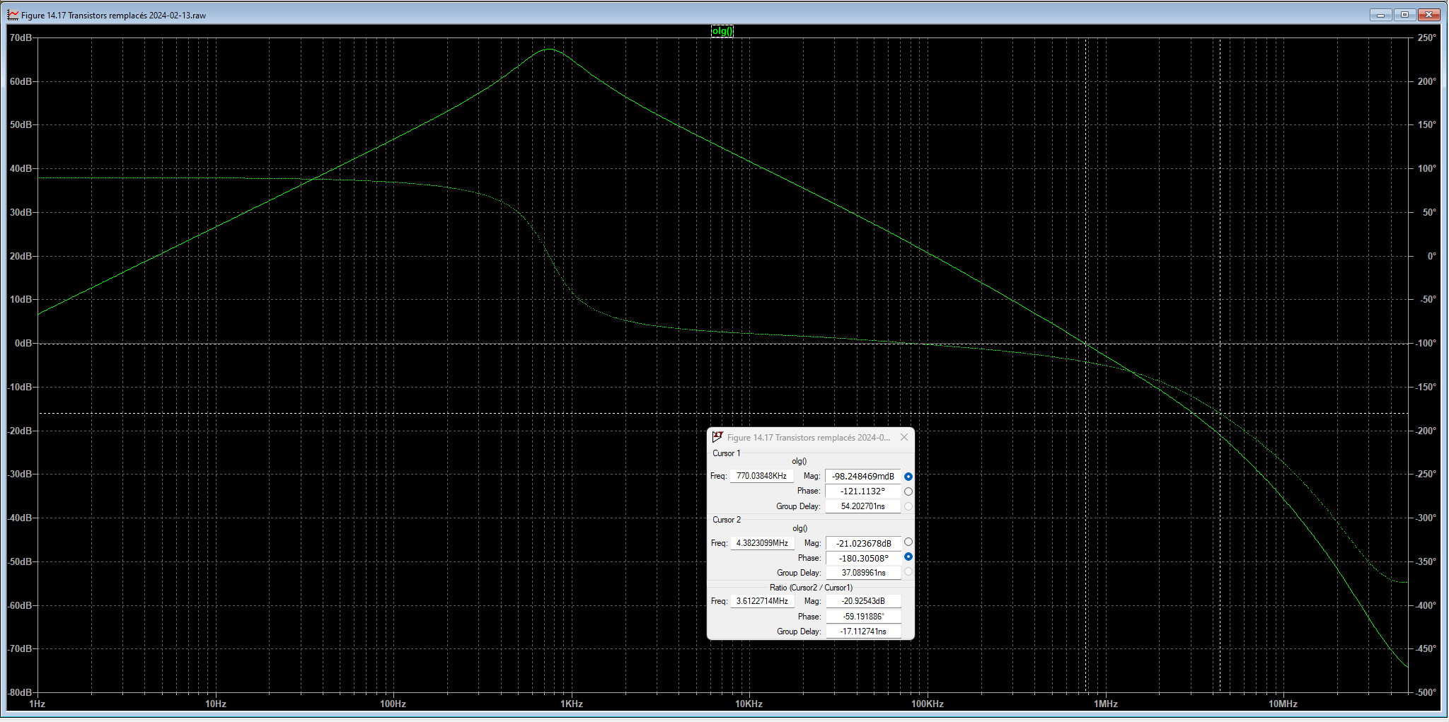

I followed your tutorial minek123. It is really well done and comprehensible. Thank you!
I did the tests with both your schematic and mine in parallel, steps by steps. Here are three screenshots. The first is the result of your tutorial. The second and third are the same simulation as yours but with my schematic. I don't see the Phase crossing the Gain more than once, but I admit I am a bit scare of the 1 kHz peak!
What do you think?
