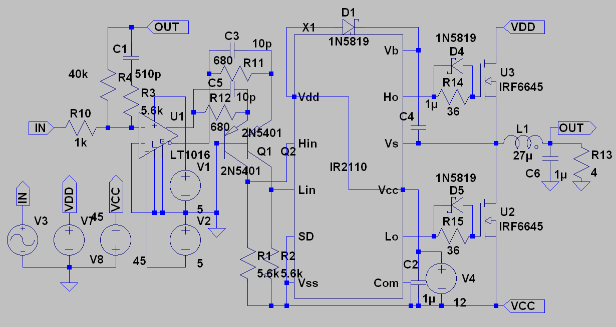

Just started on a new project, a class d discrete approach.
Uses triangle wave generator, comparator, xor phase splitter and irs2113 hi/lo side switch.

Circit diagram.
A bit small due to screen capture.

Got the square wave and ramp working cleanly by adjusting components.
Designed improved level translator from output of comparator to xor gates.
This works cleanly now.
At this point it outputs sound althogh with a little more noise than i would like.
Found tweaking the DC offset improved the noise situation.
Output MOSFETs were getting warm so changed gate resistors from 10R to to 56R now they stay cold.

can you provide a readable schematic?

Thats the best i can do without chopping it up into quarters and then it would be meaning less.
My earlier message explains all the stages.
Ramp generator and audio input, comparator, xor phase splitter, hi/lo side switch into irfb4019 mosfets.
Its pretty basic really. Sadly takes more components than a 2092 circuit but what components it uses are very cheap. The inductor is the most expensive part then the £2-50 IRS2113.
It only exists in LTspice, I never built it.

Spent a bit more time getting the noise floor down.
Got thrown a bit by my Mp3 player as its power supply was putting out a bit of noise.
Currently running the amplifier open loop with zero feedback and it sounds very good.

Got my pcb through for my discrete class d amplifier.
AAAAARRRRRRGGGGGHHHHH got 2 pins swapped on my op amp !!!!!
Hence the two flying leads.

Er, I thought your design was going to be DISCRETE ???

I have done both a discrete and a 2092 amplifiers.
Both work very well.
Discrete version.

I meant discrete as in no single chip solution.
The semi discrete version works very well open loop.
Sadly it will probably get shelved as the 2092 is a single chip solution and uses less components.

Can you show your circuit diagram with a WHITE background, not black, please.🙂
It's a complete pain in the eyeballs to examine, as you have it.
