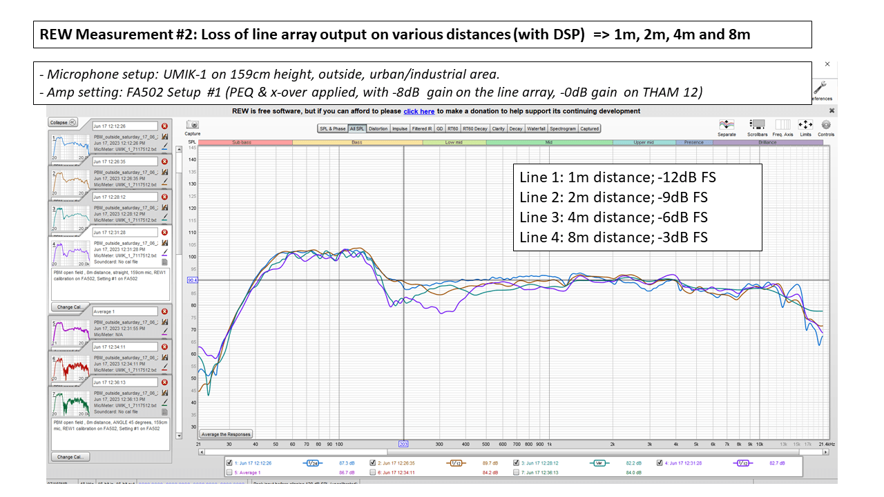

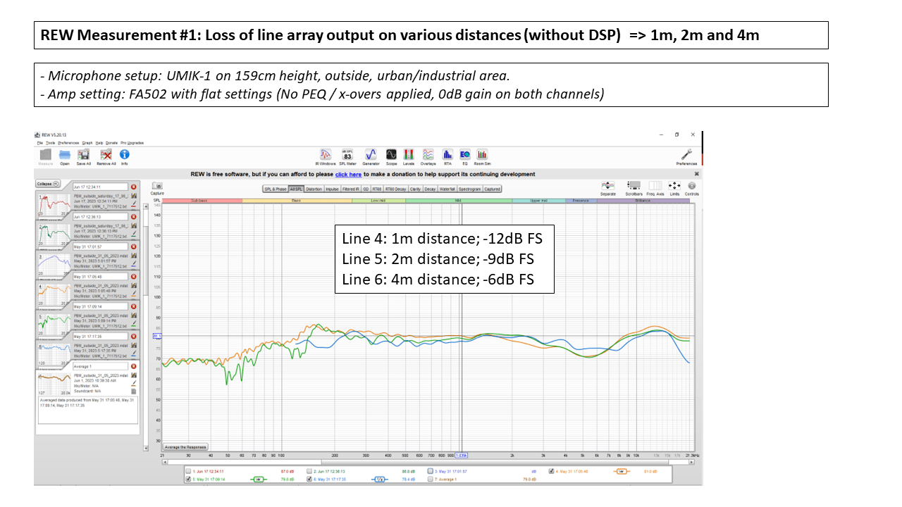

a) Measurement #1: Loss of line array output on various distances (without DSP) => 1m, 2m and 4m

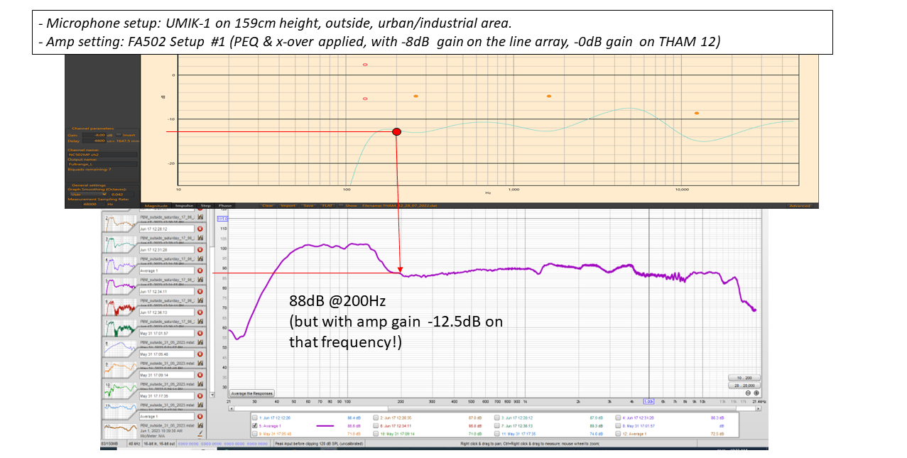

c) Measurement #2: Integration of THAM 12 and line array - amplifier gain adjustment (with DSP applied)
Measurement #1 comments:
- This was taken with one line array, and with "Hypex" FA502 completely flat => no DSP applied, no corrections of any kind, no crossovers.
Idea behind this measurement is to check if 3dB loss of output per doubling distance happens only on very narrow frequency range or on wider frequency range.
So my idea is to first go with 1m distance, but with -12dB output on REW.
Then, I would double the distance to 2m , but increase output only 3dB (to -9dB).
After that, I would again double the distance of the mic to 4m, but will increase output only 3dB (to -6dB).
Finally, I would increase distance to 8m, and will increase output to -3dB.
If the line array theory of "3dB output drop per doubling distance" is correct, all four measurements should align very well.
Above measurements shows two things:
a) That from 200Hz to 16kHz there is no significant variation between measurements,
b) That even without any correction applied 3Fe25 are very linear drivers
Measurement #2 comments:

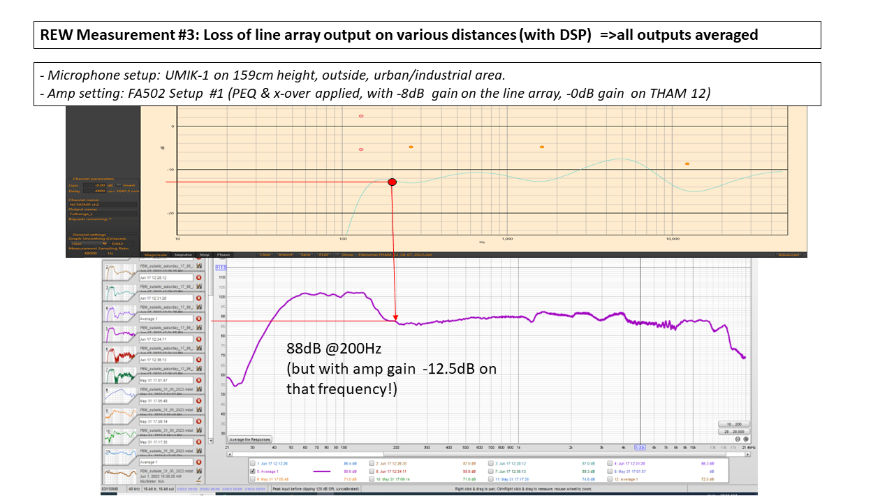

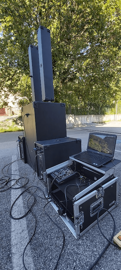

This measurement was done with one THAM 12 and with one line array.
Line array was mounted on 60cm pole (threaded to THAM 12 top).
"Hypex" FA502 had DSP applied on both channels (both PEQ, and cross-overs).
In order to get desired loudness curve, I've reduced gain on line array amp channel to -8dB (this is overall gain), but kept THAM 12 amp gain to 0dB.
As you can see above, with PEQ applied, some frequencies on line array are down as much as - 13dB when compared to THAM 12 (in example, 200Hz),
but actual sound output from line array is relatively flat & consistent from 200Hz all the way to 15kHz.
What is interesting, even with such gain setting arrangement, line arrays can keep without any issues with THAMs ,especially on 10m distance range, where line arrays output drops less than THAMs.
I believe that in most of cases, PA systems are typically tuned with some kind of loudness curve - how much low end should be "hotter", is mostly matter of preferences & type of program material (I am not taking into account actual venue location/ambient conditions, etc.).
My experience with this small system so far , that by keeping line array amplifier gain -6dB to -12dB lower than THAM 12, produces pleasant sound with most of the music genres.

Bubba,If the line array theory of "3dB output drop per doubling distance" is correct, all four measurements should align very well.
Thanks for sharing the measurements!
The 120dB range makes it difficult to see the variations, some of which may be due to wind/environment noise and ground reflection cancellations from path length differences between direct and the 159cm mic height.
A) The octave between 1-2kHz is within 3dB, there are variations of 3-6dB above and below that octave, more below 200Hz.
Those differences are the equivalent of doubling distance, which seems to be a significant variation.
B) +/-7dB, not too bad, would be interesting to see the off axis variation.
Seems the Tham conforms to the -3dB per doubling of distance better than the line array 🤔Measurement #2 comments:
The line's -10dB "scoop" from around 160-320Hz at 8 meters seems more like what I'd expect.

Hm I would agree and disagree - if you check all graphs you can see that on longer distance measurements , some frequencies have higher output than on lower distances.A) The octave between 1-2kHz is within 3dB, there are variations of 3-6dB above and below that octave, more below 200Hz.
Correct me if I am wrong, but if you have measurement with four different distances , and if the output drop linearly 6dB per doubling of the distance, then each contour of the four curves would be offset for this 6dB, and with my +3dB compensation of the gain , there would be still offset between each measurement - contours shouldn't cross couple of times.

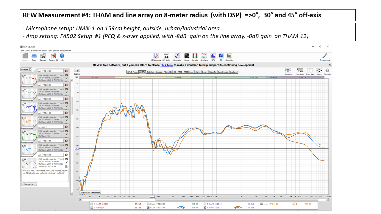

I have off axis measurements, but I need to find them.B) +/-7dB, not too bad, would be interesting to see the off axis variation.

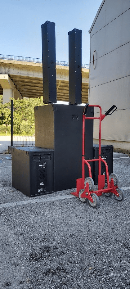

As promised to Art. here are three measurements of THAM and line arrays, all three measured on 8 meter radius, but with mic placed on various angles:
a) Orange line: on axis,
b) Blue line: 30° off-axis,
c) Brown line: 45° off-axis:
I've zoomed SPL range Y-axis when compared to previous measurements, in order to emphasize amplitude differences:
- The 30° measurement drops after 6kHz around 1dB, and 45° measurement drops more sharply on same 6kHz - drop is up to 7-8 dB.
Up to 6kHz all three lines are very close , so low-mid, mid and upper mid area is covered without any noticeable drop in level.

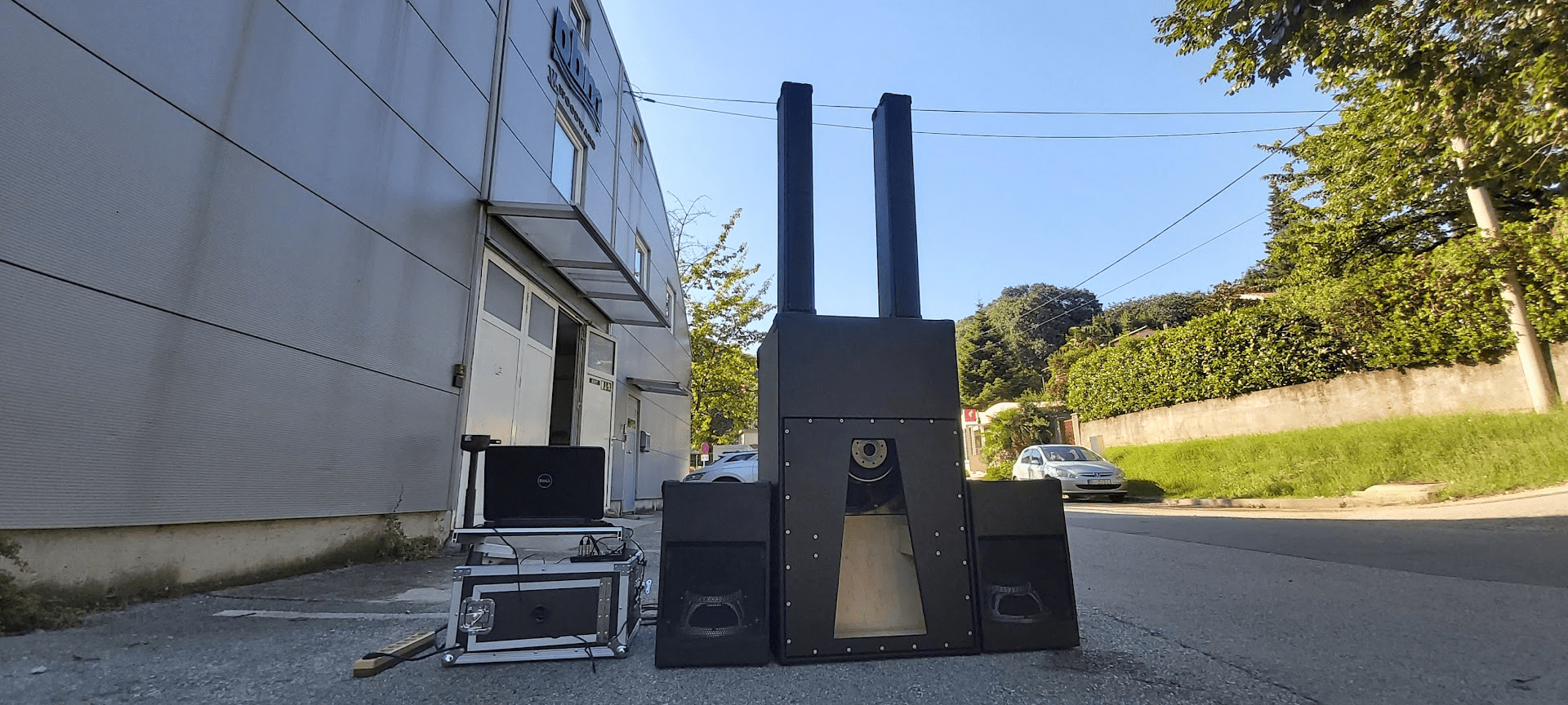

So, after spending one year with my system with THAM 12 , full-range line arrays (column speakers) and "Hypex" FA502 plate amps, here are my impressions (I'll try to be objective as much as possible):
1. Overall sound quality:
a) Pros:
b) Cons:
- Realistically, I never expected to get chest pounding bass from 3.5" line array drivers down to 100Hz, and they can't produce that for sure.
Currently , I'm crossing them around 160Hz, which is around maximum upper frequency for THAMs.
I wish that THAMs could be crossed just little bit higher , maybe 180, 200Hz, as this could relieve small 3Fe25 membranes from the excessive movement.

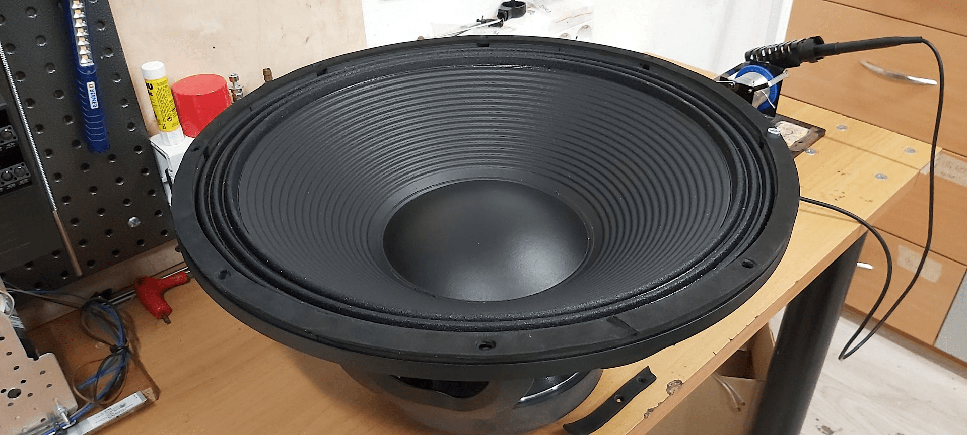

Around spring time, I was searching for suitable 18" driver & checking Hornresp simulations => while B&C 18SW115 is obviously the first candidate performance wise, the price seemed a little bit to steep, so I almost purchased cheaper alternative B&C TBW100...I said almost, as for some reason, I asked my self is there another replacement to TBW100.
And then I accidentally found interesting Beyma 18QLEX1600Fe sub driver:
https://www.beyma.com/speakers/Fich...ecnica-baja-media-frecuencia-18QLEX1600Fe.pdf
This driver could be purchased at that time for even slightly less price than B&C TBW100, so I ordered one unit.

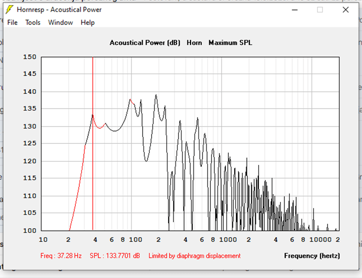

Hornresp simulation shows that it should work in Keystone at least as good as B&C TBW100 -here is simulation with 1200W applied:

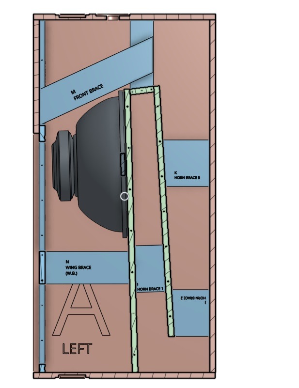

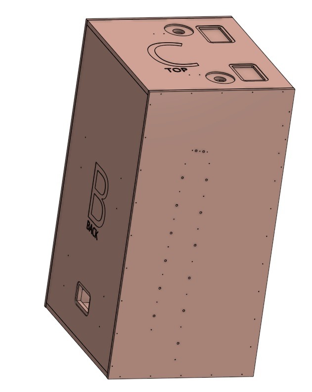

After ordering driver, I immediately started working on conversion of Keystone Sub plan measurements to metric, and simultaneously, I started to draw 3D model of the complete Keystone Sub.
In order to mount internal bracing, I've created screw holes for each brace & adjacent surface, so that during actual assembly I can quickly glue brace & tighten brace at exact position with wood screws.

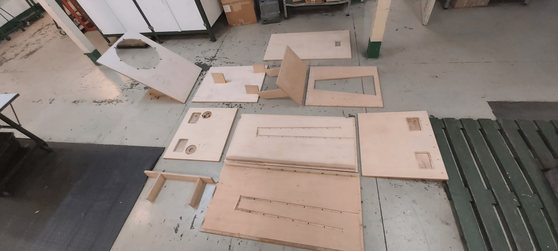

After 3D design was completed, and checked for eventual clashes, I've had to optimize nesting of the parts on plywood stock.

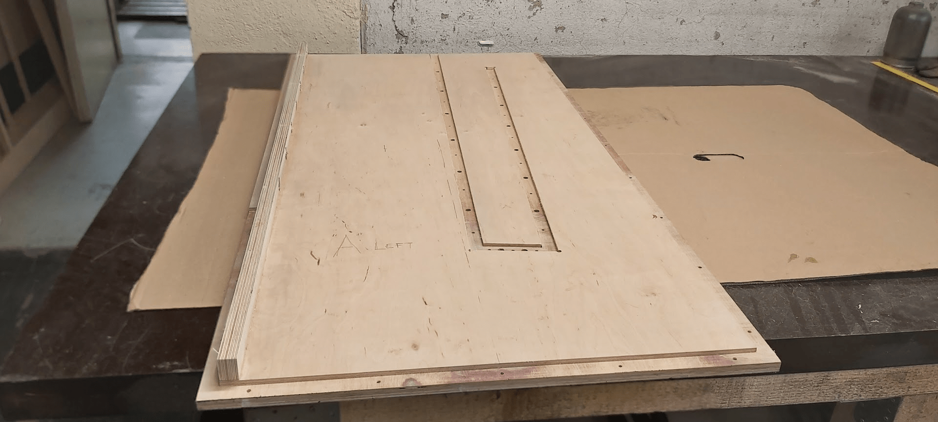

Optimum CNC cutting combination was placement of all parts to 5 separate 18mm plywood pieces, where each stock piece is 1250 x 1240mm.

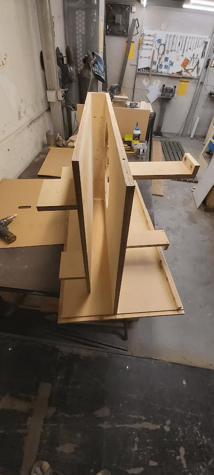

Even though the most of the parts could be cut by CNC router, there are few internal parts that had to be done on circular saw & angle jig.

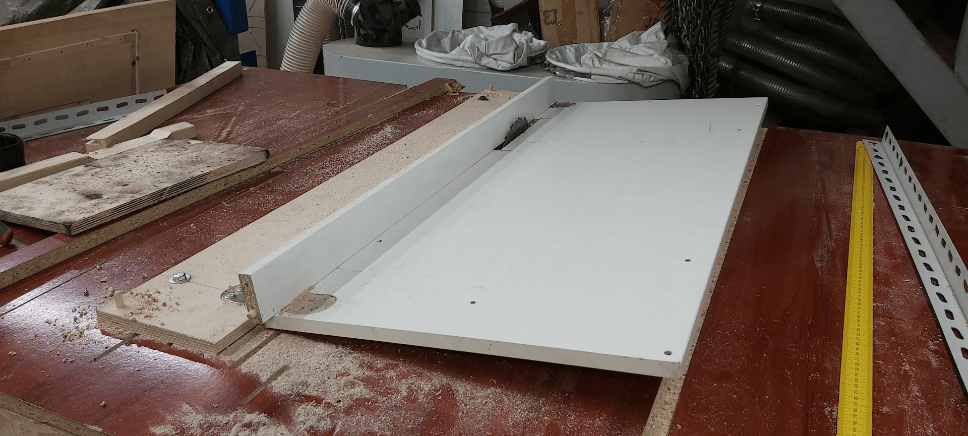

As I didn't had access to table saw with precise adjustment of the cutting angle, I've made large table saw from existing hand-held circular saw installed upside down (and left-over material), plus I added simple sleds for straight cross-cuts, and one additional simple angle jig:
This simple jig is designed for smaller angles, ideally under 30°, and this will be sufficient for my purpose,

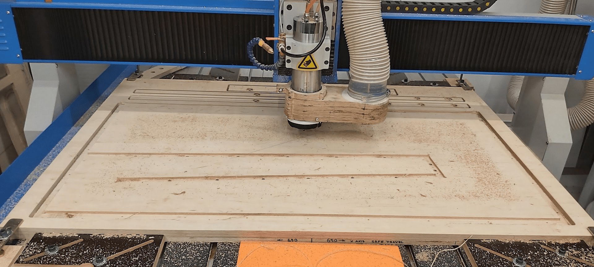

When placement of all parts was defined, then I prepared CNC cutting file, and started cutting all 5 plywood pieces:
When all parts were cut, I've cleaned the edges. Then, I've installed M6 T-nuts, and cut the one prong that is protruding towards hole center on all T-nuts.

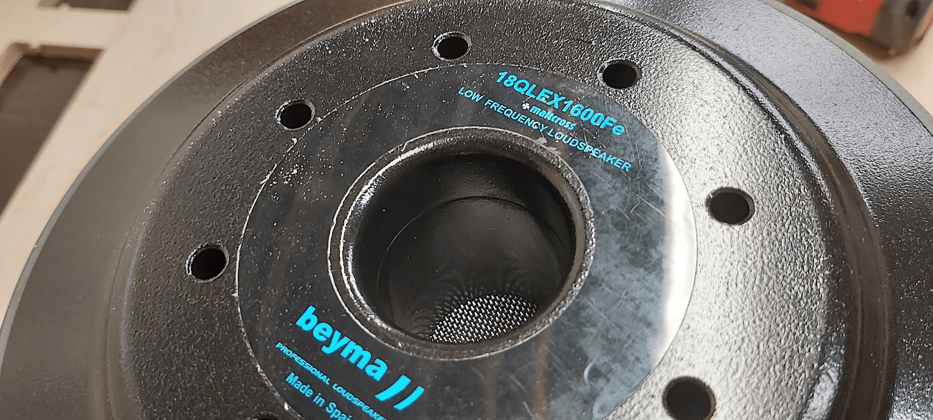

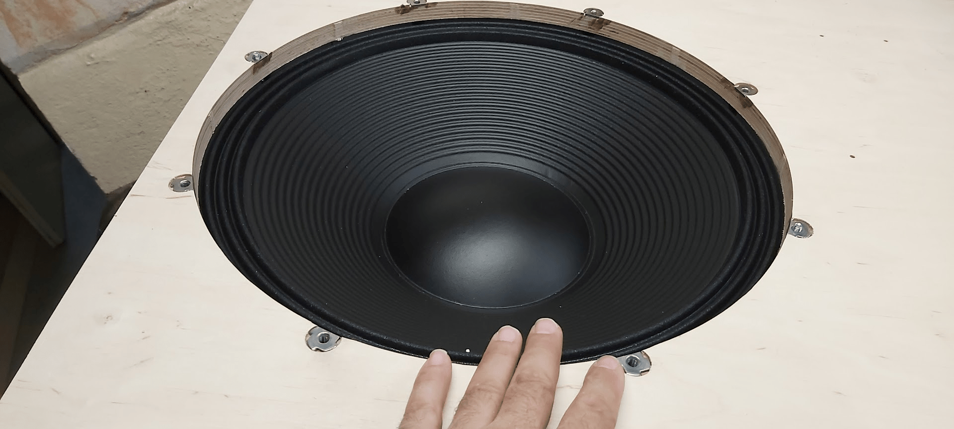

Then, I've checked fitment of "Beyma" driver on the baffle- just to check if the main opening is correctly sized, and surround can freely move without touching plywood edge:

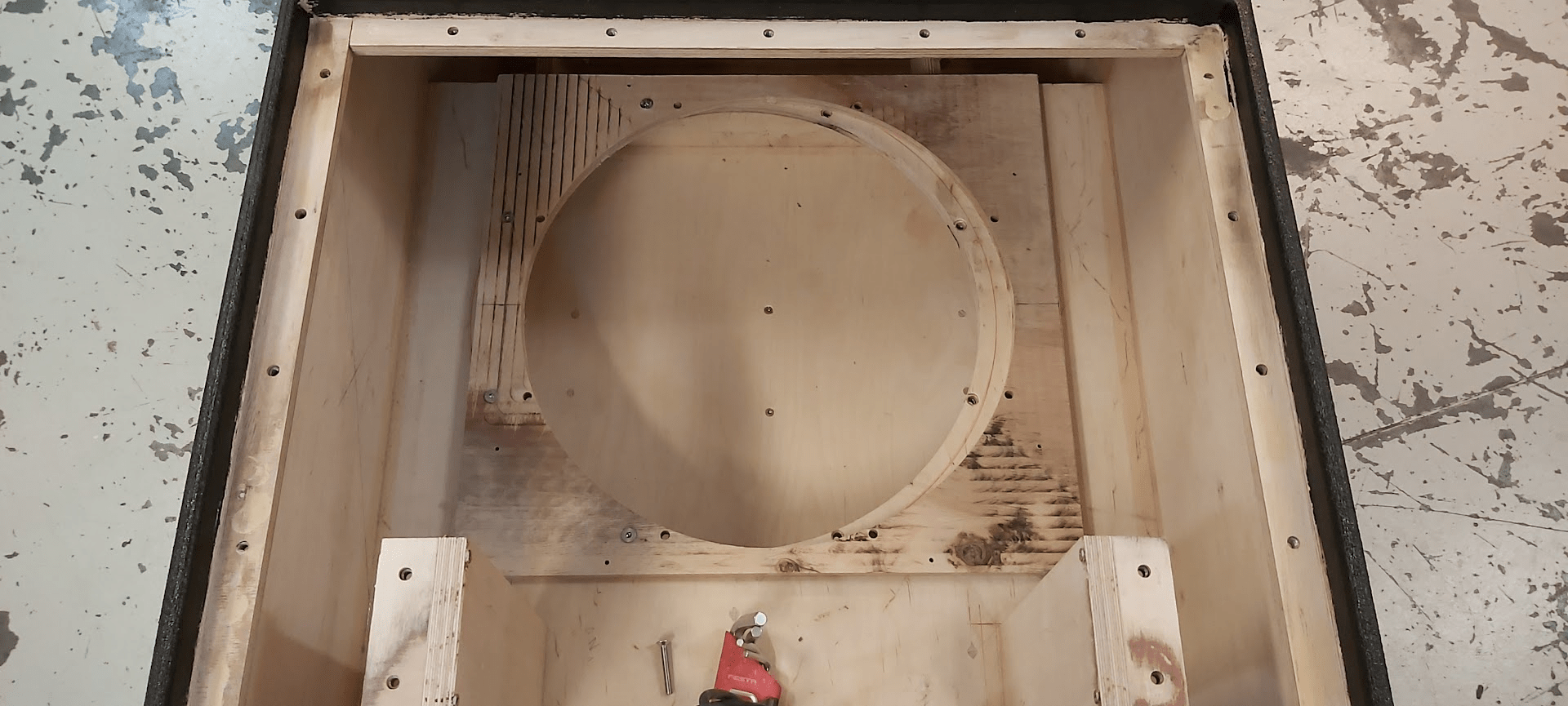

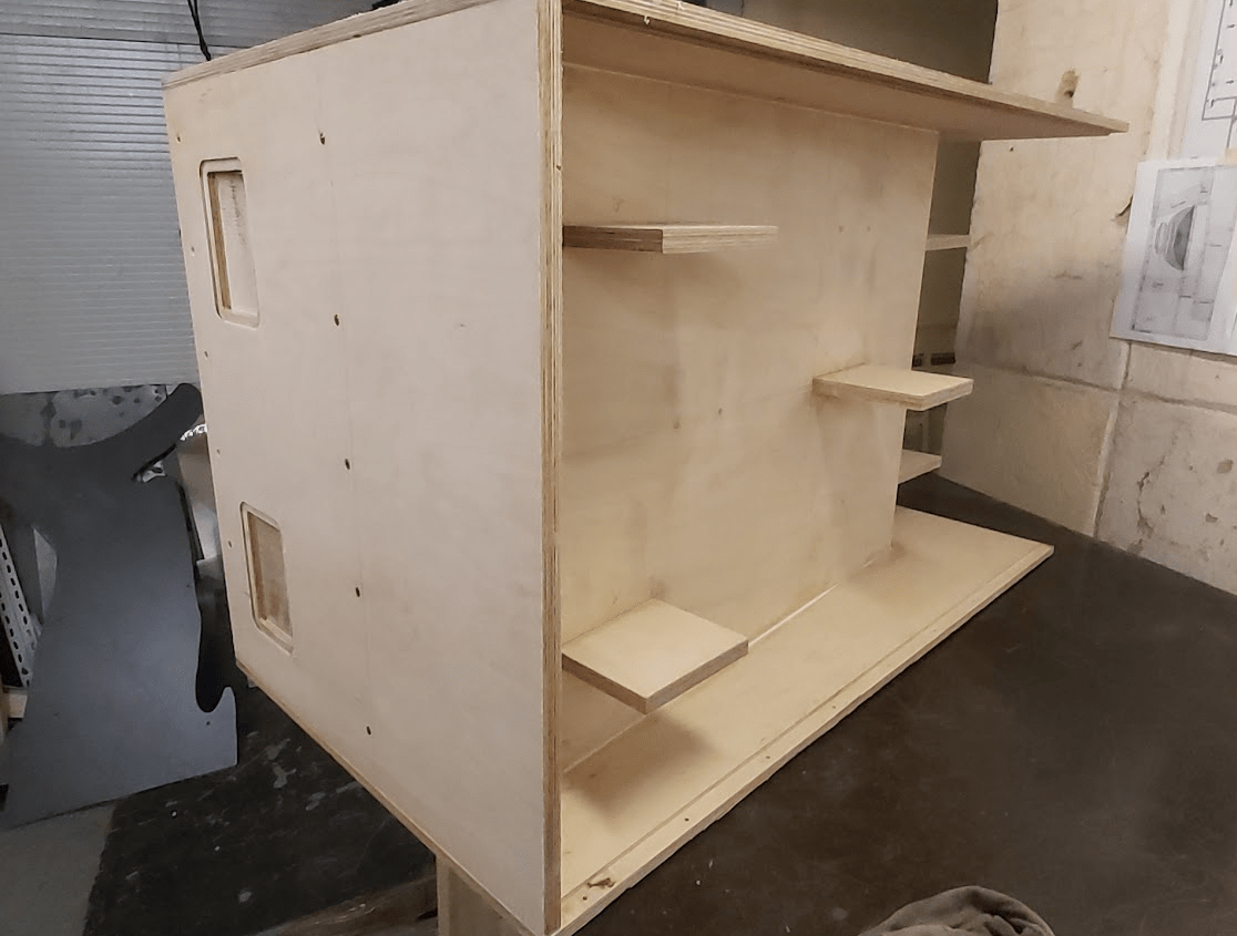

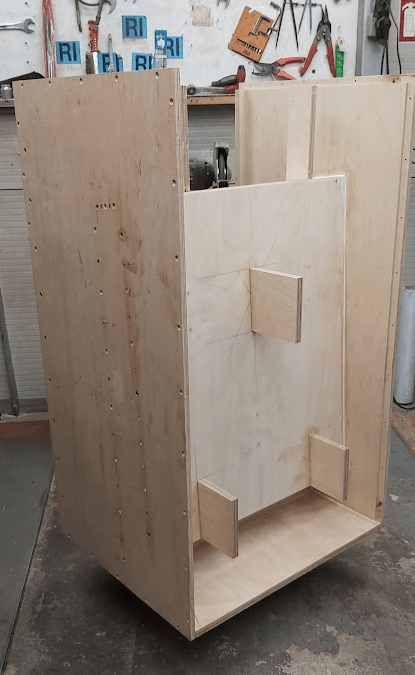

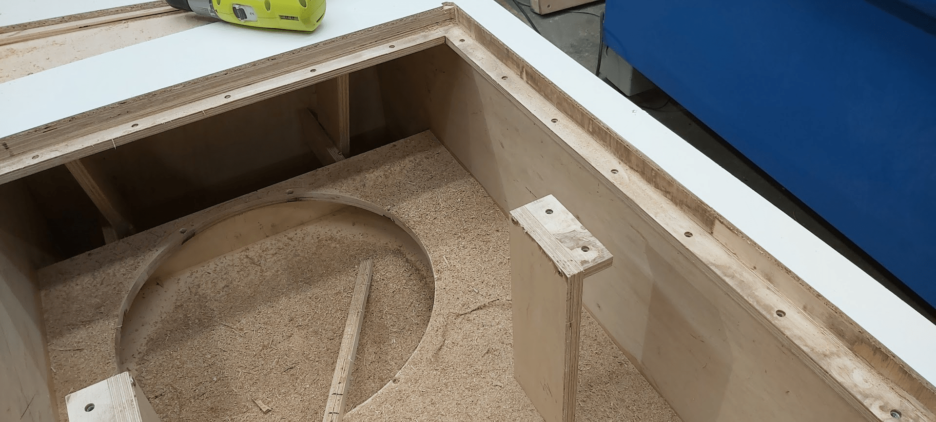

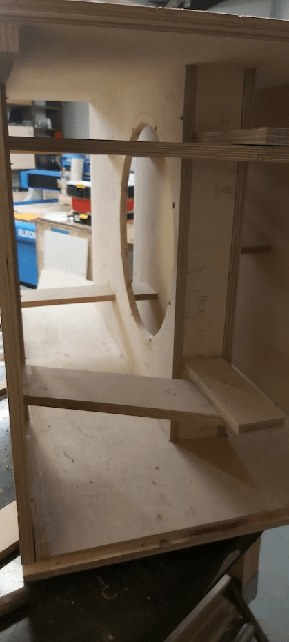

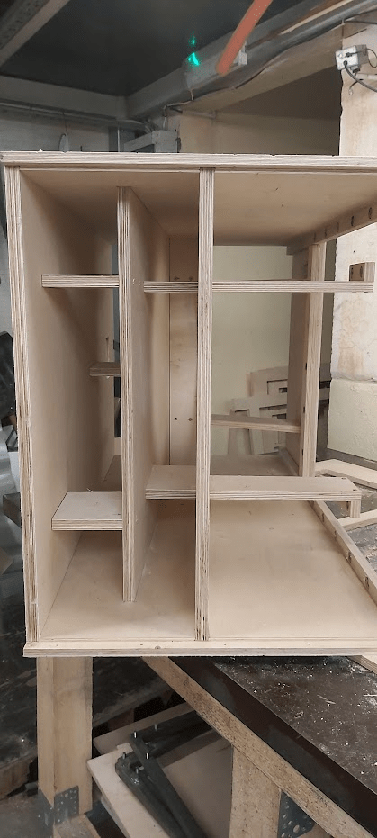

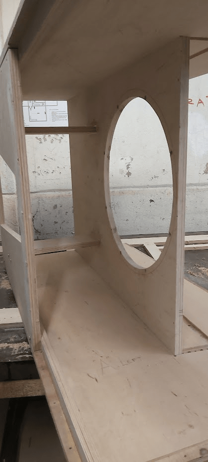

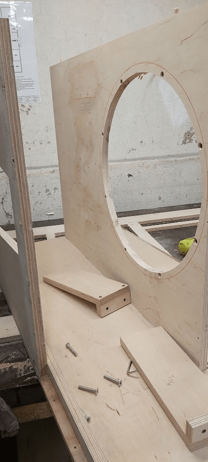

After that, I tried "dry" assembly => checking fitment of all parts, trying to identify issues before applying glue, and correcting issues if possible.

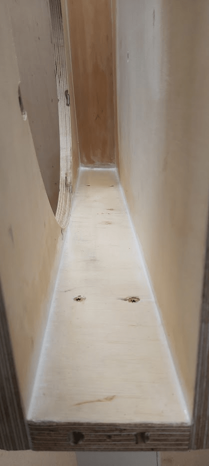

Additionally, I've marked screw holes for attaching internal braces:

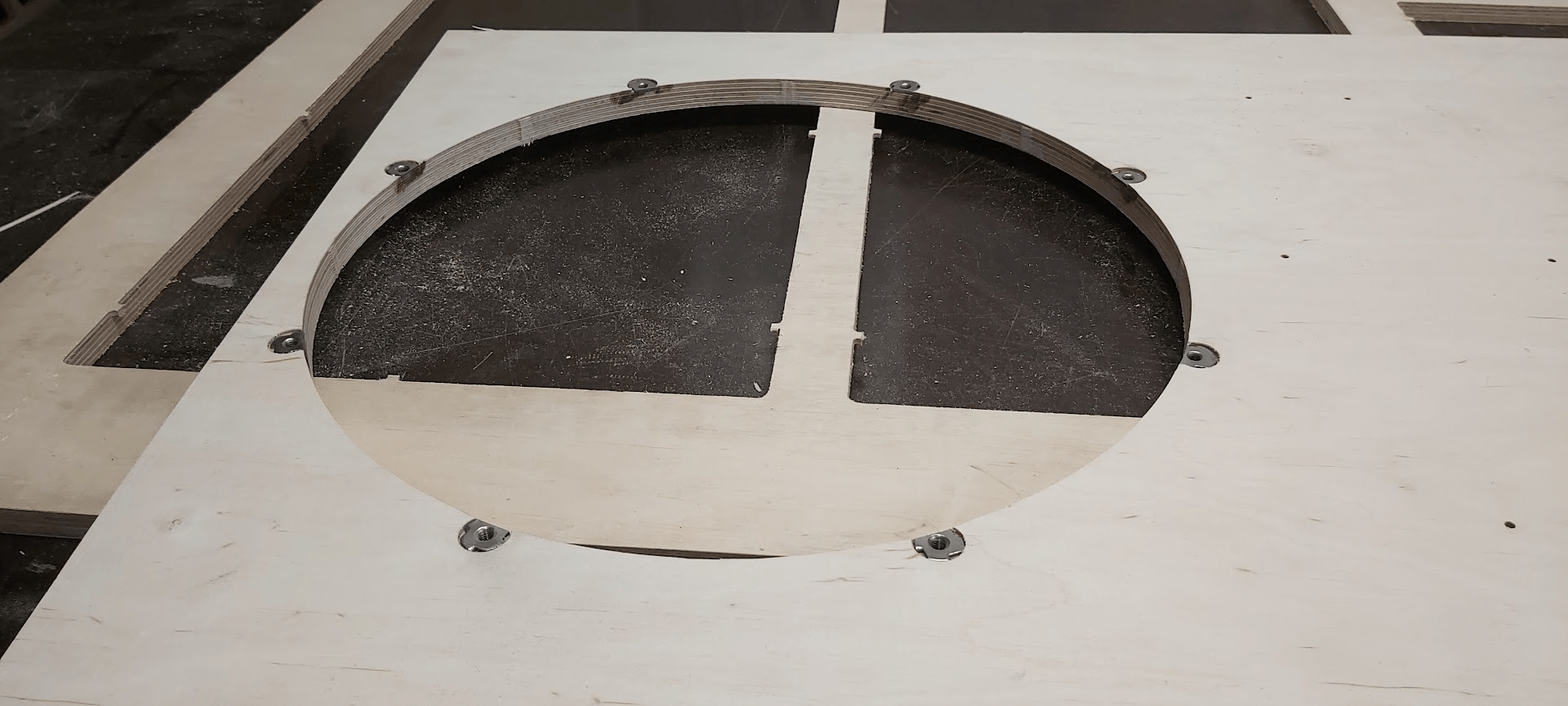

(NOTE: Unfortunately, at that time I didn't catch one major fail => the driver baffle itself was cut with driver hole offset from the centerline => the offset was 50mm horizontally, and at that time I didn't catch it, but it would be so much easier that I replaced it simply with new piece at that stage.
Later investigation showed that CNC spindle was overdriven by too aggressive feed rate, X-axis stepper motor slipped and this slip created 50mm horizontal offset).

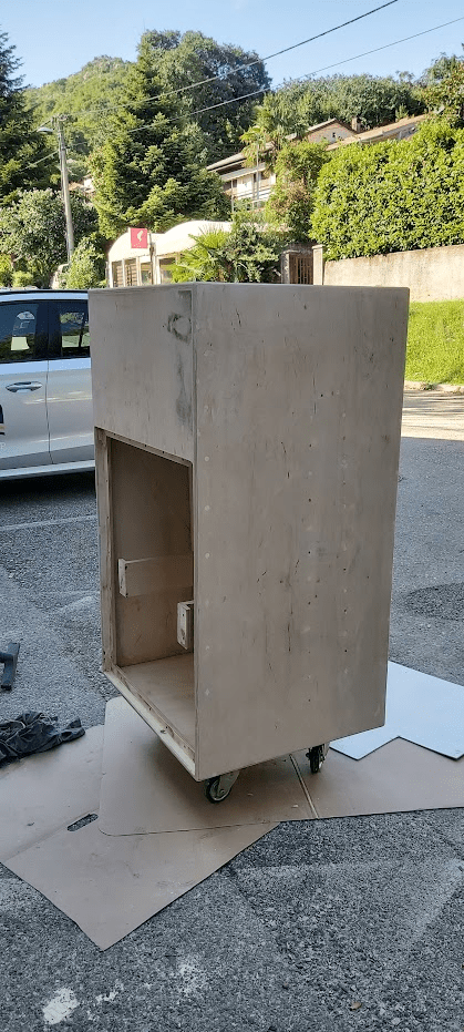

When the whole box was fully assembled, I've check fitment of the removable mouth plate - I was not satisfied with flatness of the four cleats, that will hold mouth plate, so I took a hand router and resurfaced everything until flat:

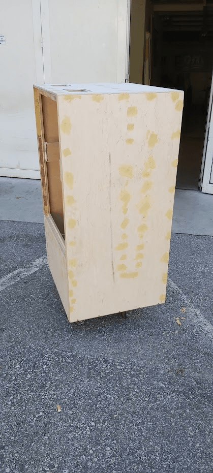

After that, I've used polyester kit to cover all screws & wooden dowels, and sanded everything with belt sander:

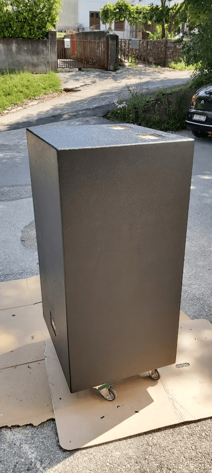

Then I've used loudspeaker paint and painted box and removable mouth separately:

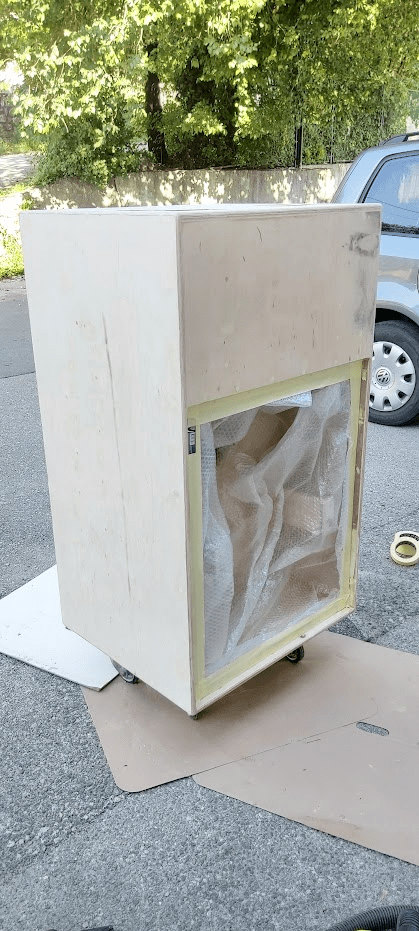

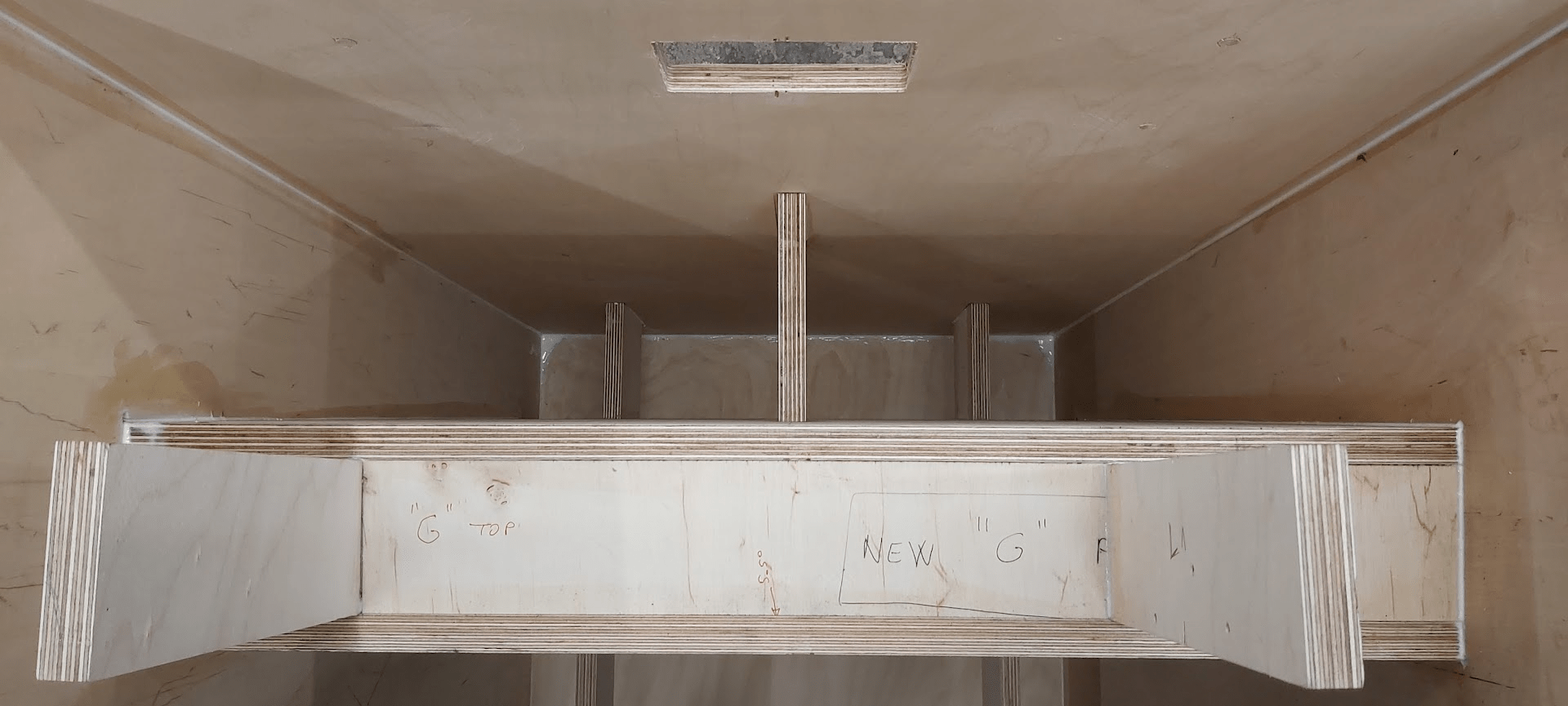

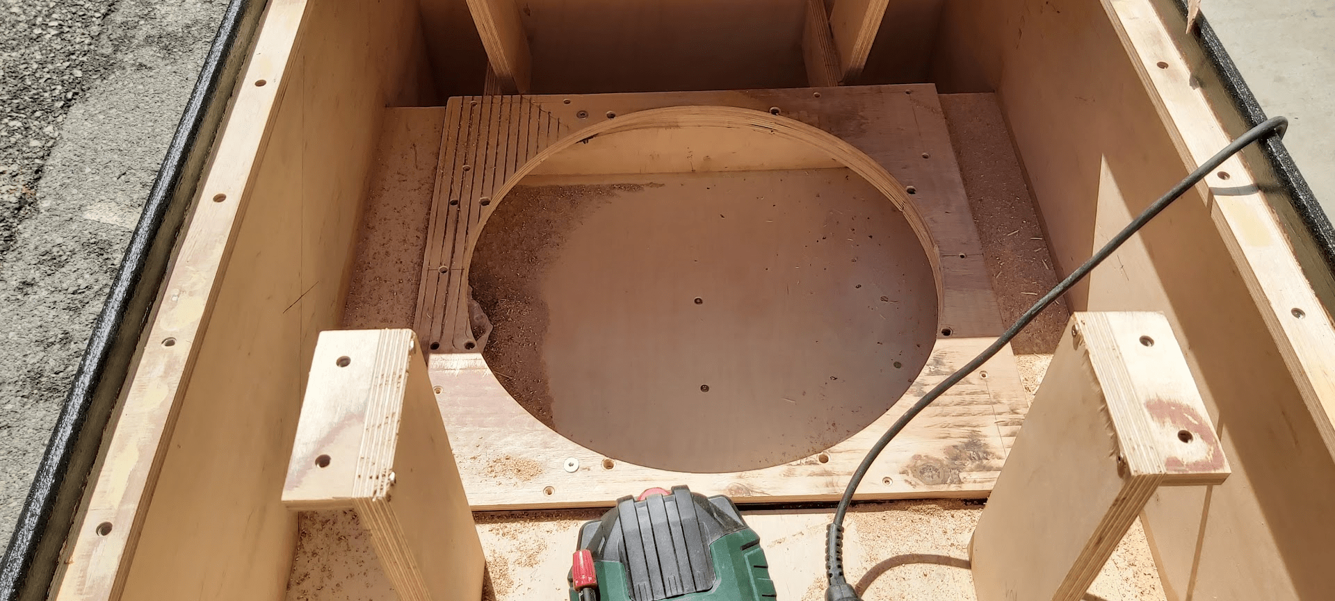

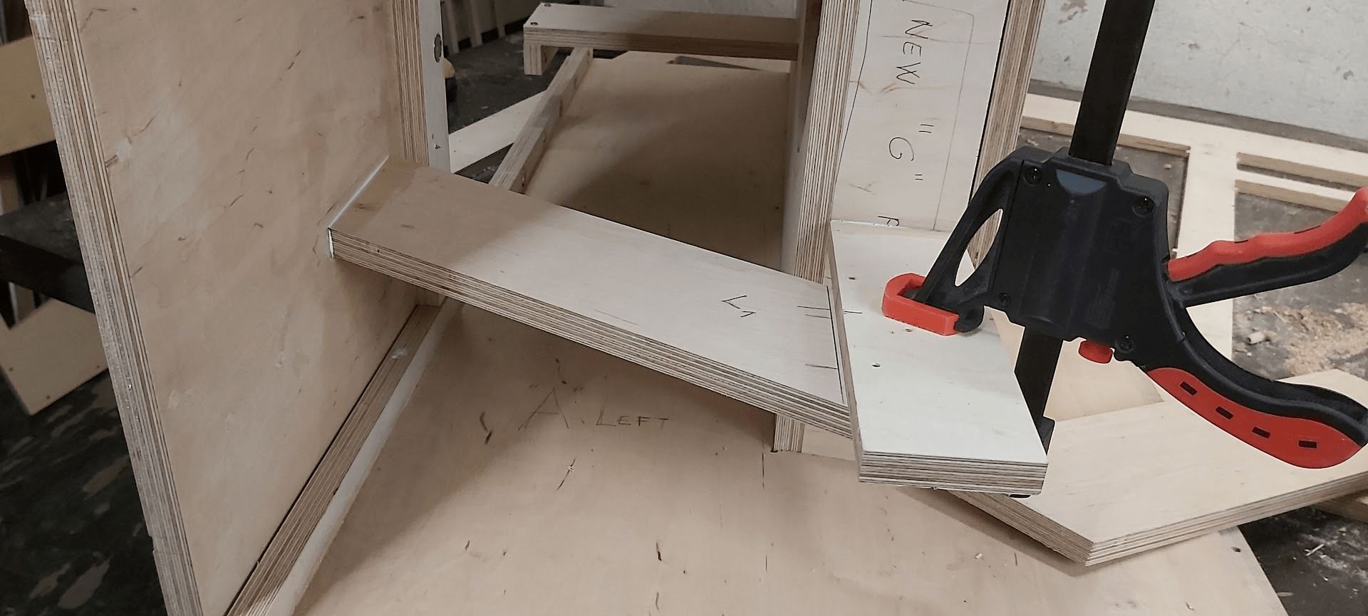

Now when the box was almost completely finished, I was looking at my CNC-cutting mistake (aka "the driver hole with 50mm offset") , and I decided to rectify this by making new adapter plate that will be positioned correctly, plus I would cut crescent-shaped plywood piece to cover empty area under new adapter:
When new driver mounting adapter was finally glued in position, the only thing that was left was creating gaskets for sealing removable mouth plate.

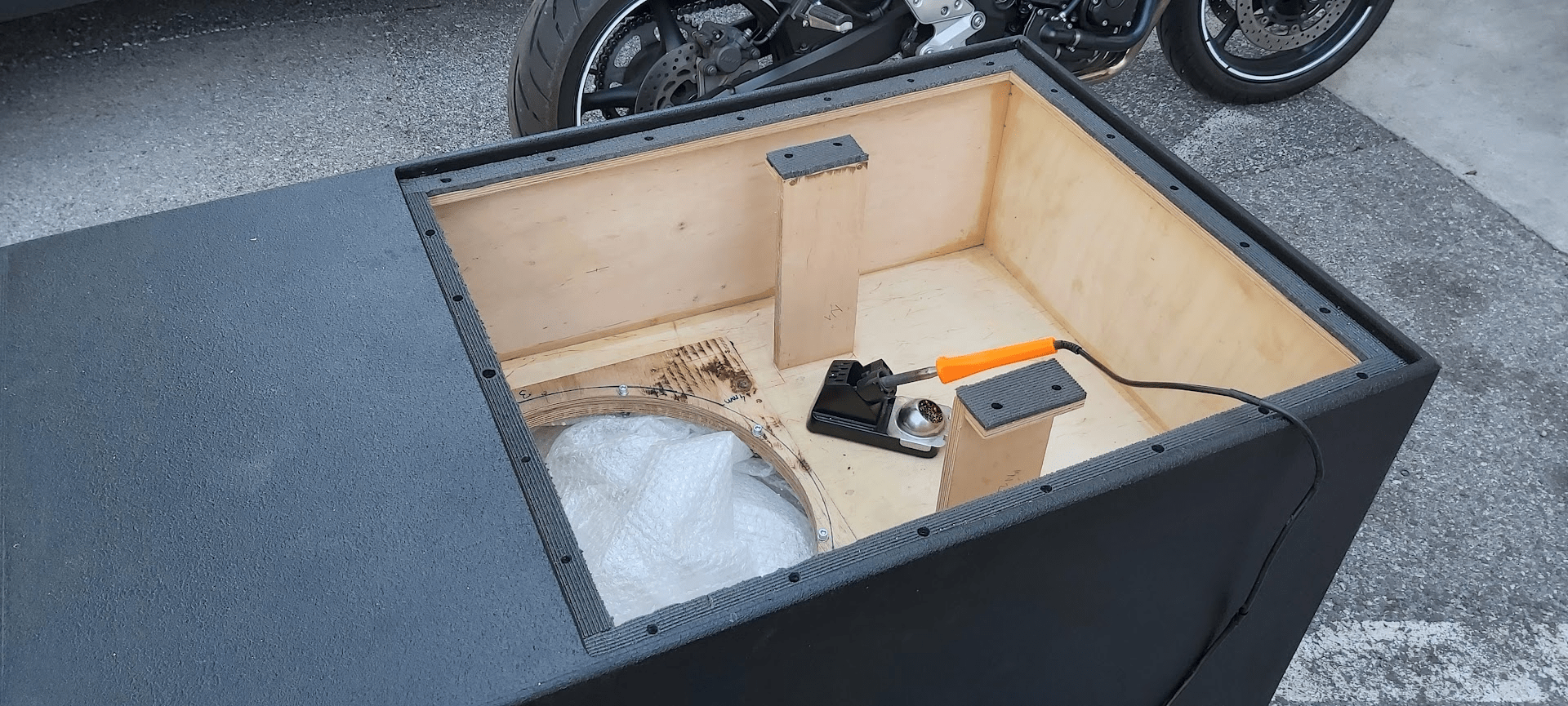

I've choose to use yoga mattress material, as it is relatively thick, but can be easily compressed and can be quickly cut to size.
So'I ve cut material to separate pieces and glue them with 2-sided sticky tape.
Holes for mounting bolts were done with 60W soldering iron, quite easy & quick method:
Sealing of the driver was done with thick, self adhesive weather strip tape, and I also cut the mounting holes with soldering iron:

As Keystone Sub will be passive, I had to use suitable amp for initial testing & DSP configuration - unfortunately at that time I didn't had suitable 19" rack amp, so I purchased additional "Hypex" FA502 amp and configured it to work in bridge mode (1200W RMS on 8 ohm).
In order to temporarily mount FA502 in my rack, I've designed simple plate adapter and cut it on CNC (19" wide, with 6H approx.):

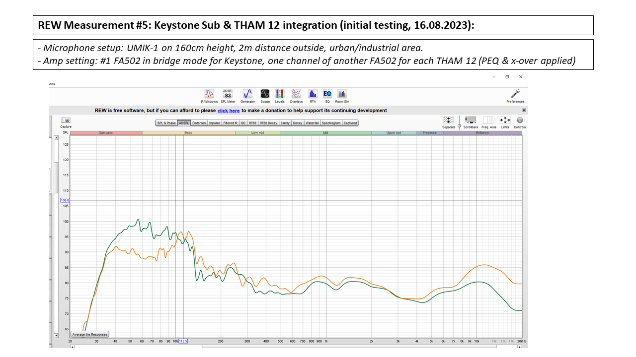

The integration of Keystone Sub with the rest of the system was relatively straightforward - there are various crossover combinations between Keystone and THAMs, but for a start I used on my bridged "Hypex" FA502 (that is powering Keystone Sub) these settings:
With above settings, I assumed that there should be wide overlap between THAM 12's and Keystone, but first REW measurements showed that my initial delay settings are not correct => when both THAMs & Keystone were combined , there was a big peak between 90-125Hz, and much lower output from 40-90Hz.
Hmmmm, then I inverted polarity on Keystone , and tried to measure again => this time integration was much better, with much smoother output from 40 to 120 Hz (Orange line=>NON-inverted Keystone, Green line => inverted Keystone output):
I've saved these settings and organized one small, private party where Keystone Sub will be used for the first time - the location was perfect for this, as this is small but isolated open air sports center, with two tennis courts, one football pitch and one sand volleyball court.

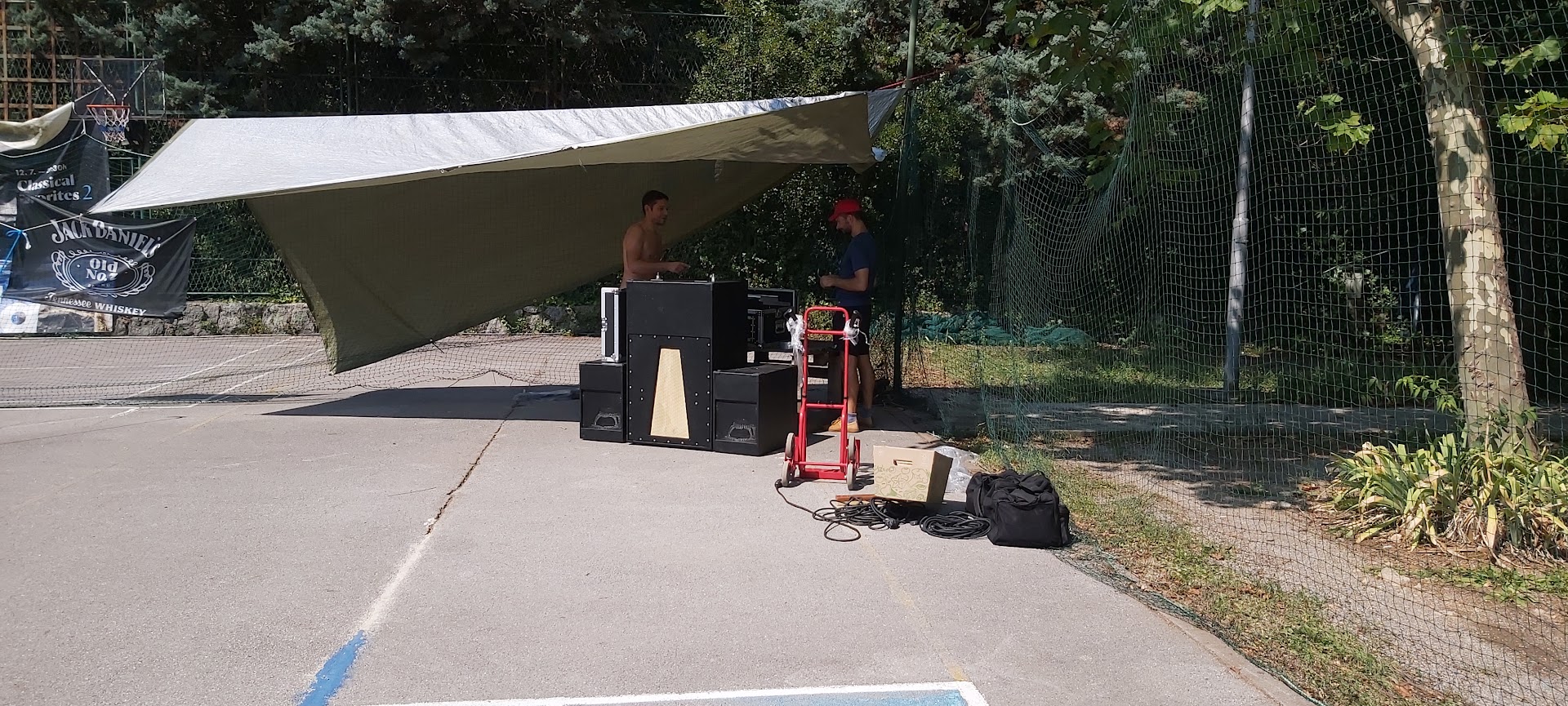

Anyway, I've rented area comprising two tennis courts for 1 day event for around 25 guests (with additional 15 kids cca), and started with equipment installation from early morning.
After everything was installed, and before any guests arrived, I had a time to perform couple of REW measurements, play various audio material and record couple of video clips, so here are the details of the field layout and speaker placement:
The good thing was that I've had couple of helpful friends that could help me to bring equipment to location - as it was hot, summer day, we had to install improvised shade above equipment:
Now, couple of videos =>here are four videos, taken from various distances:

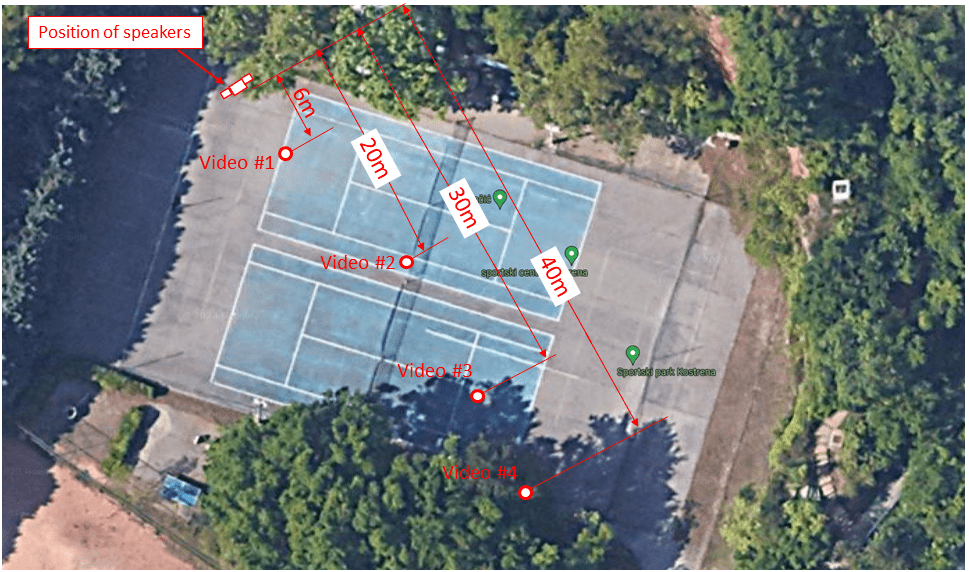

a) Video 1 => taken from about 6m distance (and going little behind to 10-12m ):
b) Video 2 => taken from about 20m distance:
c) Video 3 => taken from about 30m distance:
d) Video 4 => taken from about 40m distance:
