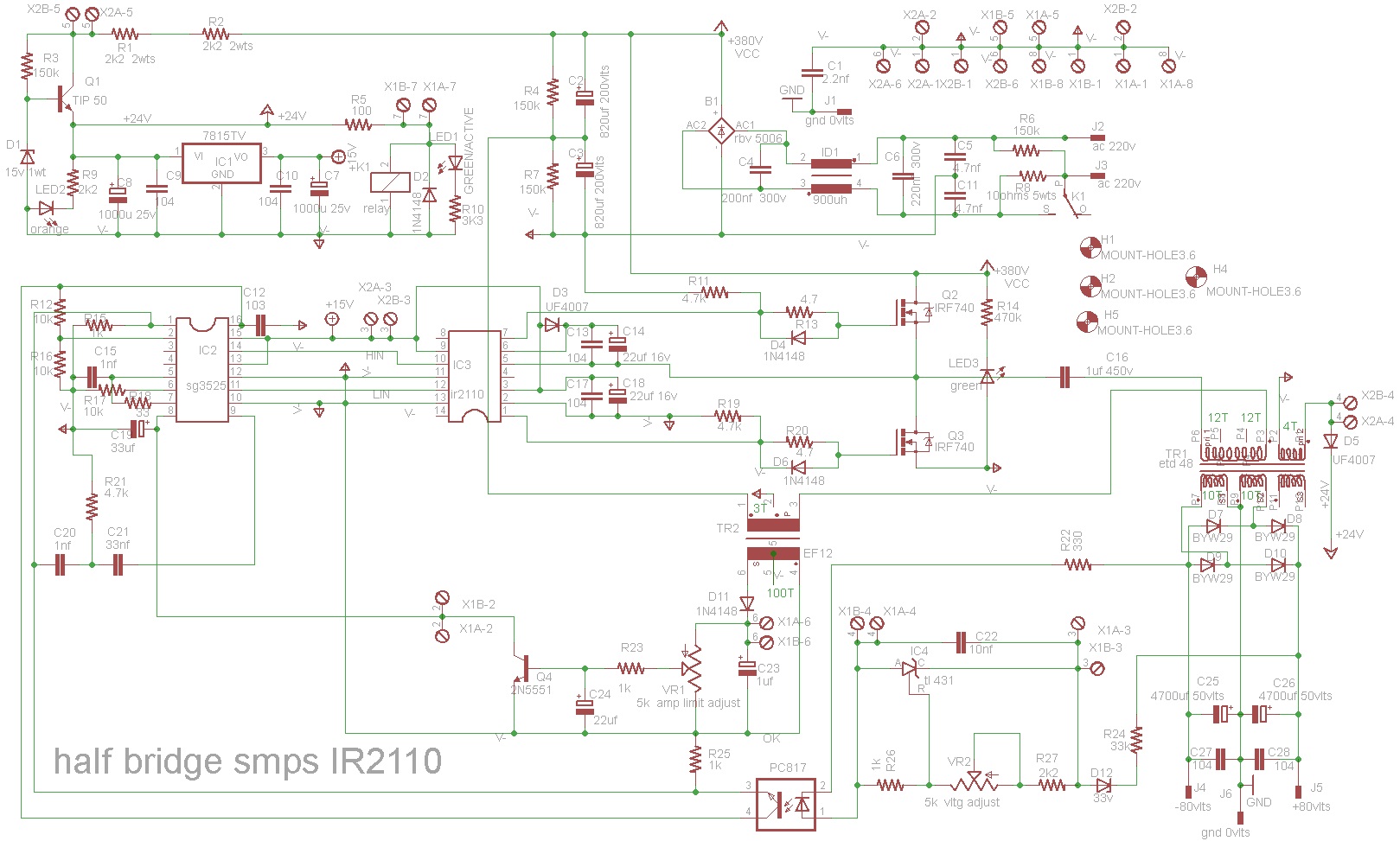

That will not work, it will blow up in your face because the gate driver is a mile away from the switching fets, even if its only a 20kHz smps, the IR2110 needs to be as close to the fets as physically possible.

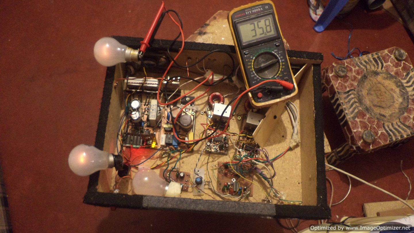

i will post pictures of the smps working soon
Also you forgot to hook up some power to the SG3525 and the IR2110.
I cannot see a "+15V" or a line going to any source of power apart from the negative rail.
Not to mention there is no filtering what so ever of the output which is BAAAAAD!!!

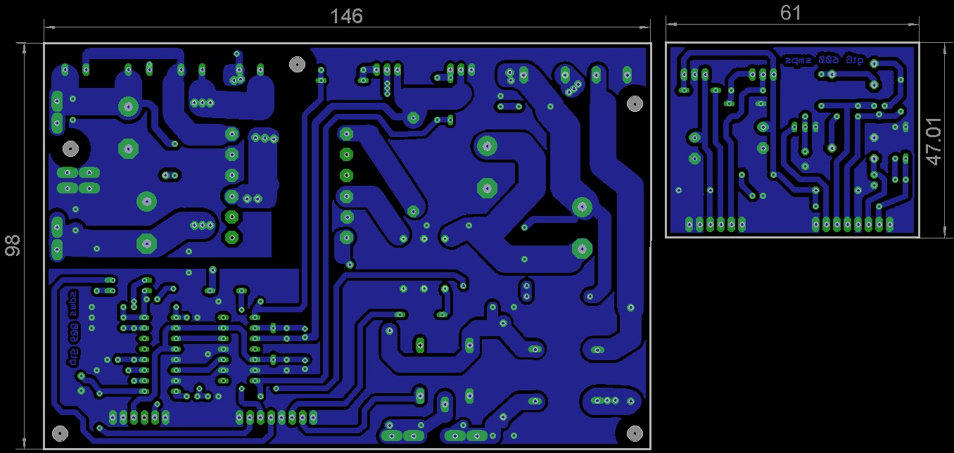

thanks tekko. i have etched three boards i will loop a wire to the power of the i.c's . also make the correction and post the revised version.

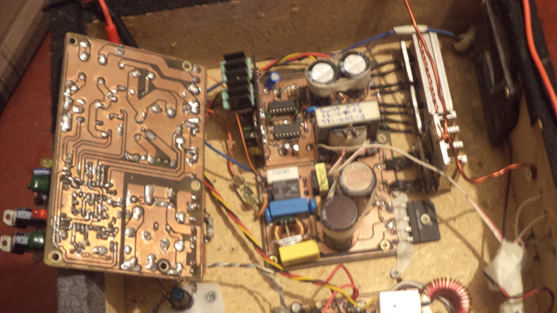

the smps is based on the one i previously made and is working well to date. i changed because i needed simplicity in mounting.
the previous version >>>>>>
the pictures

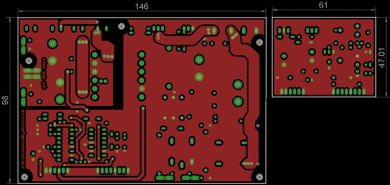

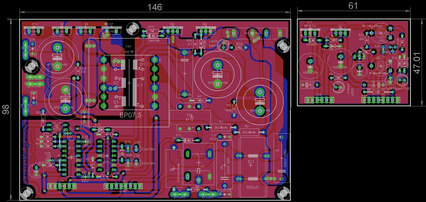

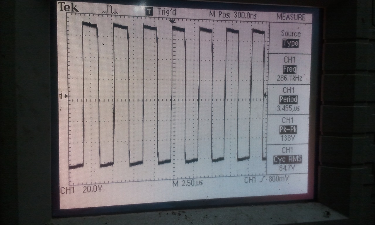

My test regarding AUD600 class d amp
fsw=310KHz will give better LF,MF and HF(below 300KHz better for MF bad LF good HF and above 310KHz better for LF,good MF and bad HF)
supply rail will vary fsw so we must adj. freq. near/equal to 300KHz
