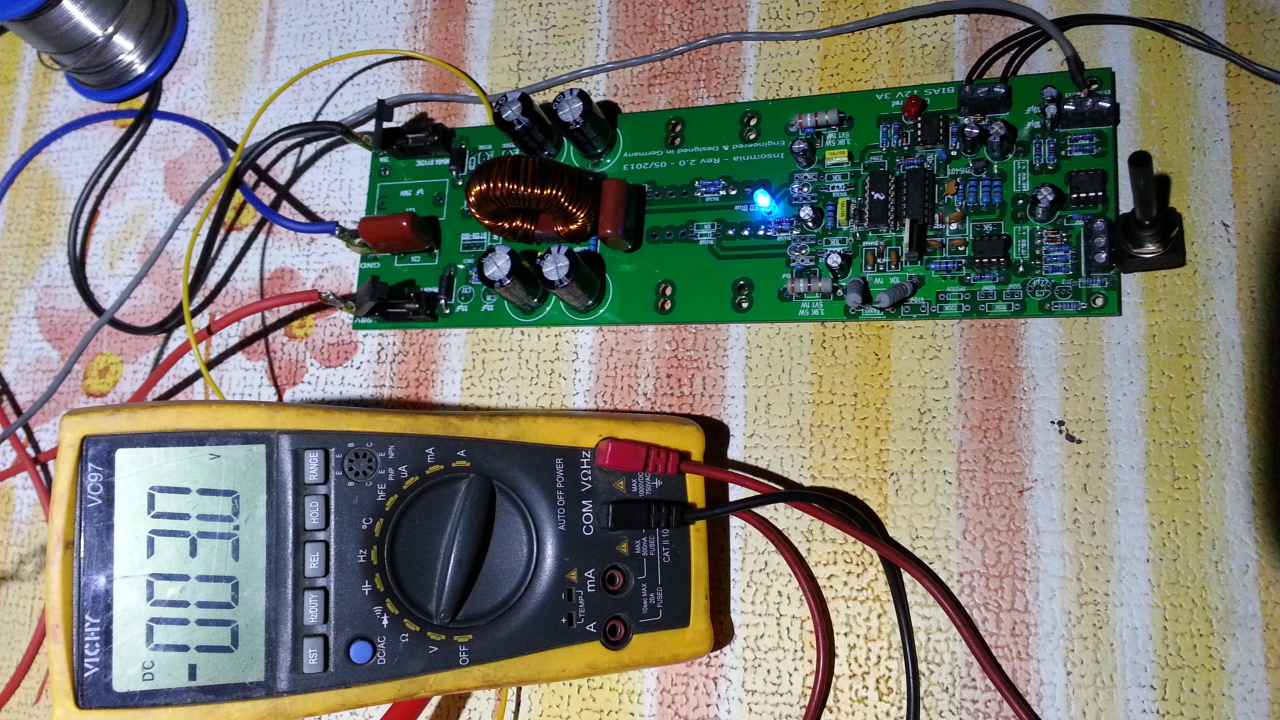

Hi manojtm
Have make AUD600 Rev3.0 but have 3V DC output - no music comes out
look pic PCB and schematic
Is it possibile my schemtic is wrong/ error
it looks like amp start oscillation and ready to work because blue control led is on
but why have 3V DC output with no input signal ?
Is setup instruction available to check faults for first time trouble ?
Mosfet IRF640N
Have try Hex Inverter CD4069 and 74HC04 .... same no music but 3V DC
Any idea or solution ?

Hi Insomnia,
no problem found on your schematic except DC-OFF set. you don't need DC offset control.DC offset down to 1mV-10mV when you change R20 resistor value increase to 10K.and R19 use 2K 1%.

Hi Manoj
are you sure ?....because R19=2K is for switching frequency and in your schematic its 1K.
Have take Scope
HIN and LIN from IR2110 have signal
Signal from Mosfets out to output Filter show Square Wave
Isi it possibile output Filte have wrong value and I dont have music against output filter problem ?
You need to check if the input signal is modulating the square wave.
Apply a sine wave to check it or even some music.
> Does a music input modulate the square wave into ir2110
Signal from CD4069 or 74HC04 modulate with music to HIN and LIN from IR2110
But output from Mosfet to output filter show fixed Square Wave.
Is this ok or wrong ?
I can hear very very quiet a little bit music with distortion
Can be output filter wrong or wrong value ?
I forget, the 3 x 1NF capacitor to TL071 are ceramic, is this ok or does oscillator not work with ceramic capacitor
With a large input signal the output should be modulating a lot.
I would check your input signal into the comparator to see if it is big enough.
It will need quite a swing to fully modulate the output.
Hi Manoj
your schema shows 1K pot with 500R. it will reduce fsw,so that i said use 2k in-lieu of 500R
