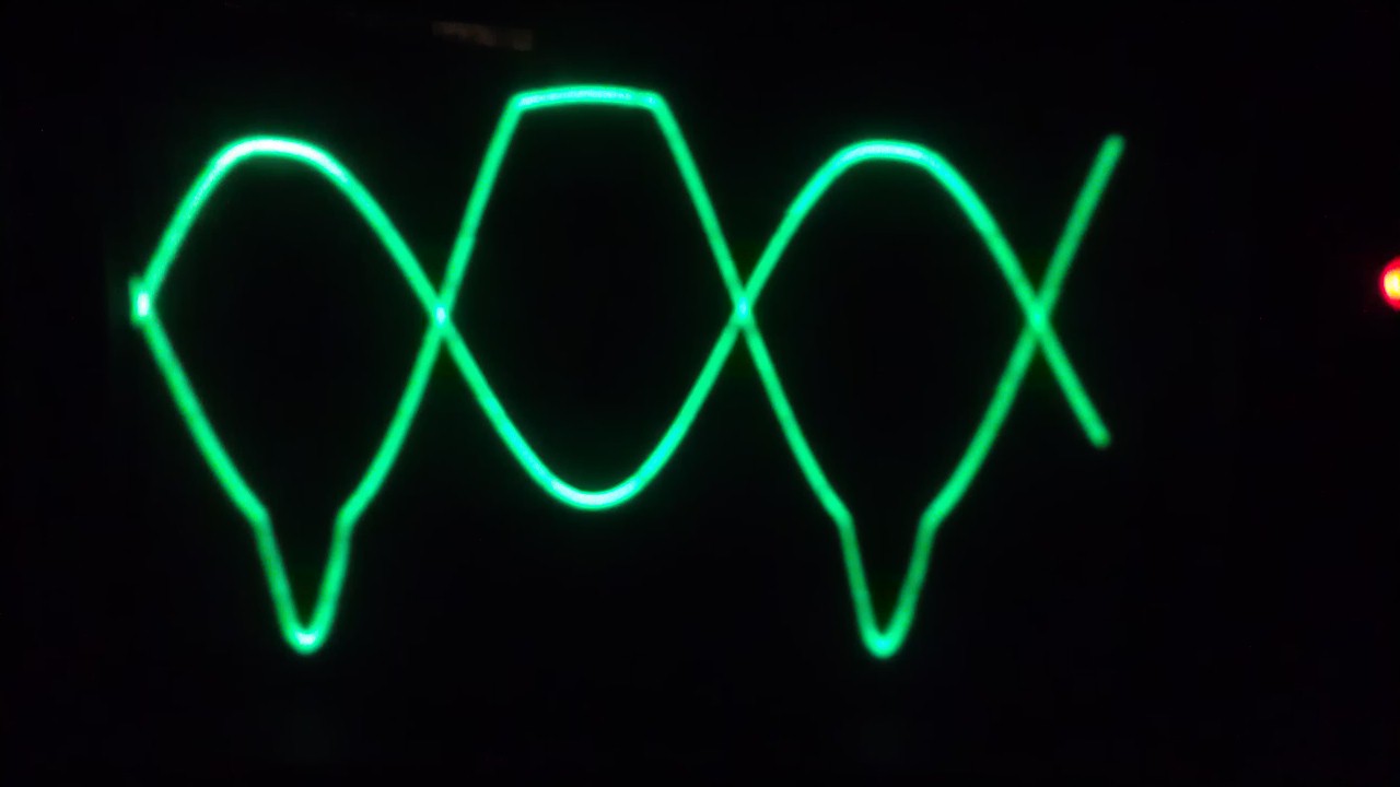

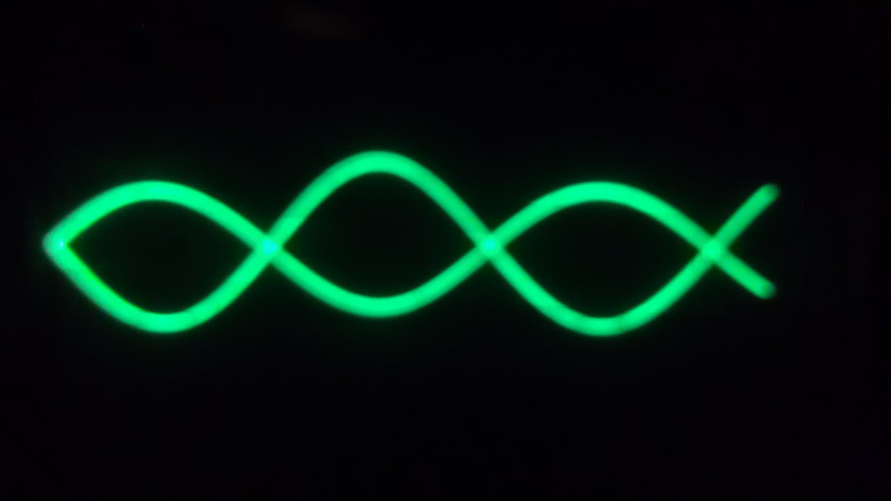

SCOPE SHOTS OF MY CATHODYNE
Wasn't too hard, never tried putting two channels into my scope, had to make up another capacitor-protected probe. Took signals (400 Hz off my SigGen) off PI going into the grids of the 6V6s. It looks more gnarly-looking than it sounds, and is a real laser-show when you play guitar thru it! Can anyone out there read what these signals show? Thanks!
That's nipple distortion from the cathodyne. Didn't you read the valve wizard links I posted? Add 470k grid stopper to the cathodyne and check again.

Thanks Dave. I've had http://www.freewebs.com/valvewizard/cathodyne.html in front of me the whole time. I see the recommendation to use 100K stoppers, but only really needed for Class A (will connect scope to common output signal - see ToneLizard, Tales From The Tone Lounge; Biasing an AA1165 Fender Princeton reverb!, for his scope shots), to see if it the "nipple" (negative gain spike on the anode) made it thru to the 6V6s or not).
There's no way for me to tell. I don't know the scale, settings and state of your scope and the schematic is rather incomplete concerning the cathodyne. First thing I would do is to check if indeed the scope is working as it should. Every scope should have a calibration point. A connection with a 1kHz 5V square wave. Connect your probes there and see if you're measuring whats expected.
Where do you take the output from at the cathode side? At the cathode or after the bias resistor?

The imbalance in the first scope capture isn't too bad. It could even be attributed to resistor tolerance (although like funk1980 said, without scale it's impossible to tell). Once the PI starts to be overdriven the imbalance gets worse, which is somewhat unavoidable. In a guitar amp, imbalance like that usually produces some good tones and harmonics. Personally I wouldn't be concerned about it, except for the nipple distortion. Even that can be overlooked if it's not causing any unpleasant tones.

Mr Funk: I'm building circuits and looking at things on my meter and scope that I never have before, and trying to relate to all the information I can find on the Internet and this forum. Could you explain what "a factor of two" means? I have yet to put any kind of grid stop resistor before my PI, in the hopes of reducing the distortion (and maybe allowing the PI to do its job better?), but plan to and will test different values for their effects. Thanks!
By a factor of two I mean the peaks and valies of one wave are about half the value of the other. Make absolutely sure the voltage/division settings (coarse and fine if separately available) of both channels are set the same. Also check if both probes are measuring the same amount by connecting them to a know source. Once you're sure both channels are equal, you can measure the difference in output from the PI.

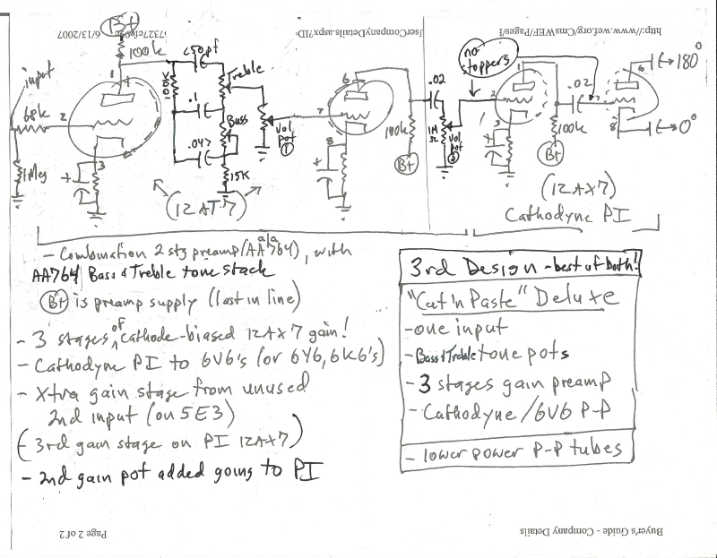

I will check both scope channel calibrations (do have reference on scope). My PI and power sections are exactly like the 5E3 - see pic, except for a 500K pot on PI pin 7 (in series, not to gnd) for grid stop testing. The hand-drawn dwg is my current preamp schematic, showing use of both halves of the 12AX7 for gain on one input, and tone stack from the Champ AA764 (currrently disabled for my testing - lifted gnd). I wanted to make use of the extra 1/2 tube for when I put a LTP or other PI on the breadboard (in place of the Cathodyne), where I would lose the Cathodyne 1/2 tube of gain.

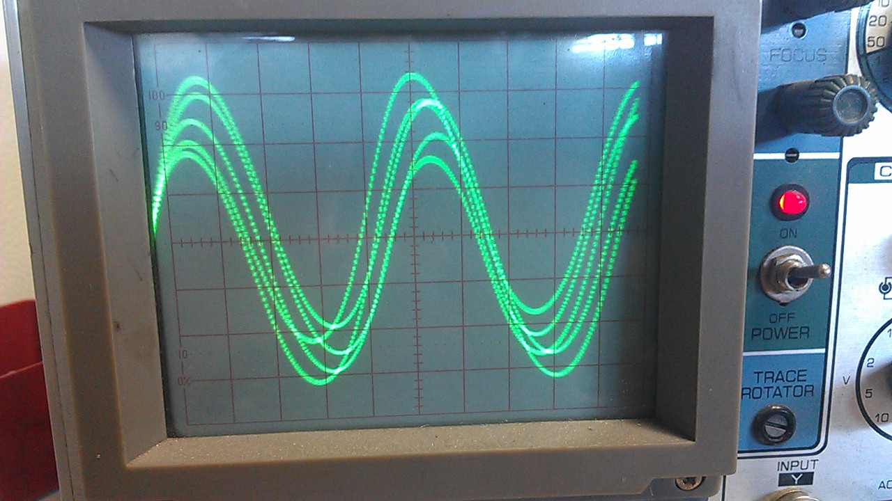

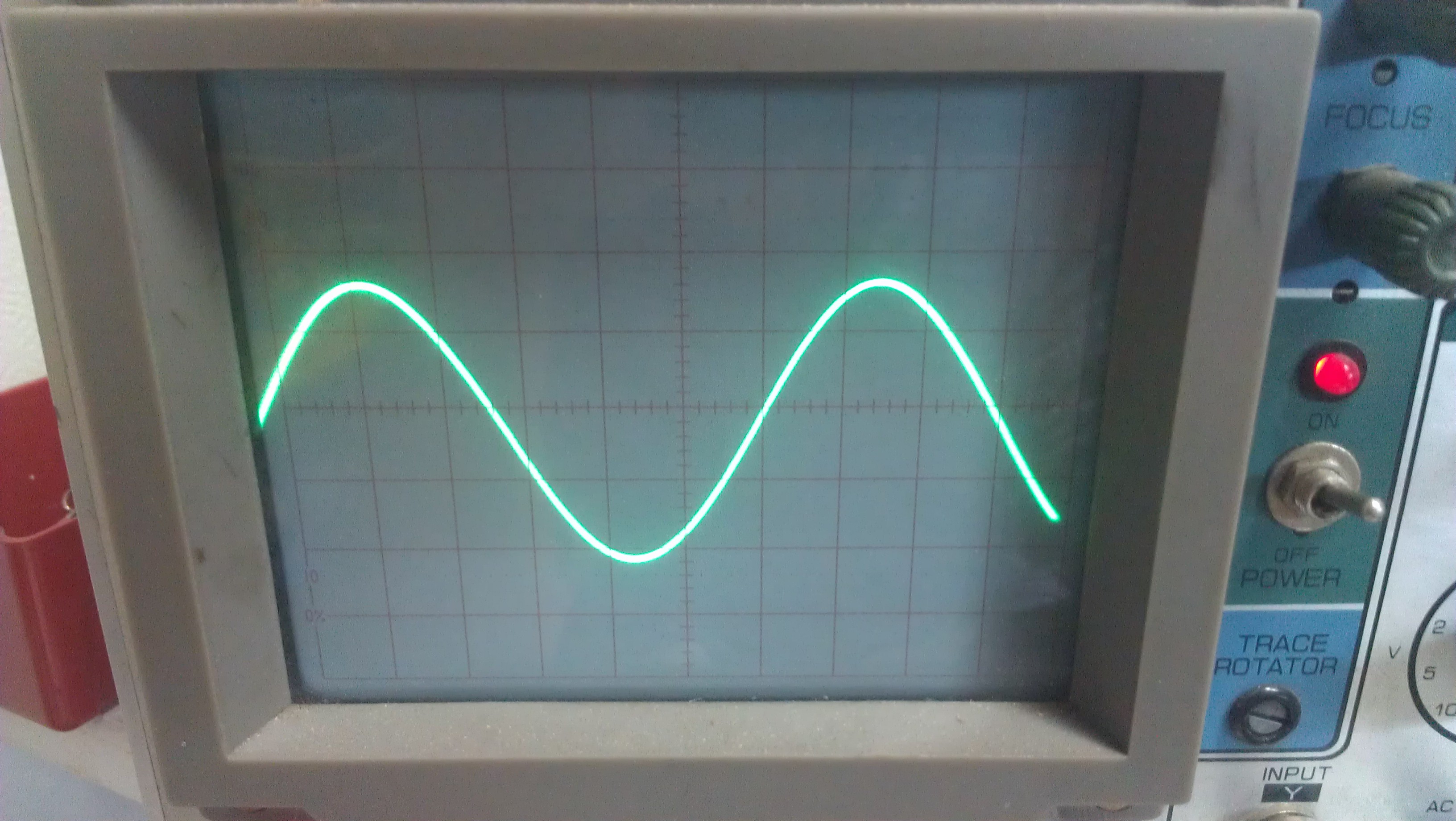

Am currently testing two 6Y6s, need LOW plate & screen voltages (200/135), but get the weird sine wave shown. Only on the 6Y6 plate (not preamp or PI). Clean sine wave is from earlier 6K6 tests. What am I looking at? Thanks!

Quick correction and question: My adjustable 500K grid stopper is not where its indicated on the 5E3 schematic - I have it AFTER the 1meg leak resistor (which I indicate I would replace with a pot - but haven't), directly on pin 7. Question: does it matter if my 500K pot (simple in-series wired) is before or after the 1meg leak resistor? Installed BEFORE may vary the input impedance, but AFTER wouldn't?
You want to place the grid stopper for the split load PI before the 1M resistor. I don't think the nipple distortion is your problem because you are driving a class AB PP section and that valve will most likely be "off", are you seeing any frequency doubling? This is caused by driving the PI too hard via your extra gain stage, I believe the grid stopper will help you with this issue.
