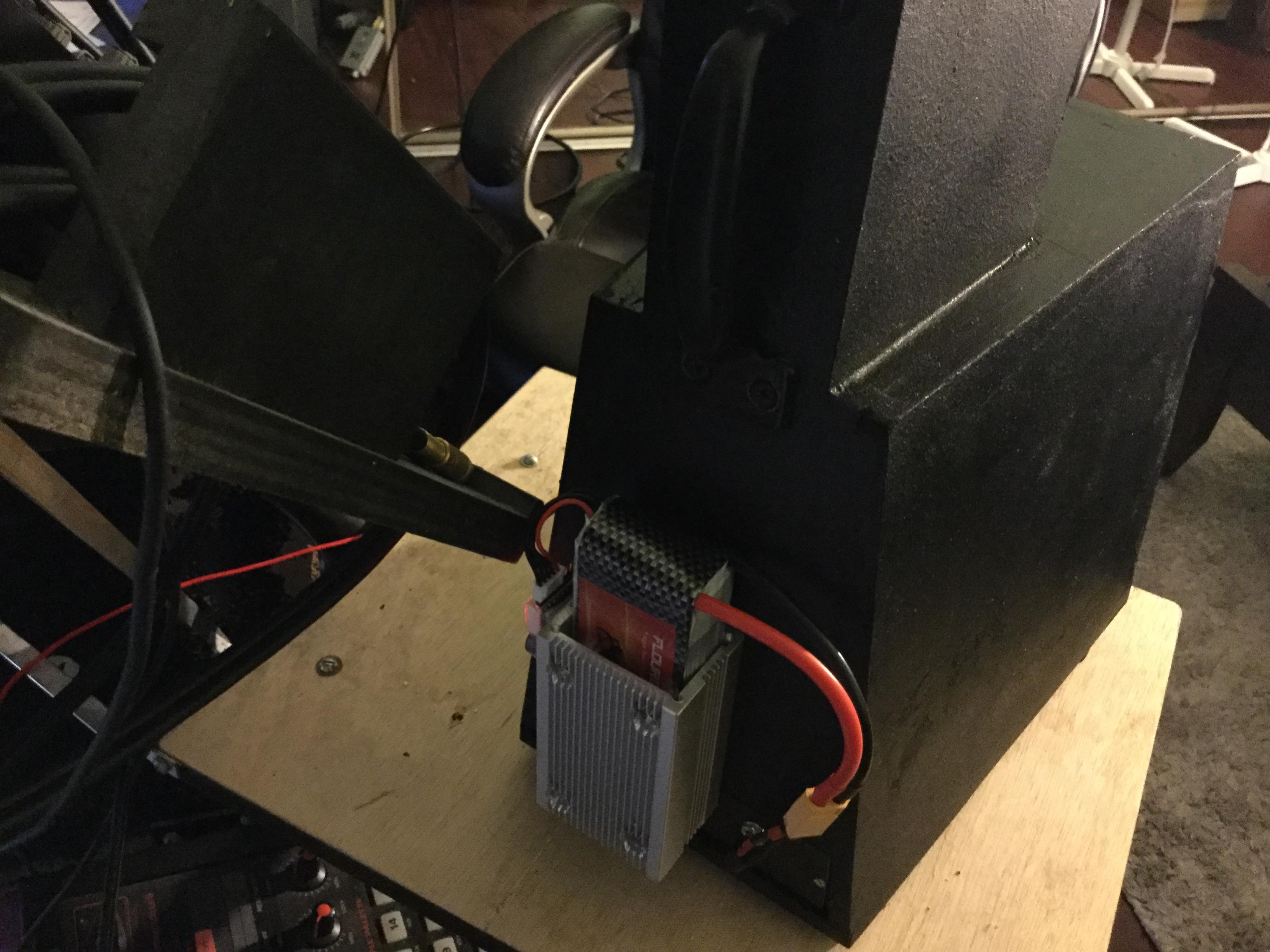

the 3 amp was on a lion battery. I have no clue what the amp draw is on the lipo other than it says 35c . But it seems to handle the high volume well, 30 minutes cranking, still cold to the touch both battery and amp. Now I just need to wire up some on/off switch and figure out the wiring so I can keep it hid and still charge some how. Also looking at project box to put the amp in, kinda wish I had bought one that was already enclosed.

Very Important > add a pigtail fuse ( an inch or two) close to the battery. You can buy them at an auto parts store.Now I just need to wire up some on/off switch and figure out the wiring so I can keep it hid and still charge some how. Also looking at project box to put the amp in, kinda wish I had bought one that was already enclosed.

Thanx for the advice infinia, I think I have one of those fuse holders in my parts box.

And I also goofed on my bass speaker watts spec I thought it was 50 watts but its actually 20 watts rms so I will add a voltage regulator to keep the voltage at a steady 12v which should keep the power within the speaker specs

What amp do you have? I very much doubt a Vregulator will improve things for you esp considering battery power.And I also goofed on my bass speaker watts spec I thought it was 50 watts but its actually 20 watts rms so I will add a voltage regulator to keep the voltage at a steady 12v which should keep the power within the speaker specs

And I have a voltage regulator coming, it won't hurt to have it on there.
And what makes you say that?And I have a voltage regulator coming, it won't hurt to have it on there.
The ebay listing claims to have a TPA3116. look at the chip amps data sheet, depending on the speaker impedance this one likes to run more towards 20 VDC.. regulation isn't helpful esp. on batteries.
Well if the amp is run at 12 volts it puts out less watts, in my case due to my speaker selection isn't this what I need? Remember my speaker rms on the woofer is 20watts and on the 6 @2 inch speakers 5 watts wired in two sets of 3 parallel I think giving me 15 watts each side. The spec sheet on the TPA3116 shows that if ran at 12 volts it will produce less watts around 15 watts I believe.
Now that being said, it sounded fine at the 16 volts my lipo fed it and most likely I would be fine without a voltage regulator but I figured it would maybe add a safety net in case I or someone cranked the volume up too loud.

FWIW most DIY people that have that chip amp use laptop power bricks 19-20 VDC. but on the other hand most folks try to get the most efficiency and power from their designs. What I do know is adding stuff on power supplies most often results in a big mess. ( BTW IF you can hide another master volume knob IMO a much better solution than " a power supply regulator")

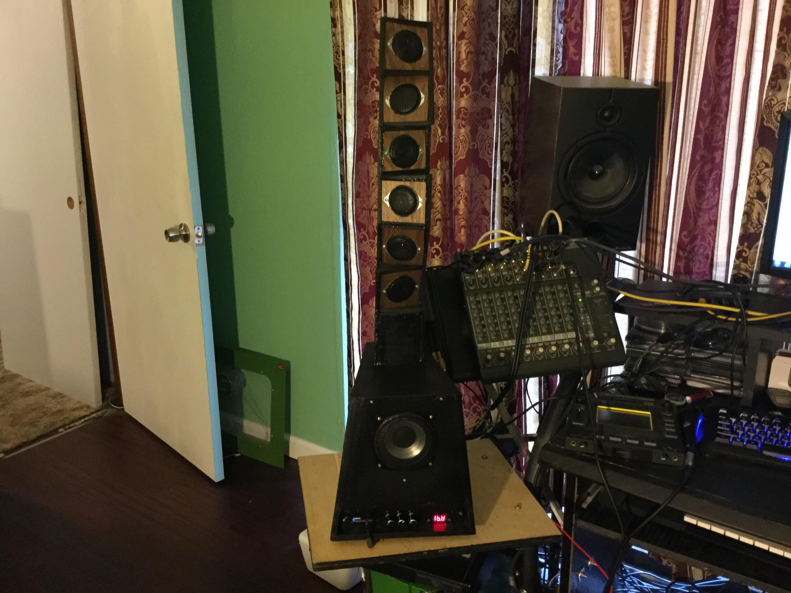

And maybe I should point out the direction of this speaker build. This is to be used as an amp/outdoor speaker, so I play electronica music, keyboard synth and Ipad both going through 4.2 bluetooth.
Oh the bass speaker is 8 0hms and the 2 inch speakers are 20 ohms but wired in parallel brings it down to 6 ohms and this was confirmed with my multimeter. The amp says 4-8 ohms.
And yes this is actually my second but we'll call it my first actual speaker build that I am trying to actually do it somewhat correctly. So I am learning a lot I never knew before.
As far as matching the speakers to the amp, I am trying to get it as close as possible with the available info that I had from the speakers. Only the woofer had full specs , the 2 inchers only had watts and ohms listed. And of course we don't know if the watts were rms or peak. So I figured better to play it safe, keep the wattage to the low side, maybe down the road, I will replace the speakers with all high end.
I also had my bass player come in and listen, he said they sound good but wouldn't hurt to put some eq on the mids and highs. So now I am looking at adding an equalizer to the set up. Maybe like this Pyle Pyle - PLE420P - On the Road - Equalizers - Crossovers
Just gotta figure out what that addition will do to battery power, looks like the wall wart I have will handle both. I also will have to figure on the amp where the bluetooth comes into the amp circuit so I can tie the audio in to the eq and back out again.

Ok I am just about finished!!
The good: power hook up works perfect, running 14.4 v 4s Lopo with voltage regulator. The sound is decent, I brought it up to my room for an a/b test against my wharfdale studio monitors,overall I am satisfied,just tad more midrange and it would be perfect. Spatial effect sounds great.
The bad: the 4.2 Bluetooth module I added has a high pitched noise,also I wired the power to it off the usb and this might be the problem as It sometimes kicks on the onboard Bluetooth thus cutting it out,I will probably remove it altogether .
The paint job came out like crap. I was using Rustoleum Bedliner the first two cans were a nice matte finish,but the can I got off Amazon which had the same label as my first two was glossy and sandy finish and this was only applied to the bottom half, ’ll live with it.
