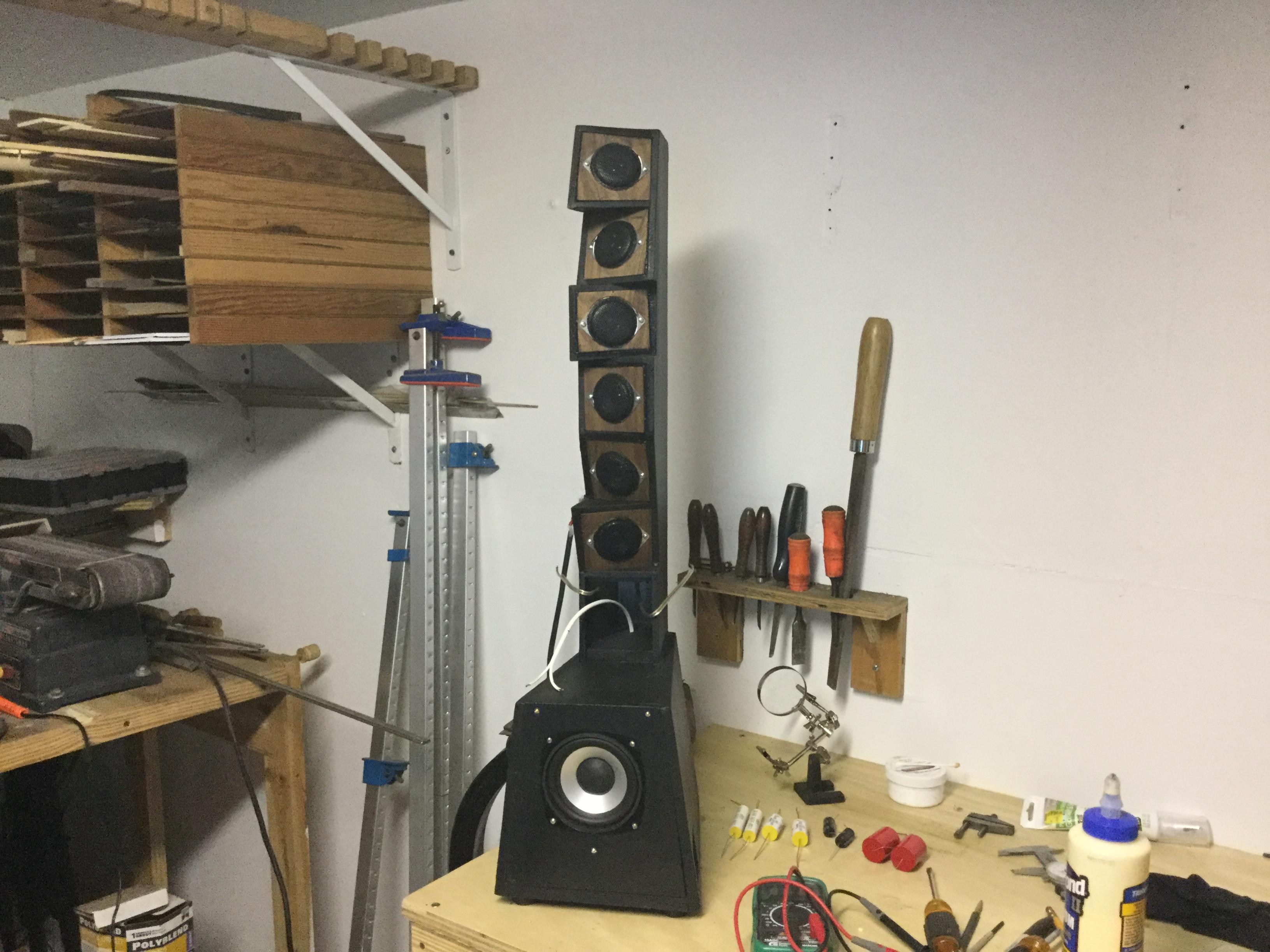

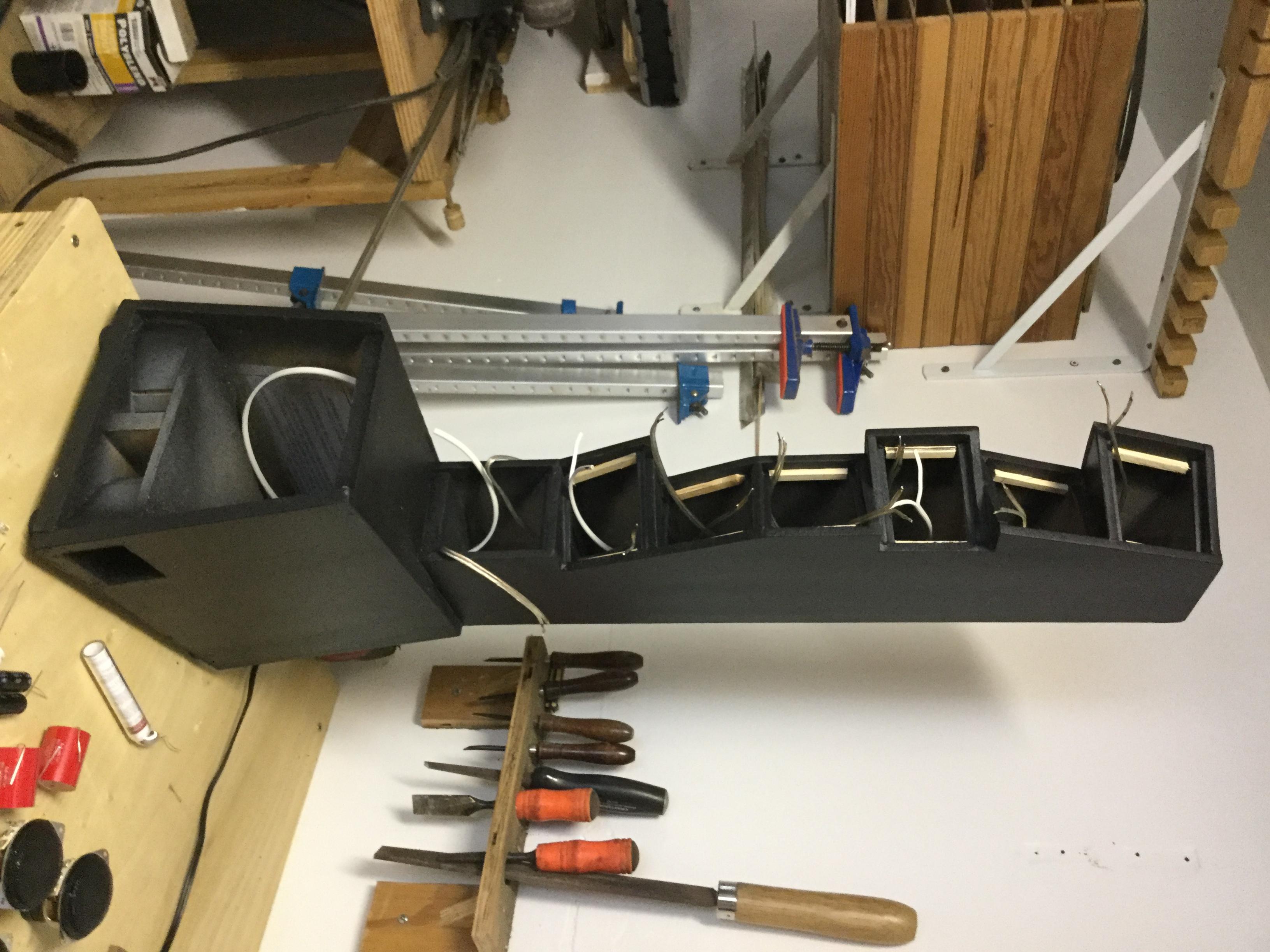

Well here is some pics of my portable lion battery powered bluetooth line array speaker. I was told by someone that this will not work as configured . But I am determined to make it work.

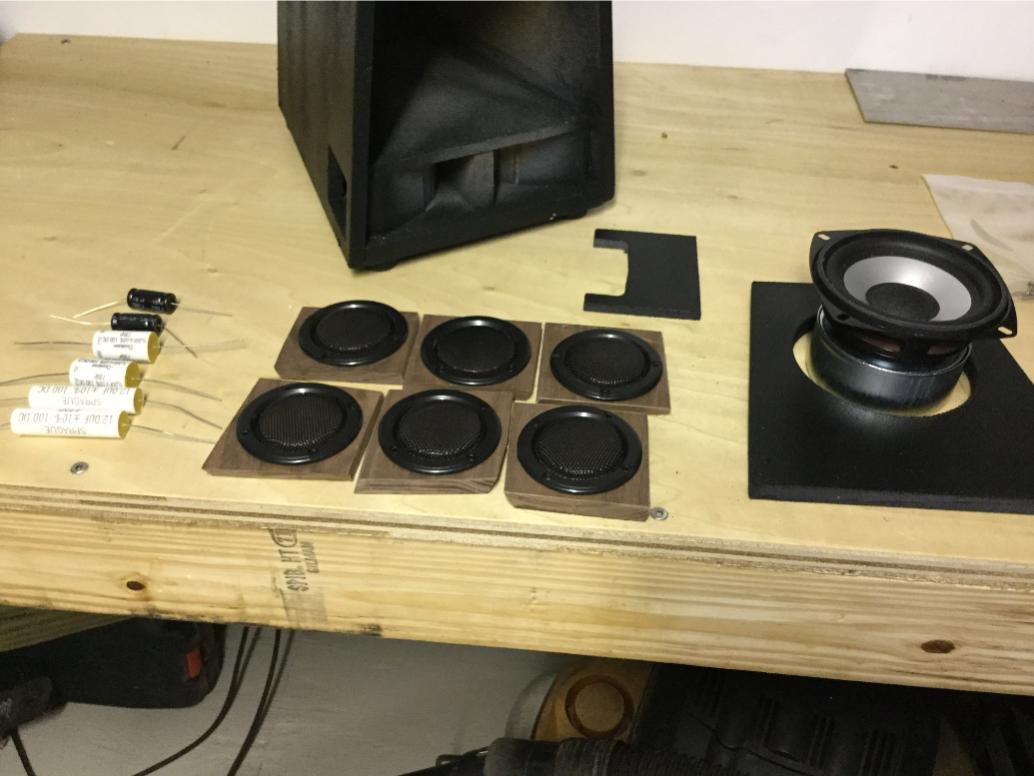

Still waiting on the 2 inch chinese speakers to come. I was originally going to keep cost under $100 but I am now at $150. And if I don't like the sound of the 2 inch speakers I will splurge and buy some Faitals or Daytons(don't know why I didn't in the first place. The 2 incher's will of course be housed in the top part and if you look to the left side of the speaker I will experiment with several caps to filter out unwanted bass. I will also add a second 4.2 bluetooth receiver so it will have total of two receivers. This speaker will be a combo mini PA system and bluetooth speaker. Made for outside listening and coated with 6 layers of truck bedliner. More pics to come as stuff arrives
PS Have a question for you guys, Polyfil or foam? I have 3/8 polyfoam and I have a bag of poly fil, what would be better to line the inside?

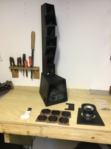

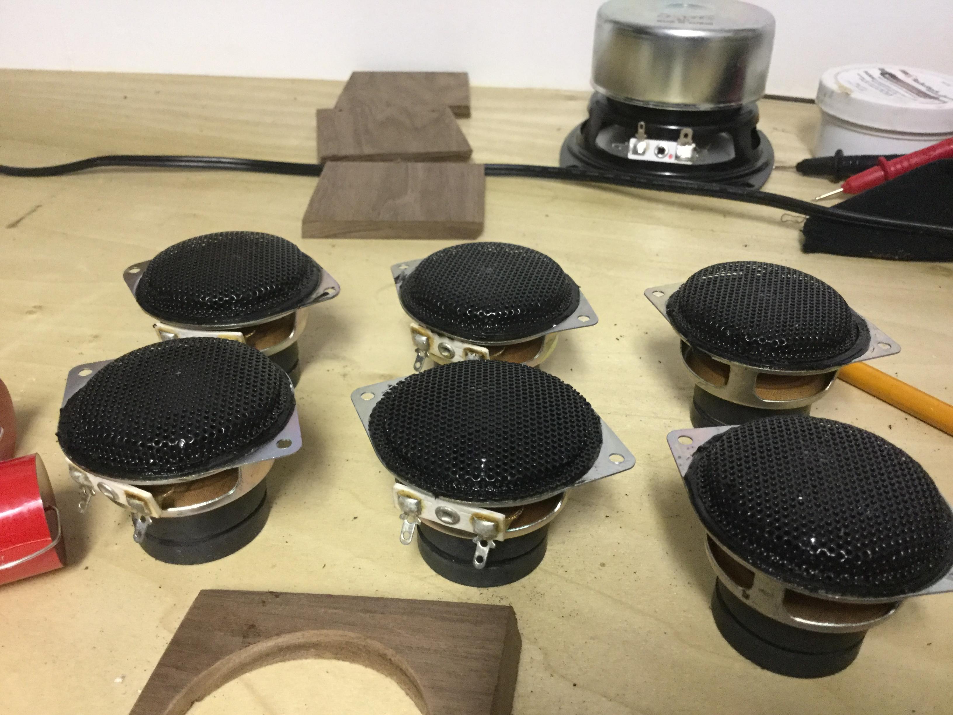

uuummm, the 2 inch speakers arrived and ran into my first problem. The speakers are fine but the little speaker grills I bought are not. They are just slighty off sized but enough to mess me up. Also the small 1/2 screws I bought are not small enough. I will probably just buy a new drill bit that matches the screws I have. As for the grill, I am thinking about leaving the flange off and gluing the grill screen directly to the speaker, this does not look bad except the speaker metal is zinc, probably the most hideous metal color there is not to mention how easy it rusts. So I will probaly mask off all six lil speakers and give them several coats of Rustoleum
