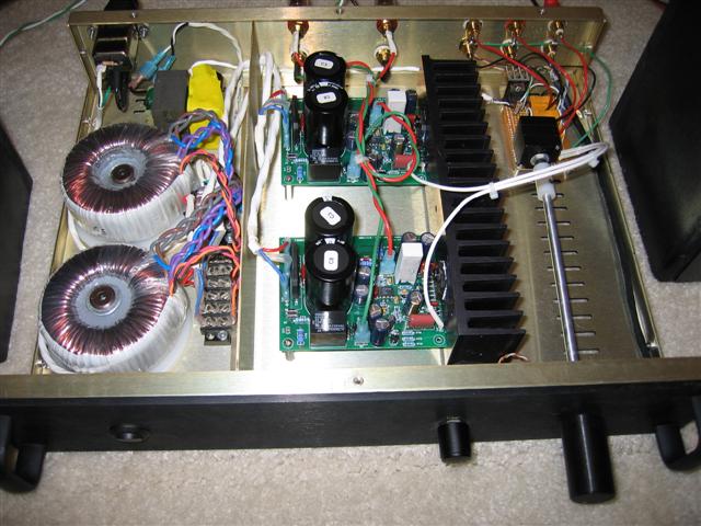

You know I'm really not sure. It came from a set of Logitech Z-560 speakers. This was a 160W RMS system that used 6 TDA7293 IC's. 4 IC's drove the sattelite speakers (TangBand 15W RMS), and 2 IC's were bridged to drive the 100W RMS tangband subwoofer.
I'd say it is at least 250VA, but honestly I don't know. It's 48VCT and that was good enough for me so I didn't need to spend $80 on a transformer for this project. After I play music as loud as I ever need to the transformer warms up to room tempurature, while the big 700VA EI transformer on my subwoofer amp is noticeably warm at idle. The smaller transformer for the preamp is 10VA.
The heatsink was cut from the Z-560 amp as well. Talk about recycling a broken set of speakers . One day I will make some ELF1.5's from the satellite drivers as well as they are a pretty nice speaker.

The making of ...
Nice to know you like it
It seems to look much more complicated than it is. On the third / fourth pic you see the basic construction: Alumimun 90° profiles screwed, some of them glued (2 component stuff, once hard you need a hammer to loosen parts) on heatsinks.
Heatsinks fixed with four screws (screwholes treated with thread-cutting tap)
on the bottom plate.
The copper plate carrying the amps is screwed on the two level profiles.
Front panel is held by two upright profiles glued on it, the power switch is flanged with two u-shaped profiles also glued on front panel. Back panel screwed on upright profiles.
The tricky part is to make the front and top, you need a router. My router is an el cheapo one for ~ $ 50,00, serving me for three years now. The cutter heads (specified for woodwork, and yes, they are still usable !) I used are also the cheapest I could get. You got to operate the router on top speed and move it slowly, very slowly. I guess this only works with raw aluminum, hard coated (chromated) stuff would kill your tool.
The front is made of 5 mm raw aluminum pane, the edges are shaped with a 45° cutter head.
The 3 mm top panel was the hardest piece to make. The cuttings are made with a hand-driven fretsaw in a way that the cuttings were a bit smaller than in the end. The final shape was made with a flush cutter (and here it becomes hard to explain when you´re not a native english speaker), guided by an open box which inner measures are corresponding to the ones of the final cutting, fixed on the underside of the raw cut panel. The perforated aluminum sheet is glued to the underside.
Hope this is clear somehow, I don´t know if I named the tools right. Otherwise I could make a "photo story" of it.

Thanks SOP. That front plate looks way thicker than 5mm somehow. Must be perspective.
One note though - I was always under the impression that router should be on lowest speed. That is the way I have done it, but it was quite a nerve wracking experience with all the warnings of lost limbs etc .
Joined 2003
Thanks for your comments. The Freebird works like a charm. I'm absolutely loving it.Russ White said:Thanks for you input on the Freebird. Its cool to see it actually working.
How is it working for you?
I think the front panel is cool.
Thanks. The chassis is actually an aluminum chassis that I bought used on ebay (Digikey part# 377-1031-ND). I used a sponge sander (for drywall) to remove all the scratches on it, or at least make all the scratches in one direction for a brushed metal look. Then, some liquid metal polish was applied for the extra bit of shine. It actually has a lot more shine to it then what you see in the picture.Byrd said:DcibeL - also good work - certainly not as ugly as som of my amps in 15 year old computer chassis . The chassis looks like it is made from stainless steel?
Byrd said:That front plate looks way thicker than 5mm somehow. Must be perspective.
Well, that´s the trick - the 45° edge is ~ 7 mm, naturally looking thicker than 5 mm. The thing with the top speed is as simple too: The faster it runs, the more "cuts" per mm are done. It´s different when working with plastic, at 30000 rpm it may tend to melt. I think getting seriously hurt by a router only can happen when you´re bladdered. Buzz saws are the tools that make me nervous; count the fingers on an old carpenter´s hands ...
