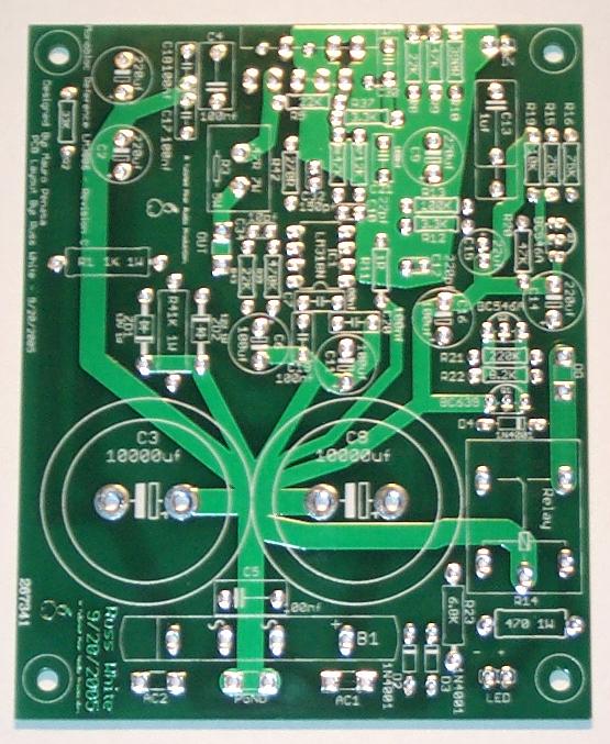

LAST GOLD PLATED STEREO BOARDs
I have the last few Stereo Board for My_Ref for sale.
Penasa Rev.A Original Stereo Board with 70um copper,
gold plating, top silk screen.
Added Solder pad for Rev. C additional component mounting.
Top quality. 18 euros plus shipping.

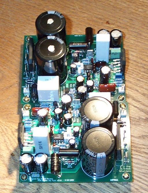

Seeing as the Mauro thread has gone a bit quiet, I thought I'd spruce it up with a bit of nearly off-topic goodness 🙂
Top to bottom: Russ's FreeBird Pre, Mauro Rev A, New toy - Eastsound E3 CDP.

Going back
I installed the latest ideas in mine. 17 Volt zeners amd LM334 constant current sources.
It does not sound as good as before. It may be output related. This was only checked at low volumes. The amp seems colder and "smaller" than it did as a Rev C.
May be my implimentation of the LM334Z. The data sheet showed a formula to calculate Iset. The value is Iset = 67 mv/Rset. I used a 16 ohm resistor to get 4 ma. Is this close to the values other have used here?

Re: Going back
I actually agree with you, I am not sure this mod is for everyone. And I reported my results only after a very brief listening session on my bench amp which was classical music at medium levels. My vote is actually not to bias or tweak the zeners unless you feel like experimenting. I have not modded my mains system (Rev C monoblocs) at all, and it remains my favorite.
I am not 100% sure that the 318 is the best candidate for biasing...
For the record:
I used a 100R pot and my DMM to set the current, but measurements show it is close to 16R.
When you add the current source you definitely need to increase the available current to that part of the circuit.
I did that by running 2x 1.5K on each rail next to the zeners. This gets me about 18ma for the LM318 PS.
So my advice...
If it aint broke.... and it aint, don't dix it, but if you feel like it, play all you want! 😀

Hi all,
I not suggestion to modify the biasing points of LM318 , in particular in revC.
The equilibriums of a " nesting feedback " circuit are important, and is not been able modify without a very profound knowledge of all the situations.
The motive for which I have used the 12V and zener is written much turned in this thread.
The active load ( current source ) it is not adeguate. The load with LM318 it is constant and greater of 10Kohm, and LM318 works already on class A to this impedances. Increasing the bias current it serves only to increase the THD.
I don't want do the "teacher", but is not has to ignore the theoretical complexity of the circuit. If not understands perfectly as works the net among pin 6 and 8 of LM318 (revC) , not it may modify the circuit...
ciao
Mauro

mauropenasa said:Hi all,
Thank you Mauro! I was hoping you would give us some input on this. Your statements confirm my suspicions. 🙂
I will leave the circuit as it is. 😀
But still it was fun experimienting, and I learned something! 🙂

Changed mine back
I pulled the current sources out today. Sounds much better. Left the 17 volt zeners in.
Cannot tell if this made a big change from the 12 volt ones. It was Monday the last time I listened to it with the 12 volt zeners. If anything, it does not sound worse. May be a subtle thing.
Might have a little better dynamics, hard to compare from a week ago.
Like reported and recommended, this may not be better only different.
