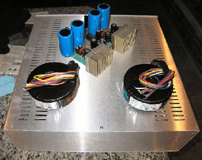

Plitron toroids are in
Finally got my Plitron toroids. Took about a month. Very nice looking encased in black tape. It has a nice rubber mat attached to the bottom to provide some dampening. Certainly their is the apperance of high quality. We'll see if their sonics are as good as I'm hoping.
My par-metal chassis though came in and is HUGE. Maybe I need to plan a preamp stage in front of the Mauro amp. I am buiding a stereo Rev. A so far.
Anyone think a tubed preamp section is crazy? I think turning this into a tubed hybrid would be interesting......
Maybe I just need a smaller chassis and a nice attenuator???

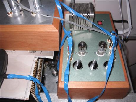

I have 2 chipamps one with a Plitron trafo. and the other a Hammond. plitron is pricier but has a reputation for quality, they look well made with the potted center. Hammond is also very good,is heavier built and readily available. Yes I had to wait for the plitron also, while they made it! I like them both but I really havn't a-b'd them in the same circuit.
A tube preamp is neat, I have a Bottlehead Foreplay 12au7 which is a kit. What I don't have is solid state pre; I will have to look at the Freebird.
