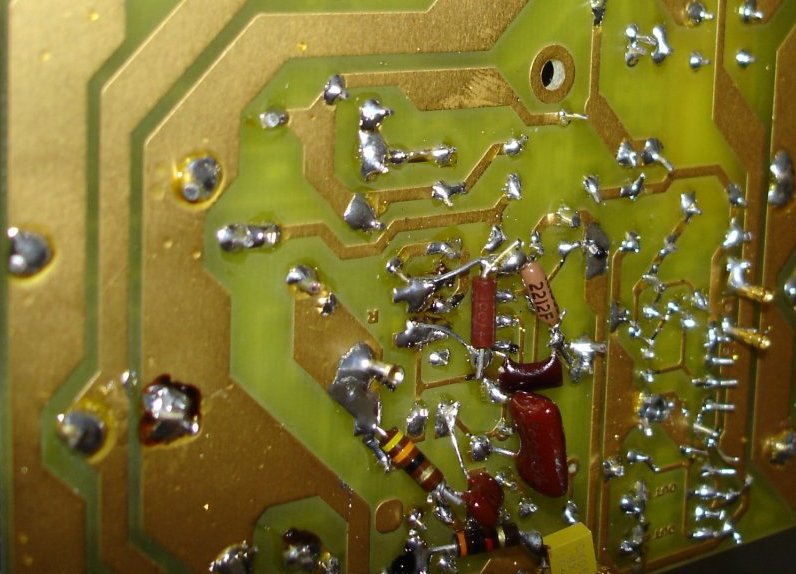

Which is the NFB?
Hi.
About to go to bed, it's late here...
On Russ's beta board, is the NFB = C14?
Got one board complete!
Michael
Hi.
Michael
Hi Michael,
The cap in the feedback loop is C9.
C14 is for the speaker protection circuit. 🙂
Glad you are making good progress.
Cheers!
Russ
Cheers!
Russ
Michael, it you have a couple of them, put a 100nf film cap between the pins of C9 on the bottom of each board. 🙂 You will be glad you did. 😀
Cheers!
Russ

Russ White said:Michael, it you have a couple of them, put a 100nf film cap between the pins of C9 on the bottom of each board. 🙂 You will be glad you did. 😀
Cheers!
Russ
Yes I do, and I will. They came in the beta parts kit, (thanks Brian), marked C21.
I won't tell you that I spent 5 minutes poring over the board looking for 'C21'... The answer was in this thread 🙂
Time for bed!
Thanks,
Michael
Bypass and mechanical resistance 🙂
Hi Russ!
in my humble opinion, and only for contribution
The bypass of NFB caps it isn't so simply and not always with great results.
It is very important the quality of the bypass cap, and dependfs from the bypassed big cap....
probably, if you use the right "big" cap 220uF 50V Low esr, it's possible that bypass is unnecessary.
For example: if the big cap its a Nichicon low ESR (c9-C24) from Brian (great BOM, Brian!!, sincerely) you could prefer a unique solution, with lower ESR: try Panasonic FC 220uF 50V.
There is a little difference, but the FC it's a little bit better.
For the bypass, the little film cap must be very very fast, and clean!
So you could use Vishay MKT 1872 series 1%, high slope DV/DT, or a little Evox Rifa MKP...great quality, in little box...or Arcontronics R82..
or a panasonic sere E (from Brian Bom the type of 1 uf value)
For Panehead:great with italian gold stereo PCB... but...don't you think that the male faston could be better than yours in "PL" positions?
Mechanical resistance it's important, i mean, and the secondary wires of transformer are about 2 mm diameter.
And so, the ground connection must be greater, for a good sounding and functioning... and so the power connection, and speaker wires...i mean less impedance etc etc...
Ciao
RR

Russ, sincerely, today, i always use the Nichicon of Brian's choice.
They sound right, and are very very good.
I tryed the bypass, too, with good ones, but i think the sound lost a little bit.
So i did cut away the bypass.
Analizing the datasheet, i note that FC caps are a good choice and good enough to eliminate the necessity of Bypass. Thats all.
Piergiorgio Lovati sayd me that a possibility could be use a Solid alluminium cap, for c9 and c24 but the costs are a little big high...
Ciao
Riccardo

Need to learn how to use all this fancy software to shrink my pics to a postable size. Installed in my cramped box, it answers a couple of your queries. The ground is doubled up, two wires, used four pin Neutrik Speakon connectors. And about 8 inches of star quad 16 ga cable to connect from power supply to amp, same is used to connect from connector to board, but about 3 inches there.
Agree completely on the feedback cap, used a 0.33 ufd stacked film and foil to bypass a 220 ufd Rubycon ZL. It was added after pics. Connects from input of electyro to the 390 ohm resistor to get around trace inductance. Gotta go back and do the same to my Rev A board. Suspect it helps.
My amps only has a half day of playing, but it seems to be what I have been looking for.
Thanks again Mauro, Russ, and Piergiorgio for the help.
George

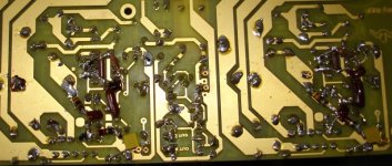

maf_au said:Panelhead's photos,
Pic2:
hey, this is one of my boards!
How gone that it is in Australia now?
Piergiorgio
