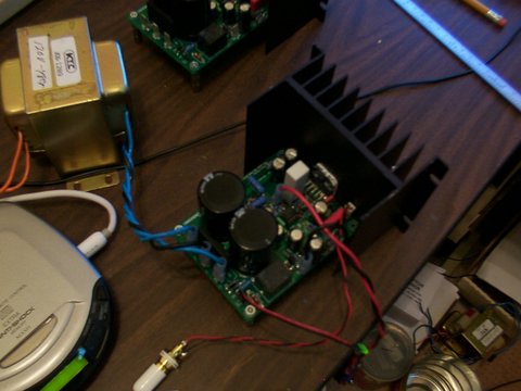

The Betas are up and running. Only made enough breadboard to test one at a time, but both check out. 3.0 mV so seem real clean. First impression with only one channel at a time is that the brightness at the top end is smoothed out a bit.
Will try to get both running together later this evening.

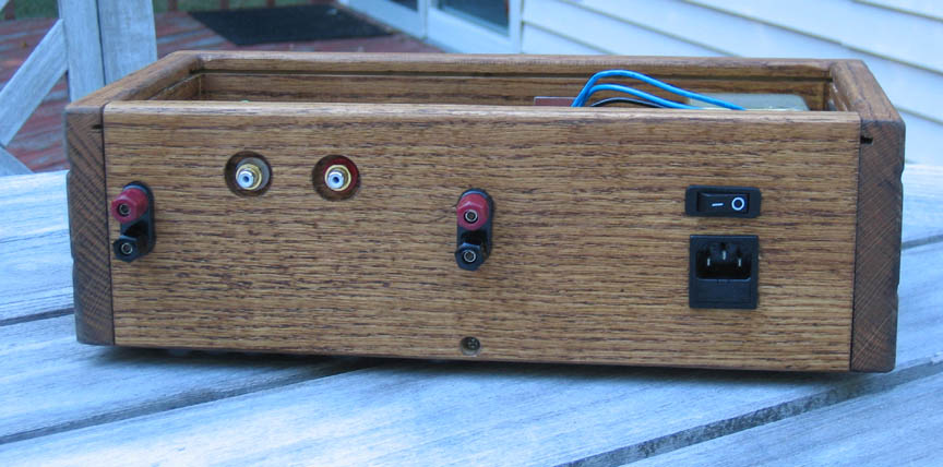

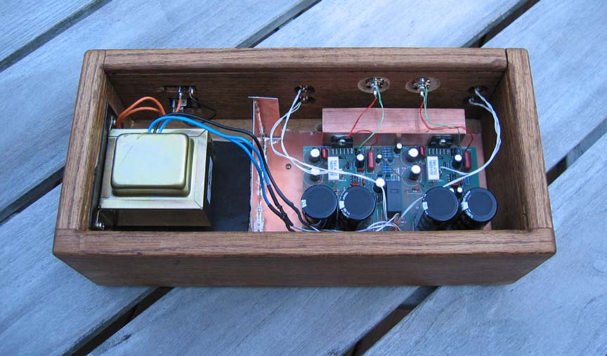

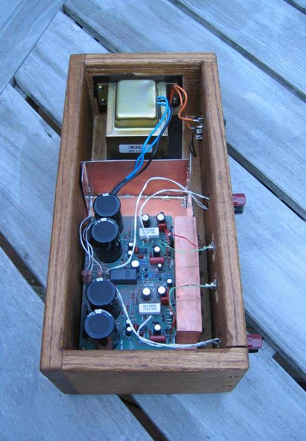

Just wanted to add my amp to the list of completed amps built using the original boards that Mauro, Russ, and Brian put together. The only change I made from the parts provided by Brian is to change the 220uf feedback electrolytic to a Panasonic FC and bypass it with .1uf and 0.01uf film caps.
I built it using the now lamented Parts Express $7 special and put it in a homemade oak box. I built an internal copper ground plane / shield using copper circuit board stock and just used a chunk of copper (1" x 4" x 6") as the heatsink.
After playing for an hour or so the heat sink gets warm to the touch but not so hot that you can't leave your finger there. There are ventilation holes next to the copper block, so I assume theres a decent chimney effect helping to keep the temperature in control.
I normally invoke a 24 hour rule before seriously commenting on the sound quality but I will say early indications are promising. One trick that I've found with other amps seems to be true here - the polarity of the transformer makes a difference. Try swapping the leads going to the board and you'll see that one way sounds better.
Among the changes I'm considering are better input caps (I've got some nice Russian military surplus oil caps) and fast/soft recovery diodes.
I'll attach a few photos for those interested.
Thanks,
---Gary

I have several (10-12) of those exact heat sinks...
Yes, I got a bunch of the heat sinks for around a buck each on eBay. From what I could find on documentation, they seem to be about 1.8 which is what the National Semi design guide shows for the 3886 at 35 volts. They are warm but not hot.
Transformer is also warm, but not hot driving both channels now.
