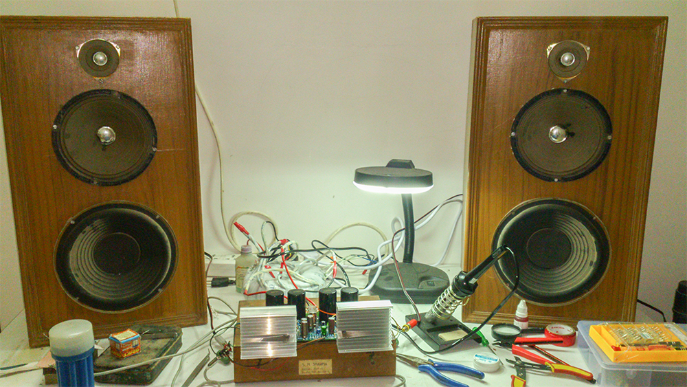

But I'm so glad I was pleasantly surprised by my DIY make-shift speakers living up to myref. I always thought my 3-way speakers would just sound dull without the tone controls of ESP project 97. Plugged in the TL071c again and I just sat right in the middle of the two for several hours and played out all my favs. The myref has a very clear, detailed image and sounds just like inside a movie hall or better. I feel as if I'm out there in the live.
The paint on the enclosure will dry by tomorrow and then once inside, the shield of the enclosure will hopefully reduce or rectify the oscillation of the myref.
From the looks of it, these look trash and those are some of the cheapest drivers I bought with my pocket money 15yrs back. But for now, my new 2-way speaker project is on indefinite hold.

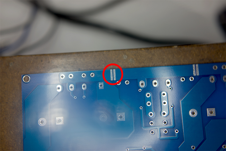

So I turned it off and went for a break. When I returned, I switched on the mains with shivering hands (it's biting cold here). And I saw a spark on the PCB. The only switch I have currently is the AC mains. And then no sound. The relay clicks in though.
Upon microscopic inspection I saw that the PCB has some kind of a fuse built-in. Is it ok to jump it and try again?
Photos from a blank PCB (I have 4 extras). Click for larger version.

I jumped the breaks with solder. I put in the bulb tester and turned it on. The LED came on and the relay clicked.
If I remember correctly: I measured 0V at speaker gnd terminals (well the positive rail read 25.6VDC from there so they were not disconnected, suggesting that the relay was engaged). But this is if I remember correctly.
And no sound. Speakers felt dead.
I'm supplying 19VAC and getting 25.6VDC on the rails. I'm also using a TL071c instead of LM318 (they were blown and I'll only put in new ones once I've put this in it's enclosure).
The only way to turn on this thing now is to touch the Pin 1 of TL071c with a screwdriver etc. That somehow seems to engages the relay and turn on the speakers? This is contradictory to my measuring 0VDC on speaker gnd terminals.
What else should I try?

Thats not a fuse. You can change the fuction of the pcb. If it worked without then they probely need to be left as is. Are you still using shunts on your supply? This is not the way to get a stable supply. As the current increases the voltage decreases (Relais on relais off relais on.......). I think this amp needs 24Vac if only for the relais (30Vdc).

I bought 4 PCBs and one assembled piece from a chinese vendor. I saw a spark while turning it on (it played fine for hours earlier), and then I verified with my multimeter that the spark-gap fuse was in fact blown. When soldered it came right on but I'm using a blulb tester in series now. And apparently now it's too low a voltage. I'm planning to raise it to 22VAC and the primary in series with a 100W bulb. I'm currently connecting 4 ohm speakers.
My broken PCB had that gap/fuse blown (looked just like a shorted blown out metal). On the new pcb that was a 0 ohm, conducting joint.
thedeath0212: You should be able to use it provided it is actually a 24 - 0 - 24 and NOT a 24 - 0.

Also my voltage was 19VAC with the bulb tester. Without it, the relay clicked right in.

This shows that the relay drive circuit is susceptable to supply voltage variations...........Also my voltage was 19VAC with the bulb tester. Without it, the relay clicked right in............

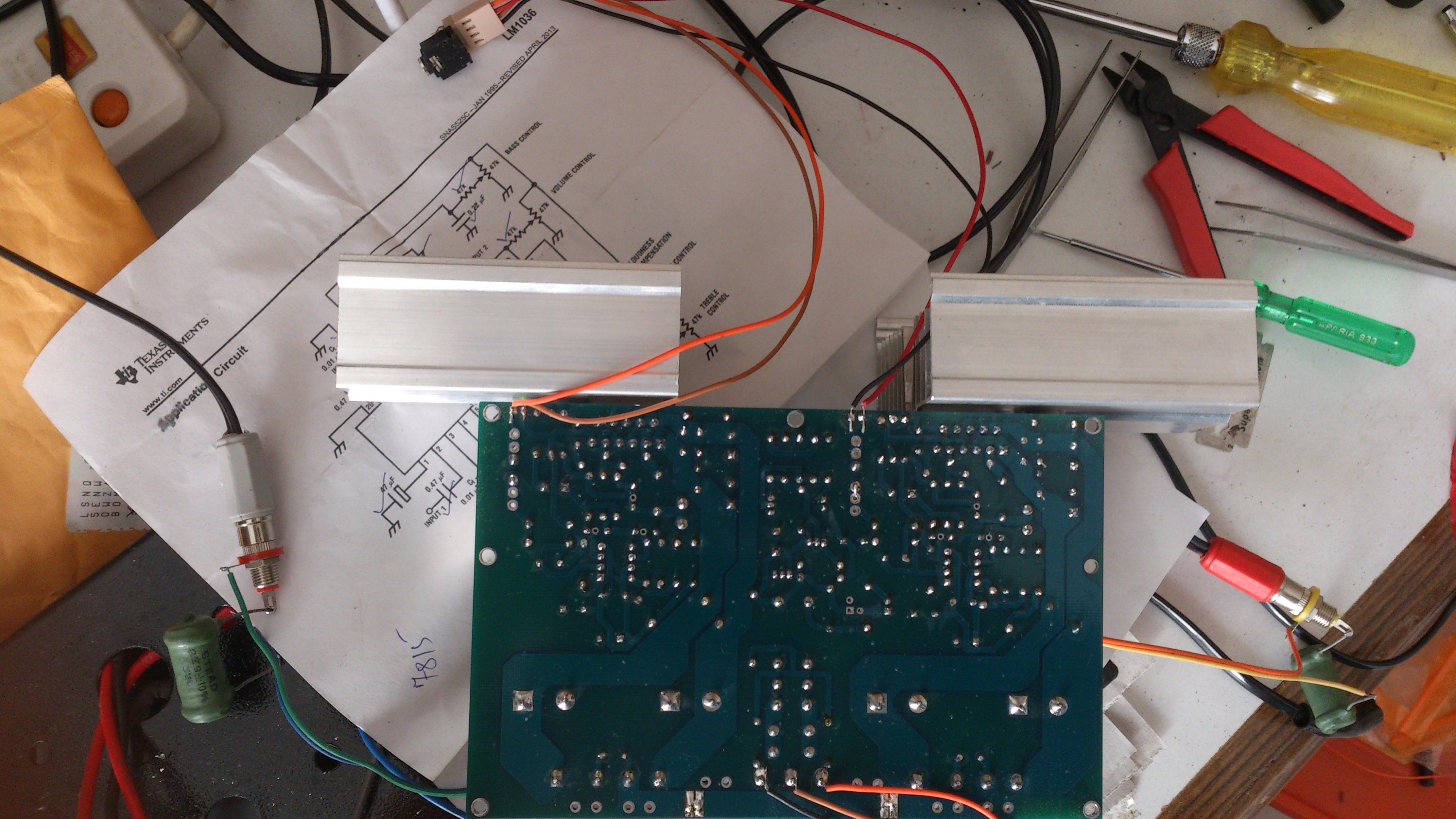

So far all is well. However I just replaced the TL071A with a LM318n from texas instruments (Chinese supplier on ebay). I get a hiss/HF oscillation. This is 12KHz and above. LM3886s run pretty warm. I shorted the audio inputs and the hiss fainted but is still audible. LM3886s stay warm/hot.
Currently the lead is 11" before it is shorted at the socket/end.
1. What could be the issue?
2. Will putting this in a case help?
Thanks.

The hum wasn't a ground loop per se but was actually because the input signal had an audio ground separate from the 0V in myref. So basically I had to separate the 0V of LM1036 and the myref and link their audio grounds instead of connecting the 0V rails. (More specifically, myref was amplifying the difference between the ground and audio-grounds in addition to the signal, thus the hum).
The hiss/HF-oscillation with LM318n remains. Also, what kind of offset should I be measuring on the speaker terminals. Is it AC or DC?
