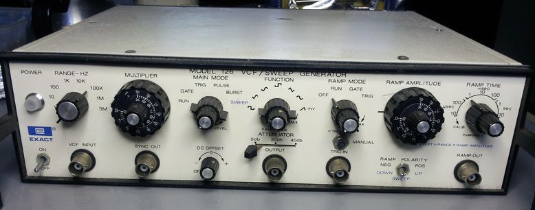

I may have asked this question recently but I'll do it again.😱 Is anyone aware of a scope tool that is PC based and is stable and powerful enough to give accurate and useful results? This is of course a cost consideration on my part. I'm aware of some of the deals on eBay for real hardware units if I have to go that way.

Try to get a decent fully tested used 2ch. analog oscilloscope with 1:1/10:1 probes from a used test equipment seller, local surplus store etc (ebay deals can be problematic at times). 20Mhz bandwidth is not ample but OK for the most part (50Mhz++ is better). Then get some reading on 'scope usage and measurement and play with it. It will be an eye opener, literally.
Soundcard-based 'scopes are OK too for some first insight for zero cost (check out that Visual Analyser, a current thread here atm -- a very complex tool alas not perfectly suited to beginner's needs) but are VERY restricted (only a few kHz) in bandwith and typically not that easy and convenient to operate.
PC-based signal generators are OK too, but again restricted in bandwidth. No way to make square waves or pulses with steep edges.

Thanks KSTR, I will certainly take a look at that thread. I got a refurbished signal generator for a song from a TV repair shop several years ago. Its only use so far has been for speaker building and testing. Now maybe I'll be able to learn to use it for the intended purpose.😎

Bob, that generator looks pretty perfect for the task and is very versatile with its many operating modes. Now get a scope 🙂
